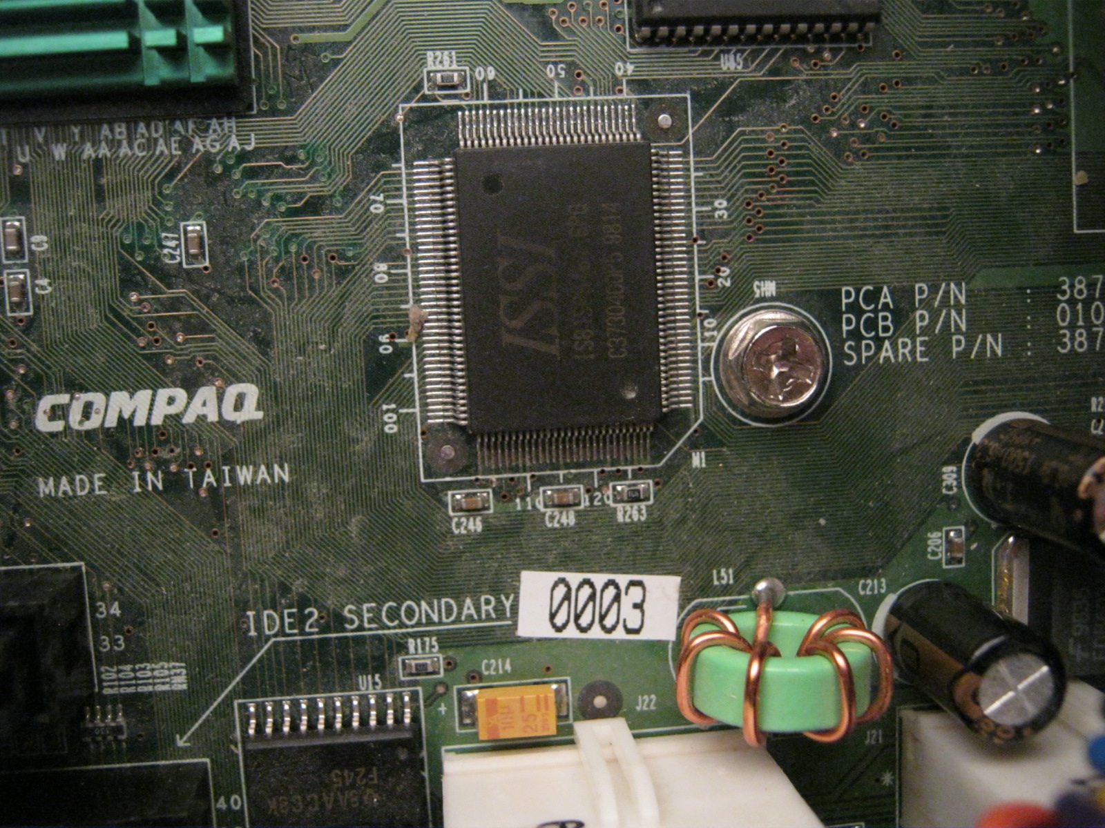

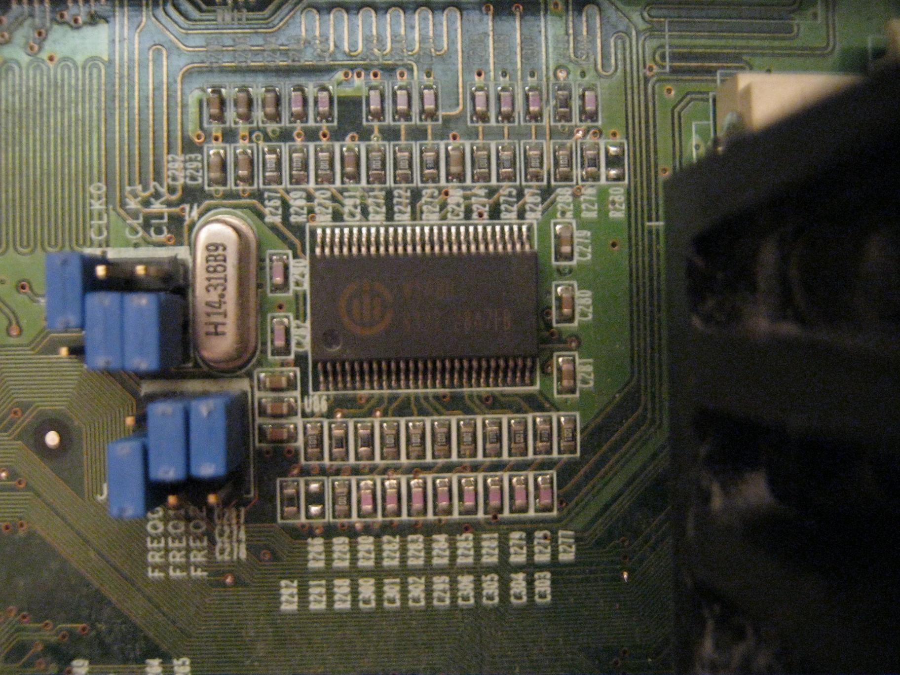

                I want to get this computer running so I can use it until I get a real Windows 98 CD. Today I noticed that the cache memory chip has a dark spot on it, but the chip doesn't get very warm. The clock generator chip is a W148H and doesn't get warm at all.

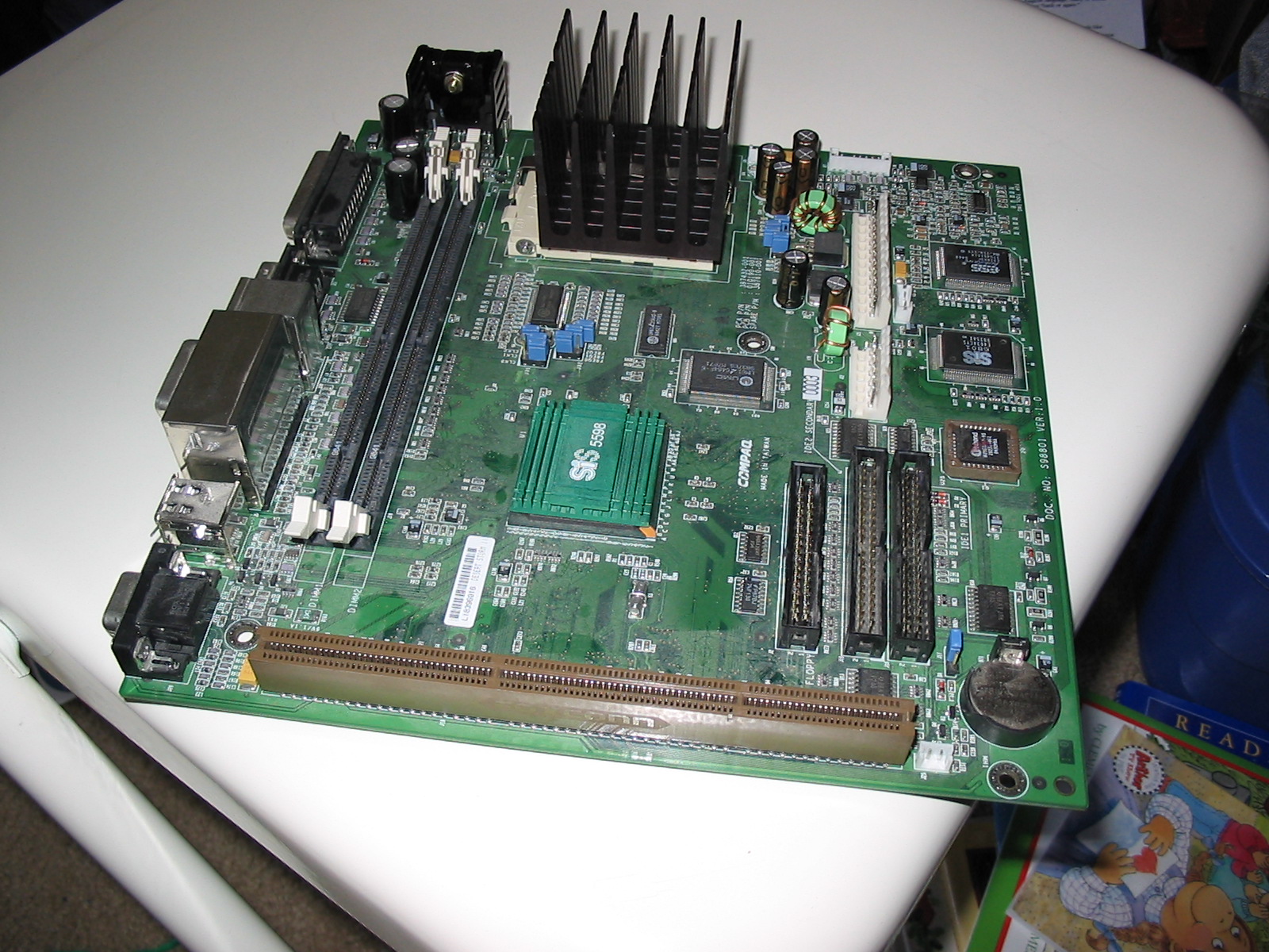

                I have posted three images of the board. The first is an identical board that does not work. Next, there is a picture of the cache memory chip. Finally, there is a picture of the clock generator circuit.
                I would like to get this board working. Reinstalling Windows did not help.

                  That generator clock IC of this maker logo mark is a problem I had with many different boards that used it. Runs hot (some warmer some hot) than should be and signal and voltage quality fades away.
                  Better to find a good socket 7 (dual voltage, switching regulators) based on HX chipset someday.
                  Cheers, Wizard

                    I was thinking that was the problem. The computer keeps getting slower every time I use it, and it was doing this before I tried to upgrade the CPU. The extra clock speed of the K6-2 must have stressed the clock generator and caused it to produce a bad clock signal. I can't find any information about the chip, and I don't have the skills to swap the chip with the other board. That chip might be bad on the old board as well.
                    None of the chips on the board are very warm. The clock generator is only slightly above room temperature.
                    I would like to know how Compaq managed to run the SiS 5598 chipset on an 83MHz FSB.
                    There are way too many design flaws on this board, just like everything Compaq makes. I had to modify the board to get sound to come from the built-in amplifier at a reasonable volume. I had to turn all the volume controls in Windows all the way up and put my ear against the speaker to hear anything. Now the amp might be the only properly working portion of the motherboard. If they couldn't get a simple audio amp right, what did they mess up on the rest of the board?

                        The amp wasn't broken. The board designer left out two resistors and had direct connections instead. After cutting the traces and putting resistors across the cuts, the amp worked properly.

                          This SiS on yours chipset were specificed to run up to 83MHz. True on one of ASUS boards with this chipset and were good boards and sold by large numbers but not great on performance-wise but it is enough for public.
