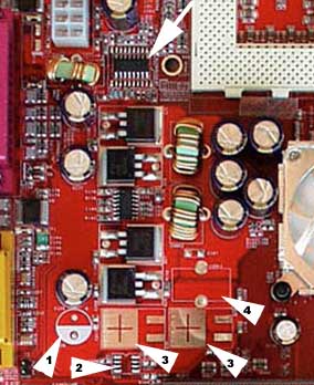

  • Mustang
    • Dec 2003
    • 203
    2 Phase to 3 Phase VRM
    There has been much discussion about VRM's on this forum recently. It lead me to thinking about the viability of upgrading an older motherboard to handle an Athlon 2500 XP. The board up for surgery is a MSI KT3 Ultra ARU. It has 2 phase power but space for the 3rd leg. The board has been recapped and is running the 2500 XP at 333 FSB which is an unsupported option in the latest BIOS. I just question its stability with only 2 sets of mosfets and think a 3rd would add a bit more power handling as well as stabilize the voltage peaks. Is this a feasable option?
    Close-up of the board power circuitry. The arrow on the top shows where the HIP 6302 controller chip has been spreadeagled to fit the footprint of the much larger 6301 programmable multiphase controller. The arrowheads indicate missing components or more correctly components that were part of the reference design but have been eliminated by the (invisible on a red PCB) red pen (1: cap, 2: driver chip, 3: MOSFETs, 4: choke).
    photo and description courtesy of lostcircuits.com

    That's interesting that they just stuffed 2 of the 3 phases on that board. Have you had a chance to put a scope on the VRM output while the CPU is under heavy stress?? I never thought the Barton core chippies were too demanding on core current, so i would think that 2 phase would be fine, provided there's enough output capacitance to keep Vcore from drooping too much due to the high di/dt's exhibited by all modern CPU's.
    As for feasibility, as long as you're sure that the 6301 is the proper VR controller to go on the PCB, and make sure that the added FET's are a close match to the existing ones. I personally wouldn't bother, provided the system can hold up to at least 72 hours of continuous Prime95 stress testing.

          The 6301 controller is 3 phase but the board has a 6302 which I'm not sure if it's able to handle 3 phases.
          You're probably right it may just be a waste of time. Maybe just soldering larger caps might help it along enough.

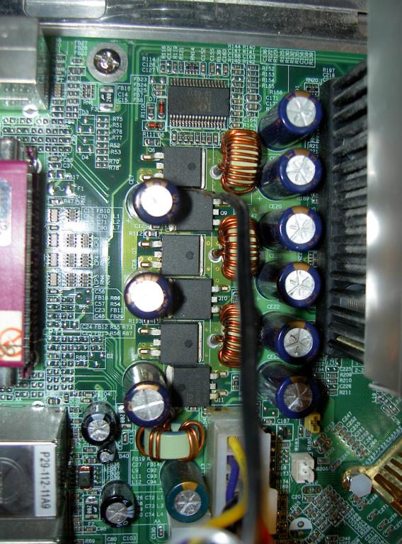

                  I would recommend checking the +5V with a DMM before assuming you've got that much of a voltage drop. Could be oxidation on your ATX connector too..
                  I usually do it that way - the board can't even strain my Fortron 530W... still annoys me though watching the software and BIOS readings take that much of a dive when the overclocking starts. Goes from 4.82 all the way down to 4.44 with the PSU measuring a solid 5.09. I think the lowest I ever saw was 4.39.
                  Maybe the board's getting the readings after those Lelon caps... hope the Panasonic FM's help. If I can get them to fit that is (replacing 10mm with 12.5mm). Never really noticed that much fluctuation in Vcore even at 2.4 GHz.

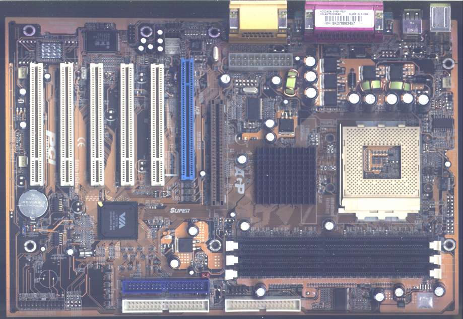

                      Check the temperature of the mosfets when the CPU is fully loaded. If they don't get very hot and there are no stability problems, I'd leave it as is.
                      See this PCPartner K333ASA-270 board - there are 5 mosfets in the CPU VRM. They're probably arranged as 2 phases somehow. And those 5 caps in a row are 4700uF so a total of 23500uF

                          Mustang; The only real benefit except cleaner vcore you get from using more MOSFETS is that the load on them naturally decreases so they will not become so damn hot, saving the life of the capacitors around them...
                          I've seen MOSFETS stay at 100°C on some less genious designs by Epox a few years back, loaded with CPU's that of course did not exisist when the boards where originally built...

                            That's basically why I'd like to add the 3rd phase. But as Rainbow suggests, I'll check the mosfet temps under load and if ok, will leave as is or pop in some higher rated caps.

                              That PC partner board has quite a different layout that most VRM's do. Usually there's a pair of FET's for each phase, one's the top FET, that's connected to the VRM input, and the bottom FET, which goes to ground, with the area in between being the part that goes to the toroid output filter. The top fet pulls the voltage up to the input VRM voltage, while the bottom FET pulls it down. Hence, by varying the duty cycle of the FET's, the output current can change while holding Vcore stable.
                              The reason i say it's weird is that the three FET's right by the ATX connector appear to be "top" FET's but they appear to be connected in parallel, so they'll just work as one big FET, not three individual ones, while the other two appear to be a pair of "bottom" FET's, one per phase, which are right by the two toroid inductors. Hence, it's more like a single phase VRM than a two phase one, just going by looks alone. You'd have to check between the 3 FETs by the ATX connector and verify if they're in parallel to see if that's true or not.
                              I have seen VRM's that have more bottom FET's than top FET's, since the bottom FET's get more of a workout, since Vcore is so low compared to the VRM input voltage, especially with +12V input VRM's being common now.
                                I know that it's weird design - that's why I posted it here.
                                I examined it when I had the board but I forgot it since I only have a more detail scan of the board, hopefully enough to read the marking on the VRM controller chip.

                                  Found out a few things. The Intersil HIP 6302 is a dual phase controller..so much for adding caps and a choke.
                                  3 caps by the VRM are 1500uf while the other 5 by the cpu are 2200uf. My fried ASUS A7N8X board is also dual phase but has 8 3300uf caps. Maybe go with that value.
                                  Running Prime95 so far no problems. Mosfets are just warm to touch but I did put heatsinks on them.

                                    THat's why the spot the 6302 is soldered to has some extra pads close by. The three channel PWM controller most likely has more pins, for the control of one or two more phases. I have seen some VRM controllers that support up to 4 phases, but they can be configured to operate less. I've got an Epox board i've been contemplating recapping for a while..
