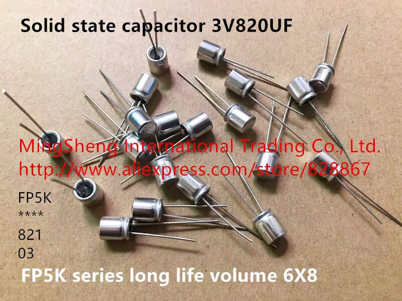

    Hey everyone
    So many things happend this year, and because of that - only place where i could buy caps is Aliexpress
    I won't consider buying electrolytics from ali(or if there is a good trusted seller, than i would buy), but i think polys will be good
    Are polys could be easily faked ? Especially FP12K Caps from Nichicon/Fujitsu(not FP5K, FP12K), their shrink is more chrome'ish compared to other caps, so maybe anyone knows anything about it?

      More important question to me - is it easy to fake FP, as I call them 'Golden' caps(attachment picture bellow), their sleeve is golden color, and as i mentioned higher, they aren't available for public, and only sold to vendors such as ASUS, Gigabyte etc.
      • Uranium-235
        Comrade Glimmer
        • Aug 2007
        • 5045
        • US
        Re: Fake polymers?
        Any cap with a metallic can I would imagine is harder to counterfeit, FP or not. In fact I just did a google search and could not find one warning about counterfeit polys.

              Here are few interesting ones
              Nichicon/Fujitsu FPCAP FP5K Golden for vendors
              https://aliexpress.com/item/32973706708.html
              Very interesting and rare one, no info on this one on the internet, didn't saw anyone else selling these - NCC OS-CON FX(Info from capacitor.web.fc2.com: Capacitors with sleeves that have "OS-CON" written on the familiar Nippon Chemi-Con pot logo are solid capacitors of the "Nippon Chemi-Con OS-CON" series, and the contents are SANYO's OS-CON itself. It is a SANYO OEM product (probably made by marcon. Looking for information), and it is currently treated as an old product.

                Re: Fake polymers?
                NIPPON CHEMI-CON Solid Electrolytic Capacitors (OS-CON)
                Series: FA, FH, FS, FP, FX, FRA)
                https://aliexpress.com/item/32762747693.html
                These capacitors might be original, however they are over 22 years old based on the date code on the packaging!

                  • 31278
                  Re: Fake polymers?
                  the black caps in the first link look recovered from unsold product, they have signs of solder on the pins
                  try to avoid anybody selling caps with short legs
