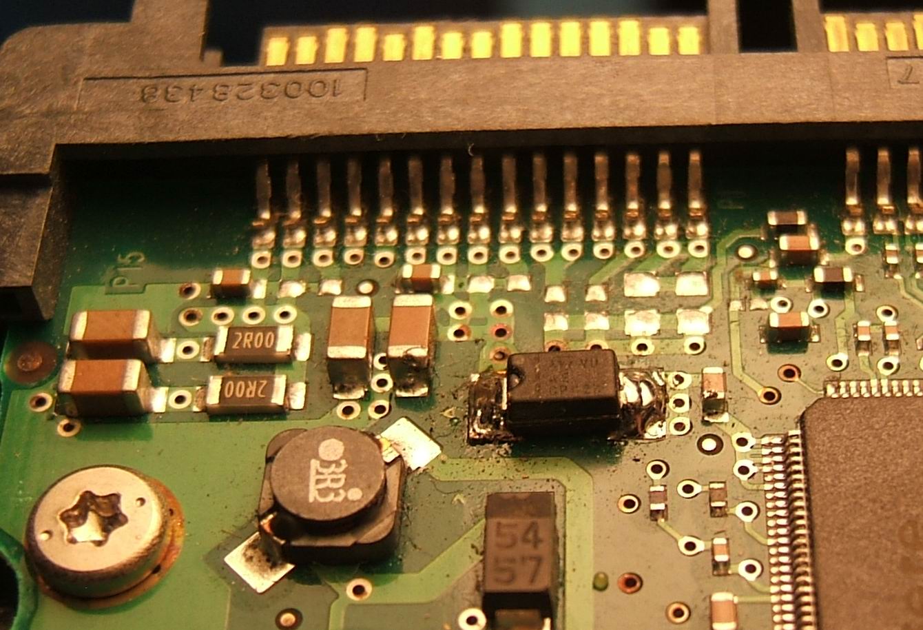

    I have 4 drives in a Raid5 array, the last two drives were smoking!
    immediatly disconnect power and examine drives.
    Both drives have the same component fried on PCB (right by sata power connector) but i have no idea what this is, my first guess i would say some sort of fuse because its right off the power lead (i think the 12v ) and it basiclly broken in two, i dont see any other signs of damage but who knows...
    its black rectangular, has a logo "ST" a space then an "E"
    below that has BUX and below that says C705 or C750
    the question of the day (for me anyway) is that once that is component is identified do you think replacing it would allow me to at least power the drive up to clone it in hopes of saving some data.

        It will be easier when you post pics
        But most likely it is a power mosfet, harddrives are very sensitive for both under and overvoltage
        If you are lucky it will be enough to replace it

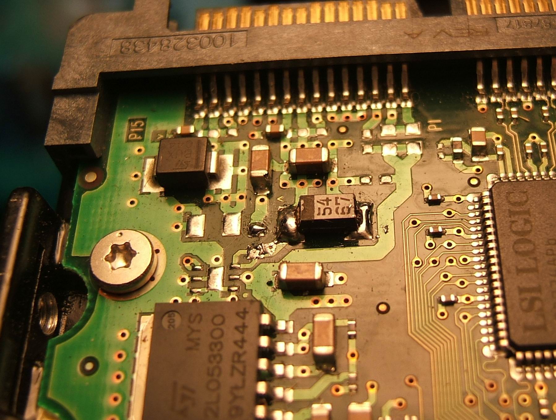

            Here is a pic of one drive, wont bother with rest until i get the higher res. camera

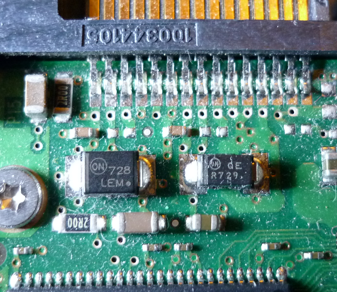

                  Here's mine in case it is any use to you, same model, same firmware. Site code: TK.
                  I believe it is a TVS diode, once replaced hopefully all will be OK!
                  You can see from the dust that it's been sat, upturned on my desk for quite some time. Lots of bad sectors, it'll go off for RMA after I've moved.

                      Hi, that does indeed look like a fuse
                      Please post better pics and we might be able to figure it out

                          BUX is a SMT diode. When I ran out of scrap boards with BUX on them I started replacing them with any SMT diode from any brand hard drive that was the same look and dimensions. They all work fine.
                          Most drives will come back to life when you throw some BUX at them.
                          Antec SmartPower should be inspected every 6 months. If that's too much trouble they should be recapped or replaced with something that doesn't break down.
                          Here's a couple of successful repairs. On one a BUX was replaced with an AE which is a little narrower. Another didn't blow at the BUX but a little farther in.

                            those are a tvs.
                            you can just remove them to test.
                            but use a known good psu!

                              Yes, that is it! thank you for the pictures!! (iphone 3g camera sucks) I found out the drives are still covered under warranty, im afraid by removing or replacing that part would invalidate the warranty.
