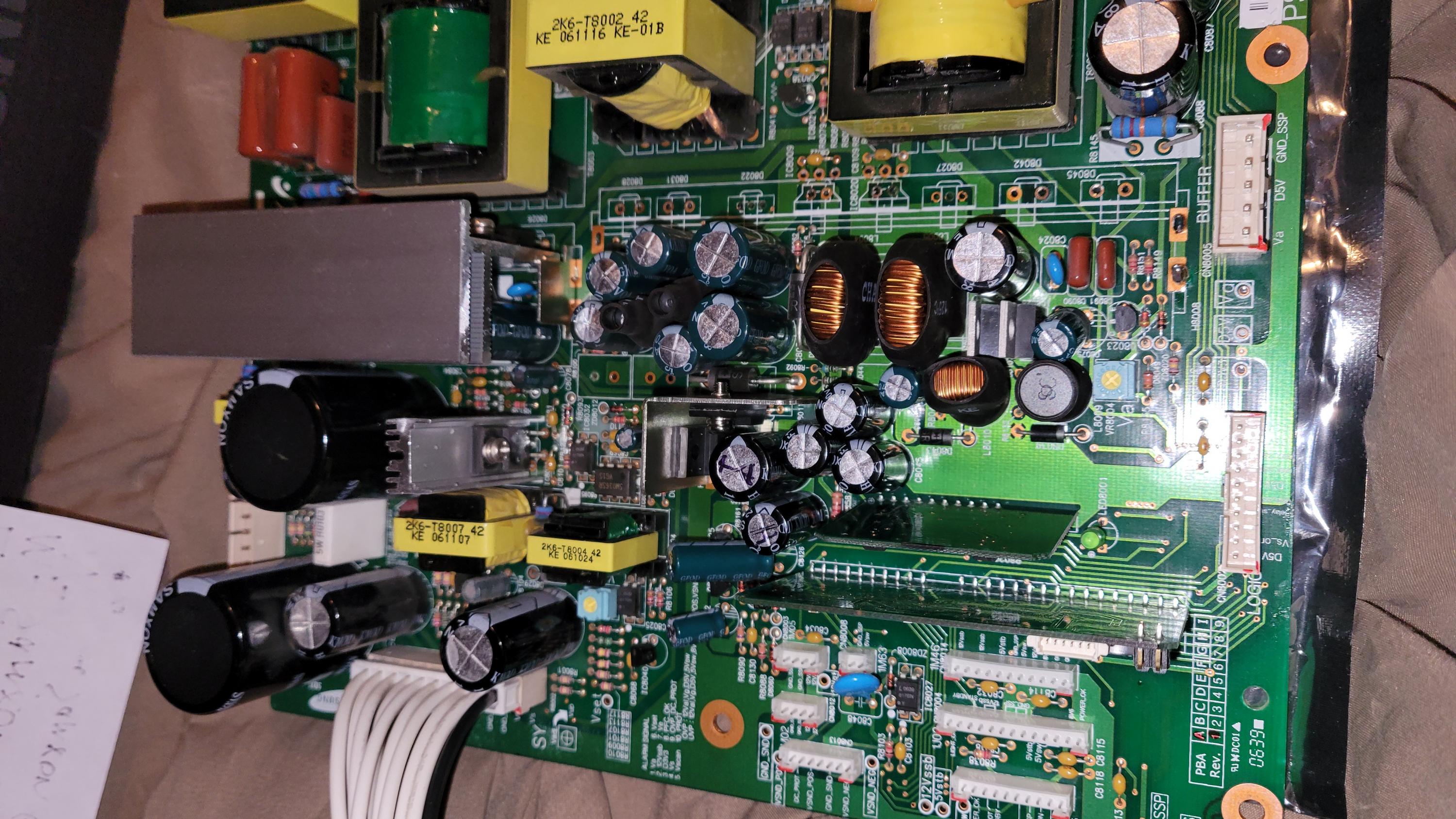

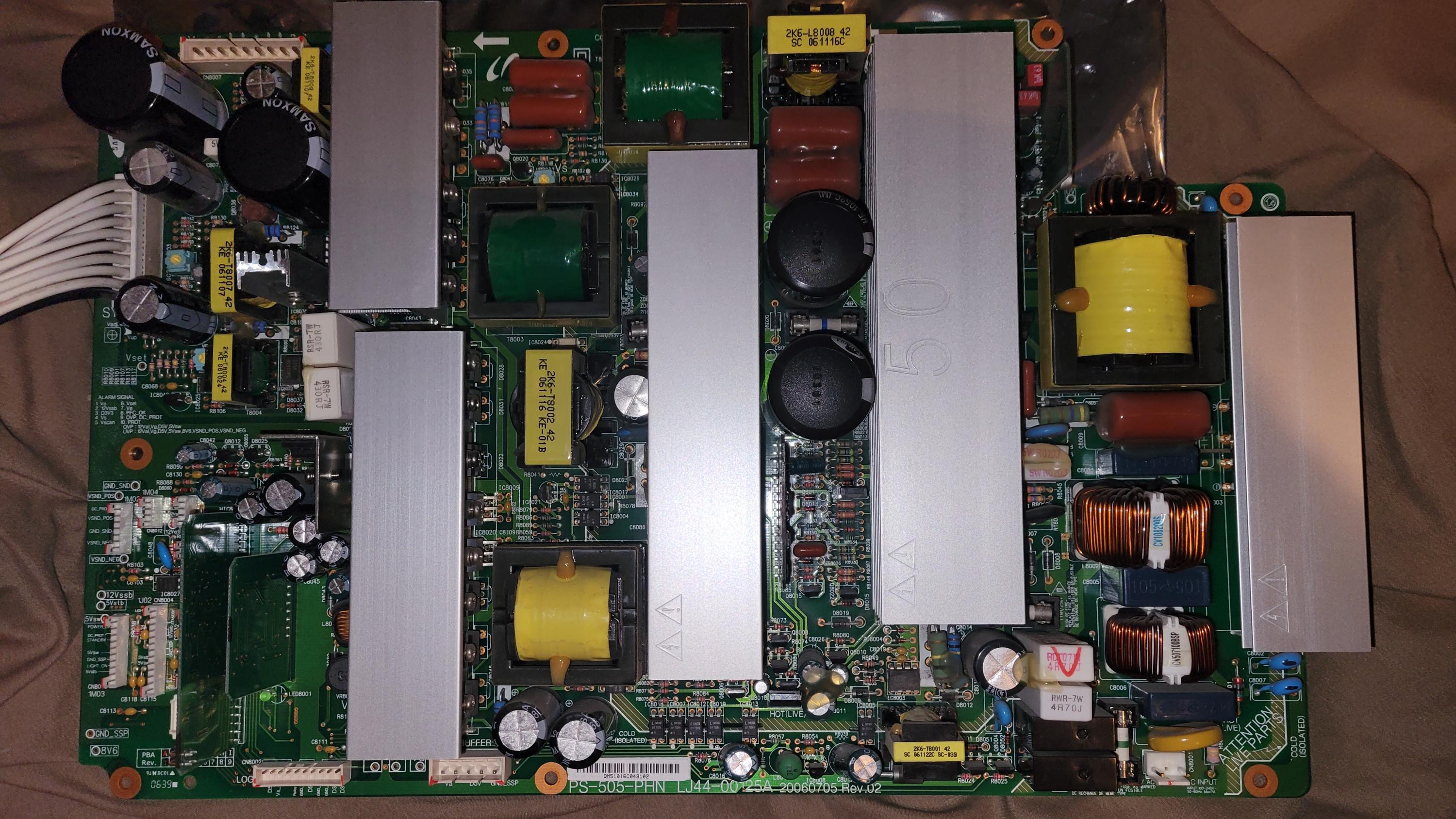

    Need replacements for Samxon HP
    I've been looking through all the best brands (rubycon, nichicon, UCC) with little success (edit, I mean I find them out of stock, or only stocked in other countries). Is there a mid-range brand for these
    Must be:
    315v-400v
    470uf (560 maybe)
    1.7ARMS
    30mm diameter max
    40mm height max
    Mid-range caps are fine and you guys are up to date on other brands
    for: Plasma TV main power board
    I know some are bloated and I plan to replace as many as I can

              You're not going to find a cheap capacitor with the ratings you specify unless you look on the used market.
              The ones I linked are all fine, the 85°C version would be no problem unless the designer of that TV was really stupid.
              Here is a list from Digikey, very similar: https://www.digikey.com/en/products/...ACeLCpq1JKCdQA
              EDIT: Well, after looking at the Samxon datasheet it looks like they should be 35mm wide, unless this was a custom order.
              If so there are allot more choices.
              That said bulk filtering caps rarely fail, so if you want to cheap out you could just leave them alone.
              I would check in-circuit ESR and capacitance though to make sure it is in the ballpark.

                  Took the whole VRM FETS off. Huge pain in the ass. Some traces unglued a bit but they're still on

                              This is about as close as I can find:
                              https://www.digikey.com/en/products/...71MELB/2540761
                              https://www.digikey.com/en/products/...MELB40/2540156
                              ^ Both are 470 uF caps in 30 mm dia., but one is rated for 315V and the other for 400V. Height for both is 42 mm... which is the smallest you can get. Do you really absolutely must keep the height below 40 mm? With the case close on the plasma, is there really no more space / height inside? Otherwise, if you can go up to 47 or even 52 mm, that opens up even more choices, like these:
                              https://www.digikey.com/en/products/...MELB45/2540435
                              https://www.digikey.com/en/products/...MELB45/3929841
                              And yeah... I know you said mid-grade, since you probably want to keep the costs lower... but that's the unfortunate part about plasma TVs - they really do need quality caps if you don't want to do this repair again. And also, mid-grade caps aren't much cheaper - at least not on Digikey. I'll try to check eBay for you tomorrow. I know I have bookmarked a few sellers that actually had good quality caps for relatively cheap. Just don't remember if they had HV units.
                              BTW, maybe another (possibly cheaper) option would be to look for used Panasonic Viera / plasma TV boards online and just take the caps from that?

                                Height isn't a restriction here. But only the LGU and LGX have the equivalent ripple (1.7)
                                I did search 400v, not sure why those didn't come up on dgk
