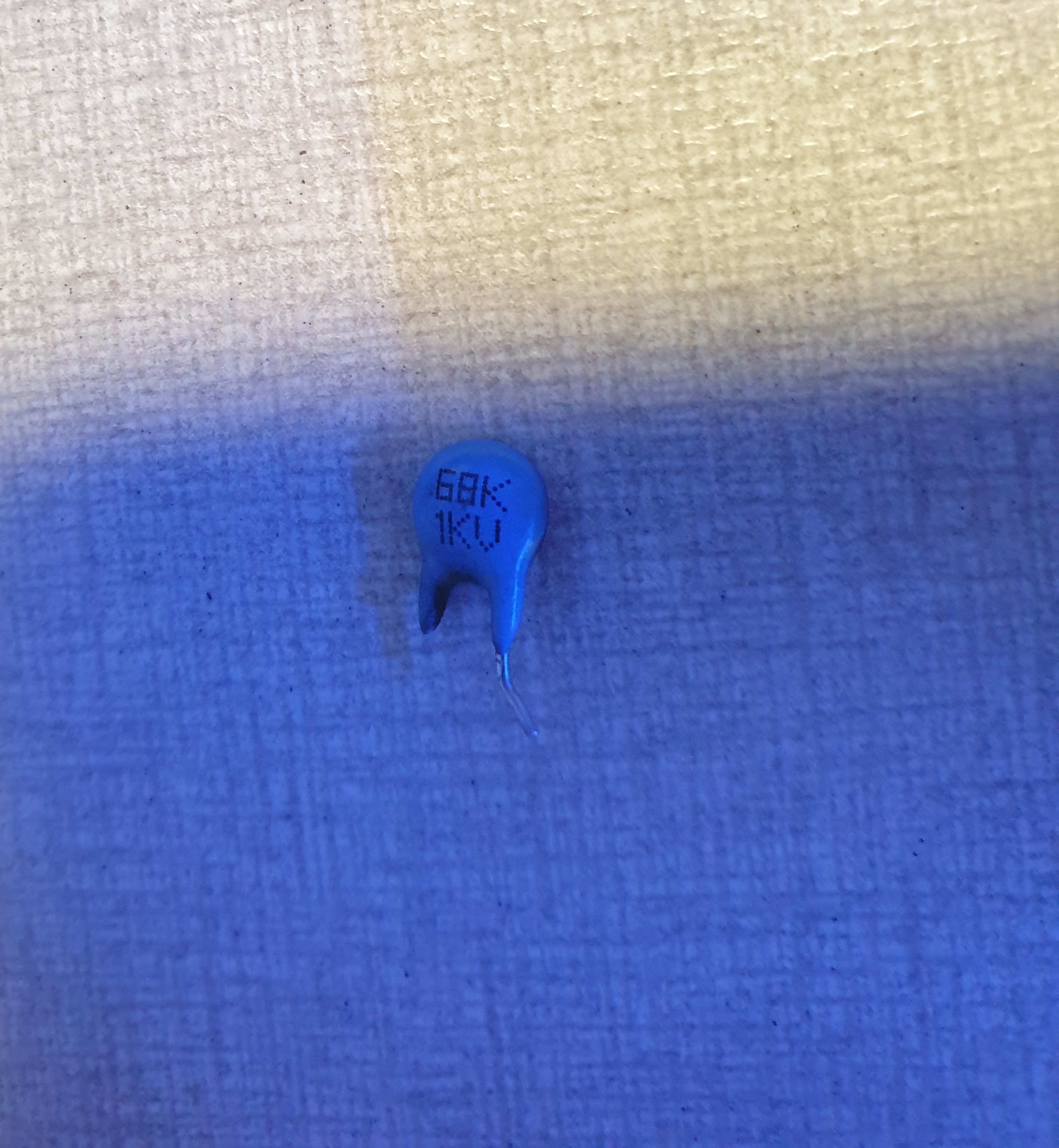

Ceramic capacitor from Samsung monitor 68K 1KV
  • Bartoloni
    • Jul 2018
    • 140
    • Italy
    sorry but this 68K is causing me some confusion... (image uploaded)
    is the K the 10% tollerance?
    is 68K just 68 pico? (i have some 101 replacement 3KV.. maybe i can use those)
  • R_J
    • Jun 2012
    • 9624
    Re: Ceramic capacitor from Samsung monitor 68K 1KV
    It depends on the circuit, but if this is just a snubber cap, 100pf should be ok to replace the 68pf
    The K should be 10% tolerance
