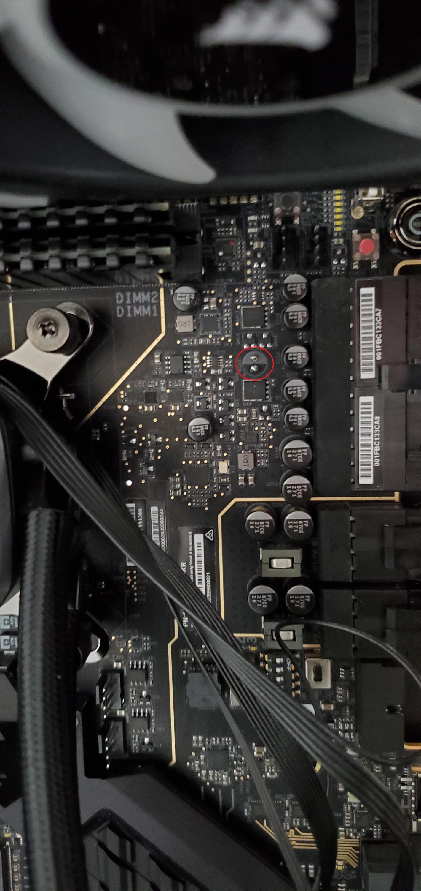

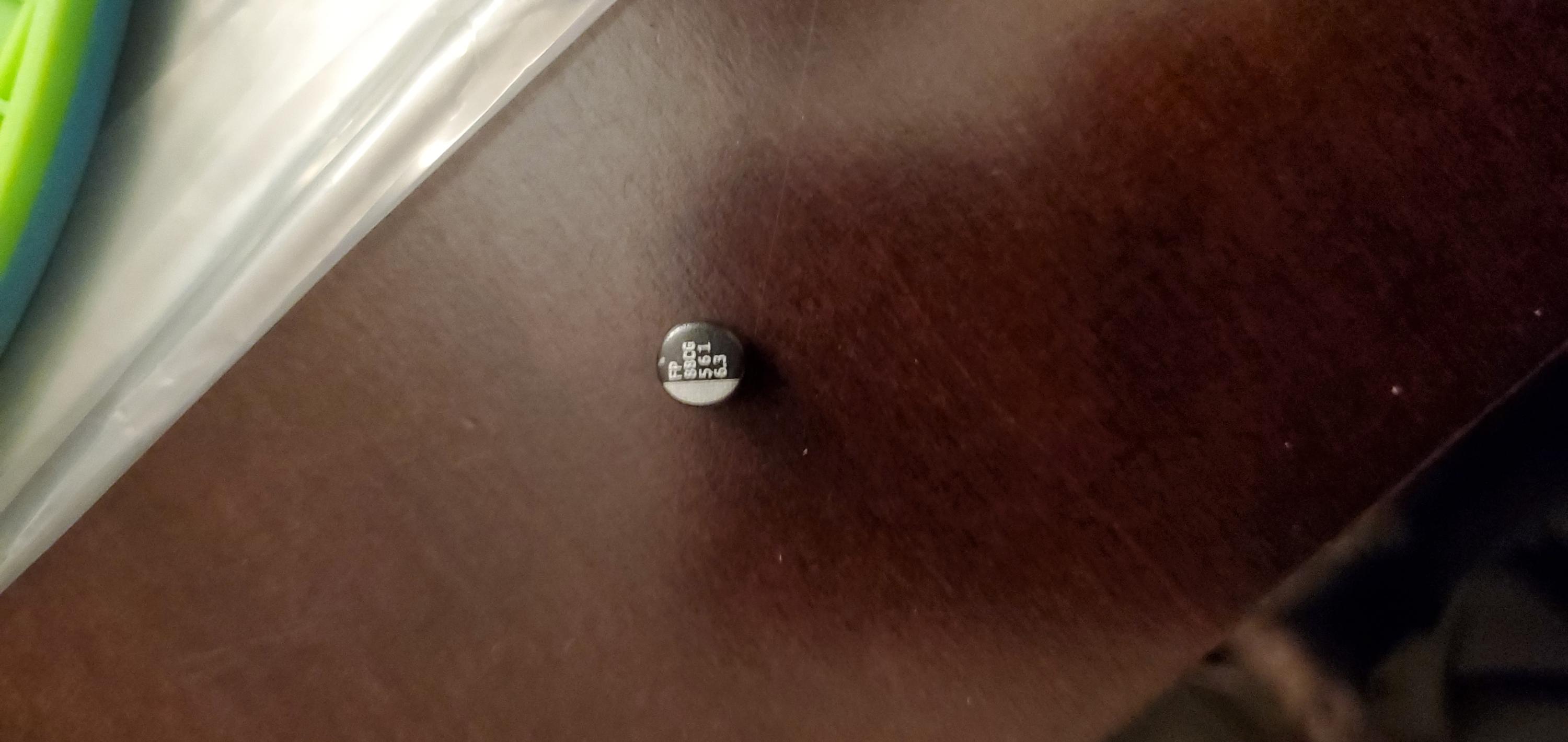

    Help! Need to replace capacitor on expensive motherboard.
    I recently found a broken/missing capacitor on my EVGA Z390 motherboard. After contacting EVGA they were not able to provide repair/warranty service or information on the part I need to do the repair myself. Can anyone identify this capacitor and where I can buy a replacement? The cap has the following markings:

    Re: Help! Need to replace capacitor on expensive motherboard.
    560uf 6.3v polymer
    you need to check the diameter yourself - probably 8mm
    and check the pitch between the pins - probably 2.5mm
      Just measured:
      6mm diameter
      2.5mm distance between pins
      Any idea where I can find/purchase a replacement?
          look in the FAQ subforum under the thread Where can I buy replacement capacitors?
          make sure u buy the right size as the original! watch the diameter, height and lead spacing as well as lead thickness or width! or else it wont fit on the board!! look for nichicon fpcap 560uF 6.3v. that the same brand and series as what the original is. tho u can get panasonic oscon sepc or chemicon npcap polymers as well.
