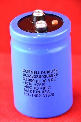

    How high does plunger come up if bad? Cornell Dubilier 23000UF
    How high do the brown plungers come up to let you know they are end of service life?

    A centimeters maybe, imagine the volume ratio, perhaps there is already some atmospheric air inside during the manufacturing process.
    Yours one looks normal

      The "plunger" is not really an indicator of end-of-life, it's just the vent valve and yours look perfectly normal - sticking out above the top cover.
      I've had some Mallory parts shrink (in) and others stay sticking out, due to the material but that is black or grey rubber.
      I think newer CDE parts are plastic/polymer and not affected so much by moisture.
      These are high quality capacitors and I would not replace them out of superstition or emotion, as some do in the Hafler amplifiers.

        Hi! According to this white paper document the bung is exactly an indicator showing end of life of a capacitor (provided it doesn't fail to do its job), which I had not known until reading this. It states that the bung will come up with pressure as it reaches end of life. Not much on the net really about this at all. However, these aren't terribly expensive at all to replace, if needed. I did message CDE about this as well to see what they say.
        I did do an image search on google to try and compare bung lengths for people selling and what not, what I found was all different results, some completely flush, some recessed and some out as far as mine, and some further. Quite interesting.
        The only issue I see on their site is I cannot find any 85vdc caps to replace them with, they seem to only go from 75 to 100.

          I totally understand what you mean, I was just thinking, these are from 2001 or so, and they are only about $40 each, to replace with new from CDE, so maybe worth just doing. I should really just measure them with a multi, but still, just as easy to replace them for longevity?

            They look fine, unless you just want to blow some $ for nothing leave them alone.

                it's a seal, if the cap tries to vent the seal will blow off.
                dont replace it.

                  20 years isn't that much for large can electrolytic caps. Unlike smaller electrolytic caps with rubber bungs and non-snap-in leads, these do tend to last longer due to better seal.
                  I say if you don't suspect these caps were abused in any (high temperature extremes, especially heat, for long periods of time in operation or many complete consecutive charge and discharge cycles), then just leave them alone. Also, that vent shouldn't be used as an indicator for end of life. Rather, check the datasheet and see if lists an endurance rating. From there, and given the operating temperature and other conditions, you may be able to roughly estimate how close the cap may be getting to end of life. But then again, 20 years for such large caps isn't that much. A good quality large can cap could probably last twice that... or if not, at least a solid 30 years.

                    CDE got back to me and said the plunger will go as high as the terminals if it were to vent, so it's nowhere near that.
