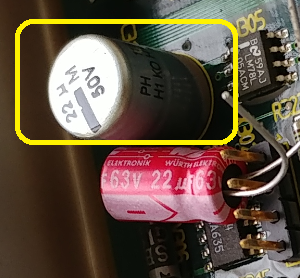

    Hello guys,
    can you explain me what type of caps is the one shown in the attached picture. Is is different from so called classical one. I have taken a photo of these caps next to each other. The data written on the cap is 22 uF, 50V, PH, 116, H1 KO H1.
    On many motherboards there are different types of electrolytic caps. These look more robust (probably aluminium capacitor).
    Do they have some special purpose?
    I have one 22 uF, 50V so called robust cap and other "classical", the same capacity and 63V, but smaller dimensions.

    At first I thought your cap was very similar to this one I posted about here:
    https://www.badcaps.net/forum/showthread.php?p=257252
    I may be wrong though, and if so it is probably a solid polymer aluminium capacitor.
    Basically they do not have any wet electrolyte and hence have much higher rated ripple current and a much longer life.

      Thank you Per, based on your suggested keywords, I was able to find a very good explanation:
      https://www.gigabyte.com/microsite/1...hyusesolid.htm
      This motherboard manufacturer has so called "ultra durable" motherboards with this type of caps.
      My dilemma is whether to replace solid aluminium cap with a classical one. I have an electronics card about 20 years old (PLC input card) which works most of the time but suddenly stop behaving as expected. After Power OFF/ON it works for another period of time. I was thinking to try to preventively replace the caps.

        In that case I think my first link above might be correct.
        I.e. that a Rubycon ZL or similar would be a good replacement.
