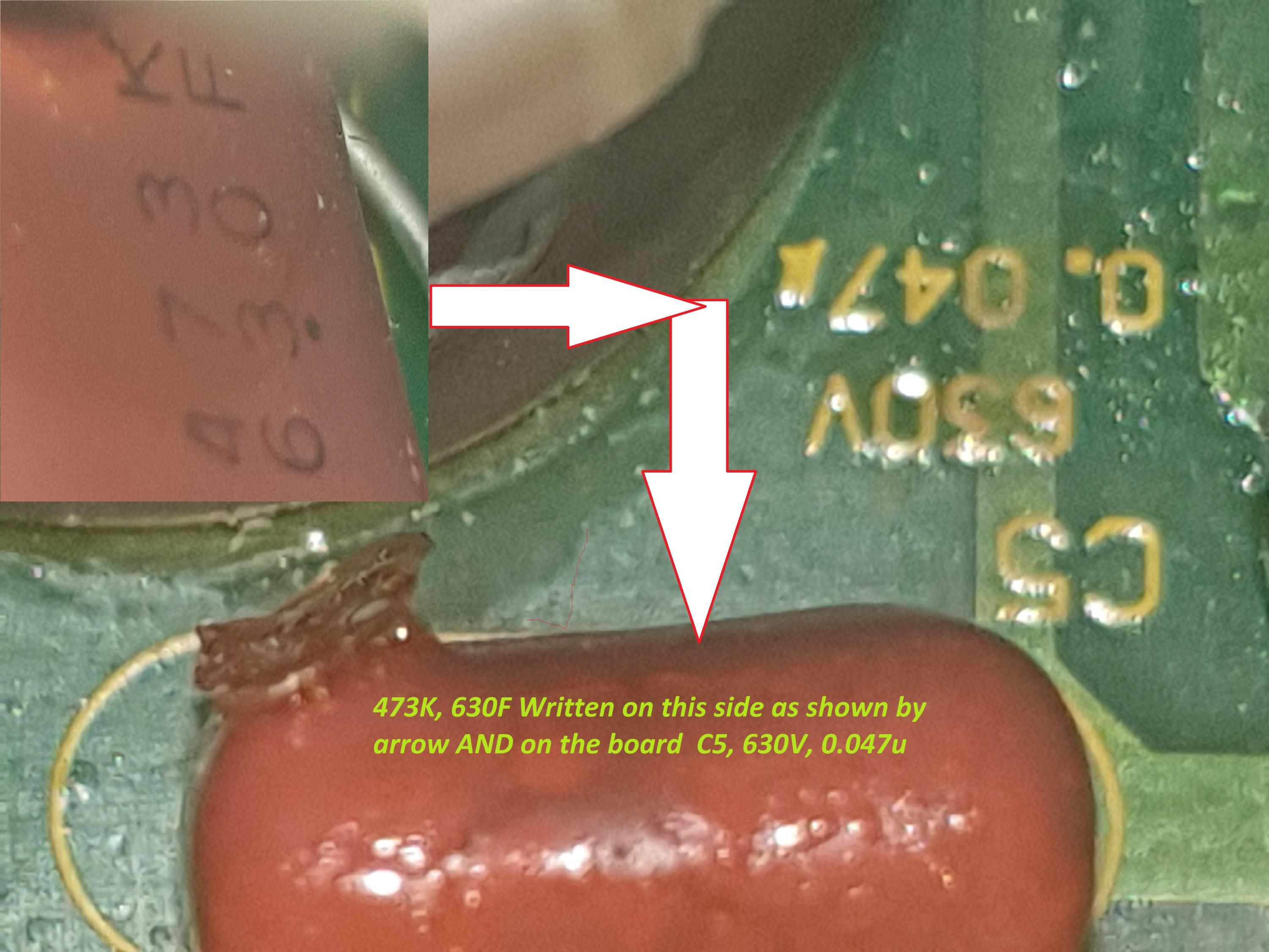

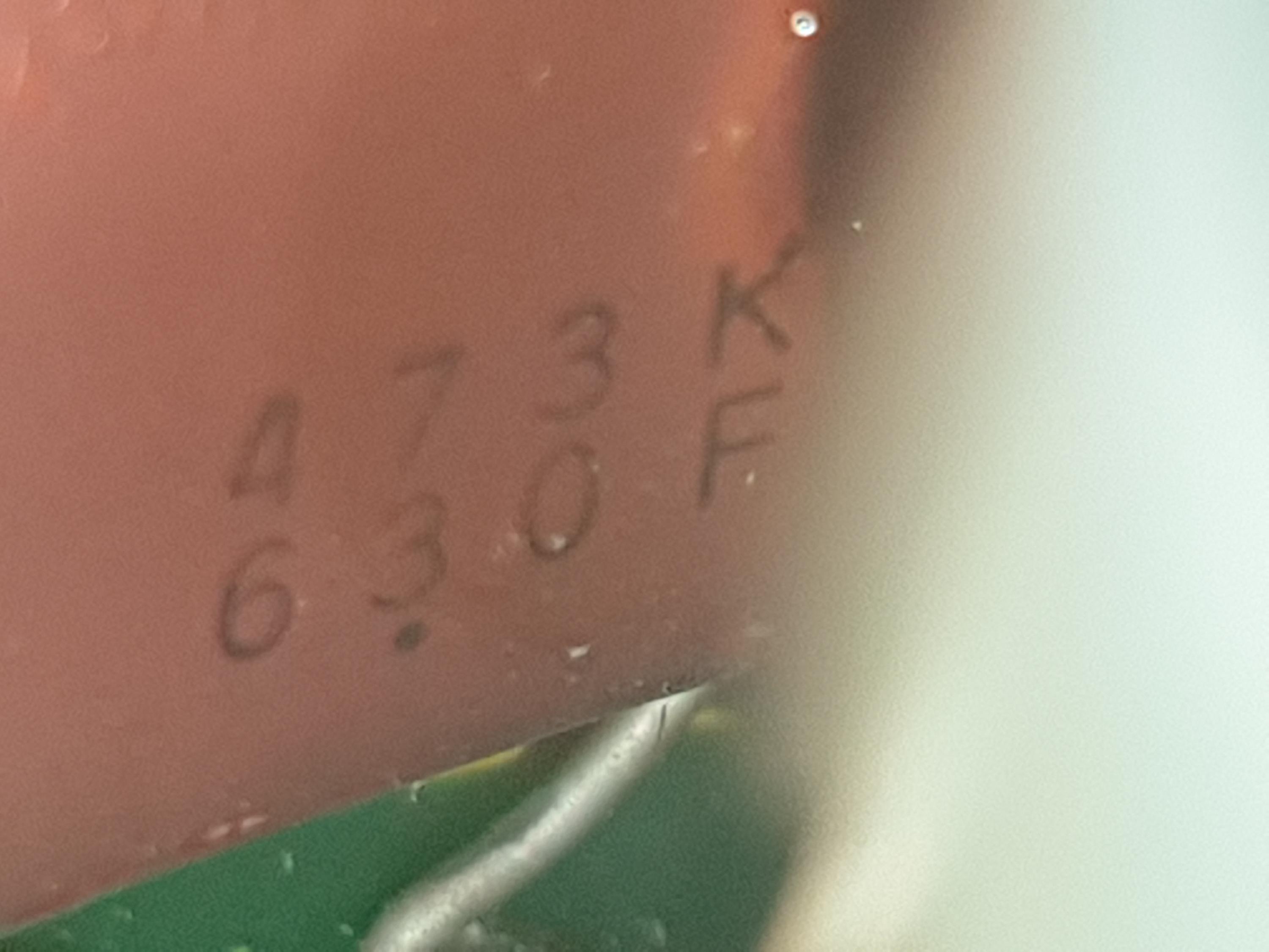

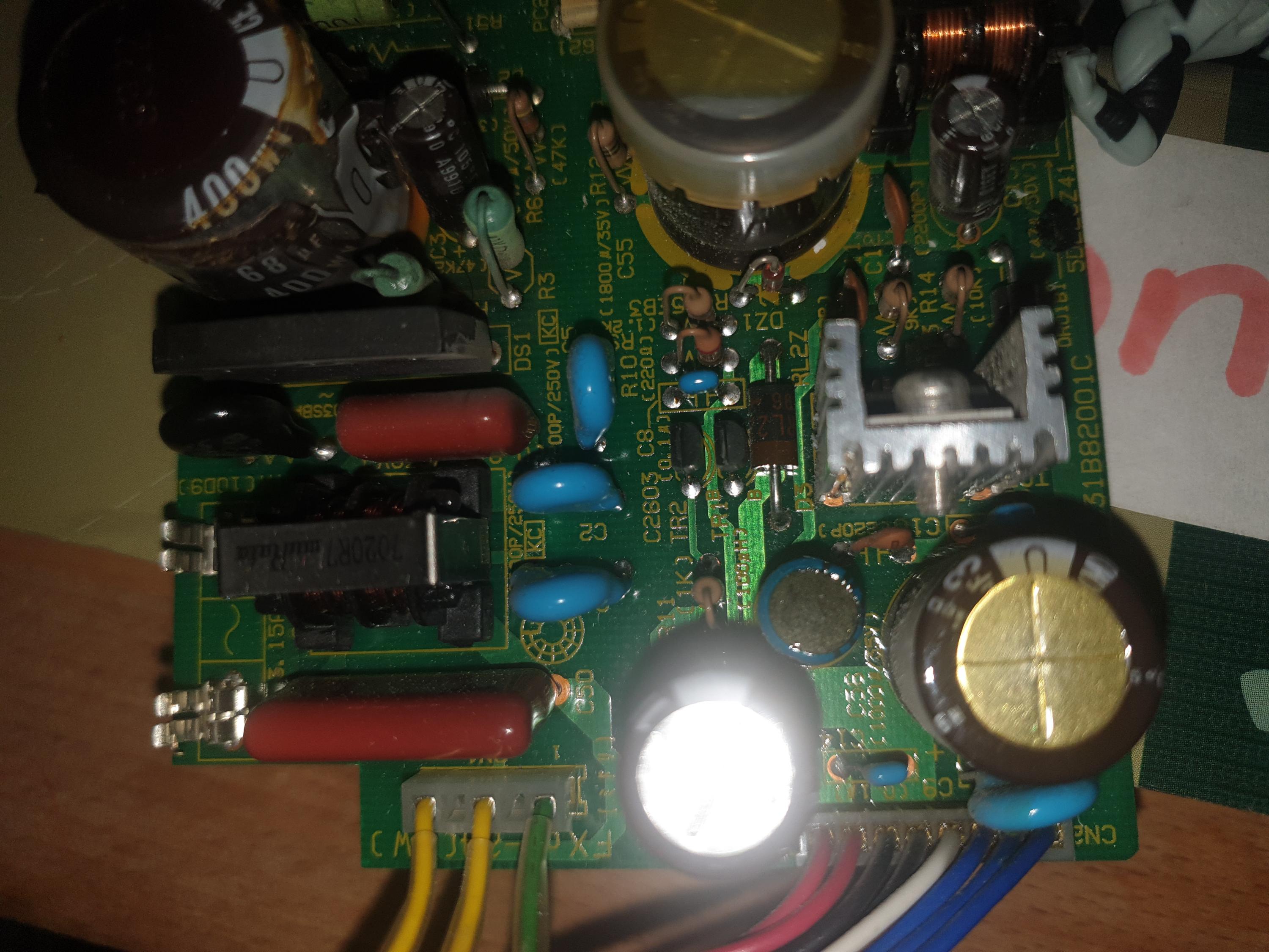

    I need help identifying this Cap
    Im trying to replace this capacitor <<<630V, 0.047u , rectangular shape >>>>
    will this be an ideal replacement
    KEMET RC Capacitor 47nF 47Ω Tolerance ±20% 250 V ac, 630 V dc 1-way Through Hole PMR209 Series
    RS Stock No. 209-213
    Mfr. Part No. PMR209MB5470M047R30
    Brand KEMET
    from rs.uk.online,com - https://uk.rs-online.com/web/p/rc-ne...itors/0209213/

    Re: Help identifying this Cap - 630V, 0.047u
    the part at RS is NOT a cap, it's a filter with a built-in resistor.
    you need something like this:
    https://uk.rs-online.com/web/p/polye...itors/1719150/

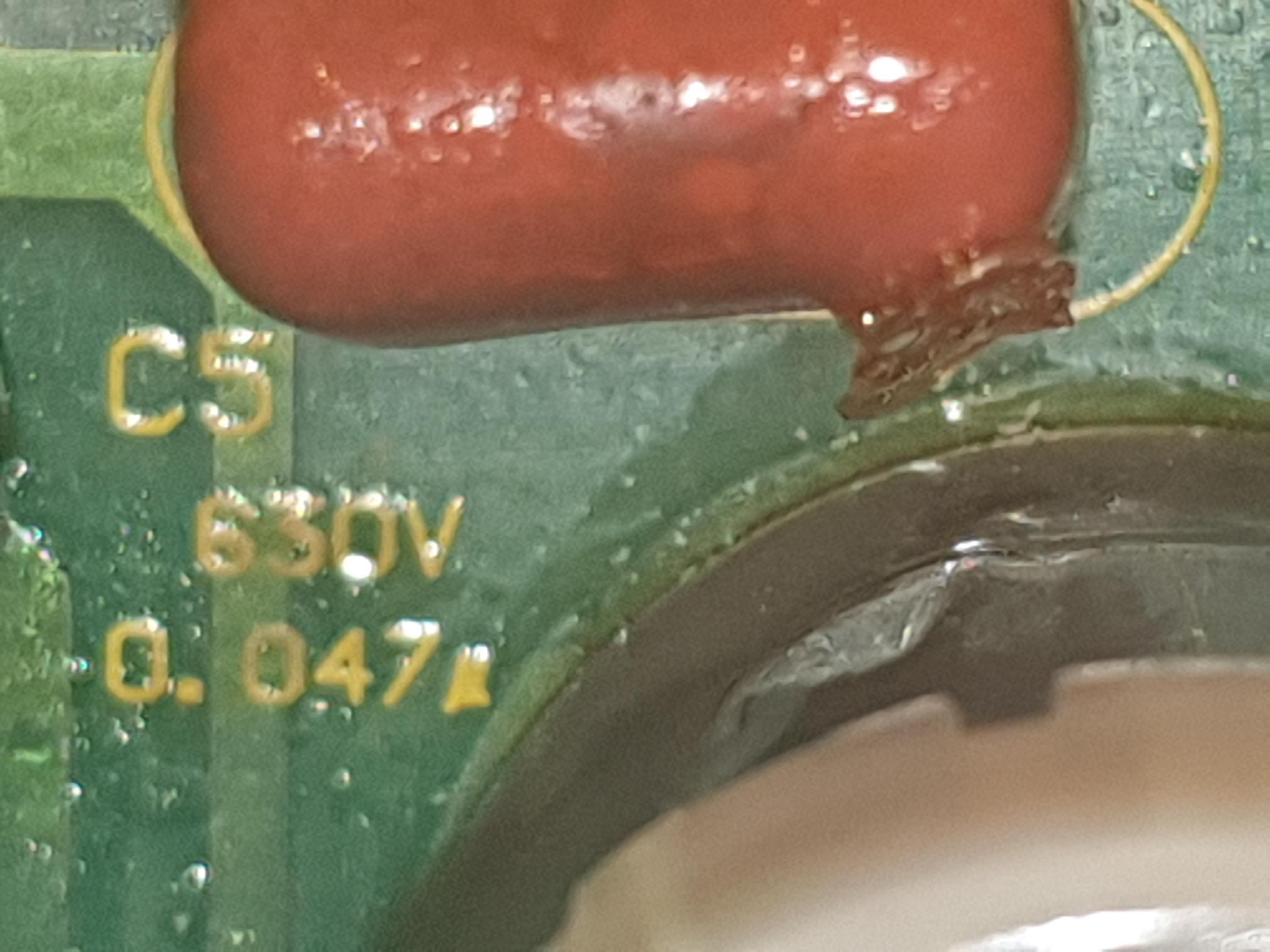

      Thanks for your reply

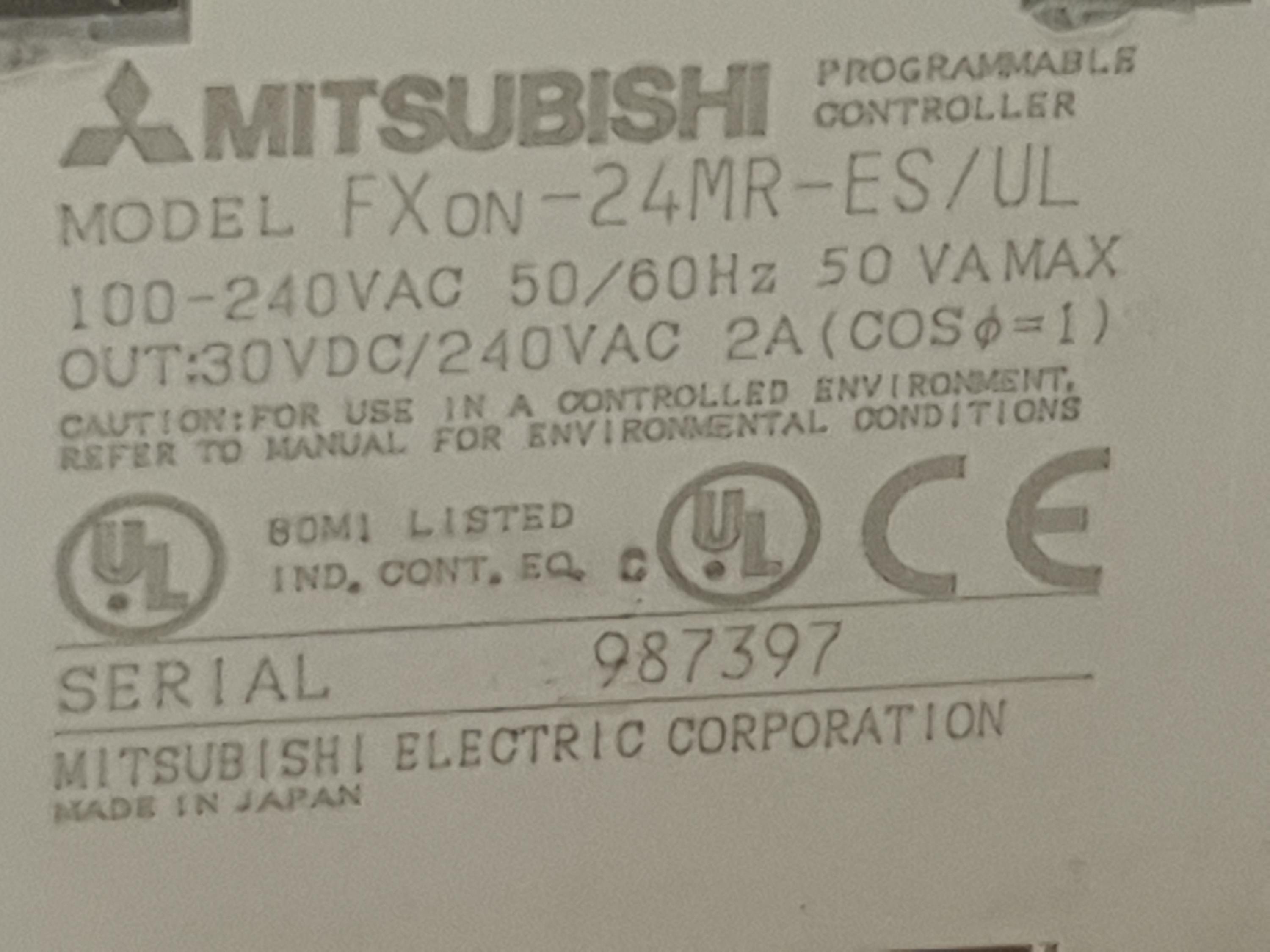

      its part of a controller circuit and shown in attachment
      and this https://uk.rs-online.com/web/p/polye...itors/1719150/ - <<< KEMET 47nF Polyester Capacitor PET 220 V ac, 630 V dc ±10%, Through Hole>>>
      is rated for only 220VAC
      will this work for me.... ?

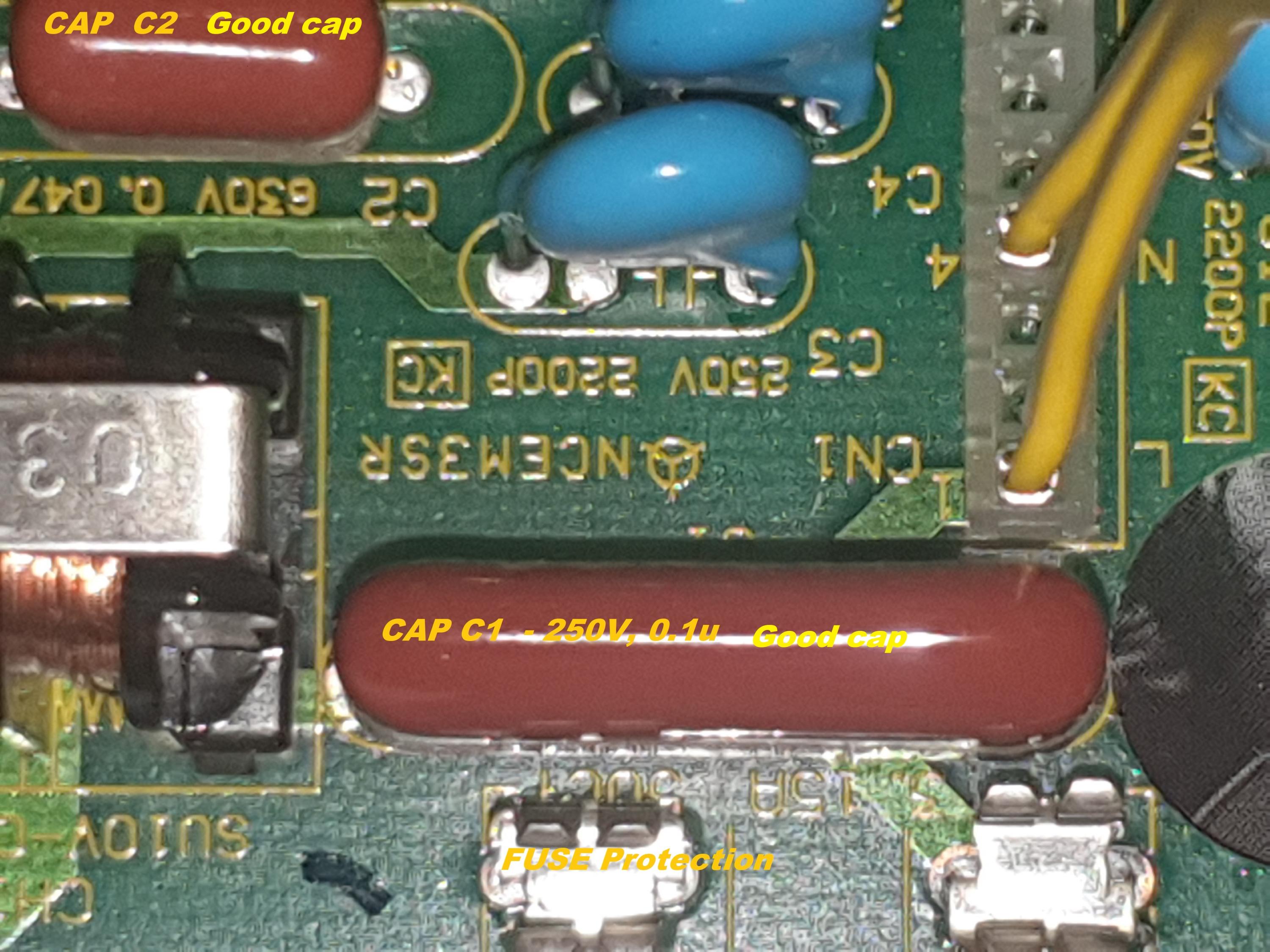

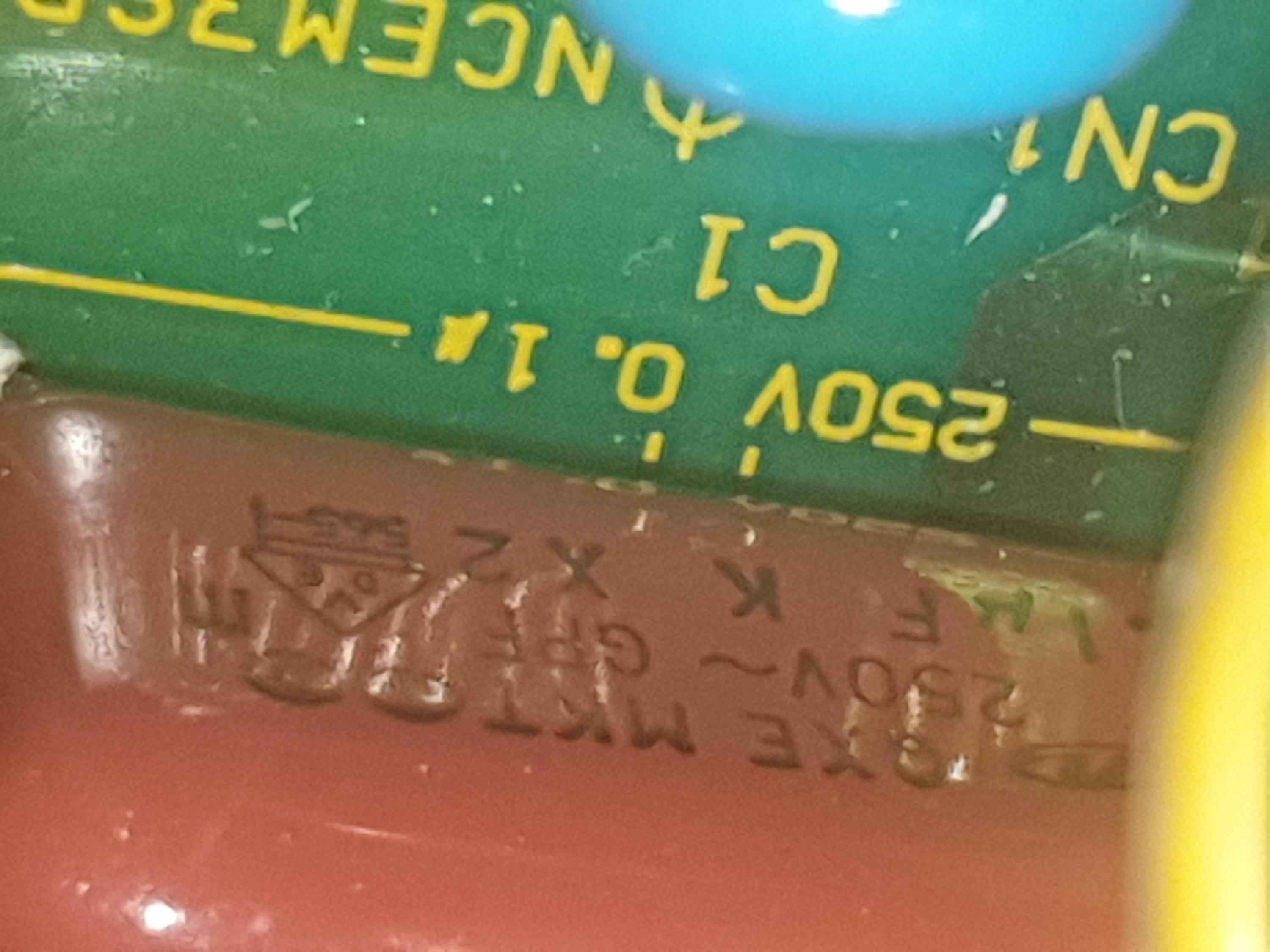

        is it connected between the L & N mains input?
        because if it is then it needs to be an X2 rated device
          Im sorry , im not sure answer to your question
          but find here attached the casing for the circuit with output of 30VDC/240VAC, 2A (COS@=1)
            • 31289

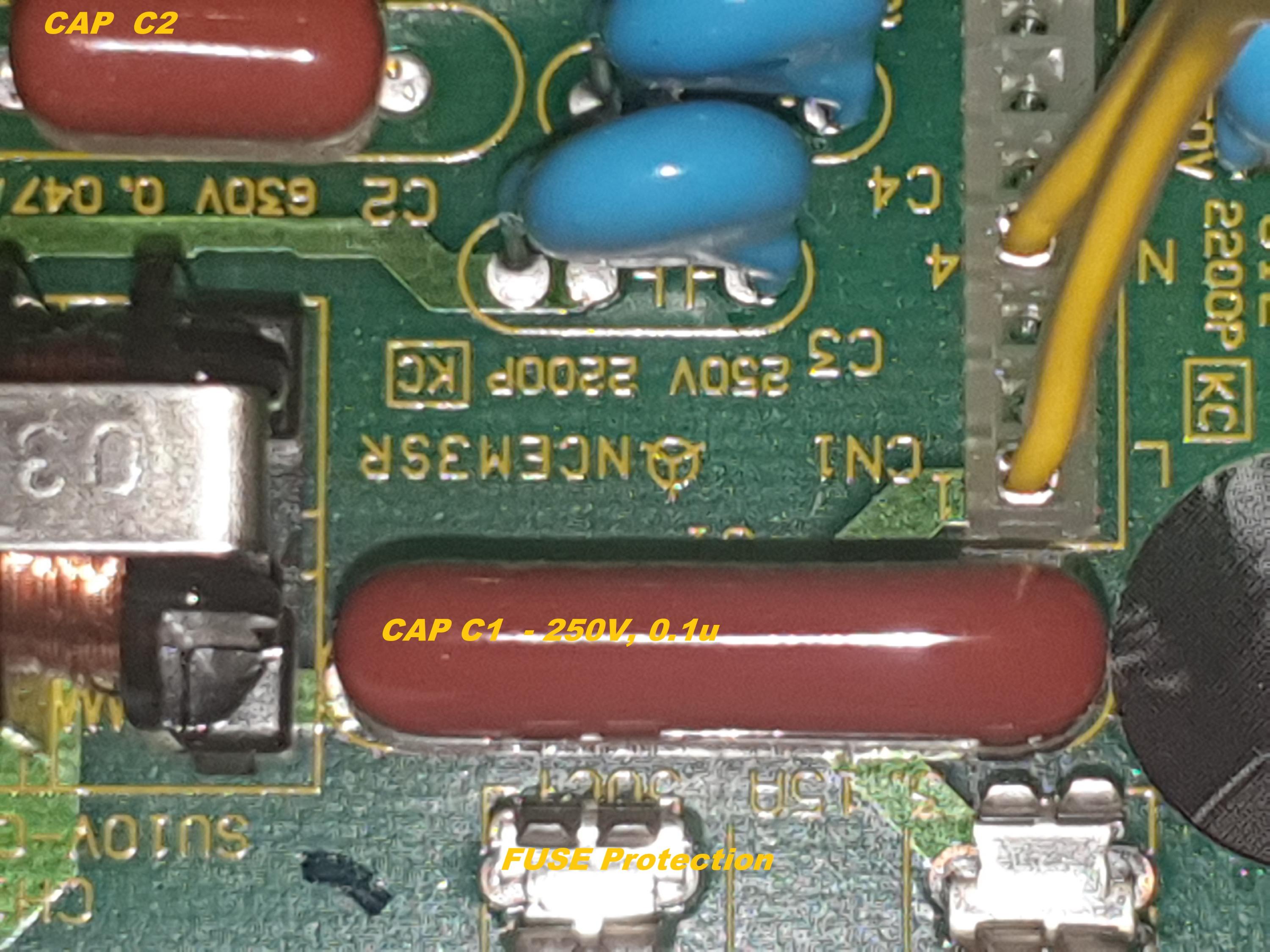

            that looks like it's on the DC side so it's getting about 345v - no problem as it's rated for 650v
            to be sure, can you post a photo of the other side of the board.
            and what is the distance between the 2 pins?
              Lets see good clear straight shots for the whole top and bottom side of the board so we can figure out the function of that cap.
              Is it tested bad?
              What is the board not doing?

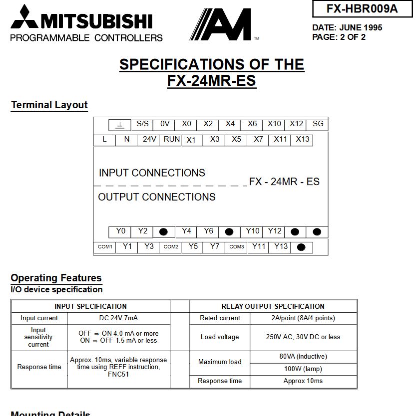

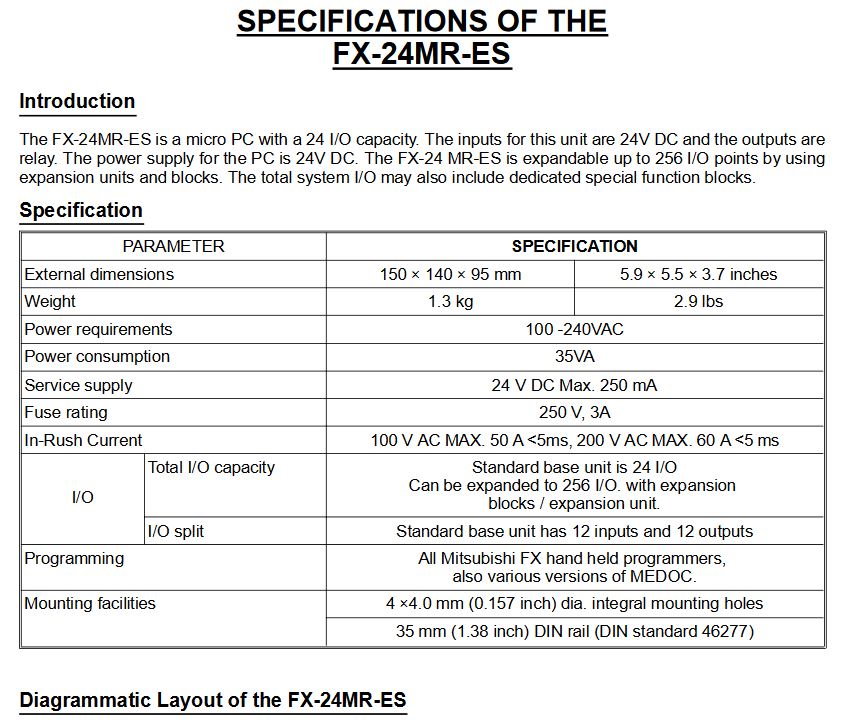

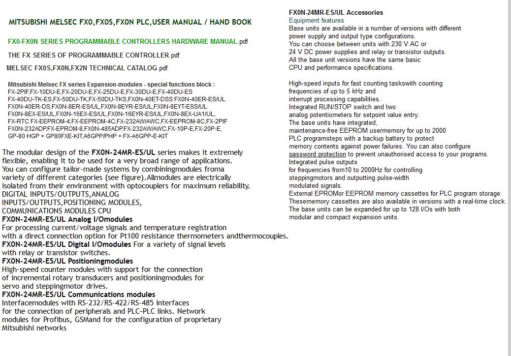

                    I found this online, hope it helps -
                    and this for a later version -<<<FXON-40ER-ES/UL datasheet.>>>
                    FOUND MORE info online -
                    http://www.inverter-plc.com/plc/FX0_...4MR-ES-UL.html
                    https://cdn.badcaps-static.com/pdfs/...cb24b567af.pdf
                    Many Thanks

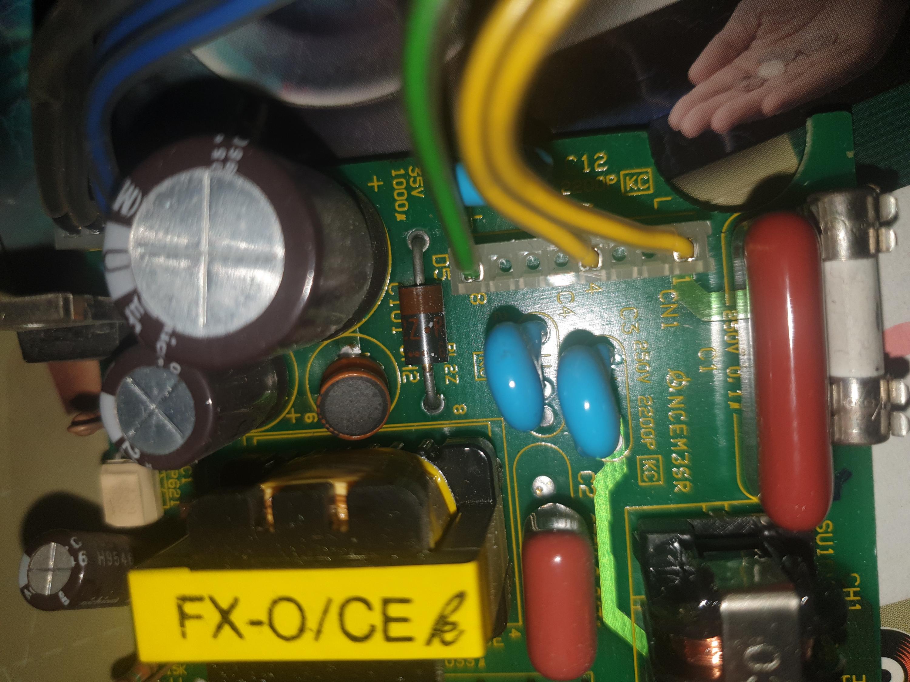

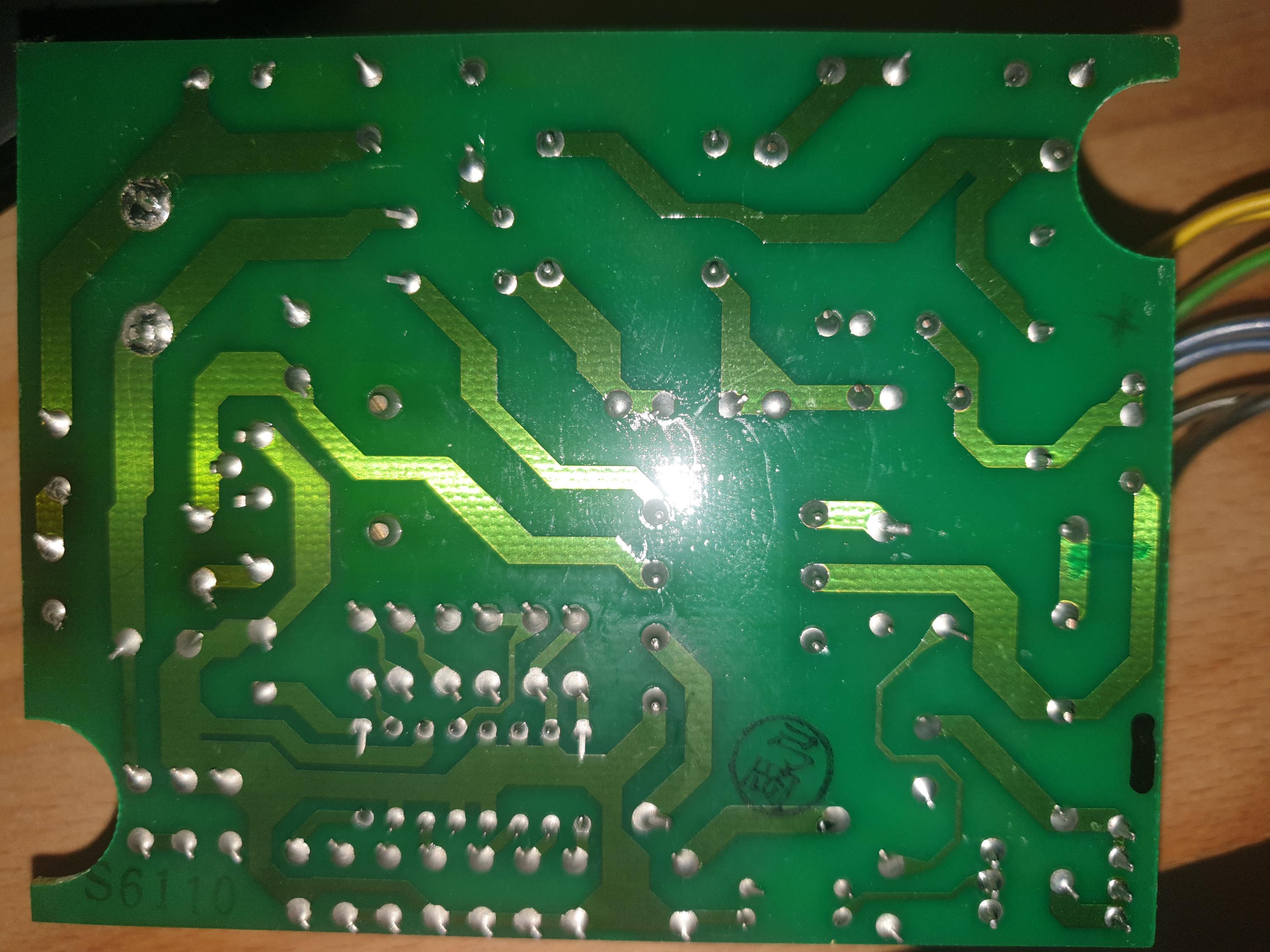

                      https://www.badcaps.net/forum/attach...4&d=1591746782
                      That is not the pictures of the bottom side of the board where C5 in question.
                      The board in question has two rectangular cutout on two corners: https://www.badcaps.net/forum/attach...9&d=1591744711
                      And again, what is wrong with the board?

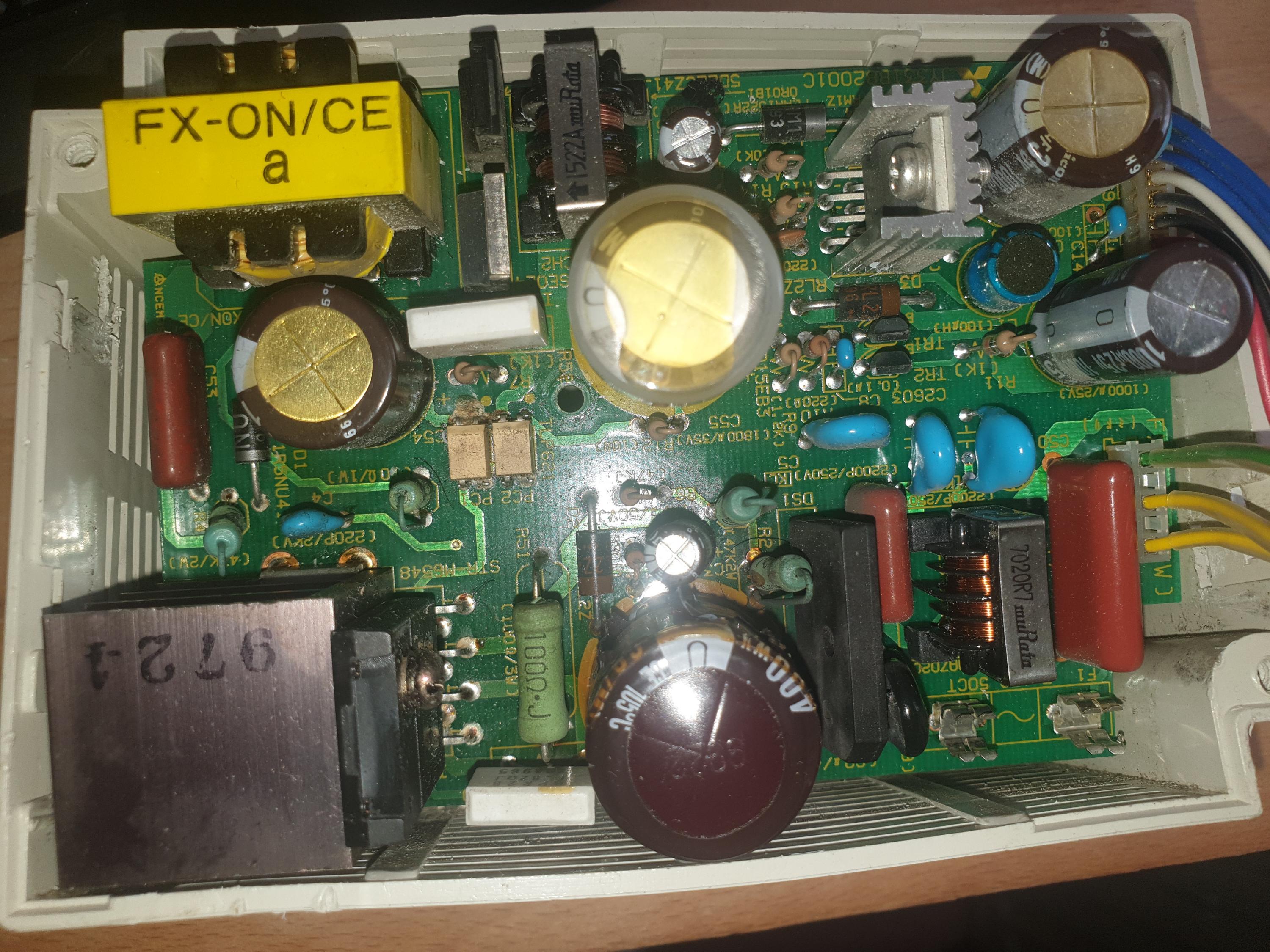

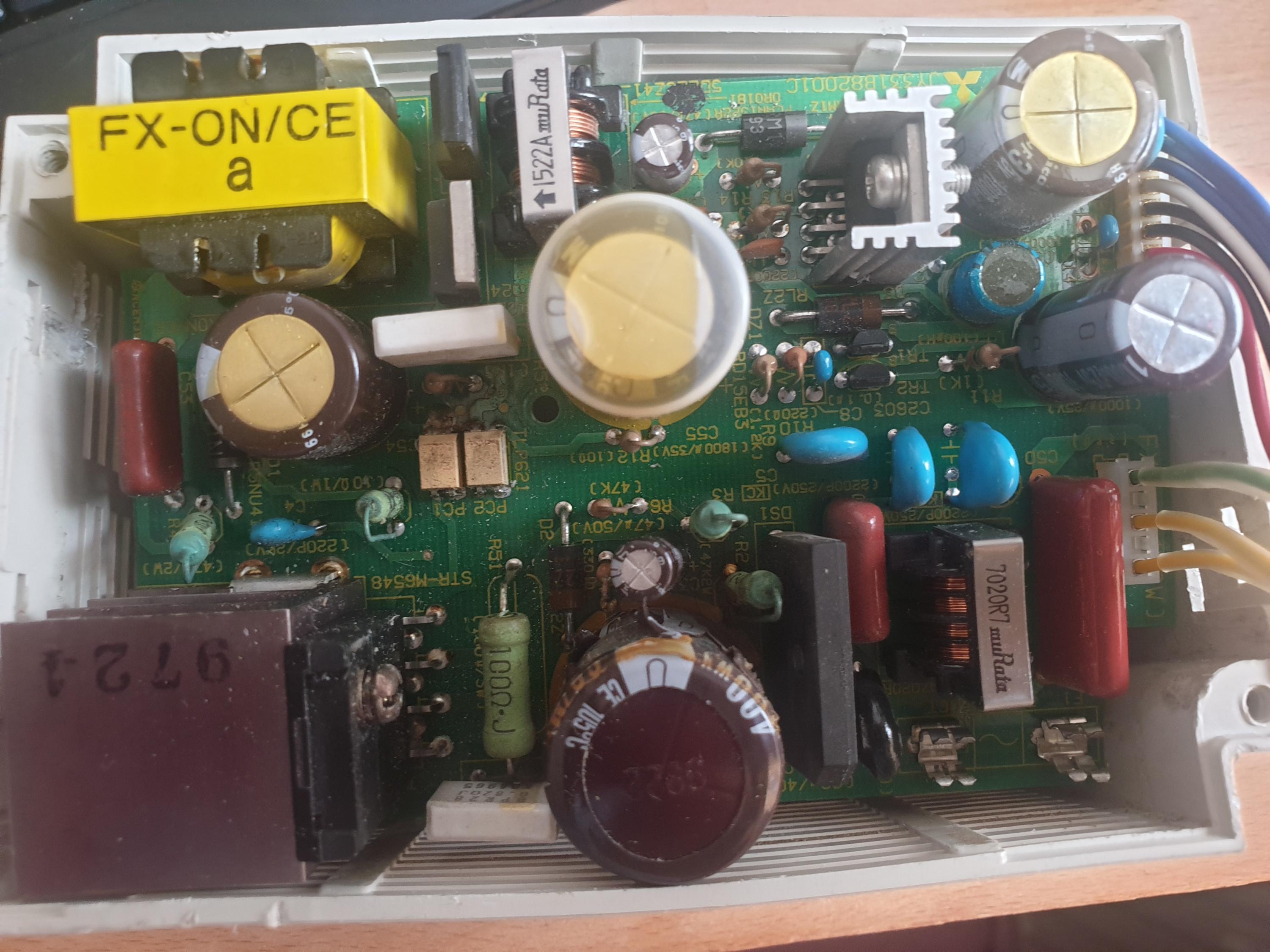

                        @ BUDM, Well spottted, sorry I got my wires crossed,

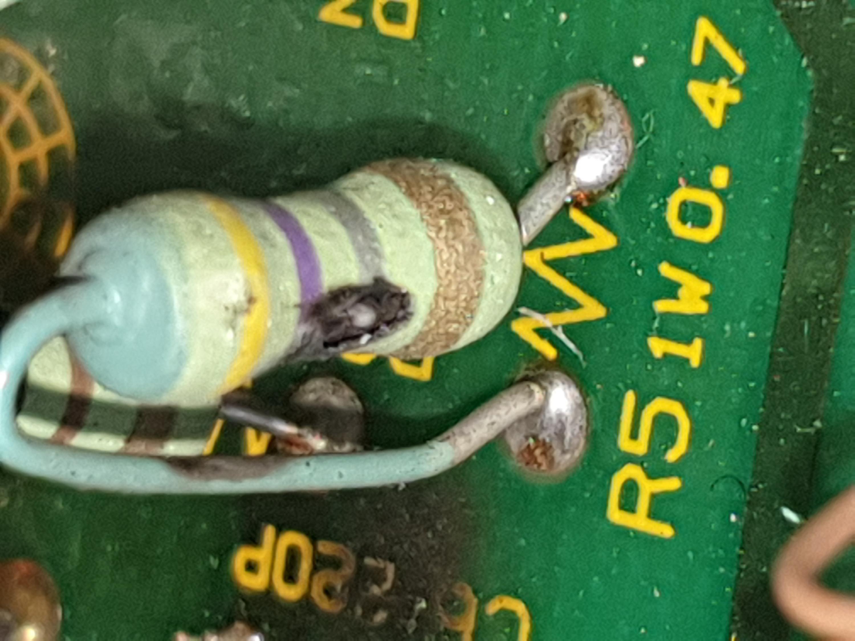

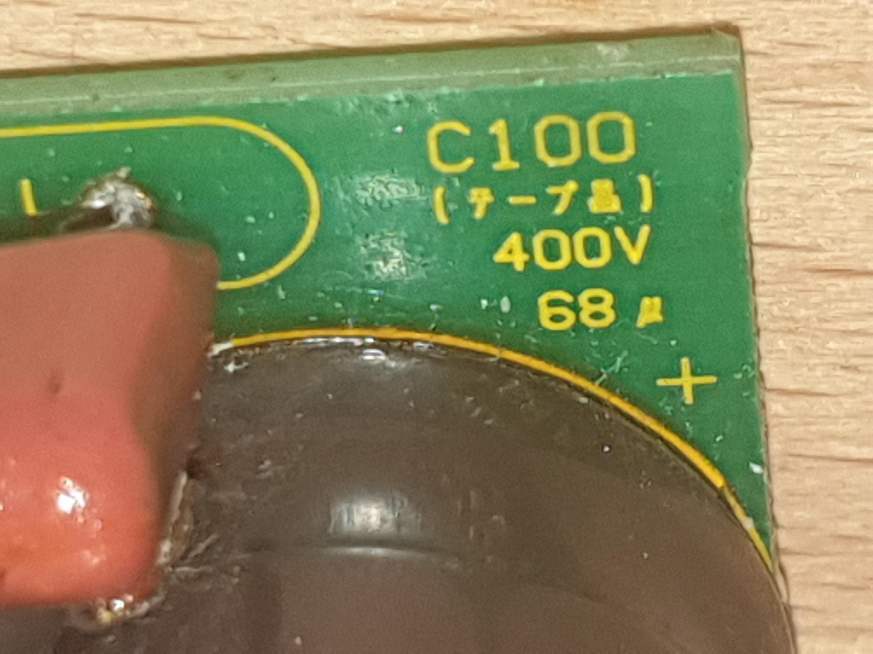

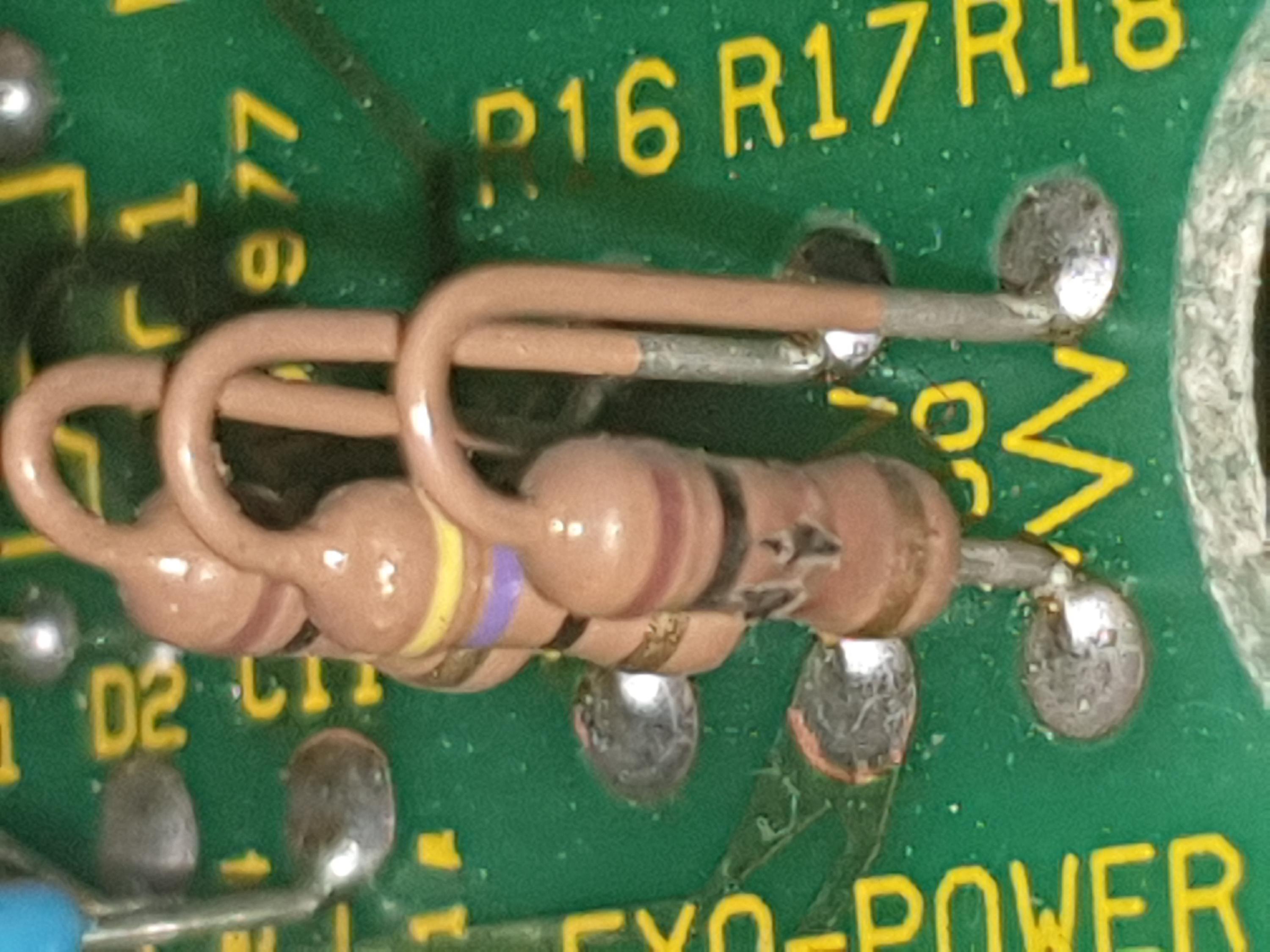

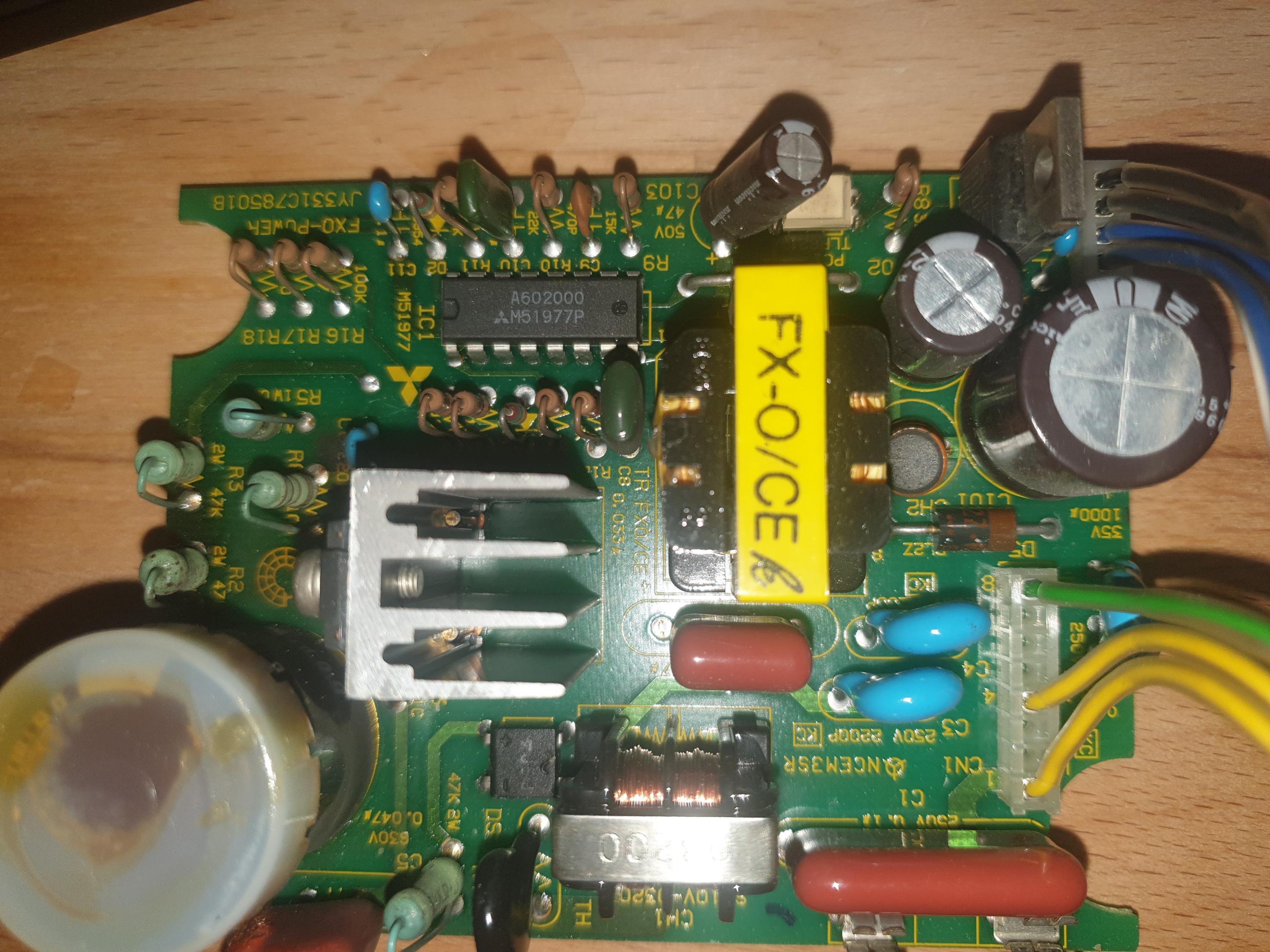

                        Find attached correct pictures Top and Bottom for FX0-Power JY331C7 8501B
                        Yes, some caps are bad i.e.
                        C5 - 630v, 0.047u,
                        C100- 400v, 68u
                        also this RES:
                        Resistor R18
                        Resistor R5
                        Thermistor (TH) 10D9 - not sure if this is NTC/PTC
                        Many Thanks
                          it looks like the cap is on the dc side.

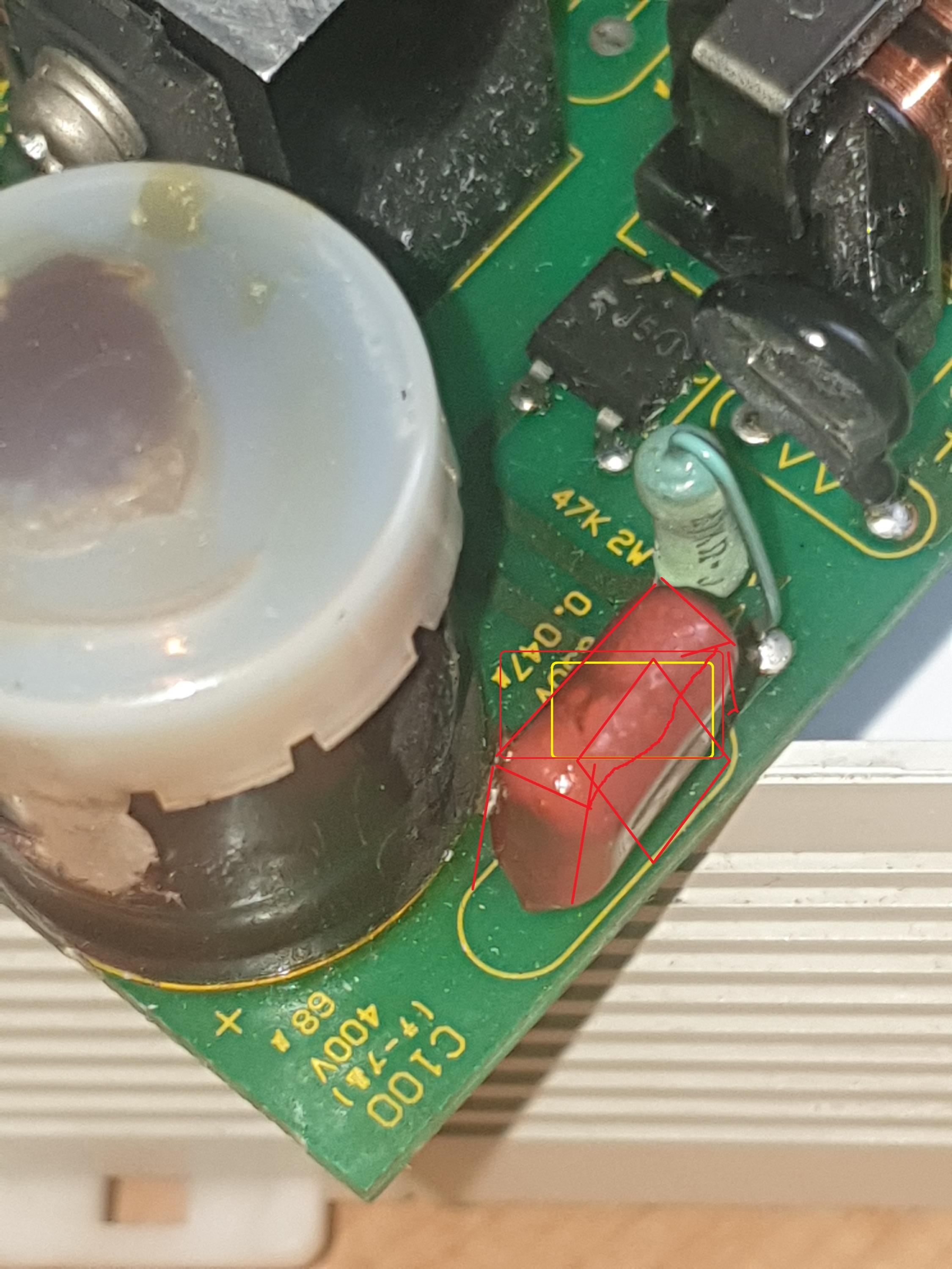

                              1) Cap C5 - 630v, 0.047u. So what is wrong with the cap? Shorted? Not showing correct capacitance? It looks to be connected in parallel with the main filter cap C100 (68uF 400VDC).
                              2) R5 (0.47 Ohms) is blown so something may be shorted out causing the resistor to blow, it looks to be resistor for the Source pin of the 3-pin power device. You need to test that 3-pin power device (MOSFET?) mounted on the heatsink for shorts.
                              3) R18 is also blown so you need to check that circuit section also.
                              4) Why is the fuse removed? Was the fuse blown?
                              5) Bridge rectifier D9 tested good?
                              https://www.badcaps.net/forum/attach...6&d=1591801314
                              At this points it looks like you have more than just blown NTC and blown resistors.

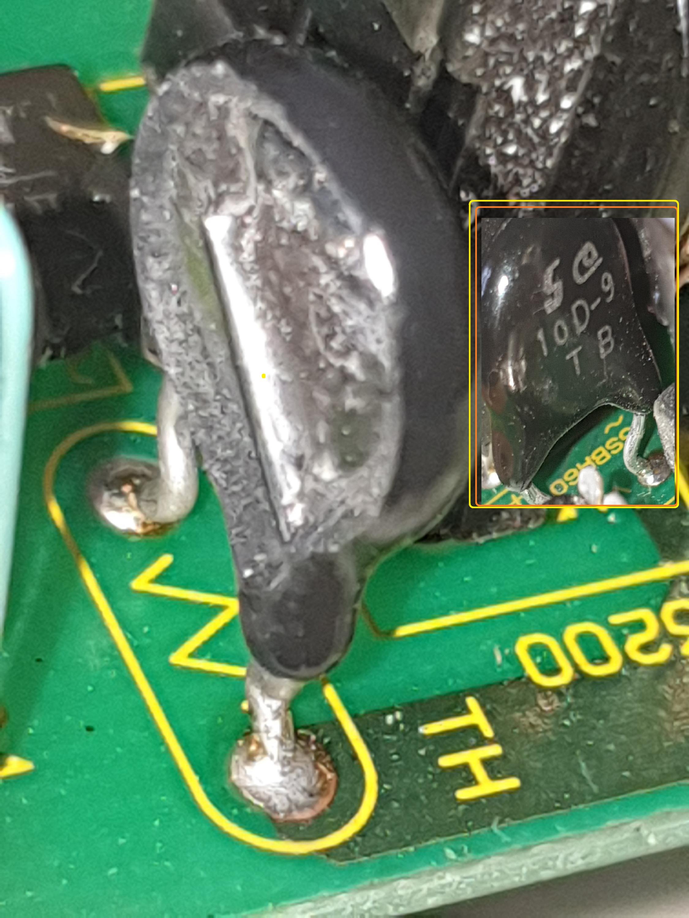

                              • Assurance
                                • Jun 2020
                                • 16
                                • u.lk
                                1) Cap C5 - 630v, 0.047u. So what is wrong with the cap? <<Has a bulge in it>>
                                2) R5 is blown so something may be shorted out causing the resistor to blow.<<the machine failed to work, Not sure why this box is blown>>
                                3) Why is the fuse removed? <<<fuse removed while taking pictures>>>
                                4) You still do not tell us what is the board not doing.<<<This is part of a power supply controller unit for a plactic welding /sealing operation, (it supplies instant heat for this operation)>>>

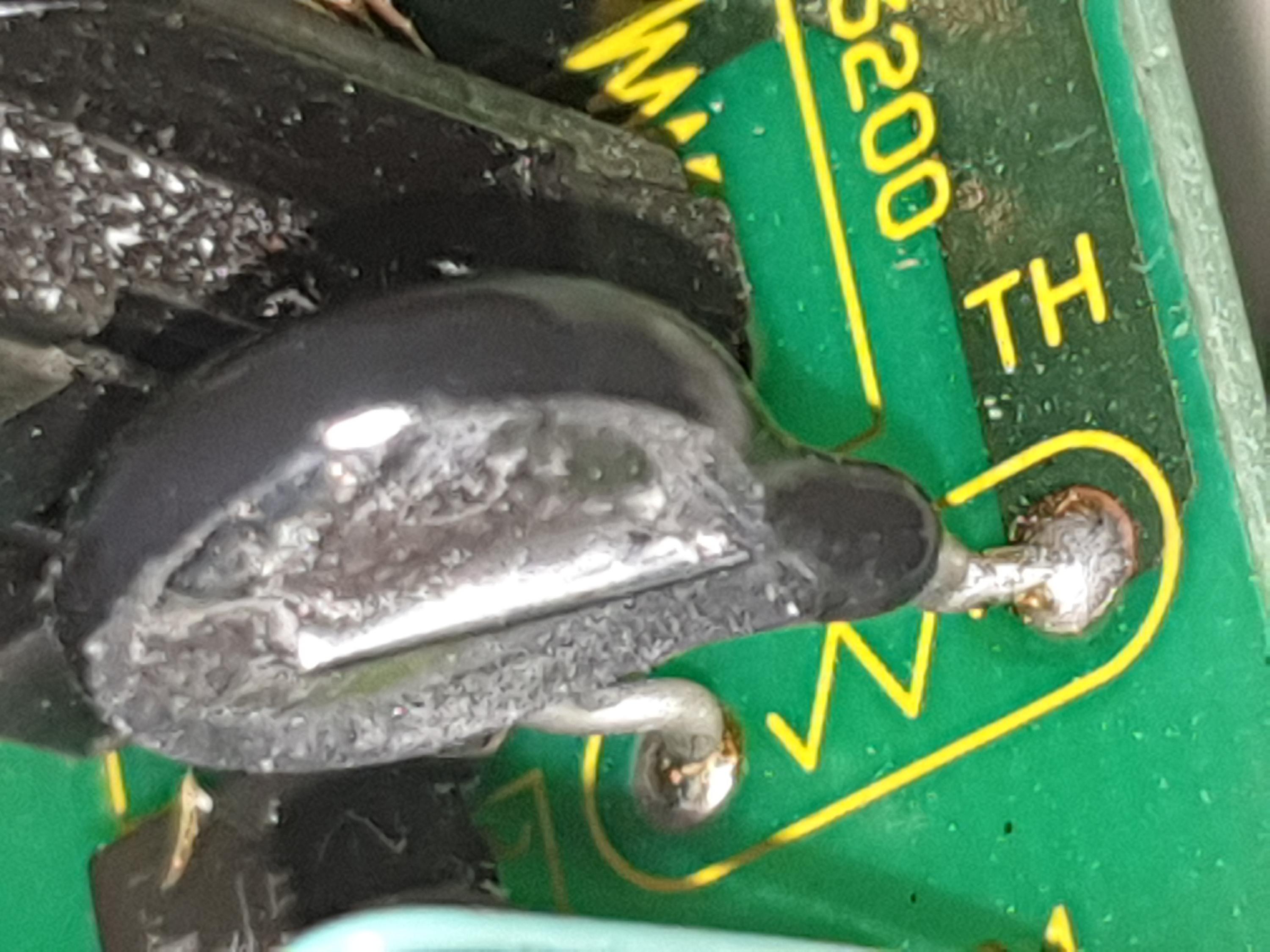

                                5) Why do you say that NTC 10D-9 is bad? <<<only changing because its cracked open as shown in attachment, im guessing it still works >>>
                                  Please see my update post 15.
                                  But does the cap C5 still show the correct capacitance? Does it show leakage resistance?
                                      At this point OP has more than just blown PTC and caps issue, more likely the MOSFET had shorted out and also blown resistors.
