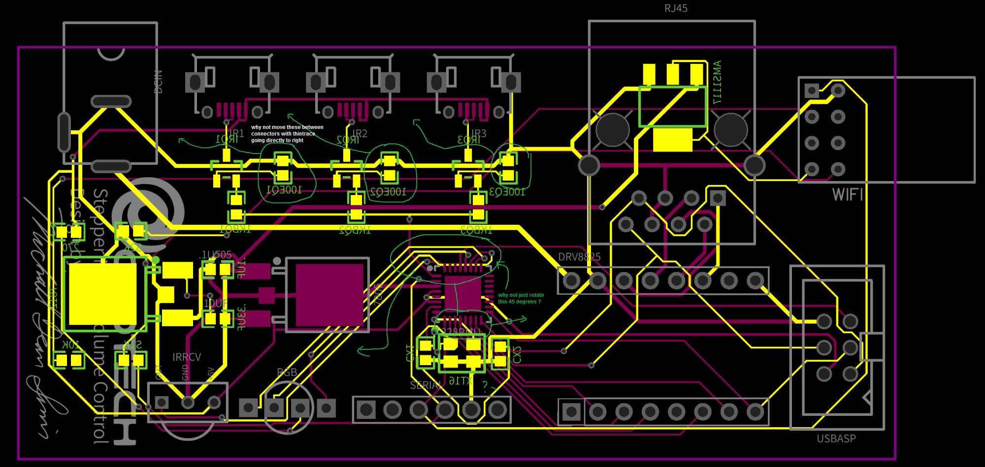

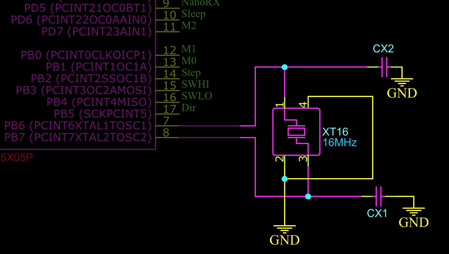

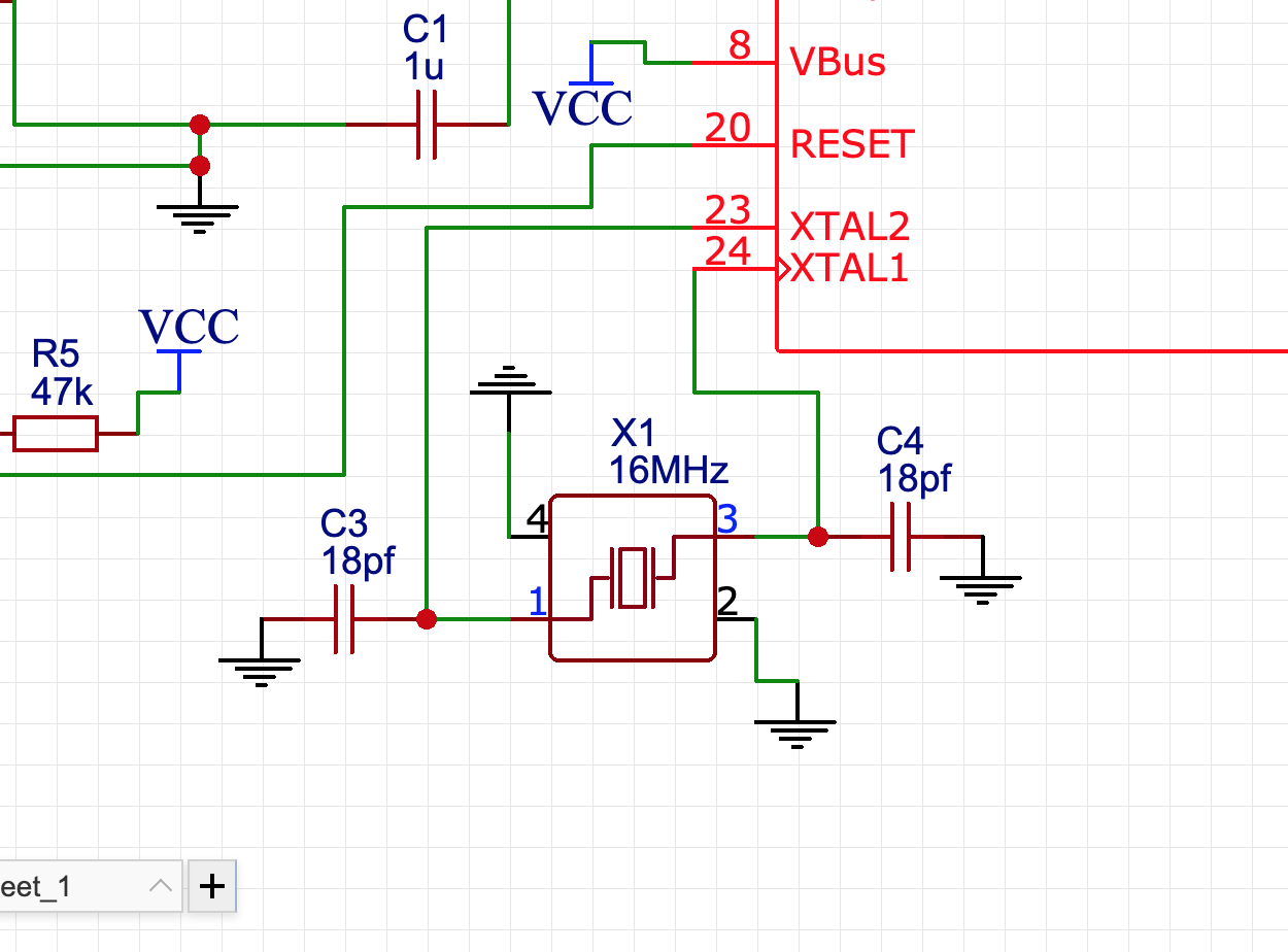

    I'm making a circuit board for an Arduino project ... I opted to go with the Mega328MP for its small size and excellent capabilities.
    Anyways, I want to go with a surface mount small package 16Mhz crystal but these things have 4 pins, two are marked GND, so it seems obvious how I'm supposed to connect it up, but I have no experience with it and wanted to fly it here to make sure i'm doing this right.
    Here's what the schematic looks like:

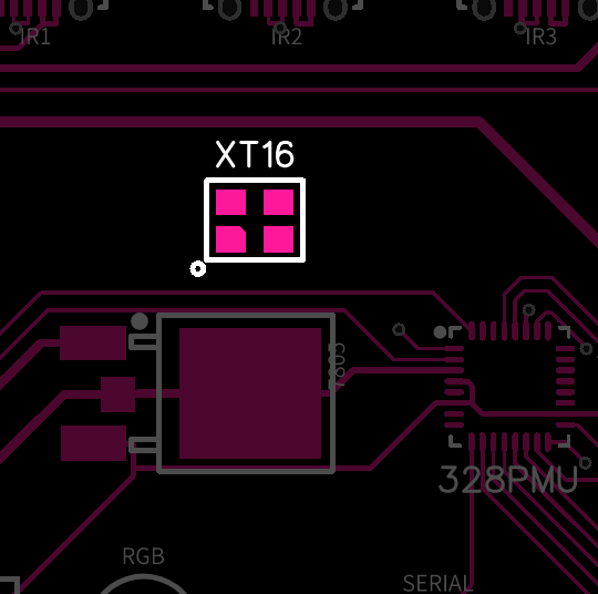

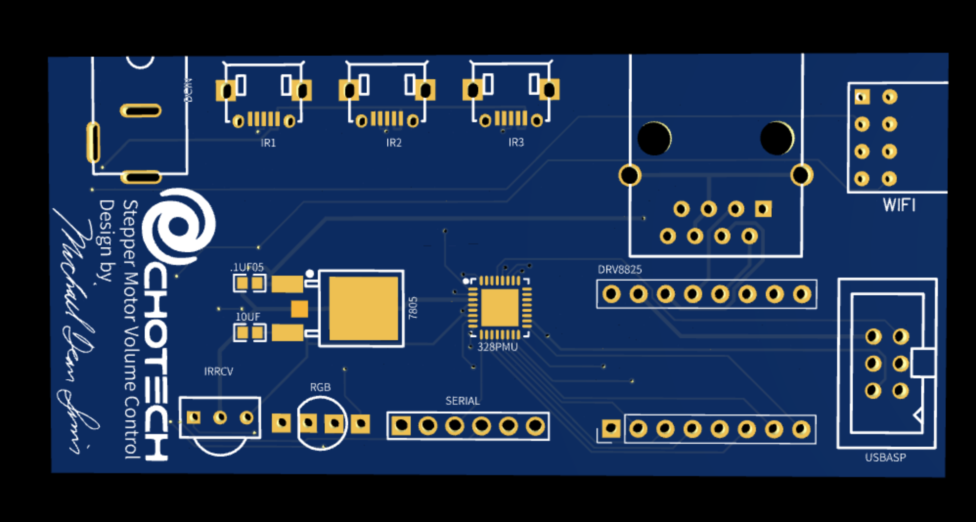

    And here is what it looks like on the PCB:

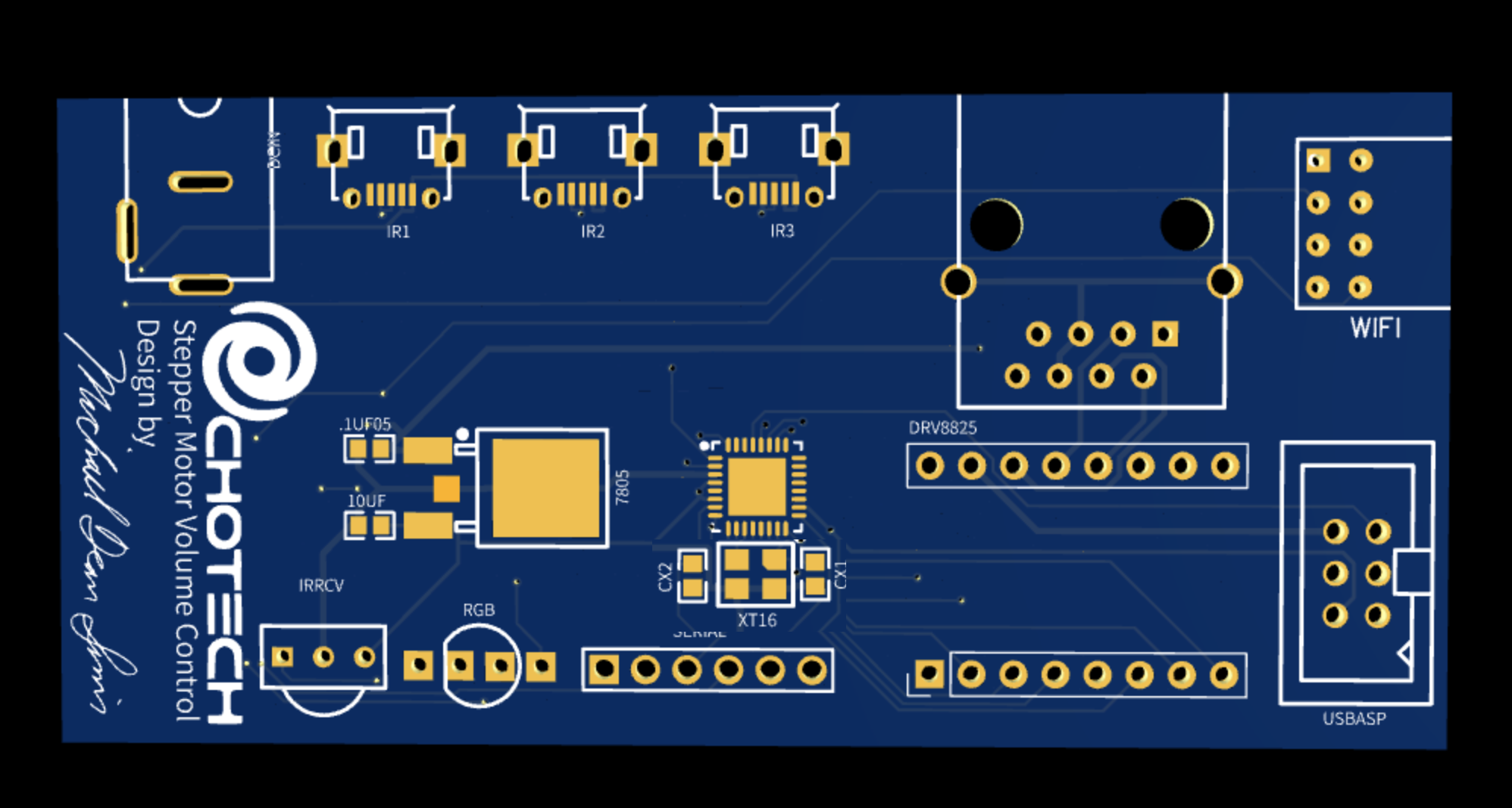

    Here's what the final placement on the PCB looks lke:
    Are the 22pf caps on my schematic connected properly and are the pins on the crystal also connected properly?

    Re: Question about SMD Crystal and proper capacitor placement / pin connections
    read the datasheet for the chip.
    but in short,
    keep it close to the chip - short tracks,
    keep the 2 tracks of equal length,
    keep the caps as close to the crystal as possible.

      So I'm assuming that my schematic is correct ... otherwise you would have said something ... right? I'm aware of the need to keep everything tight and close to each other ... I'm just wanting to make sure I have that crystal chip wired correctly ... thats all im lookin for here is a little confirmation ....
      I guess ill go pull up the datasheet ...
        The datasheet didn't have any schematic examples, but I found this project out there with this schematic so it looks like my assumptions were right...
          It looks like WAY TOO FAR from the chip when there's lots of room around the chip to place the oscillator closer.
          Also, no input and output capacitors on the 7805? Stick a 0.1uF ceramic close to the input of the 7805 and optionally a 1-10uF ceramic on output.
          Why the DPAK 7805 ... is your board really using 500mA+ of current? Why not use a SOT223 or something similar

                You got a part number for the crystal?
                Number one when doing MCU PCB layout is having the crystal close to the MCU, shortest traces you can get away with, AND no noisy traces running next to them. XTAL IN is super sensitive.

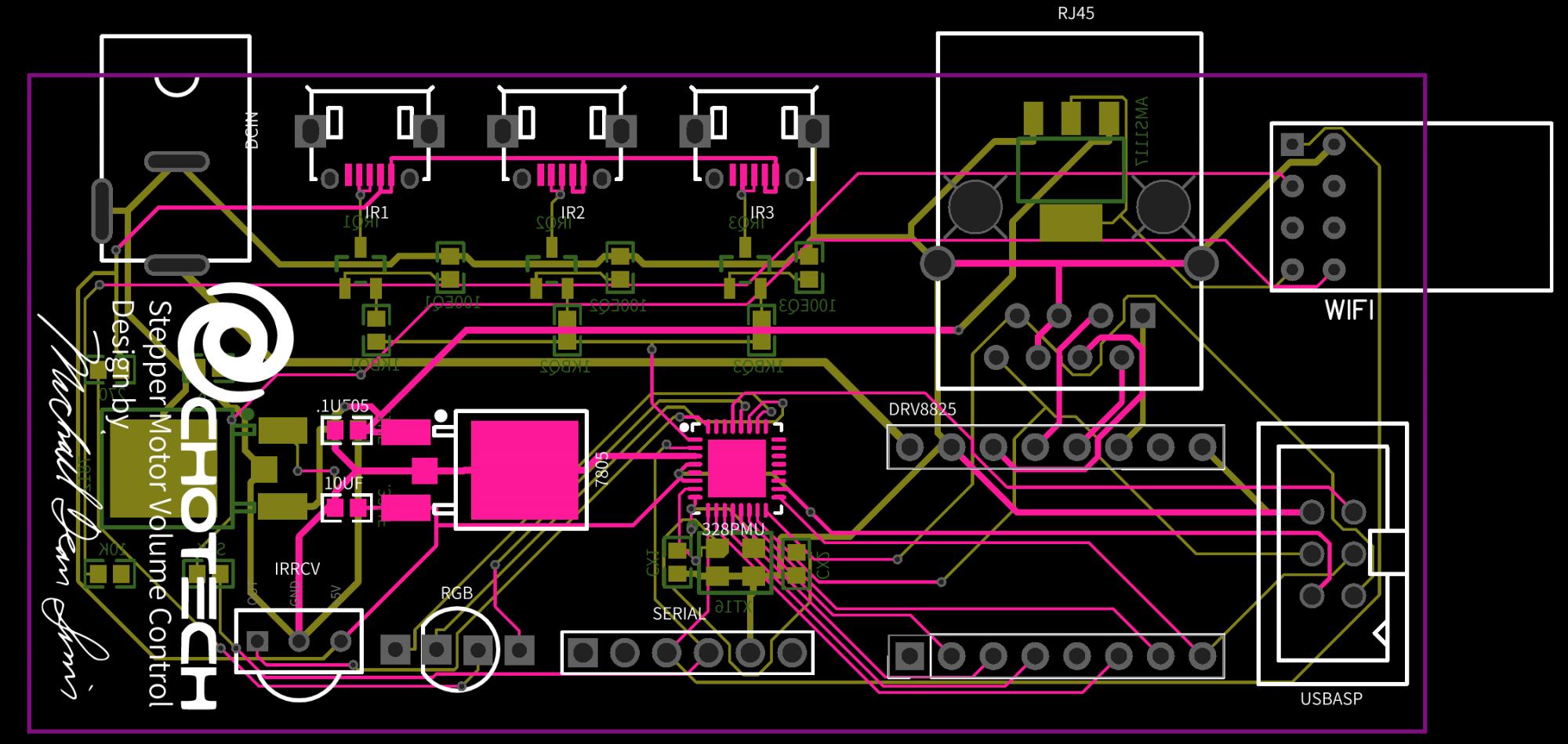

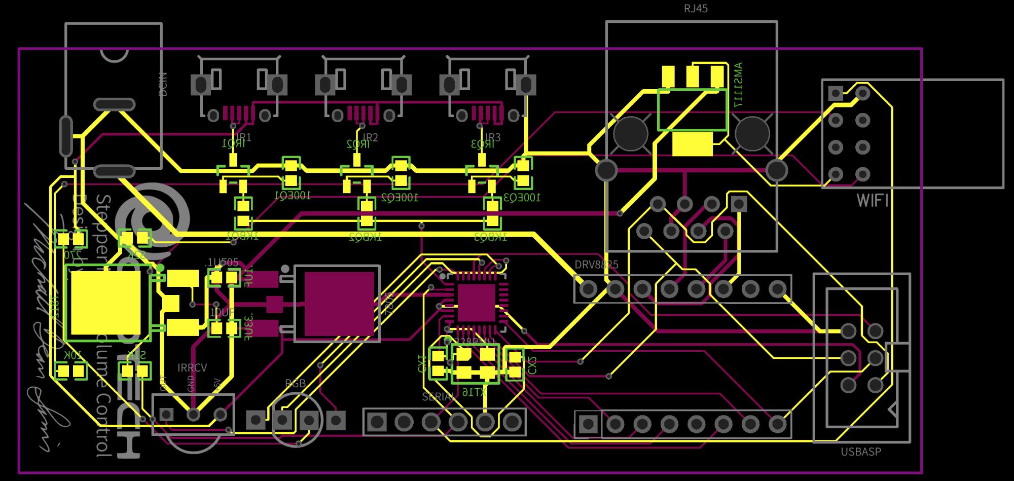

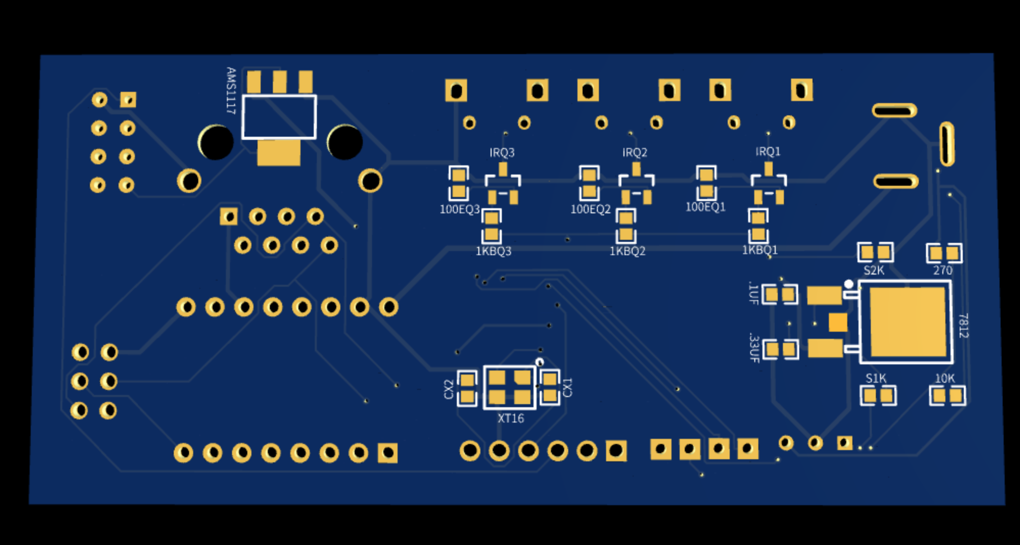

                  That was just a quick throw together here is the top AND BOTTOM of the PCB in 3D image screen shot super-imposed on each other for that section of the board ... this is final layout...
                  PCB TOP Layers:
                  AND Bottom layers ...

                      Anyway... looking at your circuit boards... what else I can suggest is
                      * move the 3.3v ldo on the top side of the pcb... plenty of room, no need to have components on both sides.
                      * i'd suggest having the back side almost all ground

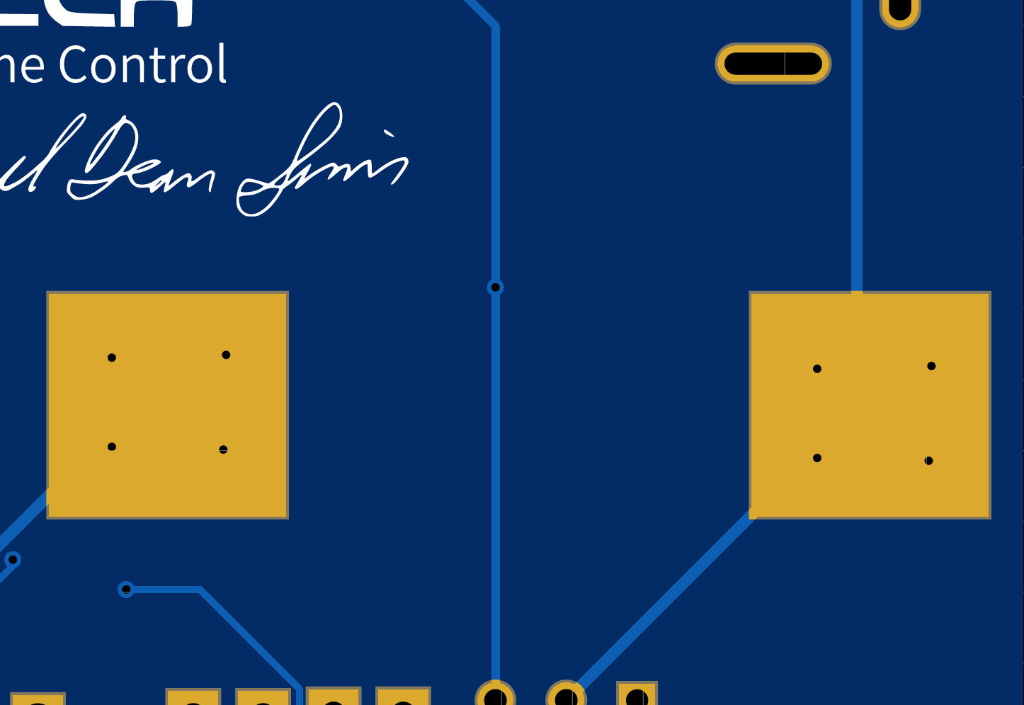

                      * you could have a square under the 7805 that's a bit larger than the ic cut away from the ground fill and use some vias to connect the top copper to the bottom (basically use a bottom square as extra heatsink for the regulator)
                      * when the wireless module turns on or wakes up from sleep it will consume a bunch of energy so it wouldn't hurt to have a capacitor by the input of that 3.3v ldo, maybe 100..150uF 6.3v/10v polymer? It would help if this is battery powered... if only on dc in then probably won't matter
                      * any particular reason why you're defaulting to so thin traces? Thicken them, especially Vin , Vout traces, ground. If you'll have 100+ mA to 3.3v ldo, make that 5v trace thicker.
                      * see my above comment about some 1117 regulators requiring some ESR on the output... the 1117 regulators may oscillate otherwise (cause random instability) ... and again you have the default thin traces ... thicken them you have plenty of space on pcb....
                      * may not be a good idea to have active components UNDER the area where your wifi is ... noise could affect the antenna (worse reception or transmission).
                      * seems like you could rotate 90 degrees that drv8225 header and move it near the USB ASP header ... and move that other header closer to serial header

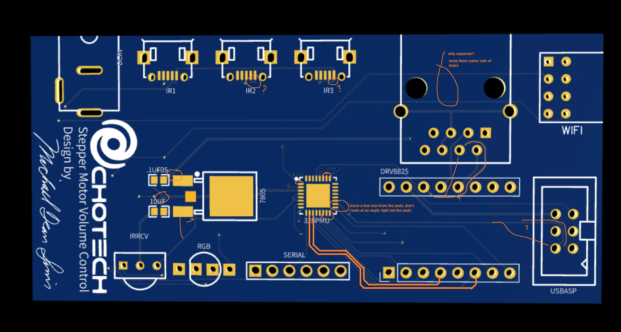

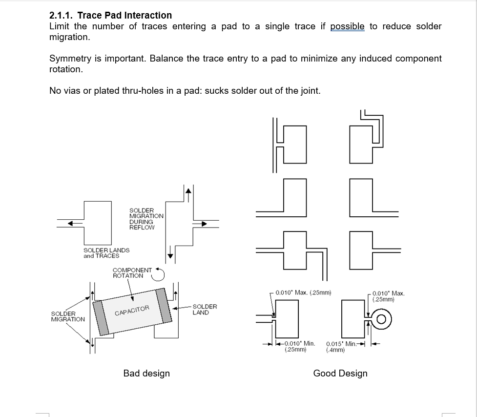

                            Also some more suggestions... see attached image and what I wrote on it :
                            * always try to get traces out of pads or through holes at 90 degrees, don't go diagonally right away if possible. Try to leave a few mm.
                            * also not a good idea to create Y shapes with traces. Make a trace straight and branch it at a 45 degree angle if needed.
                            When making circuit boards, there can be too little copper in the center of the Y, and in that area acid or other materials can be trapped further corroding the copper and causing some boards to be broken.
                            * you can configure the software you use to only make 45 degree bends.. use more if needed... i gave you an example with the header at the bottom. again, leave a bit more room when coming out of a chip, don't go diagonal right from the pad... leave a few mm of straight trace if possible then bend it at 45 degree.
                            * if the headers are not high speed and you don't have to match trace lengths, instead of going with a trace around a header, you could always use VIAs strategically placed near the header to move the trace on the other side of the board and connect it to that through hole.
                            Right by the header, it would be reasonable, it wouldn't break the ground fill on the bottom too much.
                            Here's an example... light green is top trace, dark green is bottom layer ... see how you can invert the traces
                                Kinda like this?

                                    How are you connecting those middle pins and the tab, those are typically Vout ... you can't just wire them like that.
                                    Why don't you try recreating your circuit in DipTrace, it's free for up to 300 pins so your project should be doable in it? Here's link : https://diptrace.com/download/download-diptrace/
                                      Do you have DRC turned on while you are laying out the traces to let you know if the trace are correctly terminated, correct clearance as set in the design rules, etc?
                                      Also do the research on SMD trace layout rules.
                                        • 31289
                                        What the hell are you doing with that 7812 linear regulator?
                                        no, that's ground.
                                        did he link a picture??? i cant see shit - i hope it wasnt imgur - that's geo-blocked these days.
