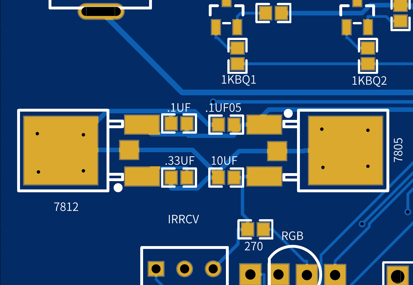

    He uploaded this:
    I can't figure out the traces... there's 3 traces popping out of that 10uF ceramic capacitor footprint. Like I said... best to have one single trace come out and then branch out traces from that trace.
    ...and makes no sense to have notation there 0.33uF ... also if you have one regulator powered from another, then the decoupling capacitor (0.1uF ) for that second regulator can be omitted, because you already have an output capacitor on the output of the first regulator.
