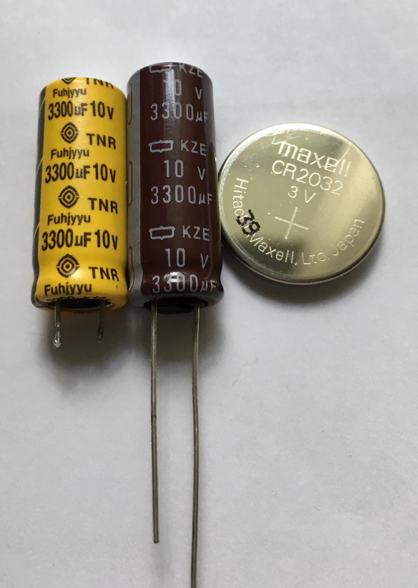

    I needed some 3300uF 10v caps for my psu (especially 10mm), so I ordered from ebay 10 Pcs of Nippon Chemi-Con (NCC) KZE 10V 3300UF caps 10mm x 25mm, are these caps counterfeit?
    link for this cap on ebay: https://www.ebay.com/itm/302793396429

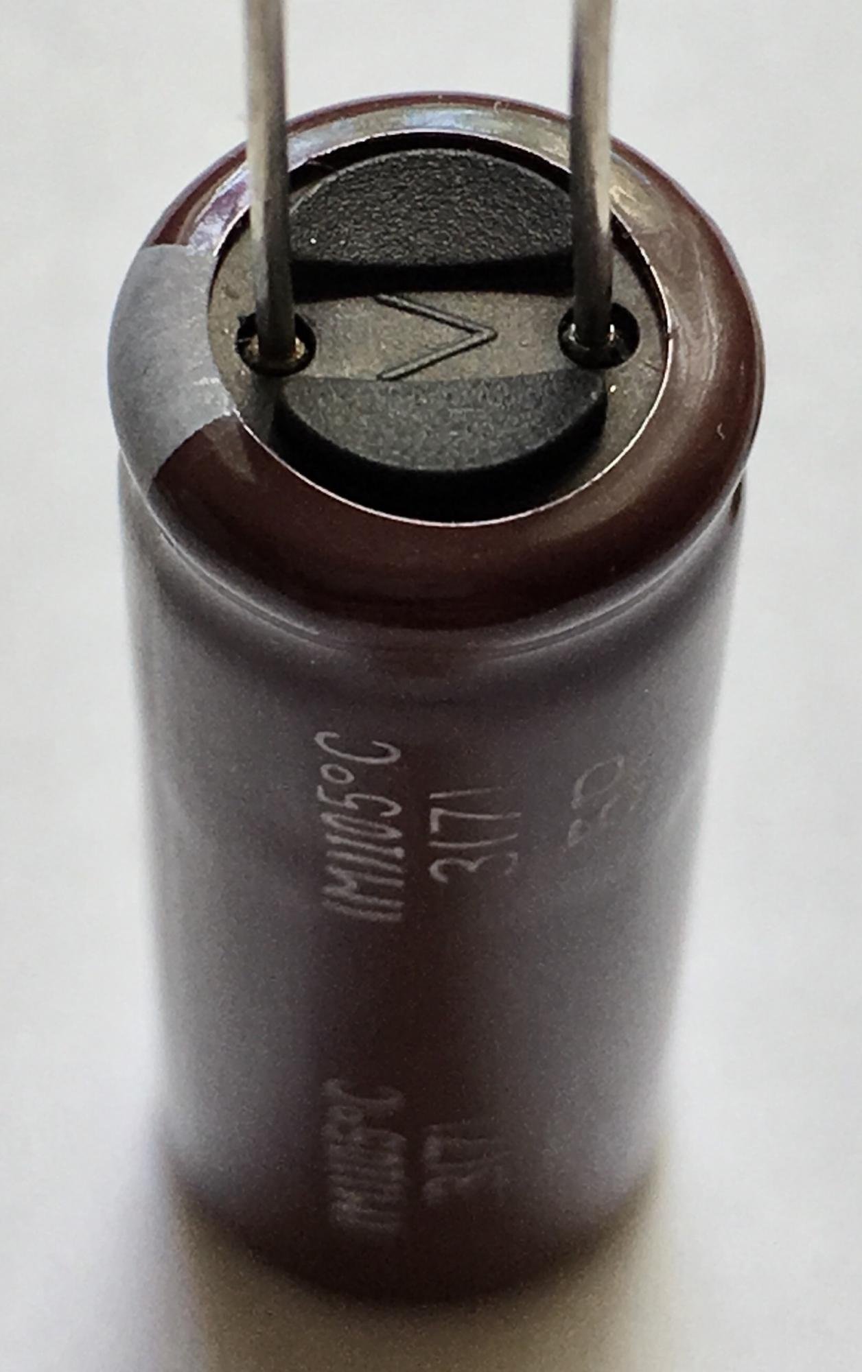

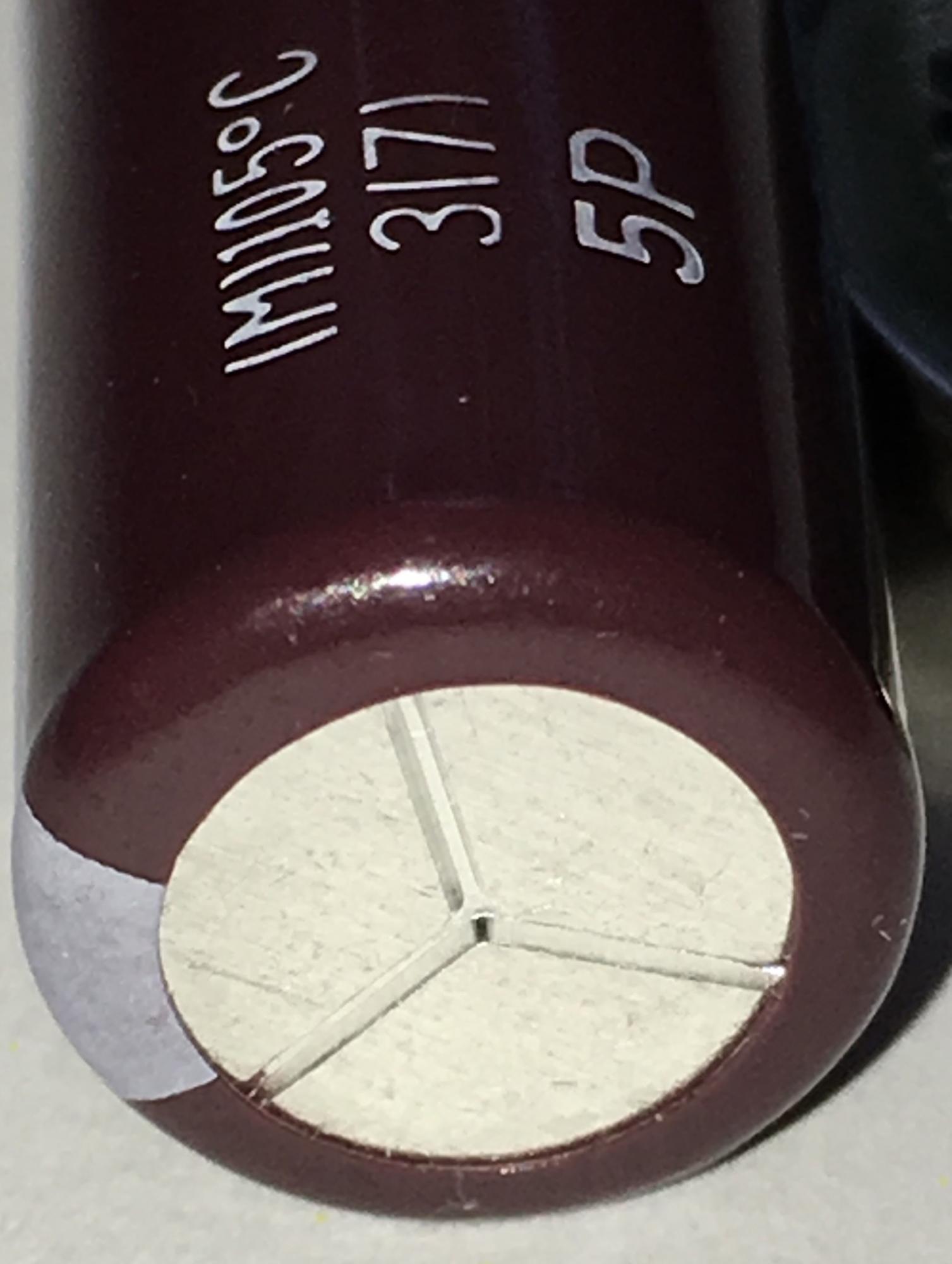

    that link is just inadequate for telling if its fake as it doesnt show the top vent of the cap and doesnt show the bung on the bottom. two telltale signs of fakes.
    but looking through the chemicon kze datasheet, the 3300uF 10v caps come in 12.5x25mm can size not 10x25mm. please measure the caps again yourself. if they are indeed 10mm in diameter, they are most likely fakes. dont buy caps from ebay or china. buy from a reputable seller like digikey, mouser or some such.

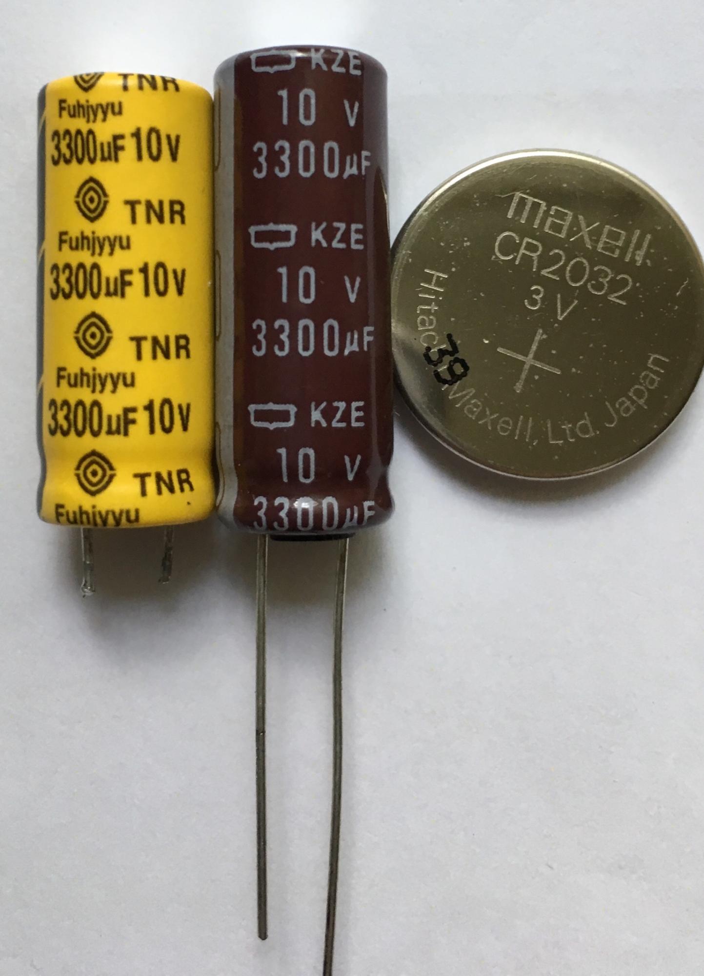

          Re: Nippon Chemi-Con 3300uF 10x25mm?

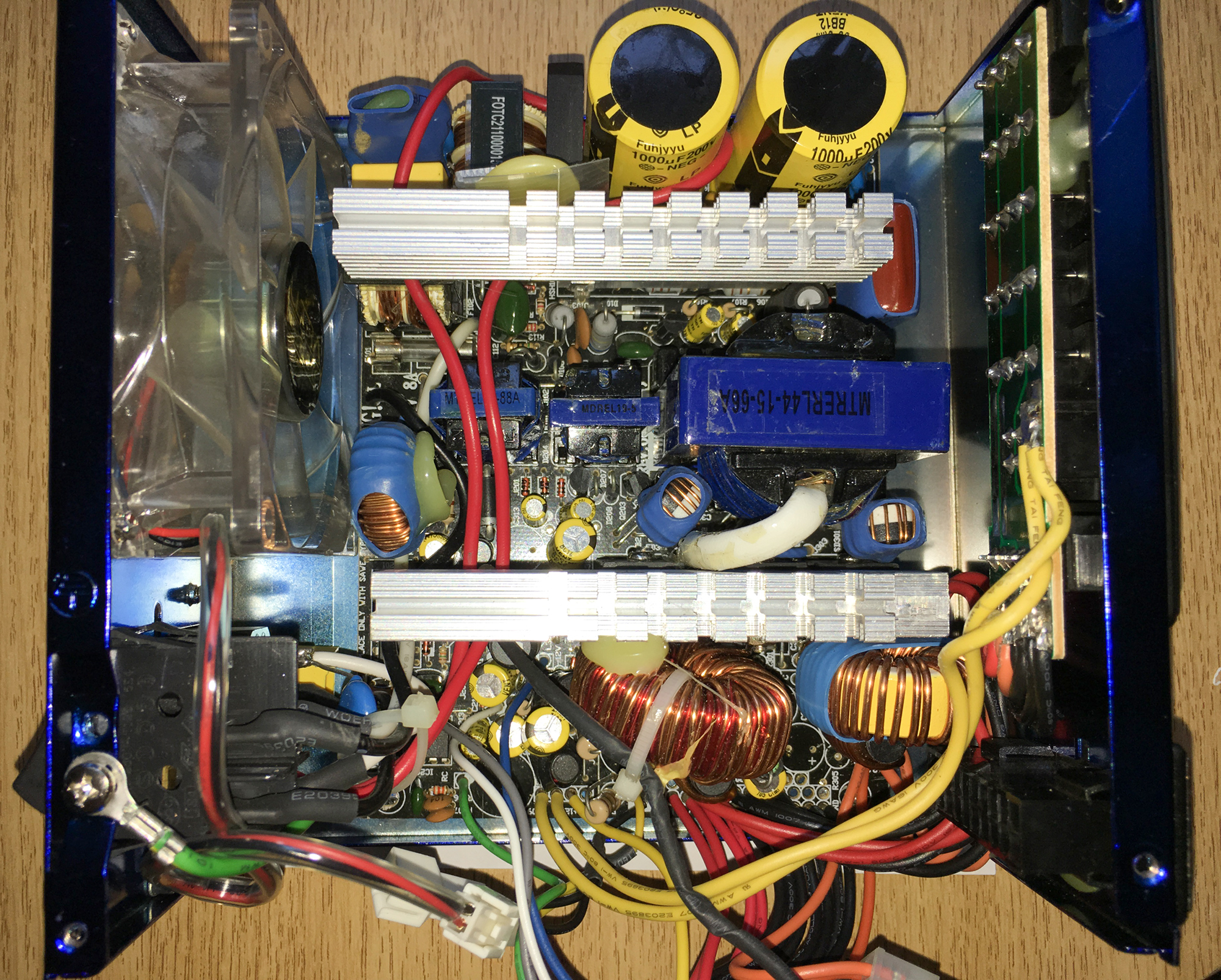

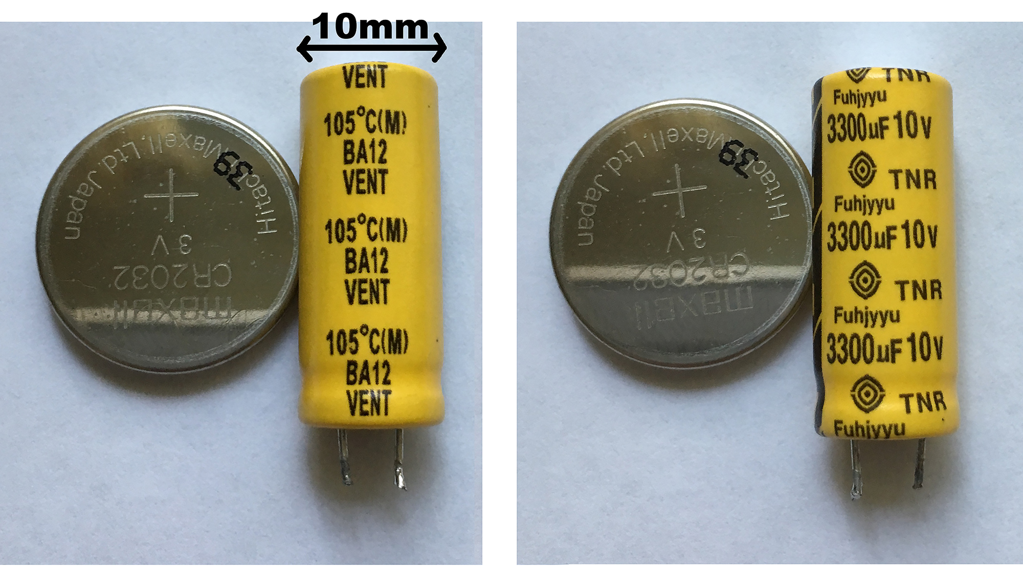

          I want to recap this Ultra X-Connect 500w Modular ATX psu for my retro pc build, all caps are Fuhjyyu brand, there are 2 caps "10V 3300UF" (output filters?) at 10mm diameter so I need 10mm caps because largers ones will not fit.
          Im a noob at capacitors so I used google to search for 10mm caps... I found out that Nippon Chemi-Con KZE series was used in high end PSU-us, that's why I ordered from ebay these Nippon KZE 10mm caps.
          So are you sure that Nichicon HM 3300/6.3v will be a good replacement for Fuhjyyu TNR 3300/10v ?

            i seem to remember in the past we had this problem with Antec psu's and solved it by using panasonic FK series 2700uf caps.

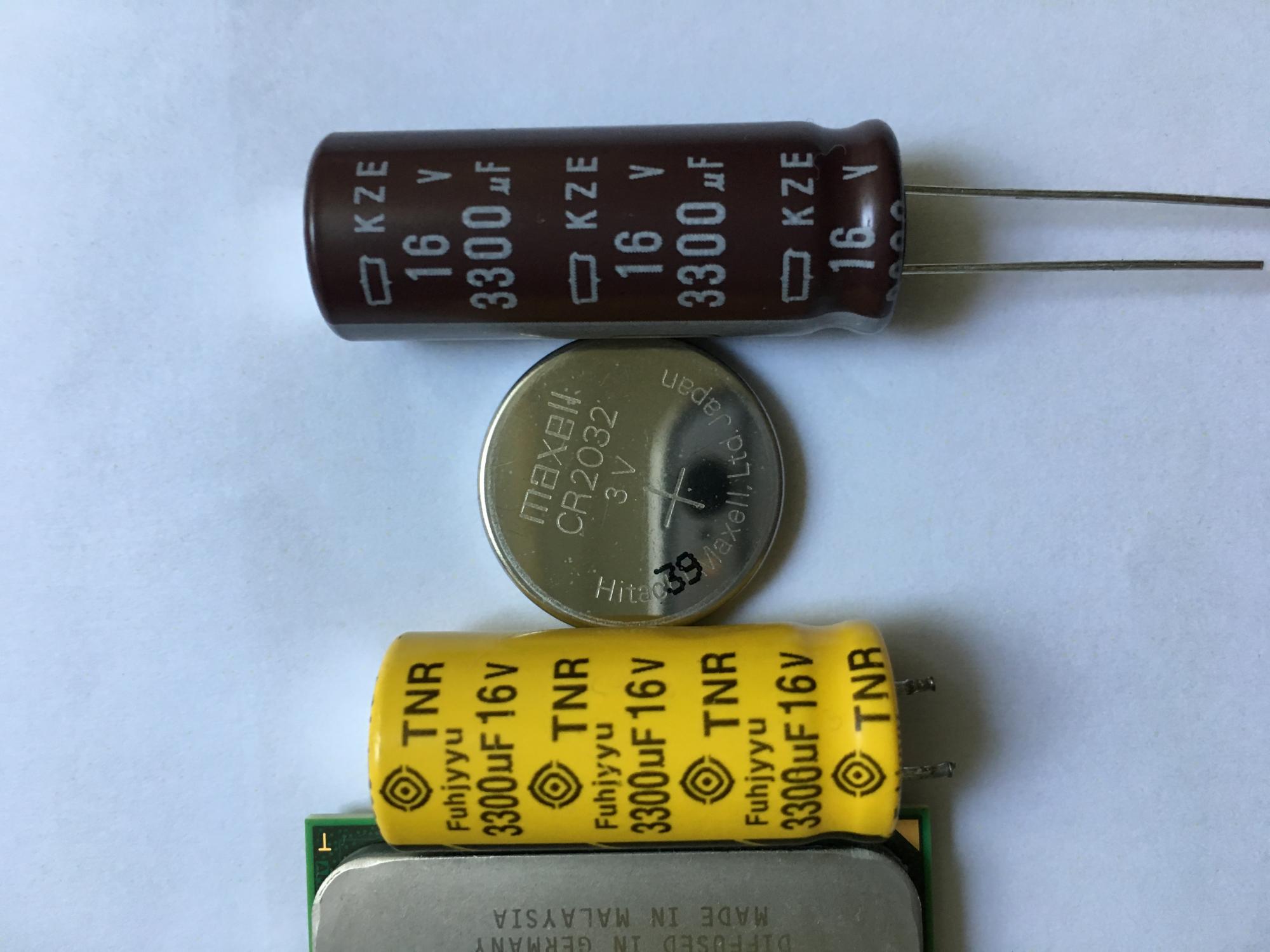

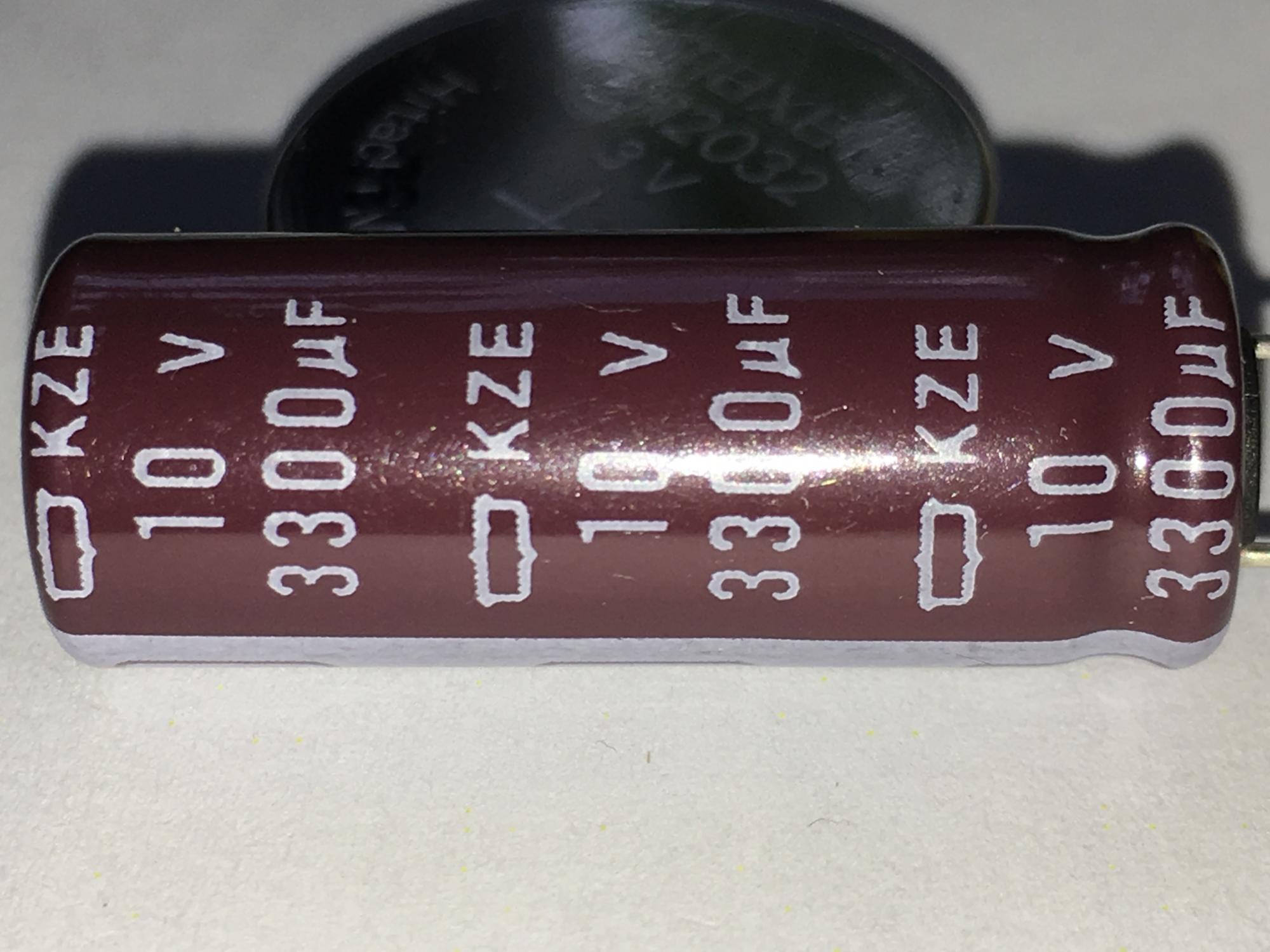

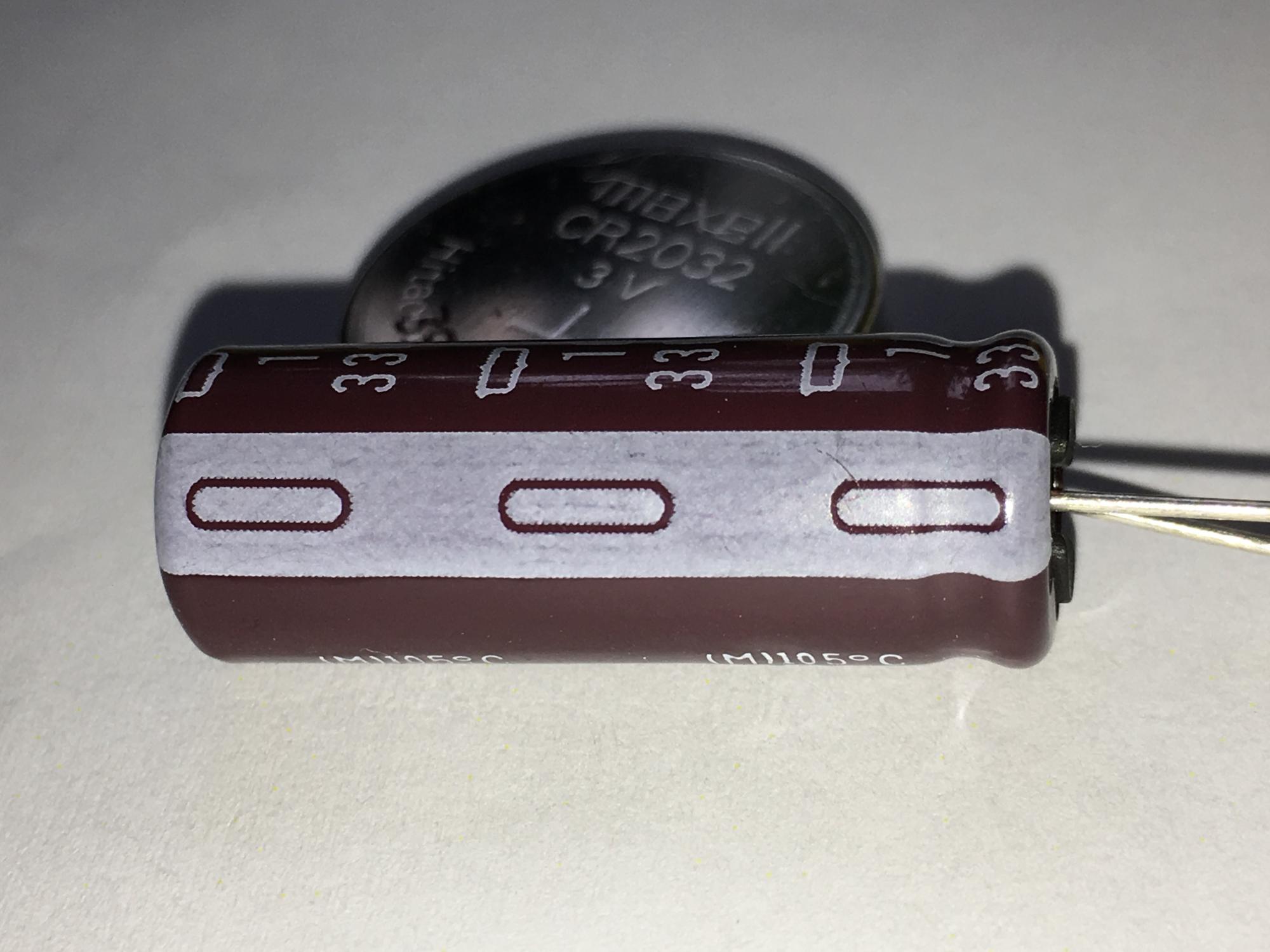

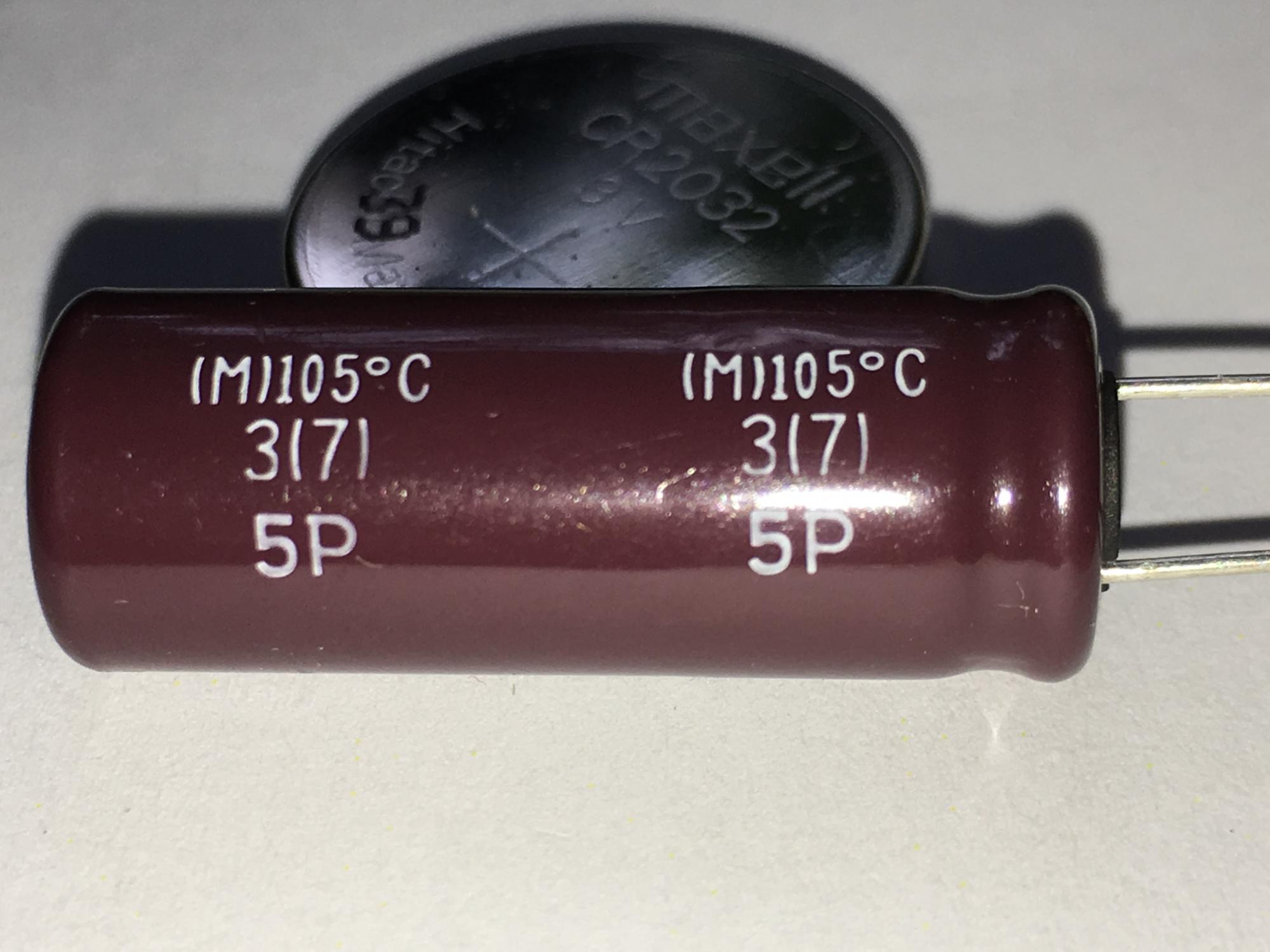

                                      just received my package today, unfortunately i don't have an esr meter but I will order a cheap “LCR-T4 ESR Meter” from ebay 🤭 and I will post their values.
                                      • Hitto
                                        • Apr 2019
                                        • 95
                                        • Italy
                                        They look legit.
