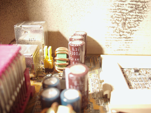

Who is the producer of the red/brown 3300 uF caps on the photo? Are they suitable for motherboard applications? It's a Shuttle AV11 that has been unsuccessfully recapped. Will try to get it working again.

they appear to be United Chemi-con KMG series.
They are used by several board manufacturers. Whether they are suitable for motherboard applications, the chemi-con series chart indicates that they are not the best choice as it indicates they are standard series. KY, KZE, KLH, KZG, KZH are better choices as they are low esr.

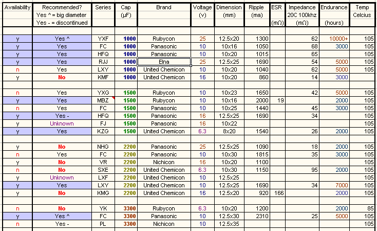

i don't think it is suitable for your purpose. the kmg series has lower ripple current than the other low impedance series or from the competitor...
again, i'm sorry for including my chart. at 2200uf 16v it has only about 900 ma ripple current... 2 times lower than the others that has about 1500ma or higher...

why are you sorry Yanz? you are doing a great job. we need someone to collect this data.again, i'm sorry for including my chart
it is very bad then that the following manufacturers chose to use the United Chemicon KMG (NON low esr caps) on their boards :in my opinion it is not even the choice for the purpose
Asus A8N-SLI Deluxe
DFI nF4 SLI-DRComment

you should still get a post even with standard caps. You said the board has been unsuccessfully recapped, I understand that job was done by someone else. There are two worst case scenarios :So it is still worth of trying to replace the caps with known good ones as the first step?
1. other components of the board sustained a failure when the original caps failed.
2. the person recapped the board badly and has damaged a trace or lead port etc........
this is assuming that all the caps on the board have been replaced with new.
first step would be to visually check the board for damaged traces, burnt components. if it looks ok then i would remove the caps and check the lead ports for signs of damage or too much heat. (i think its difficult to tell though). then you could try recapping the board with some other caps. If none of that works then you will have to test the circuits of the board.

thanks for the compliment and encouraging me guys, it just that my chart is incomplete and was designed only for my self.why are you sorry Yanz? you are doing a great job. we need someone to collect this data.
i will complete it in the future and maybe can make some use for this forums. i hope someday the badcaps forum will make some ultimate chart/specification of good capasitor..

yes, and it is in a good quantity. lucky me..Under availability in your chart: does this mean that you can obtain them in your local area? Given the cheap prices you have quoted in the past, I was even considering placing an order with you!
but they are only for a specific capacitance.. for example : the mbz, the availability is only for 1500uF 10v. i can't find 2200uf or 1000uf ones. it was strange that any 1500uF 6.3v (kzg), 10v, 15v, 25v from all manufacturer almost have the same price..
obviusly the shops here didn't know what they will get from the main supplier (singapore).. they only know that it will be originally japan or taiwan/korea... the mbz and kzg is only Rp. 1500 ($1 = ~Rp. 9000) = $0,25 and so the FC 3300uf is about $ 0,45. you want to order from me?
