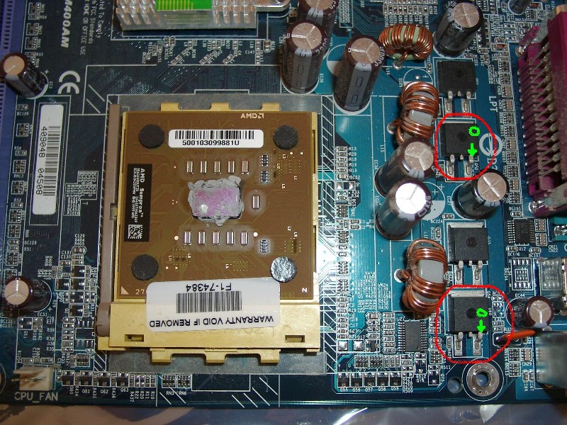

          Anyway, I powered it up again and check the voltages on the VRM FETs:
          IN Out
          4.28 1.65
          6.05 0.02
          4.27 1.66
          7.44 0.02
          So, it appears two of the FETs are not turning on. However, all 4 FETs give me similiar ohms so I don't think they are shorted.
          Also, I can turn the power to the board on and off using the Power button connected to the mobo so the board is not totally dead.
          Anyone has experience on the voltages on the VRM FETs?
          Anyone still suspect the 3300/6.3V KZGs even they look fine and are not high on ESR?
          Thanks.

            Ah... found the instruction by willawake on how to attach picture. Many thanks!
            So the green markings are the two have zero volt out.

              OK, maybe two of the FETs are dead.
              The two that have no output (and cold) have lower ohms than the other two.
              The markings on all 4 are:
              07N03L
              AV340
              I Googled and found there are 4 different varieties of this 07N03L:
              IPB07N03L
              IPD07N03L
              IPP07N03L
              IPU07N03L
              Does anyone know how to tell which is the correct one?
              Are there any subs for this?
              Thanks.

                  Re: Gigabyte GA-7VM400AM
                  the mosfets are not a problem.
                  that is a 2 phase vrm and it it running.one of each pair is the switch and the other a syncronous rectifier.
                  measure across the big caps close to the cpu and you will also find your 1.65v reading there.
                  there is a chance the vrm output caps are bad but your only way to prove that is to replace unless you own an esr meter or a scope.do you have a post card?

                                    Using the picture I have posted above, this is a 2 phase VRM as per kc8adu.
                                    I've used my DMM to measure the dc resistance from Drain-Source on the 1st MOSFET (the one that has 7.44 in and 0.02 out, see 1st table). This as I understand, is the Vcore voltage.
                                    Here is a somewhat interesting/surprising result:
                                    with CPU in the socket, the dc resistance is 0.2ohm
                                    if I remove CPU out of socket, it is 32.2ohm
                                    Remember the MOSFETs are not hot (see temperature taken with IR temp gun). If anything, 2 of them are pretty cold.
                                    Tested with 2 known working P/S (SPI brand).
                                    So what does this mean ???
                                      if vcore is reading correct for your cpu look elsewhere.
                                      normal to read some resistance on vcore to ground.
                                      you probably killed your procs running without the hsf.
                                      amd athlons dont like that!by the time you smell it or the board shuts down its too late.
