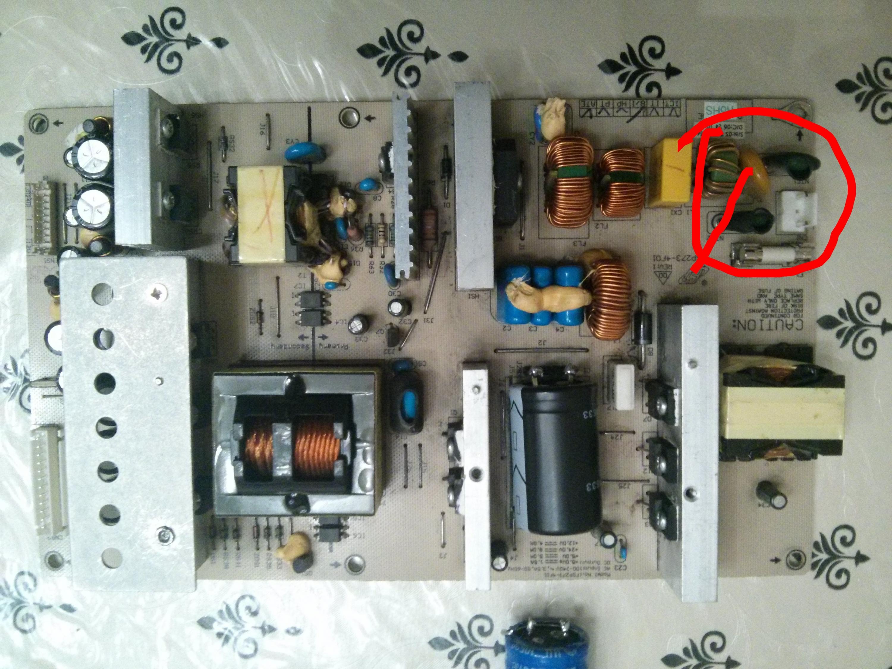

    I have tevion TV power supply

      Re: metal oxide varistor how to chack with multimeter
      On Tvr 14621
        Pic
          The MOV should measure open circuit. If it checks shorted, remove it. The power supply should work without it, but it should be replaced for continued protection.

            • 31290
            it's probably good, when they fail they usually explode and cover the area in soot!

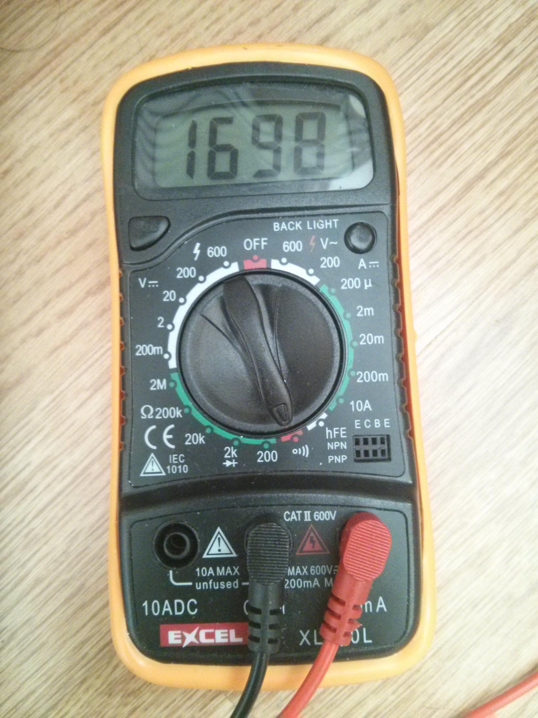

              When I chack mov with multimeter it not beeping it mean short?
                  Only show some number not beeping
                    does your meter have a beeper ?
                        Let's get to the point, what is the power supply or the TV not doing?
                        Are you getting any dc Voltage at the cold side connectors?
                        BTW, in beeping mode when it beeps it is telling you you have continuity between point A and point B, it does not mean what you are testing is bad or shorted out.
                        Use Ohm mode if you looking for shorts, but you need to know characteristic of components you are testing first.
                          If your meter is not beeping, and is showing 1968 with the leads shorted on continuity mode, then the leads or the meter is faulty...
                          Unplug the leads and short the input sockets together with a piece of wire. You should get a beep and a low number, almost zero...
                            maybe the battery is low - i'v never had a meter that indicated "low battery" BEFORE it started showing bullshit readings!
