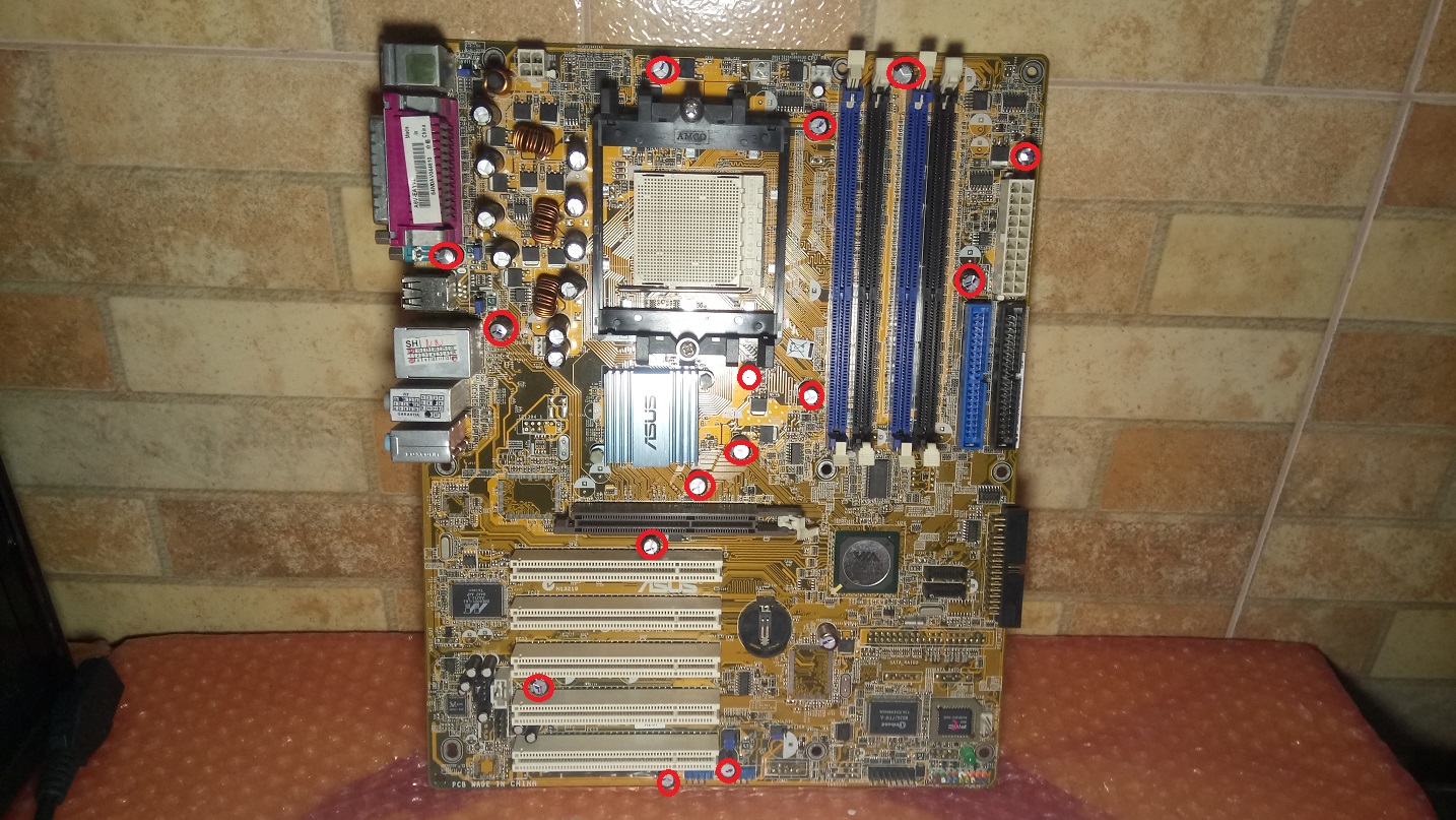

    Originally posted by ChaosLegionnaire
    for the asus a8v, i think u missed a cap near the cmos battery right by the mosfet. i have this exact same board and the cap and mosfet there actually regulates the 5vsb supply for the board. i recommend replacing that as well so u have 16 kzg caps to replace not 15.
    You're right! I've even marked it with a sharpie but forgot to red-circle it.

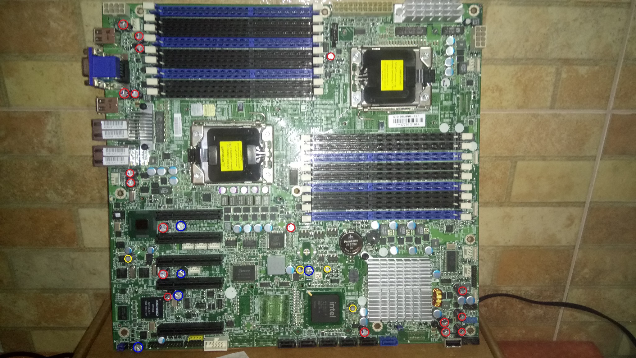

      Got one more board for cap replacing - actually it just came back from a repair lab, asked how much just to have the caps changed would cost me and they told me the job would be ~US$250 (about twice I paid on the board) and I'd like to hear suggestions on which caps to choose since I'm going to buy them all and start swapping from the easiest boards first (this one have a lot of SMDs on the back pretty close to the caps terminals). I've circled the different caps in different colors for easier reading since the picture quality is pretty terrible.
      TYAN S7012:
      NCC KZG (red circle):
      18x 470uF @ 16V
      NCC KY (yellow circle):
      4X 220UF @ 16V
      SUNCON (blue circle):
      5x 1000uF @ 6.3V

        Re: Swapping japanese/generic electrolythics with solid-states
        TYAN S7012:
        18x 470uF @ 16V
        4X 220UF @ 16V
        5x 1000uF @ 6.3V
        The KY's are probably fine... On my Tyan's I've recapped it's only been KZG's and KZJ's that I've replaced (other than an ancient dual slot 1 PII/PIII, that is).
        I'd replace the KZG's with Nichicon HN (Post 2005 stock only!) or HE, personally. I've used the former on several Tyans with good results (the boards had other issues, but the caps weren't the culprit).
            Thanks. I'm inclined to replace the KYs since I've seen one with a bulged "plug".
            KY is a very reliable series. I don't suggest replacing every KY cap. Maybe only the one that has bulged on the bottom, and that's if it really does look bad. Though I am inclined to think perhaps there is/was something else wrong for that cap to bulge.
            Also, the Suncon caps are actually Sanyo's. Depending on which series they are, you might not need to replace them. WF series tend to be fairly unreliable. WG is hit or miss (but somewhat okay). And WX is definitely okay. I'm not sure about their other series.
                  Updating the topic:
                  I've got a good desoldering tool now and I'm ready for changing the caps on the Asus (reattached picture for reference).
                  Marked caps: KZG (820uf @ 6.3V) (I've removed all of them already)
                  VRM near I/O are Panasonic FL (1000uF @ 16V).
                  VRM near CPU socket are Rubycon MBZ (1500uF @ 6.3V).
                  I've removed one of each for testing on my LCR and got the following:
                  MBZ: 1317 uF, 2% VLOSS, 0.06 ohms ESR
                  FL: 945 uF, 1.4% VLOSS, 0.07 ohms ESR
                  Should I replace the VRM caps too? (the readings seem pretty good for me)? If so, which models should I go for?
                  Thanks.

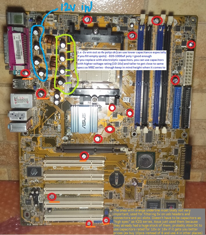

                      • mariushm
                        • May 2011
                        • 3799
                        #31
                        i wouldn't replace them.
                        the capacitors by back panel and agp and pci slots and bottom usb headers , they're all for filtering 5 rail locally, they just reused KZG series probably because they bought them in huge volume. they don't have to be as high spec as kzg series
                        replace with any 820uF -1000uF 6.3v or 10v or 16v very low esr seris..can use higher voltage rating , can go slightly higher in capacitance..

                            • mariushm
                              • May 2011
                              • 3799
                              #34
                              FL series is one of those "custom" / "on special order" / "on big customer request" series, and it's probably just a tweaked series to make the capacitors smaller diameter and taller (more suitable for VRMs and packed locations).
                              I would treat them as similar in specs to Panasonic FM series
                              see notes i put on the image:

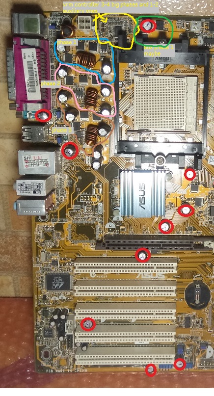

                                    • mariushm
                                      • May 2011
                                      • 3799
                                      #38
                                      @Snayperskaya
                                      If you look on your motherboard, you will see that he DC-DC converter (the VRM) that converts your 12v into the voltage your cpu is made out of a few almost identical "modules", which are called phases - there's a controller which sends pulses of energy to each of these phases and then the smaller voltage comes out from each of these phases and gets combined into the output capacitors to give the cpu a smooth voltage.
                                      You can see in the picture below ... i may be wrong at some points but in large it's correct... you see circled in yellow the vrm controller which monitors current and voltage output and sends pulses to phases as required, then you see the three phases (like 3 cylinders in a car engine) that work together to convert power.
                                      Each of these 3 main phases have a mosfet driver chip probably (the surface mount chip with 8 contacts), one or two input capacitors which act like buckets of energy, a high side and 1-2 low side mosfets (they use 2 to reduce losses and spread heat in a larger area), an inductor (that big coil of wire) and the output capacitor or capacitors.
                                      Near the cpu socket, all the outputs are joined together.
                                      On lots of motherboards you will see they often use 2 or 3 or even more capacitors for each phase, less on modern motherboards where they have now quality polymer capacitors.
                                      There's two main reasons they used so many electrolytic capacitors. Basically, the idea is to reduce as much as possible the ESR keeping in mind that over time, capacitors age and their technical specifications can degrade.
                                      When you install two capacitors in parallel, you get twice the capacitance but the ESR goes down in half, which is good.
                                      So the motherboard designer can reduce ESR in two ways... either install more capacitors in parallel (within reason, because too much capacitance can damage things), or install capacitors with lower ESR.
                                      The ESR is lower in direct proportion with the volume of the capacitor - the bigger the volume of the capacitor the lower the ESR. As a "side effect", typically with bigger volume you also get higher capacitance and higher voltage rating.
                                      So the motherboard manufacturer tries to get the lowest ESR by using capacitors that are bigger - in this case, they went with 1500uF 6.3v capacitors, even though they probably only need around 3-4000uF in total, and even though the maximum output voltage of the vrm is maybe 2v, which would have allowed use of capacitors with lower voltage rating.
                                      The problem is going bigger in volume is only possible up to a point, because the capacitors are so close to the socket you risk heatsinks and fans being blocked by the height of the capacitors. So motherboard manufacturers can only go so high and so big when it comes to capacitors and when they reach these limits they simply have to go with more smaller capacitors instead.
                                      On your particular motherboard, the designers probably designed the VRM to be stable and work fine as long as the ESR is somewhere let's say below 20 mOhm (keeping in mind degradation over time, board has to last at least the warranty period).
                                      By using only 3-4 MBZ series capacitors they probably figured something like this:
                                      Hey, these MBZ caps are very low esr high quality capacitors so we'll be fine with only so many of these, no need to put 2 in parallel at the output of each phase to reduce the ESR further.
                                      But, let's leave the capacitor locations on the motherboard, just in case we'll decide to use cheaper capacitors with higher ESR for this model in the future and then we'll have to install two in parallel to get the ESR below 20 mOhm. Or, maybe we'll want to reuse this VRM design on a "value" model of this board so instead of making the layout again, let's make the layout on this board and then we can just copy paste if needed.
                                      So stj says that FM is not "good enough" to replace FL and that FJ would be better.... Yeah, if you want to be strict about, theoretically FM would not be "perfect" replacement.
                                      But as I explained above, these boards are designed with some tolerance, with some accounting with degradation over time, so there is some percentage around those technical specifications where the motherboard will be perfectly happy with other capacitors. Things are NOT so super strict.
                                      If the VRM wants less than 15 mOhm to be happy and the MBZ give it < 8 mOhm and the FM series will give it < 10 mOhm then who cares, both series are less than 15 mOhm
                                      And if you install more capacitors, as they're in parallel on the motherboard, you're reducing the ESR even further, so you could get actually better performance with not quite as perfect capacitors.
                                      If you go with polymer capacitors (recycled from other broken motherboards or whatever), those have technical specs even better than those original electrolytical capacitors.
                                      So don't worry so much.
                                      I'd suggest avoiding NCC KZG series,as it's a series that's problematic... for a long time, they tended to go bad even when components were not in use.
                                      Panasonic FM is fine, Nichicon HD is a bit too low end, not suitable for VRMs. They can be used in those places I highlighted with orange, in those less important places, but anywhere else you must use better series like FM .
