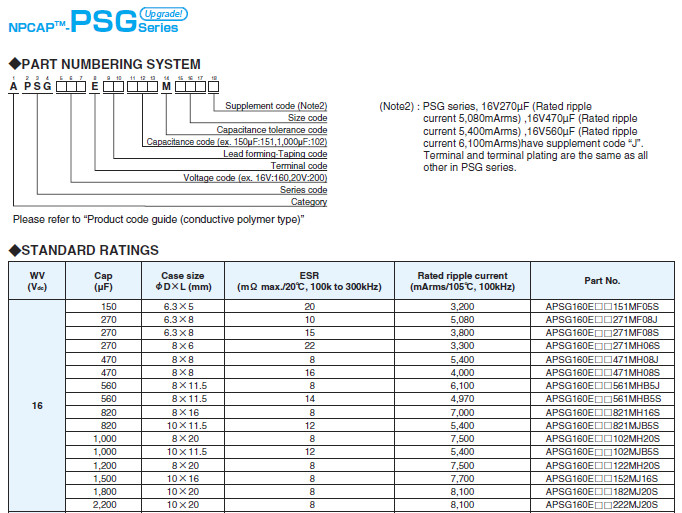

    United Chemi-Con PSG with 20,000h endurance!
    Was browsing Mouser looking to get some new 1500uF 10v caps in 10x16mm size to replace UCC KZG and Nichicon HM rated at 0.018Ω ESR and 2000mA ripple.
    No such caps in electrolytic versions really exist from reputable brands anymore.
    So I looked at the solid polymer range and came across the updated version of the UCC PSG.
    It's rated for 0.008Ω ESR and 7700mA ripple with an endurance of 20000h, that is 10 times the endurance of the KZG & HM electrolytics!
    Have not seen anything like that before!
    I have been using Sanyo SEPC 820uF 4v solid polymers in place, they are rated for 0.007Ω ESR and 6640mA ripple, but "just" 5000h endurance.
    Might actually get the 1000uF version of the UCC PSG next time I order, as it's ESR is slightly higher at 0.012Ω putting it closer to the originals
    If Z height is no objection then the electrolytic Panasonic FR 1500uF 16v at 10x20mm with 0.020Ω ESR and 2180mA ripple is a given choice.
    Being rated at 10000h it's a pretty much identical replacement.
    But as can be seen in the picture that can not always be used everywhere

    Re: United Chemi-Con PSG with 20 000h endurance!
    You're a Mouser Browser?
    More seriously, back when I was looking at polymers for Curtis Inst. they were usually rated for 2000 hours. They've come a long way!

          Yeah, Chemi-con has been rating their polymers for 15,000 hours - 20,000 hours at 105ºC at the rated voltage for a while now. That’s not at the rated ripple current, however, which would increase the core temperature (in the case of polymers since they are rated for very high ripple ratings) an additional 20ºC (105ºC polymers have a maximum core temperature of 125ºC), thus decreasing the lifespan to 1,500 - 2,000 hours.
          Nichicon confirms this much, if you use Nichicon’s online capacitor calculator and put in the maximum rated ripple current in both ripple current fields, then calculate the results. In accordance to this document by Chemi-con, the formula for calculating life expectancy for polymers is different to that of electrolytics (pages 11 and 12). A polymer’s lifespan will increase 10x per 20ºC drop (although polymers that are sealed with rubber are still only rated for 15 years max, in accordance to that calculator and Chemi-con).

                          Re: United Chemi-Con PSG with 20,000h endurance!
                          That's very good information as always, didn't know that!
                          Of course I can understand why they did it, in one way it's unfair.
                          But it depends how you look at it.
                          Since the PSG caps in my example are rated for 4x the ripple of the KZG or HM caps they would be replacing of course they will not be exposed to that kind of ripple current.
                          So in all likelyhood they will last longer than I will
                                  Wow! Those nice fat PSG series polymer makes perfect replacements for some larger 16v KZG-class caps (8x16 to 10x20).
                                    Well if what Wester says is true, the actual endurance is NOT listed at temperature AND ripple, and by recalculating it, you get the same 2000 hours…is it a much difference than?
                                    • Wester547
                                      • Nov 2011
                                      • 1268
                                      • USA.
                                      At temperatures below 105ºC, yes. Because again, the temperature coefficient for electrolytics is 2x the lifespan per 10ºC drop, and for polymers, it's 10x the lifespan per 20ºC drop.
                                      • Behemot
                                        • 4845
                                        • CZ
                                        Well according to my math, it makes 15 years at 55 °C for Suncon WG 10x23 and 22831 years for the PSGs at 2000 hours (real). So I think pretty much the same, 15+ years for MoBo? Like srsly?
