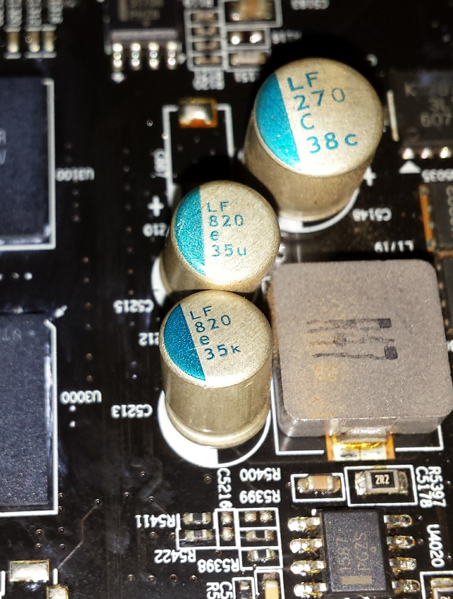

    Hi everyone
    I have a gpu and I need to order a new cap for it. On the top its labeled
    LF 820 e 35u. I was given this link for the same cap but it's 35k (http://au.rs-online.com/web/p/alumin...itors/5252600/)
    Thank you in advanced for the help

    Re: Trying to identify this cap
    Looks like it's a Nichicon LF series polymer cap.
    "820" = 820uF
    "e" = 2.5 V
    "35k" and "35u" = Lot codes

        e represents 2.5 v, but as far as I know, three letter code for all capacitors use AB * C pf technique. Here 820 will be 82 pF instead of 820 uF. Check this calculator: http://www.electricalcalculators.org...or-calculator/ It is for ceramic but code is same for all caps though.

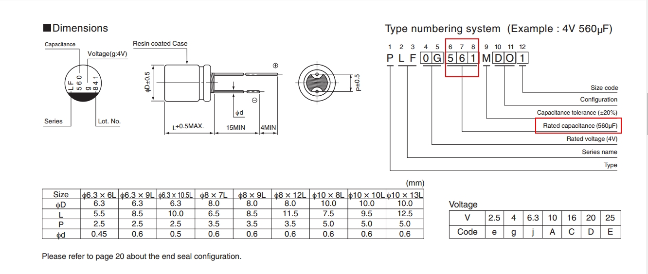

          Not for all capacitors. And not all manufacturers use the same marking code system printed on the cap
          And per spec sheet:
          I.E.
          560 = 56uF
          561 = 560uf
          So per spec sheet '820' = 82uF

            Per spec sheet 560=560 uF of course. Read it again, part numbering system for ordering and BOX LABEL printing (on the right) has nothing in commonwith the CAP CAN numbering (on the left), does it.

              Easy enough to actually measure the capacitance.
              I wonder what the 1500uF will be marked with '1500' or '152', I would say '152', but who knows for sure.
              I will see if I can download the full catalog that will explain the marking system.

                  Per the LF series datasheet, there is no 82uF, 2.5V part in the series.
                  I've seen the number system Techgeeky mentioned used on ceramic, film, and some tantalum caps, but not on electrolytics. Obviously my experience is not exhaustive. I think I've seen electrolytics as low as 100,000pF (= .1uF), but I seriously doubt an 82pF electrolytic cap has ever been made.
