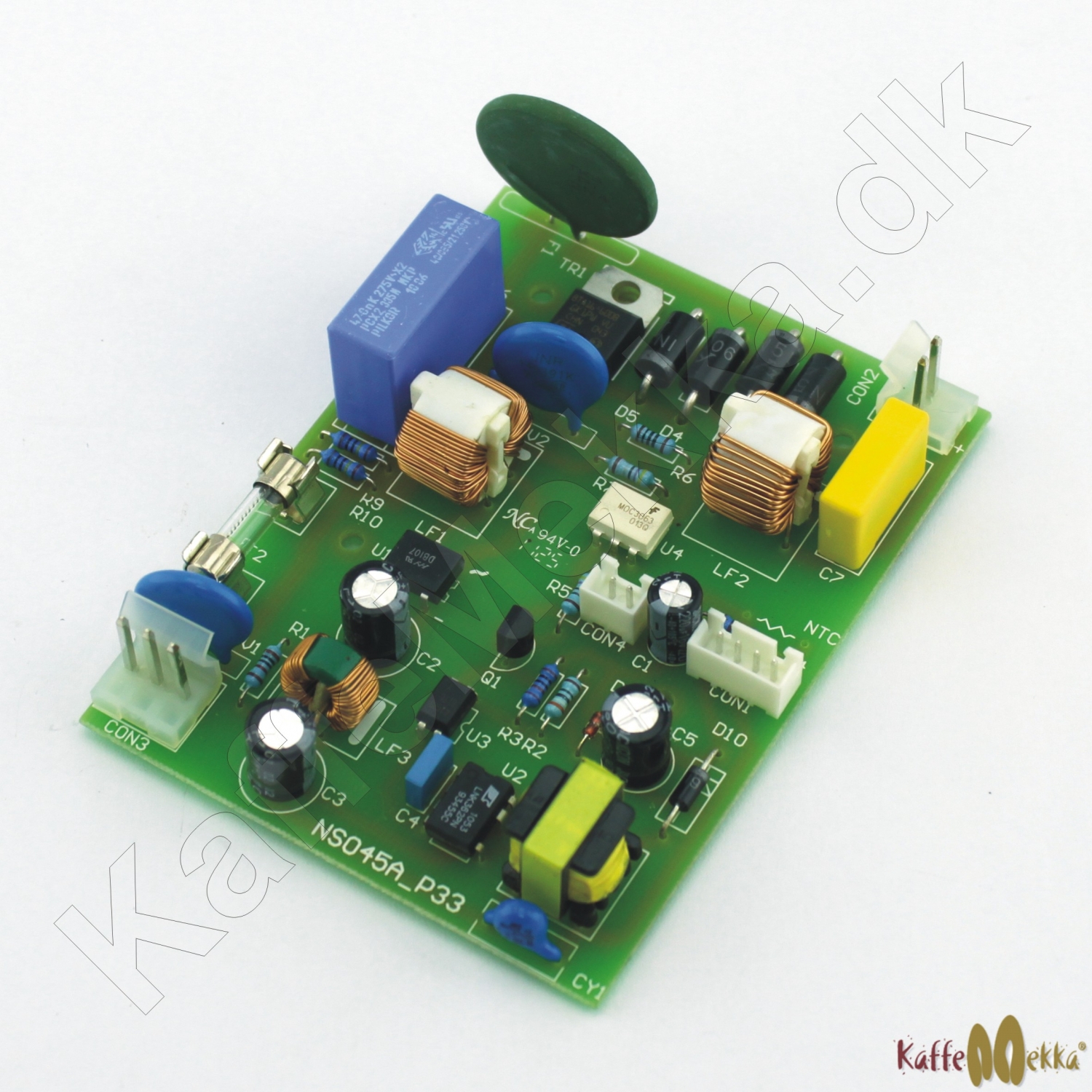

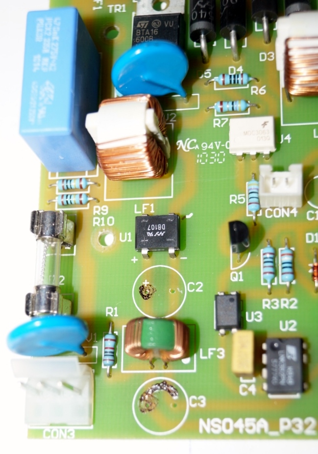

Panasonic NHG caps suitable for starter cap?
  • mikay786
    • Aug 2014
    • 765
    Jamicon 4.7uf 400v - exploded
    Have got a couple Panasonic NHG caps in same value, would they be suitable replacements? Starter cap, one at the bottom. Connector next to it is AC in.
    • Jul 2011
    • 6059
    Re: Panasonic NHG caps suitable for starter cap?
    I do not see any reason why you can not use them
    It might be better if you used 450 volt caps instead 400 volt
    If the diameter is the right size and if it is not to tall
    • mikay786
      • Aug 2014
      • 765
      Man these caps must be terrible, two of them have spilt their guts underneath and one exploded.
      Not Jamicon as stated above but Jackcon caps
      2 x Jackcon 4.7uf 400v that have leaked
