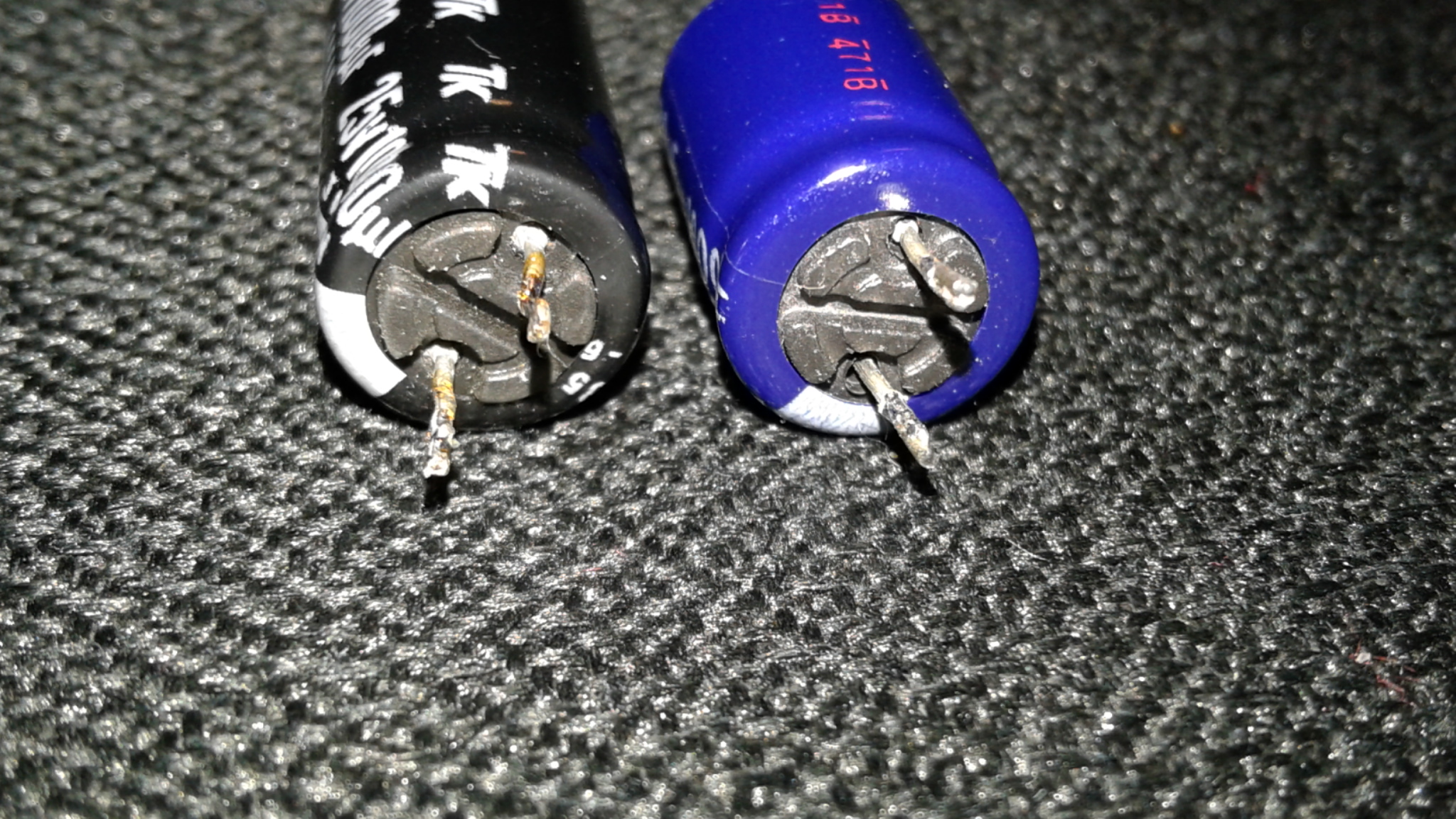

                      Ruky con : TK ... not so good, but better than no name chinese stuff.

                        Okay, i was just curious because i found some that say JAPAN on them and the rubber plug on the bottom looks just like the one panasonic uses.
