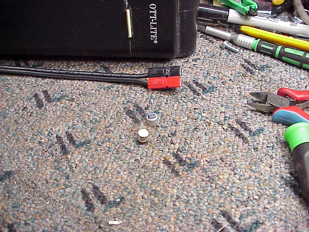

anyone ever i.d these ??polys???
  • kc8adu
    • Nov 2003
    • 8832
    • U.S.A!
    so far not much on that capacitor web site.
    anyone ever id these
  • zandrax
    Hit and miss
    • Dec 2007
    • 1157
    • Italy

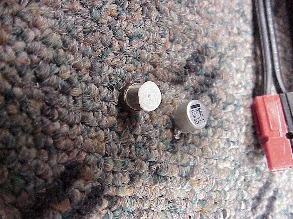

    Re: anyone ever i.d these ??polys???
    Maybe a sleeveless United Chemicon FL? The FL mark on the top lead me to Hardware secrets' forum: a member posted the image of a vrm with similar caps and claimed those may be NCC FL series; anyway 680 uF seems too much for a ventless lytic, so I should be wrong.
    Zandrax
    Have an happy life.
    • kc8adu
      • Nov 2003
      • 8832
      • U.S.A!
      well i pulled one to sacrifice.
      they are a wet lytic.
      going to replace with polys.
      • andlcs
        • Feb 2007
        • 22
        Looks like it's Matsushita FL series:
        http://capacitor.web.fc2.com/solidca...#zzz_panasonic
        I think I found the same capacitor but this time sleeved, take a look:
        Pics are from the MSI K9V Neo-V board. The last picture is the same board but newer revision.
        • kc8adu
          • Nov 2003
          • 8832
          • U.S.A!
          i had a hp/usus board in last week with jacketed fl.
          looks like many mfr's are loosing the jackets to be rohs compliant.
          • linuxguru
            • Apr 2005
            • 1564
            Has anybody got official datasheets for the FL, and are the specs any better than FJ? I've seen sleeved FLs on a lot of motherboards.
