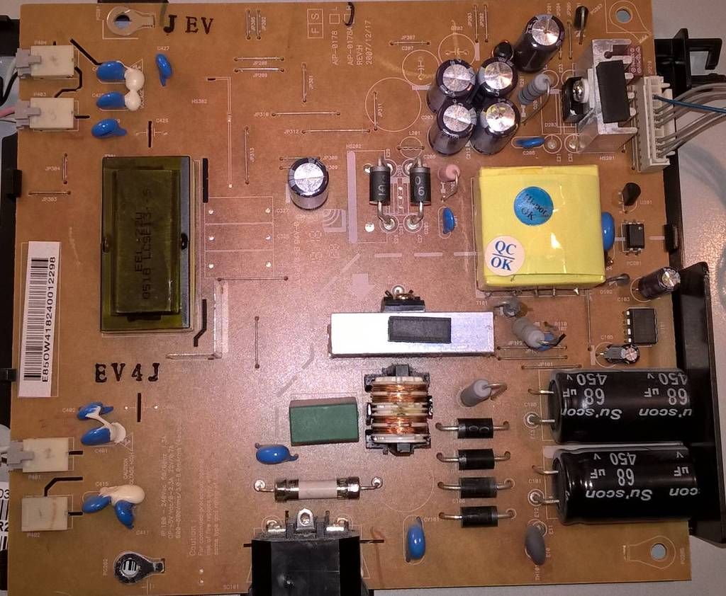

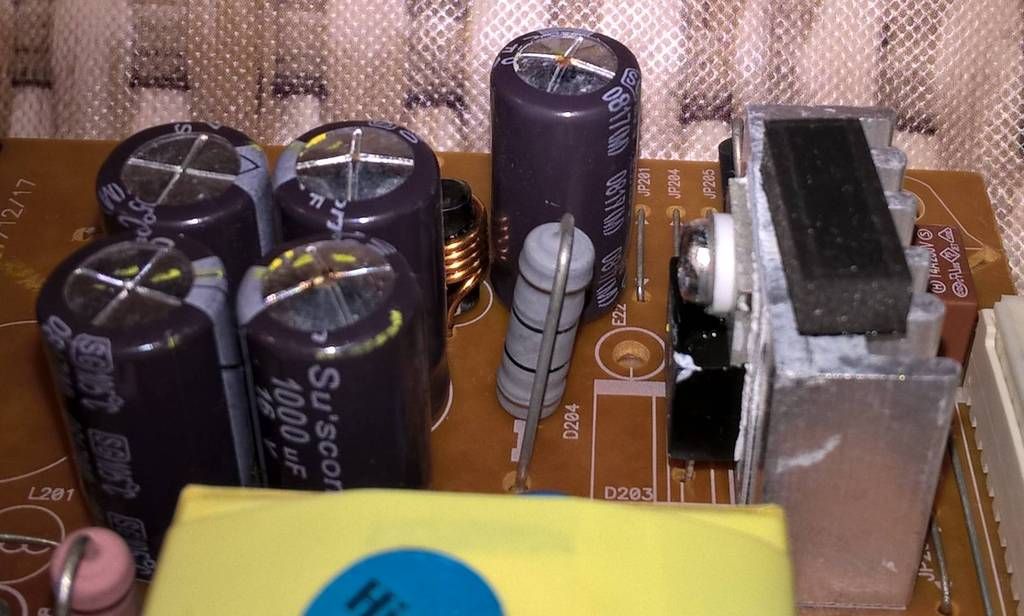

    This is for an lcd monitor that won't power on. At least 3 Su'scon caps have gone bad and I plan on replacing them all.
    Su'scon 1000uF, 16V, 10x20mm, SG Series (R.C.=1820)
    Su'scon 470uF, 35V, 10x20mm, SG Series (R.C.=1820)
    Su'scon 33uF, 50V, 6x11mm, SG Series (R.C.= ?)
    Su'scon .22uF, 50V, 5x11mm, SK Series (R.C.=11 ?)
    This is what I planned on replacing the Su'scons with:
    1000uF -> Nichicon UDH Series - UHD1C102MPD (R.C.=1820)
    470uF -> Nichicon UHD Series - UHD1V471MPD (R.C.=1820)
    33uF -> Nichicon UPW Series - UPW1H330MED (R.C.=300)
    .22uF -> Nichicon UVZ Series - UVZ1HR22MDD (R.C.=4.3)
    The problem I have is that I'm not sure on the ripple for the Su'scon 33uf and .22uF so I don't know if what I listed above is a good match. The Su'scon SG data sheet doesn't list the 33uF/50V and in SK data sheet the .22uF/50V is grouped as: .1-.47uF ripple=11.

    looks good.

      Any concern about the ripple current on the Nichicon 33uF and .22uF perhaps not being up to spec? I'm not sure if that's the case since like I mentioned before I can find the full specs on those 2 Su'scons.
        • 31156
        Re: Finding replacements for Su'scon caps
        33uf is probably about 260ma
        the 0.22 is 11ma, i would replace it with a film cap like a polypropylene

            Really, why you care?
            The truth is that even a brand new Sus'son doesn't match spec, they've declared.
            It was a long time ago where I tried to replace one cap on a mobo with Sus'con. The result was instant blue screens after this replacement. I bought the yellow series of the Hitano - there were no problems at all.
            So, everything is better than Sus'con and Capxon. Doesn't matter what you will put on their place, it would be 100% better.

                I have the same problem as you guys. My LCD didn't light up. I replaced the 5 su'scon 1000mf 16V caps with 16V 1000mf Chongx VENT. My monitor went up but after 2 seconds, caps exploded. Can someone help me. Probably related to the ripple current. The other one were a little bit smaller as well.

                  if they exploded leaving guts everywhere, then you put them in backwards
                  if they simply popped and smoked, you used bad capacitors that were lies at their quality. ChongX is of dubious quality if not simply bad.
                  Get quality capacitors and you'll be fine.
