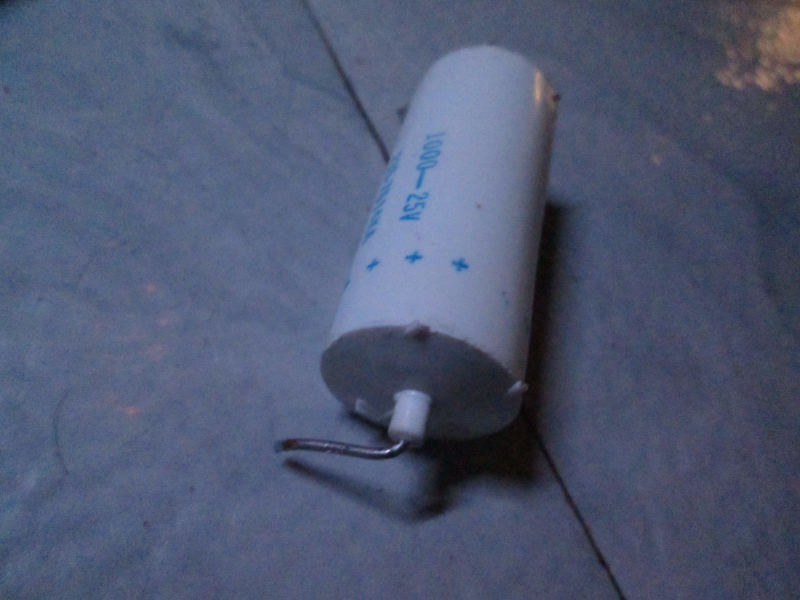

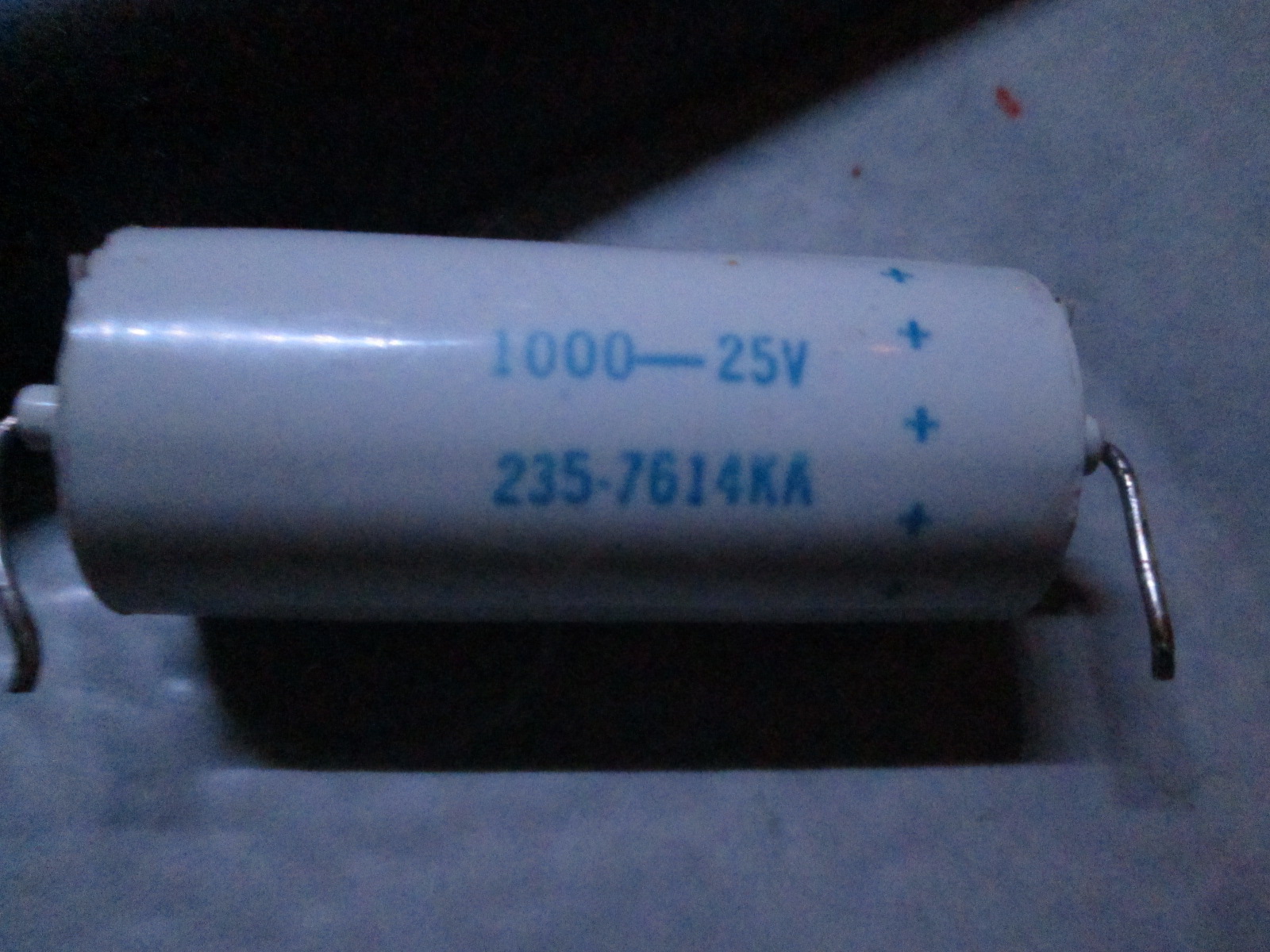

Can anyone identify these?
  • Cartel
    • Feb 2006
    • 112
    I would guess heat resistance but can't find a replacement.
    1000uf 25v

    Re: Can anyone identify these?
    1000uf 25v Film cap i think.
    EDIT: Derp, those don't exist. Ill leave now.

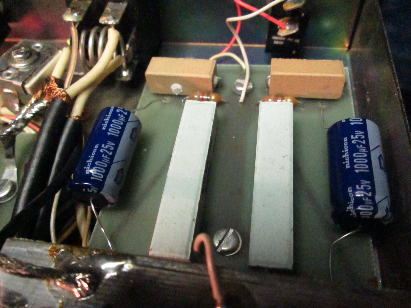

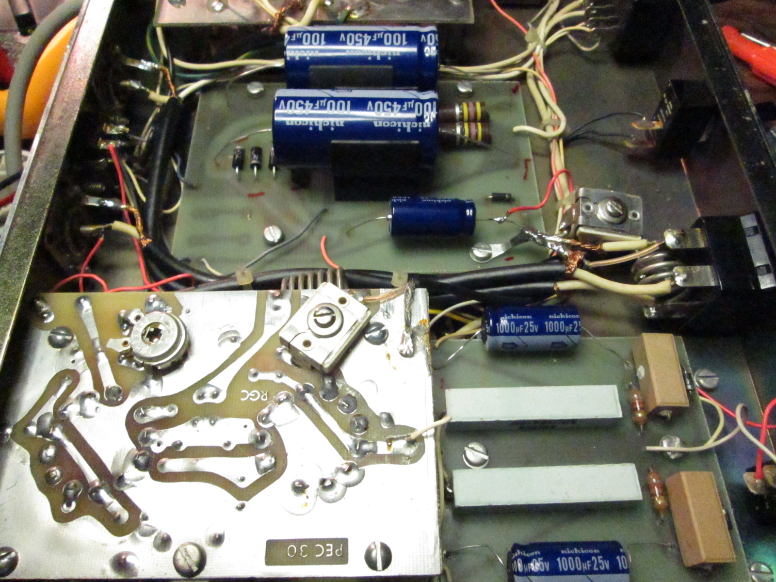

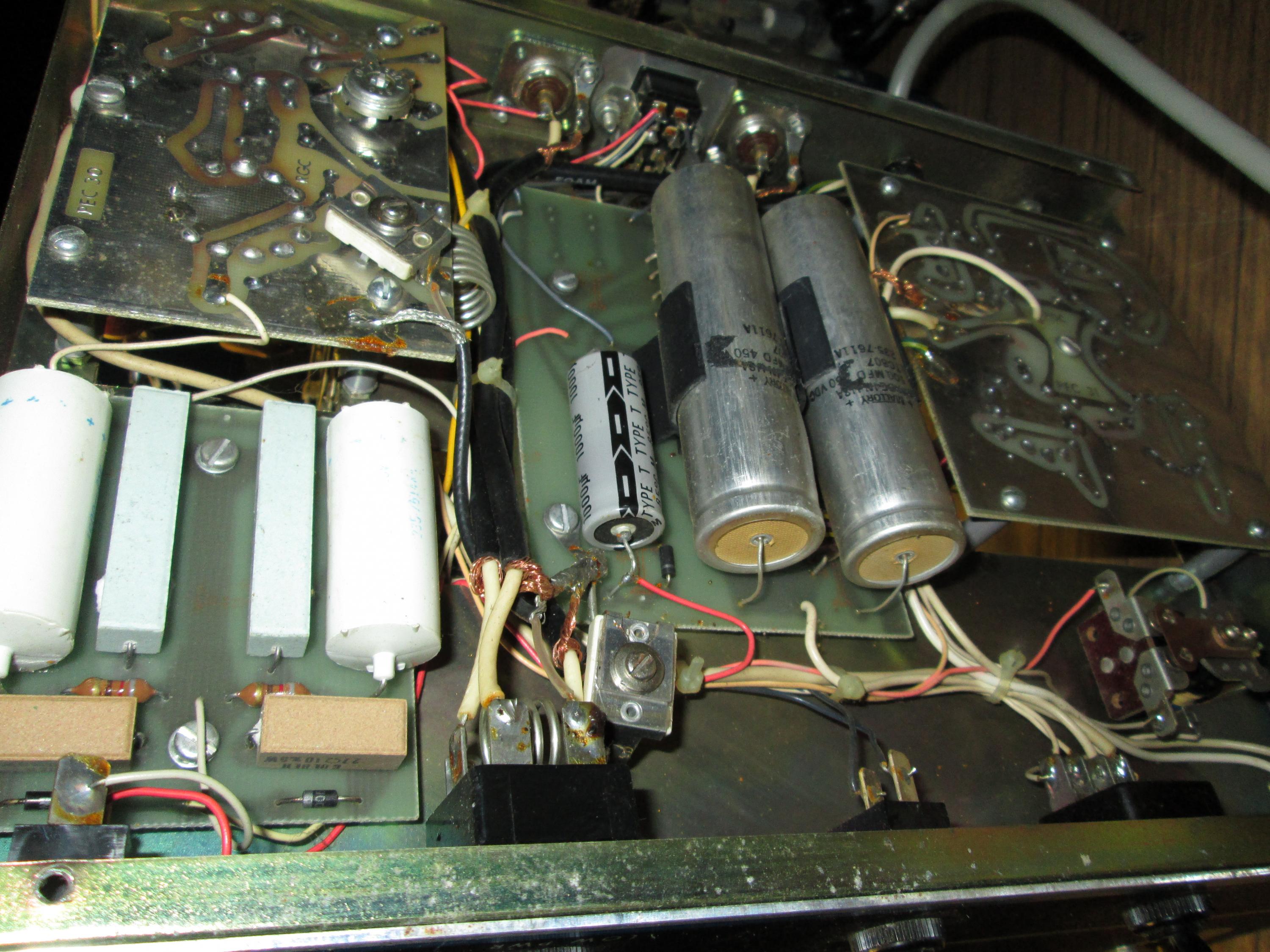

      they go here beside these sandblocks.
      I bought nichicons but now I'm thinking twice....maybe some heat resistant sleeves or something would work.
        Tube gear? If so they may be plastic encapsulated lytics.
        Follow the white rabbit.
          • 31278
          i think they are encapsulated electrolytics.
          in the early days there where a number of attempts to stop them leaking ranging from putting epoxy over the bung or dipping the whole cap in epoxy to putting them in plastic boxes.
          the russians (USSR) also tried the expensive method of using a solid plastic bung with a seperate rubber gasket.
          that actually worked btw, i have never seen one of those leaked - but it's expensive to make.
          what does a cap meter say?
          if your sure it's fucked then cut it open and see what's inside.

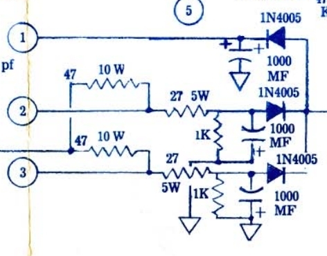

            tester says 1184uf 3.8ohms
            new nichicon is 938uf 0.17ohms
            schematics shows electrolytic.
            the new caps are smaller so maybe I can push them away and put an asbestos sock thing over them.
              • 31278
              airflow would help more - maybe you can stick a small (40-60mm) fan inside just to move the air around and avoid hotspots.
              • redwire
                • Dec 2010
                • 3912
                Newer electrolytics are so much smaller, I'd move them away from the power resistors even 1/2" away helps alot. I use a dab of silicone sealant to tack them down.
                The old caps are from a day of sealing them 100% for long life. Until. they. go .pop.
                  Hopefully that does it.

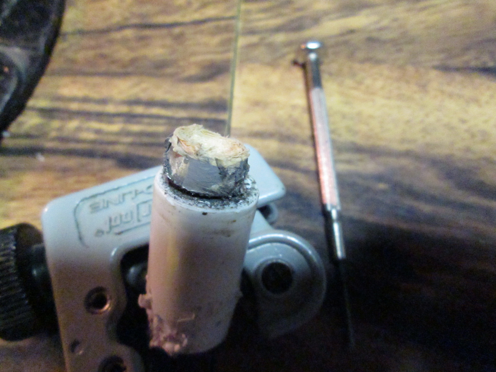

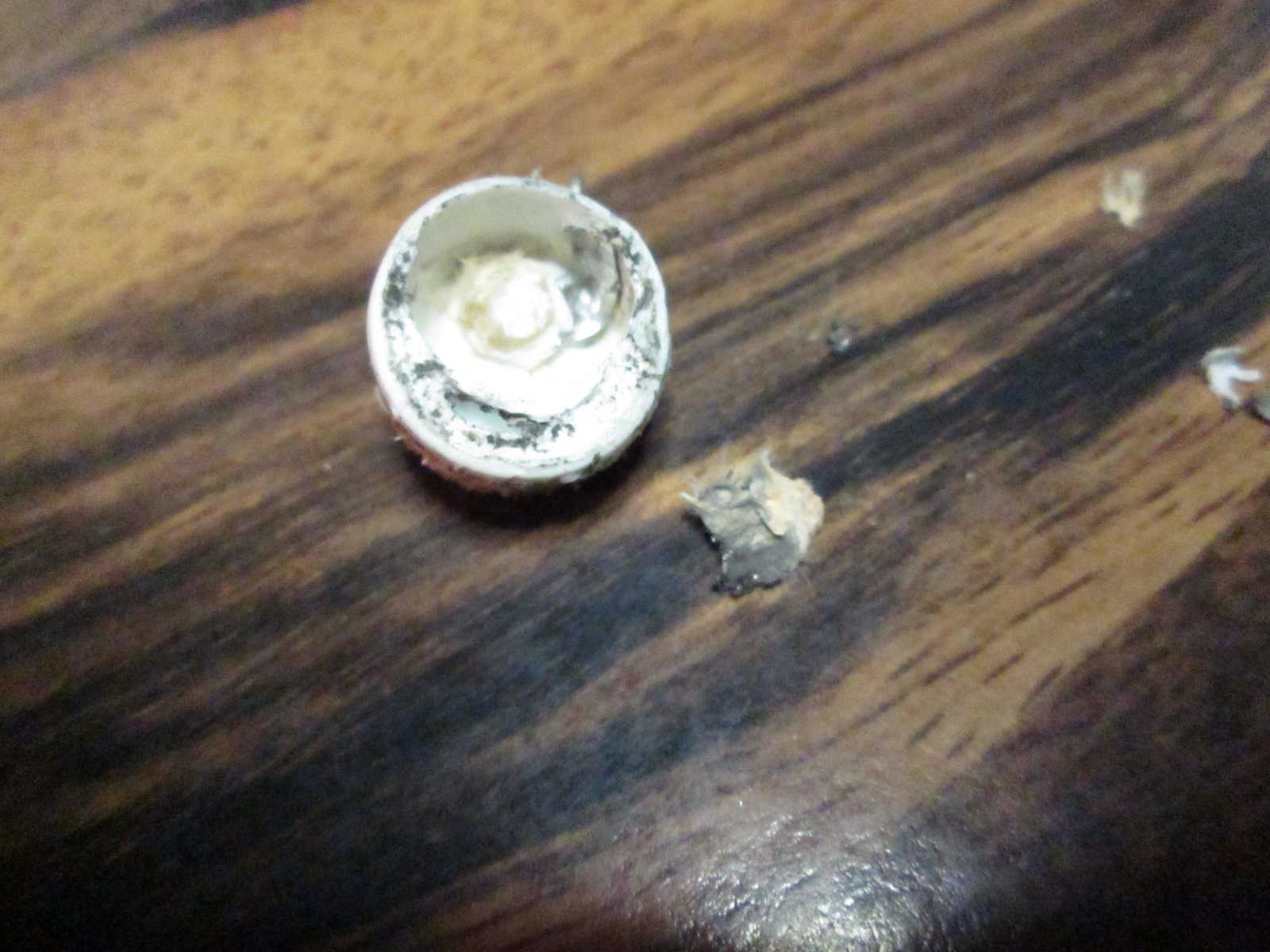

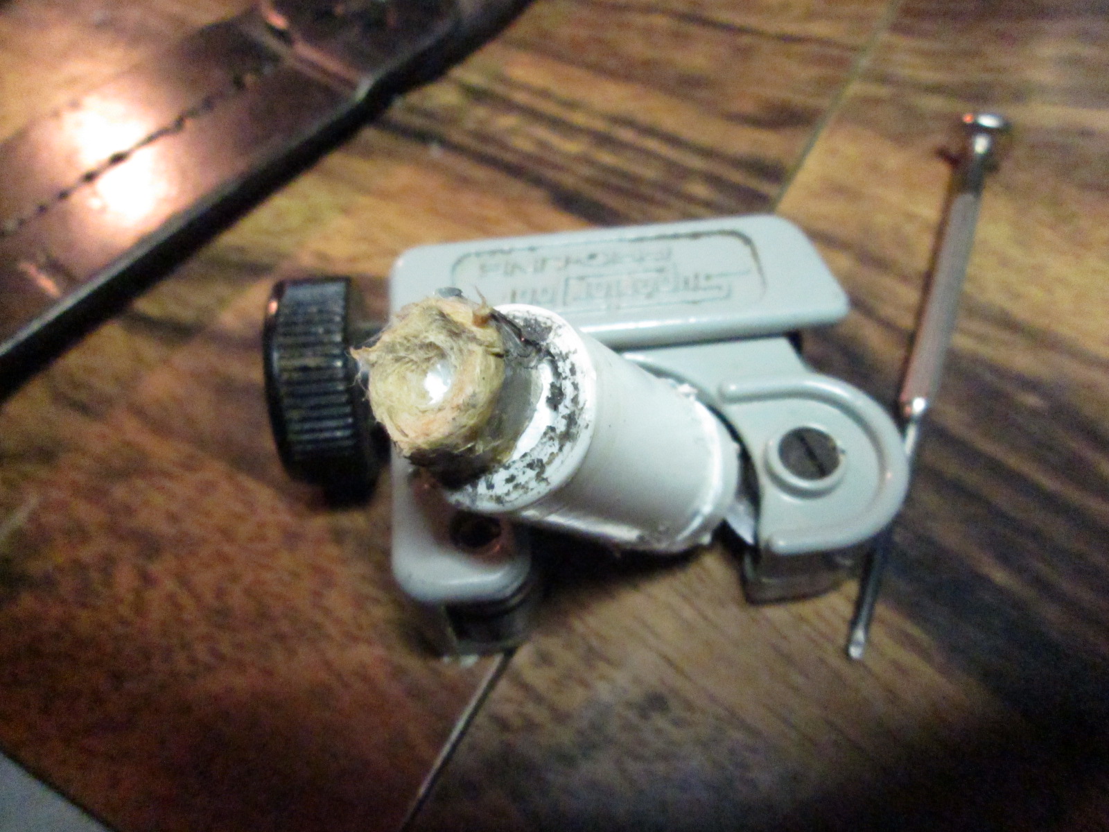

                    This was ridiculously hard to get open.....Electrolytic I guess.
                      • 31278
                      yes, and surprisingly thick plastic!
