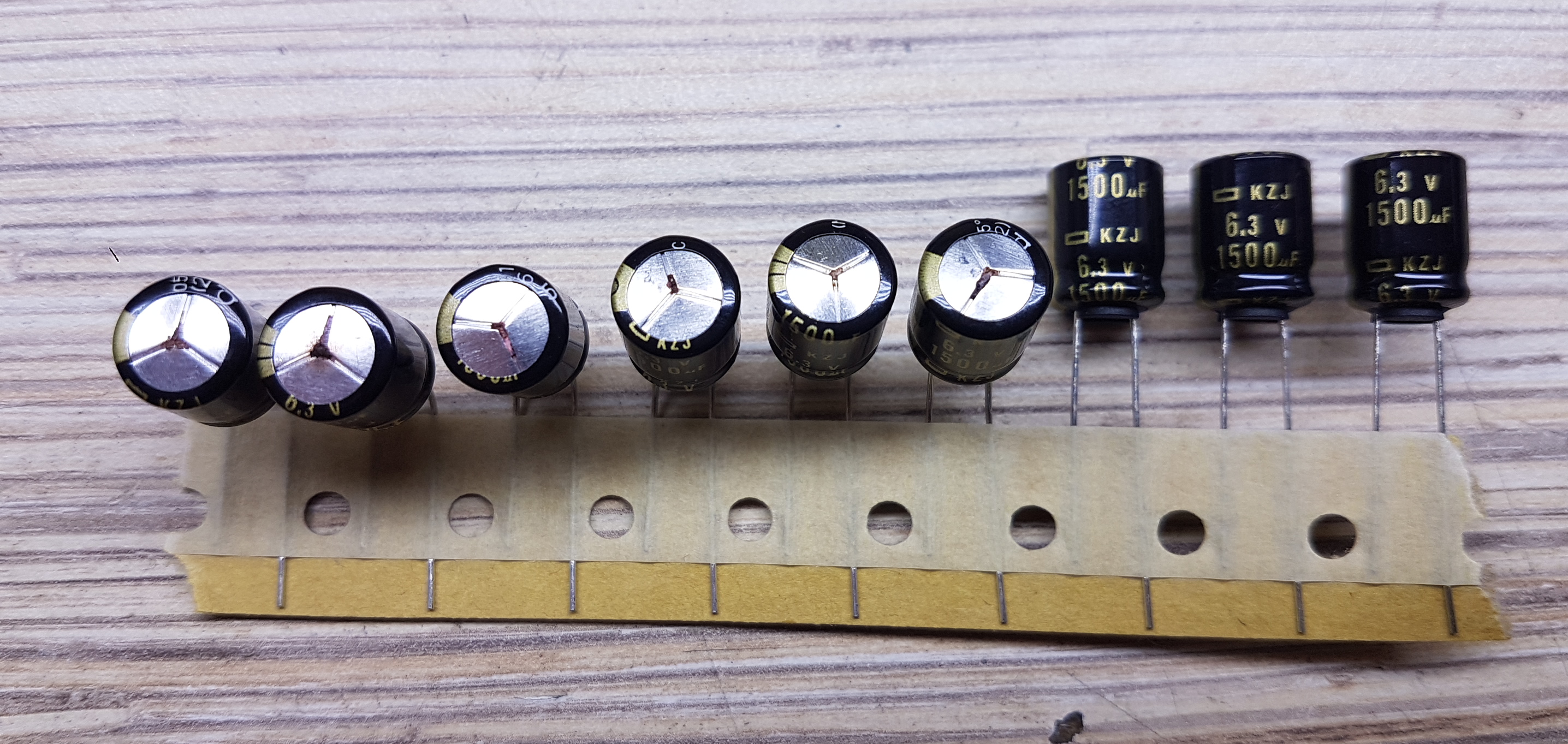

          KZJ are a really bad capacitors.
          They blown up during storage in good conditions.
          See photo.

            ^ Yup, both KZG and KZJ employ an electrolytic formula that's so dreck it generates volatile amounts of gas even in NOS capacitors, a la GSC and Fuhjyyu.
            And I think the OP missed something in the UCC KZG datasheet.
            The KZG series is a new ultra low impedance series from United Chemi-Con. These capacitors are different from the standard low impedance capacitors, as they use a new low resistivity electrolyte. Compared to our KZE series that also uses this advanced electrolyte technology, the KZG series has lower ESR/impedance ratings, making them ideal for use in computer board circuits where very low impedance capacitors are required.
            I know I've said this before. I just thought it should go in this thread. What this probably means (in KZE's case), since KZE has a very good track record (unlike KZG and KZJ), is that the resemblance the electrolyte bears may be superficial.

                Re: KZG - KZJ - Same Electrolyte
                Originally posted by Wester547
                ... What this probably means (in KZE's case), since KZE has a very good track record (unlike KZG and KZJ), is that the resemblance the electrolyte bears may be superficial.
                I don't know if the origin (manufacturing plant) of the electrolyte and foil have a bearing on reliability, but it seems that some batches of KZGs don't fail as much as others. KZE and KZN also appear not to fail at all.
                The difference may be a crucial stabilizer/getter that was omitted in KZG/KZJ, or conversely, some trace contaminant in KZG/KZJ that is not present in KZE/KZN.
                • Wester547
                  • Nov 2011
                  • 1268
                  • USA.
                  #68
                  I don't think it does in NCC's case, because according to NCC's website, they own 100% of most of their plants, except for Indonesia (who K-CC/Samyoung owns 10% of), Samyoung (whom they only own 33.4% of) and Marcon (whom they only own 20% of). I'm pretty sure NCC import most if not all their materials from Japan as well, and KDK Corp (Hitachi Electrolytic Foil Research Co. Ltd), their subsidiary which manufactures ultra-high purity anodic and cathodic aluminum foil (99.8-99.98%), is their source for all production of aluminum foil for capacitors. And according to UCC, they are completely autonomous regarding their materials (IE, all materials are produced in-house, essentially, except for the chemicals NCC use to create the electrolyte itself - those are sourced from Tomiyama Pure Chemicals).
                  As for why some may seem to fail less than others... I guess that depends upon several factors. One of which is the condition of the anodic dielectric. A faulty electrolytic composition cannot properly heal the dielectric (or provide enough oxygen to "wet" weak spots), so even if KZG and KZJ do measure good for ESR and capacitance, once a weak spot in the dielectric appears, it could cause a permanent short in any otherwise "good" capacitor. But if the dielectric's condition remains good, this may never happen. As the porous dielectric deteriorates in storage from the diffusion or penetration of ionic particles from the electrolyte, the issue is only exacerbated.
                  The other factor I can think of is the rate at which molecules of gaseous hydrogen escape by way of rubber seal diffusion. If it doesn't happen rapidly, there won't be enough vapor pressure to rupture the cans or cause a difference in appearance and they'll silently drift out-of-spec as the electrolyte vaporizes and the water electrolyzes. Of course heat will accelerate the diffusion rate or the rate of evaporation, and if the thermal gradient is high (the speed of the internal temperature rise, AKA high ripple current loads), that will significantly shorten the life of the cap.
                  Same goes for KY/KZM/KZH, at least in my experience. But KY, KZM, and KZN are rated to withstand up to 10,000 hours at 105ºC (with the maximum rated ripple current applied, for larger parts) - I would expect them to have greater chemical stability. KZE and KZH are rated up to 5,000 and 6,000 hours (under the same conditions) for larger parts, so I would expect them to do better.
                  I think if the electrolyte was contaminated in any way or if some stabilizing neutralizer or scavenger was somehow absent from the electrolyte (that would cause hydrogen gas generation at the cathode), it should have been caught during factory testing (the electrolyte is synthesized in dry rooms where no human breath is permitted). Since KZG and KZJ degrade much faster (not just visibly but spec-wise) than all of NCC's other series, after the endurance test, IMO NCC should have seen that they were probably creeping towards the limits of their parameters (leakage current, dissipation factor, capacitance, ESR) and thereafter improvements could have been made upon the electrolytic composition, even if a small percentage of the caps are allowed to fail the endurance tests.
                  But I guess when you're producing thousand of series and hundreds of millions of capacitors per month (billions per year), only so much can be done. KZG/KZJ and all ultra-low-Z variants from NCC were discontinued a while back anyway, completely usurped by their NPCAP conductive functional polymer line.
