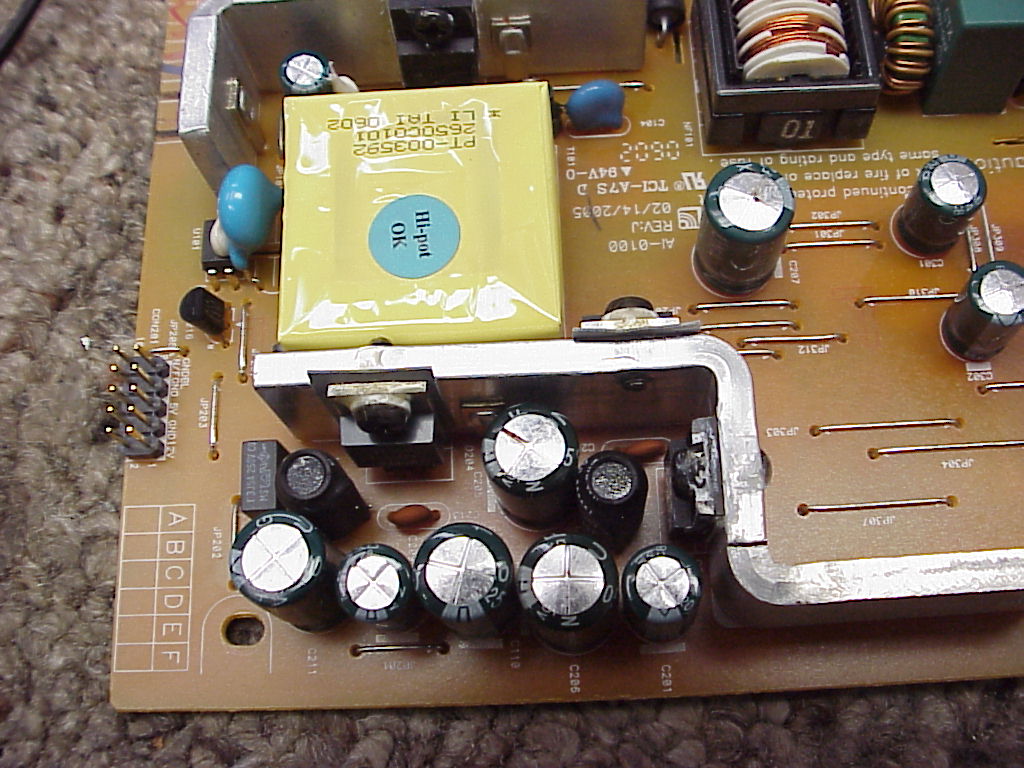

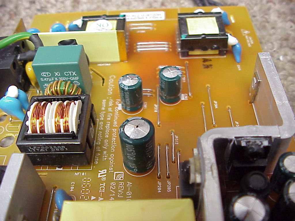

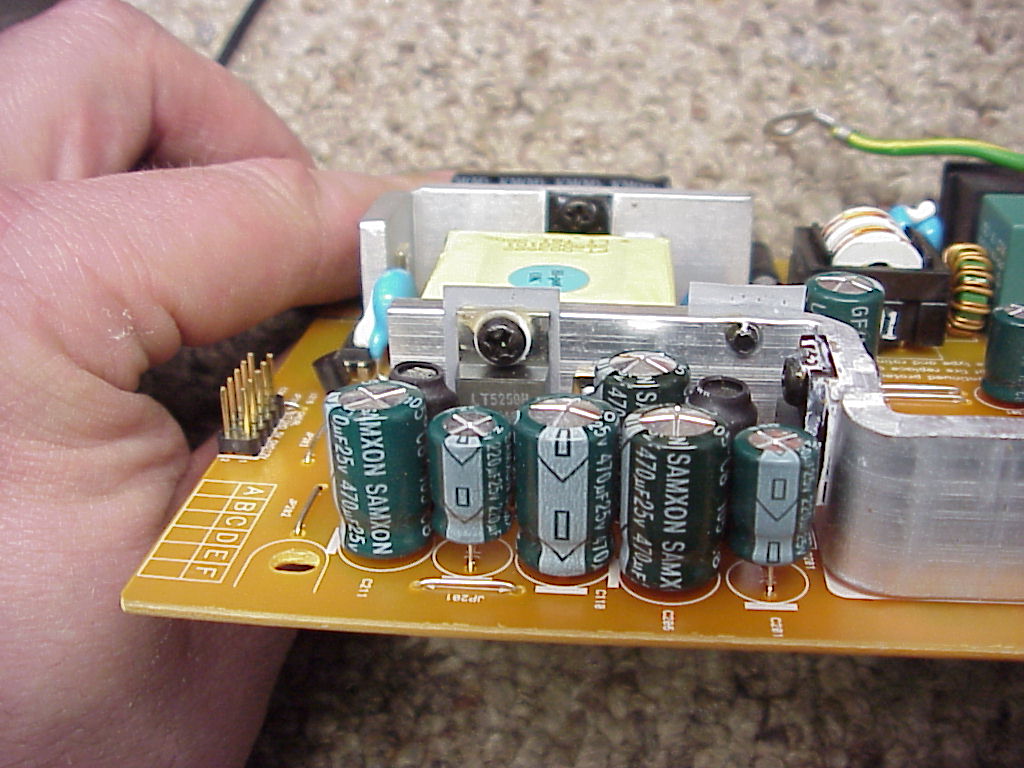

samxon gf.2006 gateway 19"lcd
  • kc8adu
    • Nov 2003
    • 8832
    • U.S.A!
    this is the 4th one of these i have had in here.
    samxon gf.
    all blown.

    Re: samxon gf.2006 gateway 19"lcd
    so is samxon a good brand or not?
    hehe...
    • Big Pope
      Approved Vendor
      • Dec 2005
      • 426
      Samxon GF 470uF 25V is known issues batch in LCD monitors in the past. There is same problem which mentioned on some threads here before, just search "Samxon GF" here.
