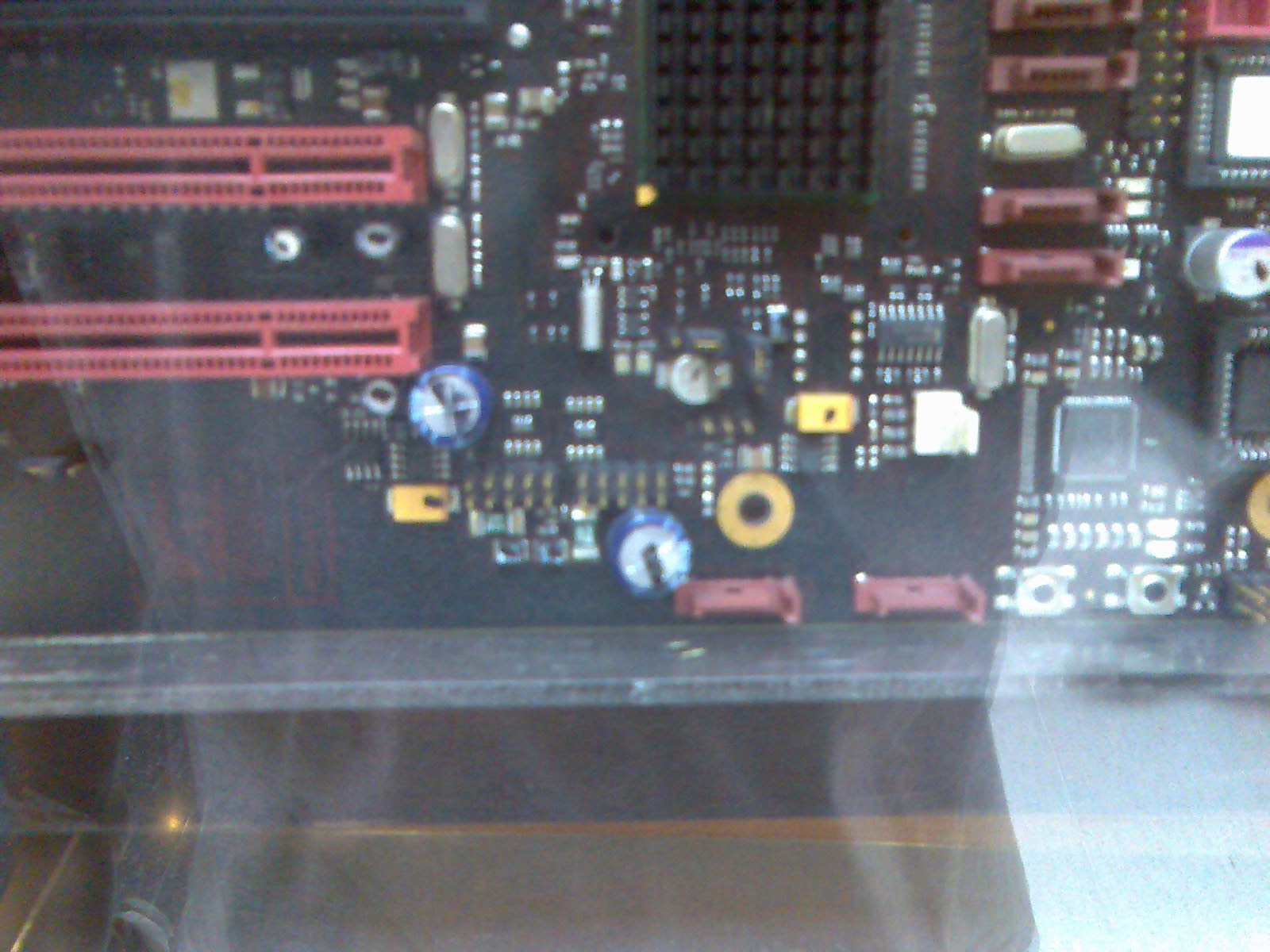

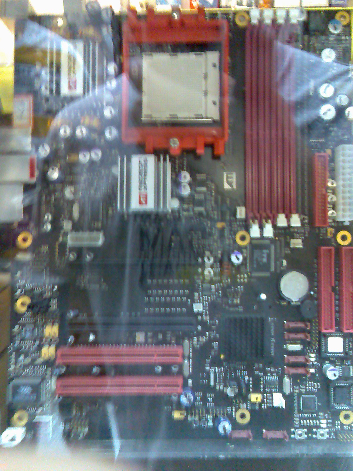

    Hello Everyone,
    I was in the Sydney city CBD yesterday going out with a friend of mine and I managed to stumble upon a computer store.
    This is what I saw in the store window and it seemed quite concerning that this display motherboard which was never used before has bad caps!.
    I couldn't believe it but it was true, it indeed had bulging caps (no leaking).... I confirmed the board was not used because the CPU, RAM and expension slots and sockets do not have any marking of being used before. I don't know what brand/ model this motherboard this is, so here are a few pirctures attached. Sorry about the really bad quality, I was using my Nokia 6234 mobile phone with a 2 megapixel camera to take these pictures.
    The caps are Nichicon HM(M) with date codes 0434. The large black ones are 3300uf 6.3V and the smaller blue ones are 1500uf 6.3V?.
    Has anyone seen anything similar? like caps that are never used and are bad.
    I can't identify what brand/ model the motherboard was, but I know it has two ATi Radeon chipsets, is black in colour, socket AM2 (or 939?) and has a large ATi logo silkscreened onto it.
    Thanks.

      cant tell much from your pic other than its a 939 or am2 from ati.

        First I've heard of unused Nichicon HM bulging, but it's a 2004 date code, so anything is possible. The most common unused bulger is YEC, used by the old IBM PC company in Netvistas and other systems. I've seen YEC caps that have bulged in sealed, original bags with full length leads, so they could not have been used and then pulled.

            I did a search on the net for board and I found it. The board is an ATi OEM board. It's called the ATi Xpress 200 crossfire edition motherboard. Here is a link to a review of the board. http://www.tomshardware.com/2005/09/...ire/page9.html
            I'd have to agree with you on that. This is the first batch of Nichicon HM(M) I've seen bulge without being used.

              NVidia, Crossfire, blue PCB, red SATA connectors, yellow serial connectors - must have been a high-end 'enthusiast' board for Ricers - lol...

                    I believe this is an PC-Partner built motherboard, I have an Sapphire Pure innovation motherboard which almost looks identical to this one. It has Teapo + OS-CON (CPU VRM), licon (small caps scattered around) and nichicon caps, And it BSOD's everyday around 2~3 times.
