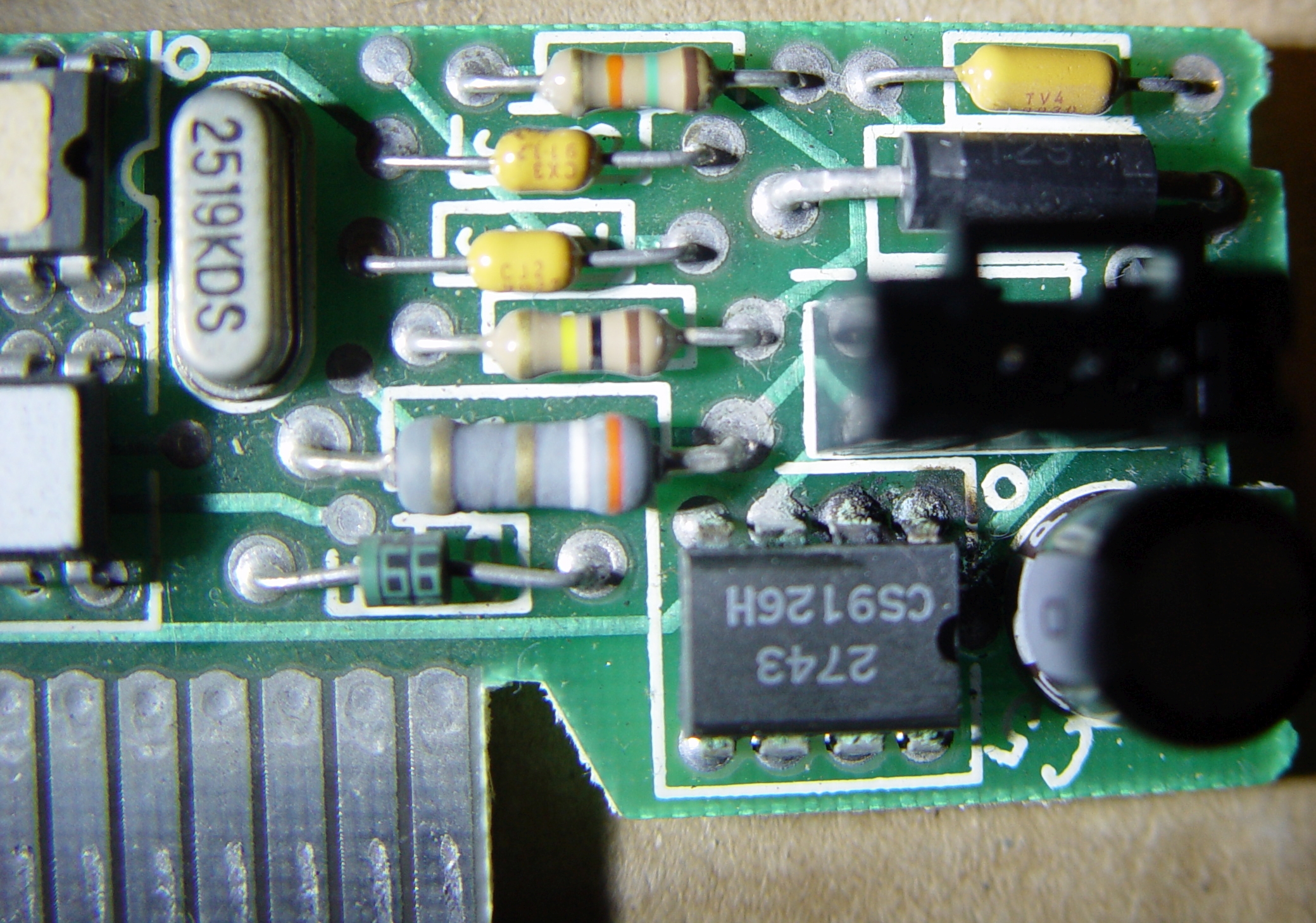

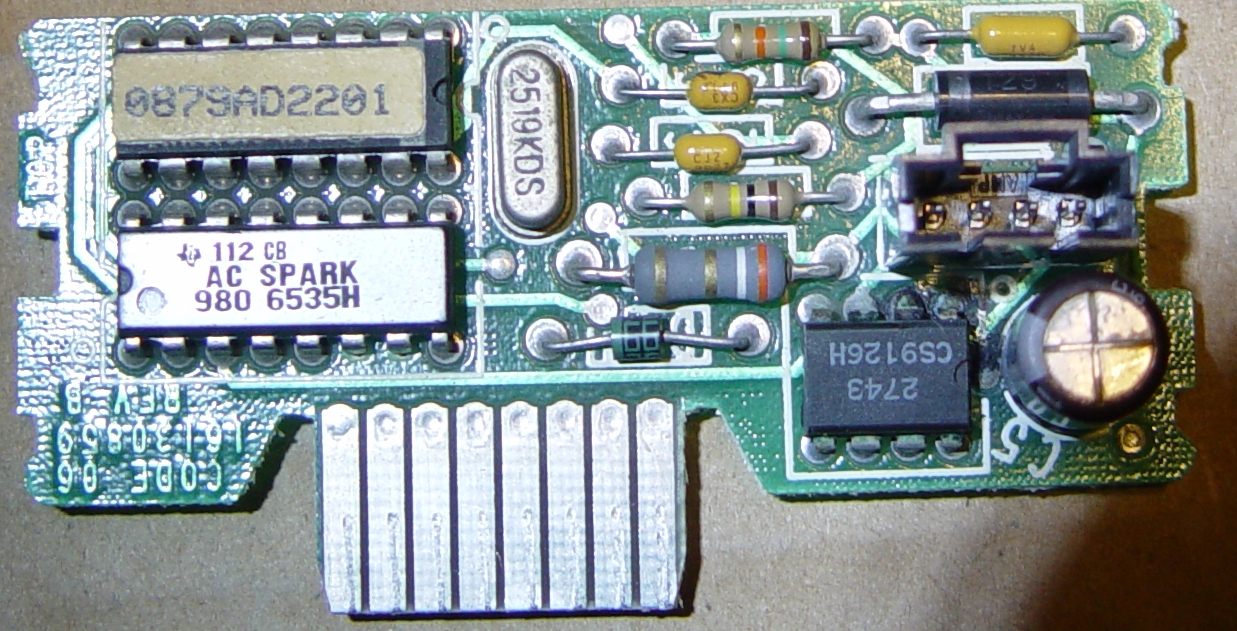

    I have a 1992 Camaro that has an electric speedometer (analog needle-type of speedometer but driven by electricity, not a cable). From what I gather the circuit board driving the speedometer is the culprit but I'm not that great when it comes to the technical stuff with capacitors so here I am!
    Chip almost looks burnt or leaking but possibly the cap leaking? Didn't look swelled from my perspective when I had it out but...
    Pics are attached.
    Capacitor is an Nichicon 150uF 25V PF(M) (which "M" I've read is 20% tolerance and "PF" is the series...
    I think I found the datasheet
    which says this cap has an impedance of "0.33 ohms max at 20c". I removed and measured mine it was 0.75 ohms with my ESR meter
    (uF measured 142 I think? my notes are confusing )
    so it seems it's definitely bad. Question is, what should I replace it with?
    Seems it's low ESR, 150uF with a tolerance of 20%; got that much...
    The datasheet says this series has been replaced/upgraded to PJ series.
    PJ series data sheet
    says the equivalent cap is 0.26 ohms @ 20c (lower is good, right? ) and says the rated ripple is higher (is higher better?).
    I've searched for caps on eBay and found several that state they are low ESR but the datasheets say "applications: general purpose"?). I've found one that looked good but stated "not for automotive". Why?!?
    http://www.ebay.com/itm/10-Elko-Pana...IAAOSw-vlVnmm6
    https://cdn.badcaps-static.com/pdfs/...4e2acec5e3.pdf
    Others I've considered:
    http://www.ebay.com/itm/8pcs-Nichico...uYhjyVedVGPwtQ
    datasheet:
    http://www.ebay.com/itm/150uf-150mfd...cAAOSwuMFUbtP2
    datasheet:
    https://cdn.badcaps-static.com/pdfs/...d7b9ce5b39.pdf
    Help!

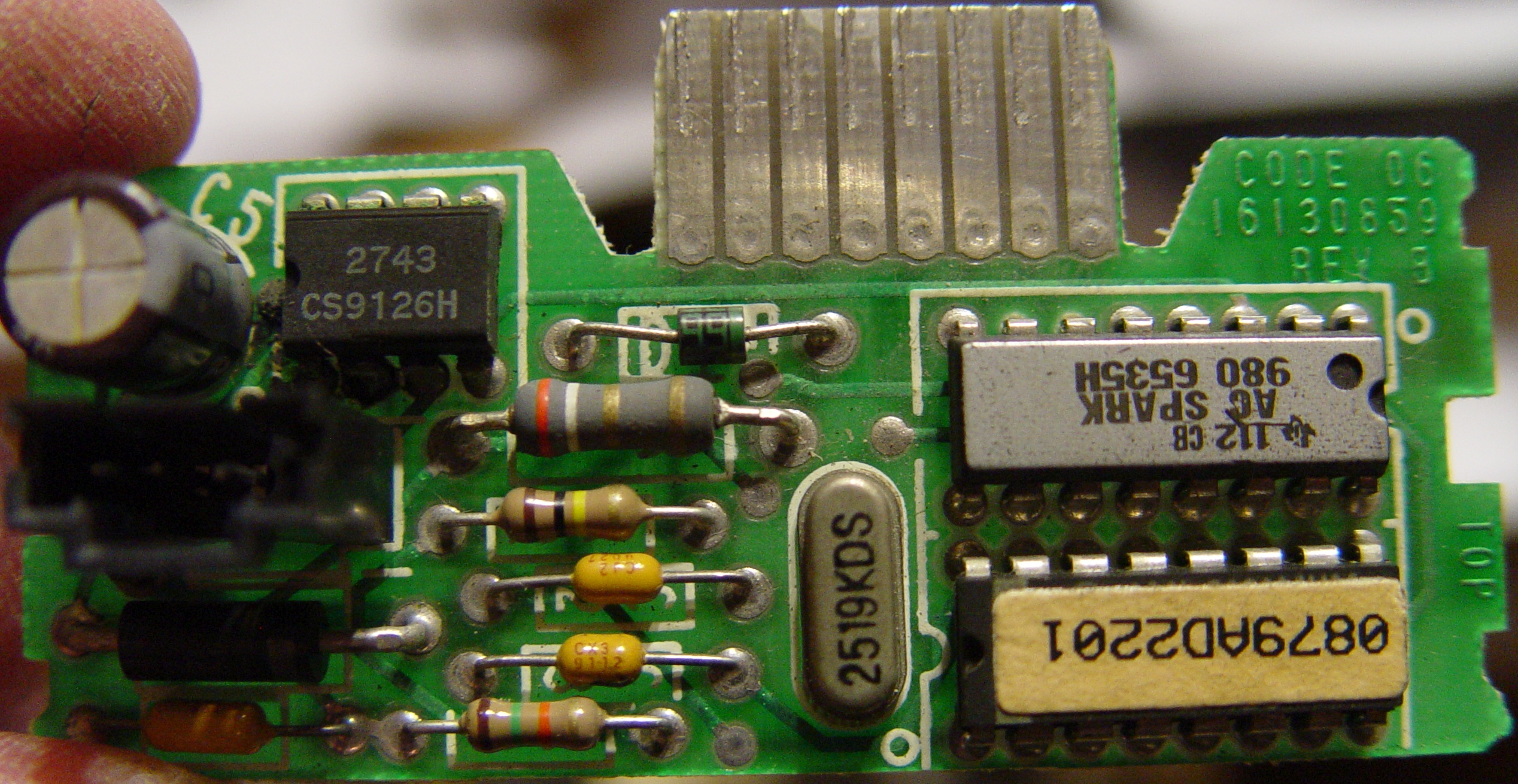

    Forgot to mention I do have a few more pics of different angles if desired...

      desolder the cap and chip,
      clean up the mess with IPA
      DONT BUY EBAY CAPS.
      does this board get hot & cold?
        • 31256
        Re: capacitor replacement in Camaro
        looked at the datasheets - that cap is crap by modern standards.
        panasonic FR series should replace it.
        probably a good idea to work out what the cap is doing first though.
        btw, they say not for cars because it's not AEC-Q200 certified.
        personally i wouldnt care, it's not like it's part of the ABS or Drive-train.

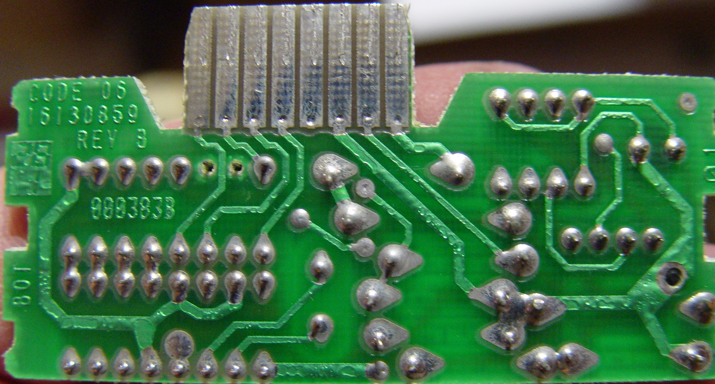

                  Ah, already tried with alcohol to the best of my ability.
                  All of it wouldn't come off.
                  Oh, and forgot to mention I already tried heating up and adding a touch of solder to all connections except the large chips- I was afraid I'd do more harm than good with heat!

                      • 31256
                      i use farnell / element14
                      try scraping that shit off with a screwdriver - use a wire-brush on the chip and hope it's not damaged inside.
                      the esr can be lower - not higher
                      voltage can be a bit higher - like 35v, never lower
                      the ripple current can be higher - never lower
                      tolerance can be ignored, it's always 20% for electrolytics.
                      the uf can be a bit higher - it depends on the circuit.
                      unfortunatly i cant trace the numbers on that chip - so i dont know what it's doing.

                                    • 31256
                                    Originally posted by avidgamr
                                    I've removed the capacitor once, hence why I knew the actual measurement of it via my ESR meter...
                                    Why remove the IC?
                                    you need to clean all the shit off the pins, and from between them.
                                    you also need to check the pads and tracks have not been eaten away by the leakage.
                                        Ah yes, never even gave the thought about that! When I receive the new cap, I'll remove the IC as well and do that. Thanks stj and Agent24!
                                        Until the cap comes, I'll just have to wait and not drive my Camaro!
