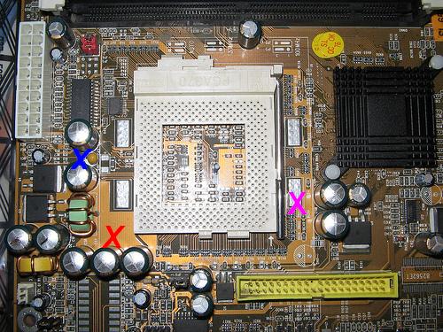

    I just had a look at the MB photos again and hope you don't mind the repost of one here for reference to what I am about to say;
    For those that know, Is that a single Phase VRM?
    (I suspect it is, 2 fets 1 green coil)
    Is it likely to be 5 Volt VRM
    (I suspect if they are all 6V3 caps of 1500uf)
    Now bearing in mind I am only working from the photo and have never seen this MB in the flesh
    So its pure "Guess work" and I could TOTALLY have it WRONG!
    The BLUE X I suspect is VRM input (2 Caps)
    THE RED XI suspect is VRM output (5 Caps)
    Here comes the bit I and querying and suspecting of possibly generating this fault symptom
    If you look at the far two caps they appear to be beside a regulator (whatever... switcher, mosfet) near the chipset
    THE PINK Magenta type colour
    is it possible this not functioning is responsible for the "no boot" situation
    What are the chances of the Chipset being damaged from this.
    I would do point to point continuity checking and see where those to caps connect to
    They may well be part of the VRM output and have nothing to do with that circuit which appears it might power the chip set in some way.
    Its seems like a good theory but does it hold any water?
    like I said, No Expert on any of this and its purely my suspicions from the photo and symptoms as described
    Looking at it further and knowing MBs and positions does not mean that thats the "function" of the caps...other possibilities could be read into that arrangement
    The yellow coil is posing questions in my mind of being related to VRM input, maybe 2 next to it are VRM input the blue are GP filtering for MB and 3 red plus 2 pink are VRM output
    may suspicion is 1 or 2 of these caps are suppling dirty power to the chipset regulator (I think it probably has one?) which is then causing it to not operate.
    Anyway thats my not so educated guess and I could totally be barking up the wrong tree

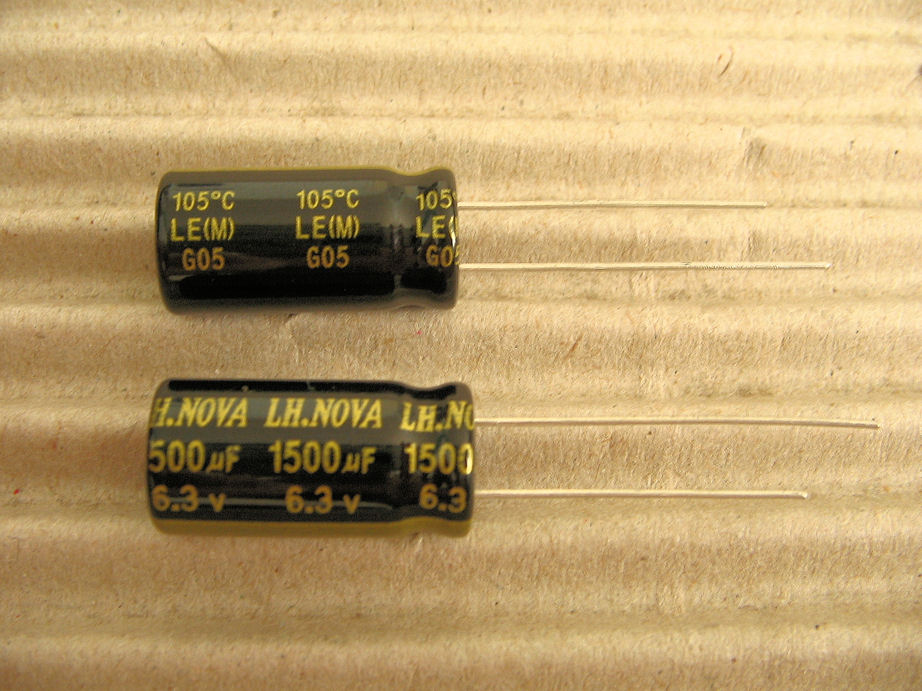

      Well I've been looking around and I think I've finally found where the Nova capacitors may come from:
      "Fenghua Advanced Technology" (www.fenghua-advanced.com)
      here's a datasheet I picked at random:
      That cap look familiar?
      They also have distribution in NZ by "arrow components" http://www.fenghua-advanced.com/english/server_02.asp - so it looks like this really could be it.
      Pity that website is horrible
      Still, I did find this http://www.fenghua.com/eng/index_eng.html which has more and seems better datasheets (although I am not sure if the sites are from the same company)
      Dirty power from the bad caps or perhaps if something went quietly open circuit...

                I just called Sicom after they didn't return the email I sent last week, but they confirmed what I suspected - the caps are branded LH.Nova, and the only sensible google result for that turns up on fenghua-advanced.com
                They also told me that XPB was not a series as such, but just the lead-free version of that cap.
                From what I gather they're just some cheap brand but they should be good enough for testing so once I confirm the mosfets aren't dead I guess I'll order some and see what happens

                            So, I finally got the capacitors (yes I know it's been a month!)
                            Anyway, I've attached a photo and the spec sheet for the LE series (which is what appears these caps are)
                            I guess we'll see what happens with them, which should be this weekend
                            -David VanHorn
