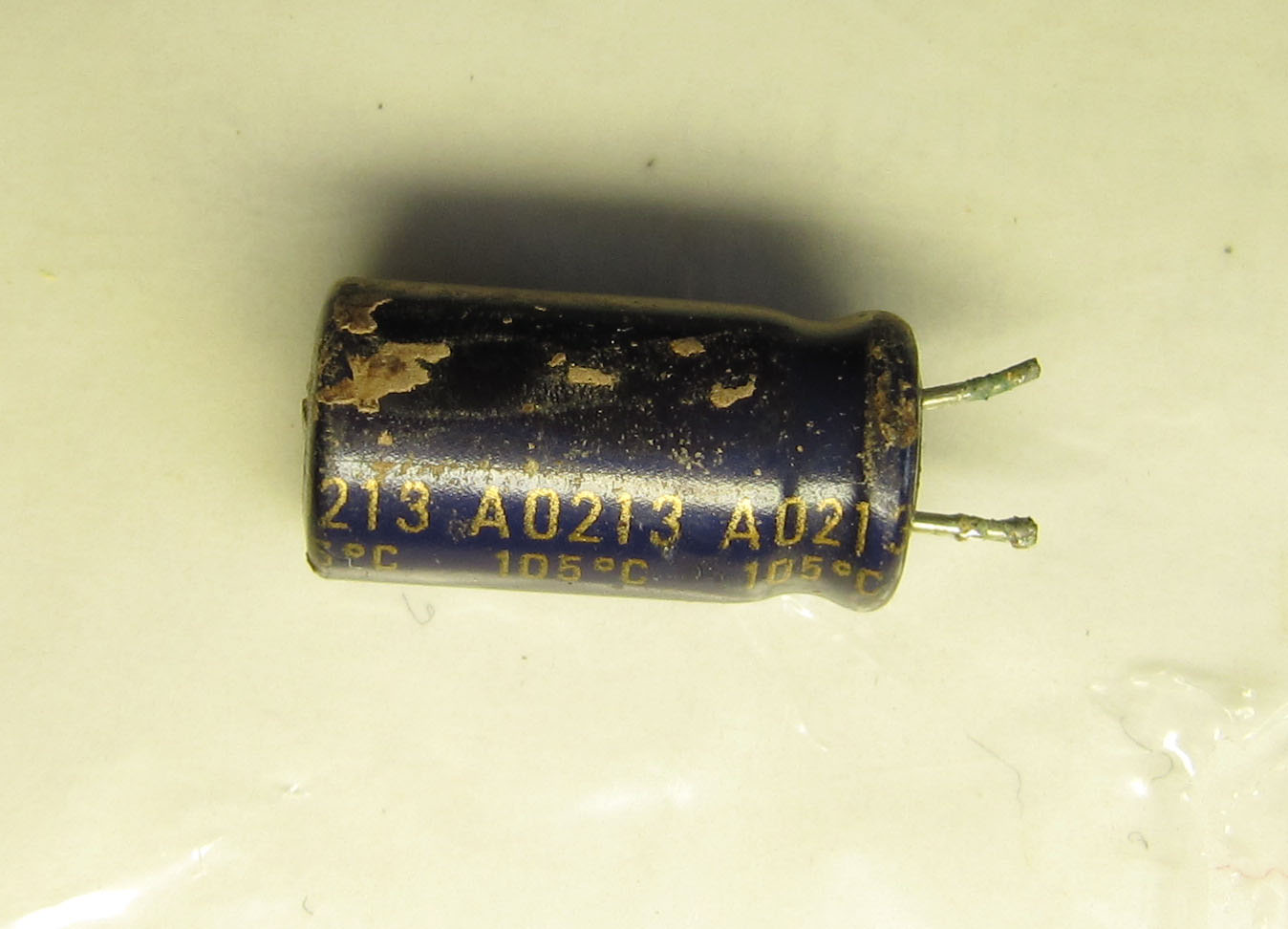

    I removed some good caps from a Dell Optiplex GX260 mb 4 years ago.
    Past from visual inspection, I also tested them with esr micro and their ESR and uF were good.
    Yesterday I noticed one of them was leaking and bulging.
    Its current esr is 0.85 ohm and the capacity 824uF.
    Those caps have been stored in a dry place and the temperature varied from 15°C to no more than 25°C
    The other cap is still good. I don't know for how much though..

    even in storage a used cap is a used cap, sometimes this happens

      Re: Rubycon MBZ leaks in storage!
      Well, that's scary...
      Even scarier, it's an 8x16 1000uF 10V MBZ, the same kind of MBZ Topcat pulled from those Thinkcentres three years ago, and most of them failed without any signs. I chalked that up to a bad run of bungs at the time (or someone who abused the leads whilst installing them), but now I'm not so sure... from what I can see, the capacitor was manufactured during the 13th week of 2002, in Singapore (March 2002... I think "A" means Singapore because I've seen 1000uF 6.3v 8x11.5 YXGs in a sealed bag before with "A" codes, and the label on the bag said that it came from Rubycon's Singapore factory). They are well over 13 years old at this point, though, so it might just be their time (even non-aqueous lytics have about a 20-30 year shelf life). Sometimes defects in the electrolyte take many years to cause issues and MBZ is only a 2,000 hour @ 105*C rated capacitor.
      Did it come out of a SFF GX260? Perhaps it was exposed to an excess of heat for too long and hence the bulging is the long-term effect (like what happens when you reflow Xbox 360 motherboards with the lytics still on). Also note that no capacitor is impeccable. When you produce millions of them, some are bound to be bad even from the factory. Another explanation is that once you get to MBZ-grade capacitors that lytics are no longer completely reliable. Think about how unreliable HMs once were and how unreliable KZGs are. Sometimes even FJs and WGs fail for no reason.... there is a reason why lytics don't go lower than HZ grade. It is very difficult to increase the conductivity of the electrolyte by way of ions. The increase in the H2O in the electrolyte necessary to improve conductivity makes all capacitors more sensitive to heat and that kind of electrolyte has a tendency to aggressively assault the dielectric until it's gone and hydrogen gas forms, which the proper neutralizers will reduce the likelihood of (which is why polymers exist - conduction by way of electrons, hence the solid state terminology). And that kind of electrolyte in a high concentration dries up faster than lytics with "conventional" electrolyte as well.
      There is also a possibility that the electrolyte completely broke down after the capacitors just sat there for four years. The aluminum oxide layer thins as long as the capacitor sits in storage with no voltage across the plates and no current going through it. That's not good for any capacitor. I think Panasonic recommends that 1 year be the maximum time lytics sit in storage without reforming. But maybe the simplest solution to come to is, don't trust those 8x16 1000uF 10V MBZs.
        i'v seen pana FC's leak around the leads,
        you have to remember that rubber goes hard with age.
        *any* cap with a rubber bung will have it's seal comromised eventually.
        interestingly i'v had old soviet caps that probably dont have this problem,
        the bung is plastic and is inserted with a rubber seal at the crimp-point - so it cant leak around the pins.
        i'v also seen old american caps from the late 70's and early 80's where the bung has an epoxy cap over it to prevent leaks. ( "T.I." branded)
            I'd give the thing a break. It's 13 years old now. It probably got quite a bit of use, and then 4 years is a long time to sit for an already almost decade old capacitor. This is why I'm always a little skeptical about reusing caps.

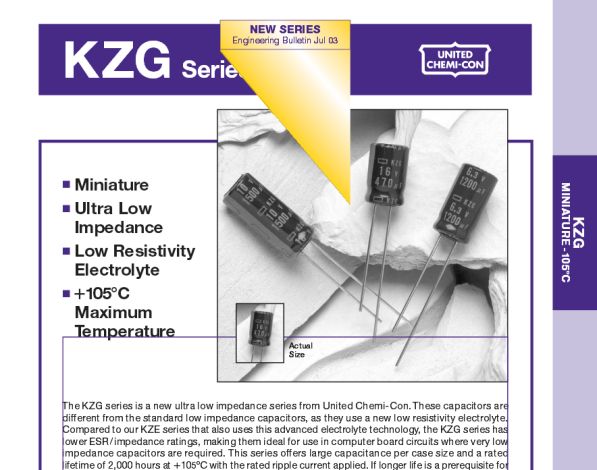

                              Uh, keep in mind, they (KZG) are only rated for 2000 hours. Even if the caps last less than a year, as long as they have lasted over 2000 hours, then I don't really see any issue. Obviously, the 2000 hour rating doesn't mean that they won't work at 2001 hours ... it's nice to have them last longer than 2000 hours, which some capacitor series will.

                                that's 2000 hours at 105'
                                the life increases as you decrease the temp.
                                  The very first version of NCC KZG's datasheet that I posted in the "What pisses you off?" thread rates the 10mm 16V KZGs (10x12.5 680uF 16V, 10x16 1000uF 16V, 10x20 1500uF 16V, 10x25 1800uF 16V) for 3,000 hours.
                                  Well, at 65*C, they are supposed to last 32,000 hours and at 60*C, 45,200 hours according to the "10*C decrease doubles the life" rule. Most of the time, they don't last anywhere near that long at lower temperatures. I think bad capacitors are too unpredictable to follow that particular ruling. Furthermore, I've seen 2,000 hour @ 85*C and 1,000 hour @ 105*C GP capacitors outlast 2,000 hour @ 105*C KZGs and KZJs, even in storage. So something is definitely wrong with them. I don't really think it's about the endurance rating, though, it's about the individual solution each capacitor uses. And this thread makes me think twice about knocking them (KZGs) - I guess all ultra low ESR capacitors have the same issue, but that for some it just takes longer for those issues to surface, even if it's many years...
                                  We all know that if capacitors hate anything the most, it's heat. Heat is the ultimate enemy of all lytics and greatly expedites any chemistry issues any capacitor may have. I think they'd be more likely to fail if you heated them right up than if you let them sit. That said, it's probably a better bet to use them and keep them cool above all else.

                                    Tne very first version of NCC KZG's datasheet that I posted in the "What pisses you off?" thread rates the 10mm 16V KZGs (10x12.5 680uF 16V, 10x16 1000uF 16V, 10x20 1500uF 16V, 10x25 1800uF 16V) for 3,000 hours.
                                    Interesting. I did a double-take when I read this, and looked my own KZG datasheet. I found the one you were refering to in this post. So now I have three of them:
