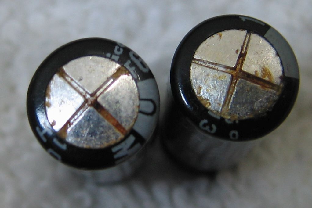

Re: Rubycon MBZ leaks in storage!

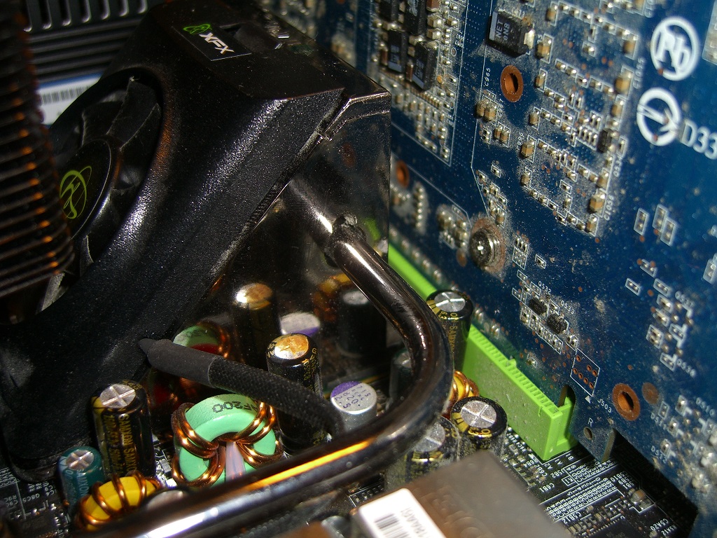

Wow! Thanks for posting that. First time I'm seeing failures. I've had good experience with 3300uF GC, ran them in a pretty hot environment, none of them bulged after a couple of years (That Foxconnn board I posted earlier... Now I'm starting to think that maybe my PSU is fine and the motherboard was the problem, I'll have to re-test this PSU).
What about GT and RS? I have RS in the SP-450 that I suspect of failure, but the caps aren't bulged or anything, nor have there been any reports of failures with RS AFAIK.

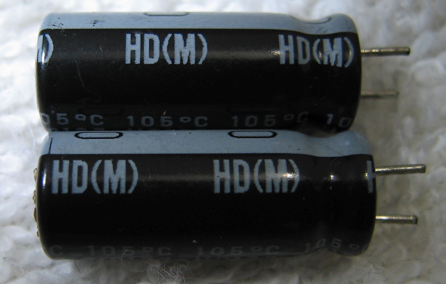

Actually, premature failures of Samxon GC/GD definitely exist...
And we all know how unreliable Samxon GF and GK are, and they are equal to HE and HD respectively, so I don't think that can bode well for them either.
But since that one was acquired from eBay, it could have been fake despite looking authentic. Actually, it could definitely be fake because FJ/FL are only sold directly to OEMs so the fact that they still retain their full leads is suspicious, unless someone acquired them from some OEM who Panasonic sold them to. And further down the thread, there's a KZJ bulging without having ever been soldered into a circuit - go figure! Seems like those ultra low ESR, highly aqueous capacitors are bound to do that sooner than later.
