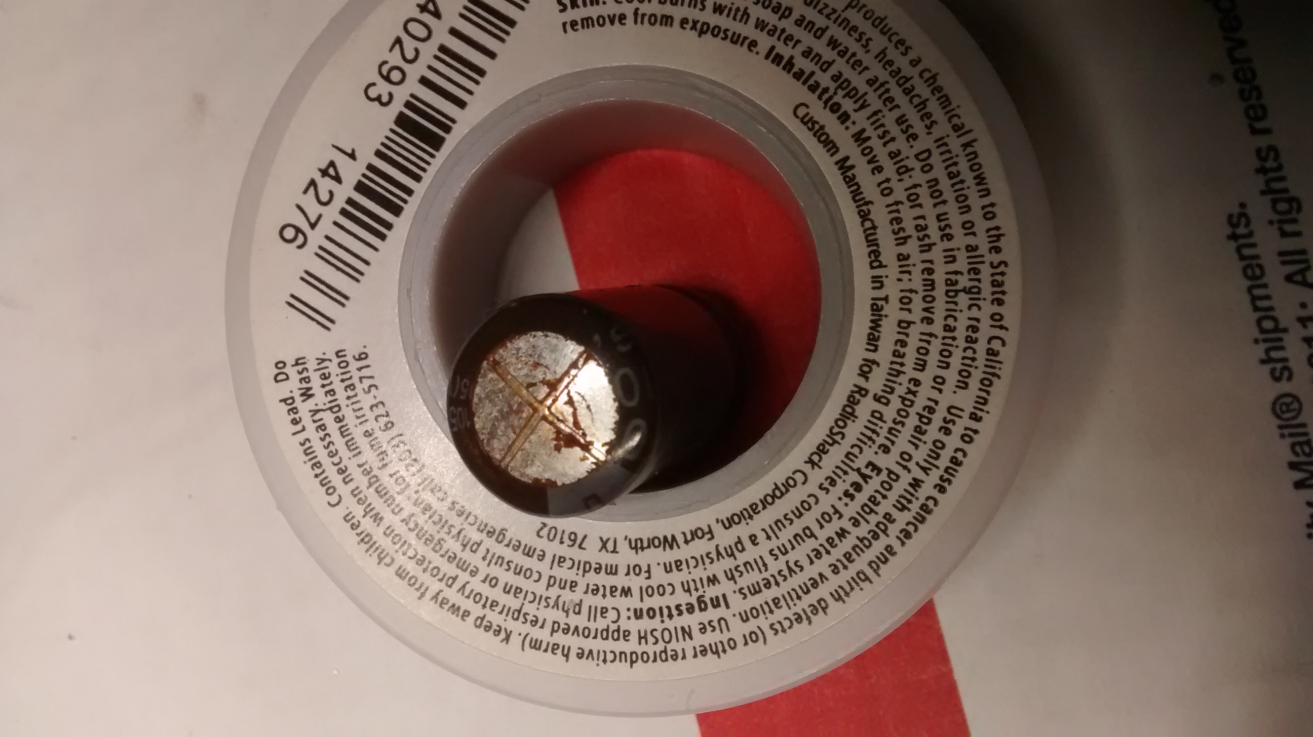

    The blue rubycons are probably really old. I think it has been atleast 20 years when theuäy had that color, if not even more. Otherwise they are probably legit.

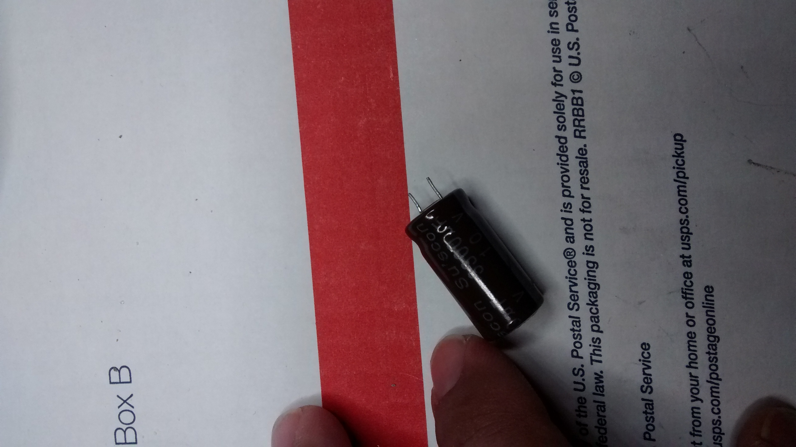

      Its only one tiny cap 100uf 35v , so if it old and its so tiny and it's 85C should it hold out? or should it be replaced? the only other choices i have in my stash are lelon,and other no name brand...

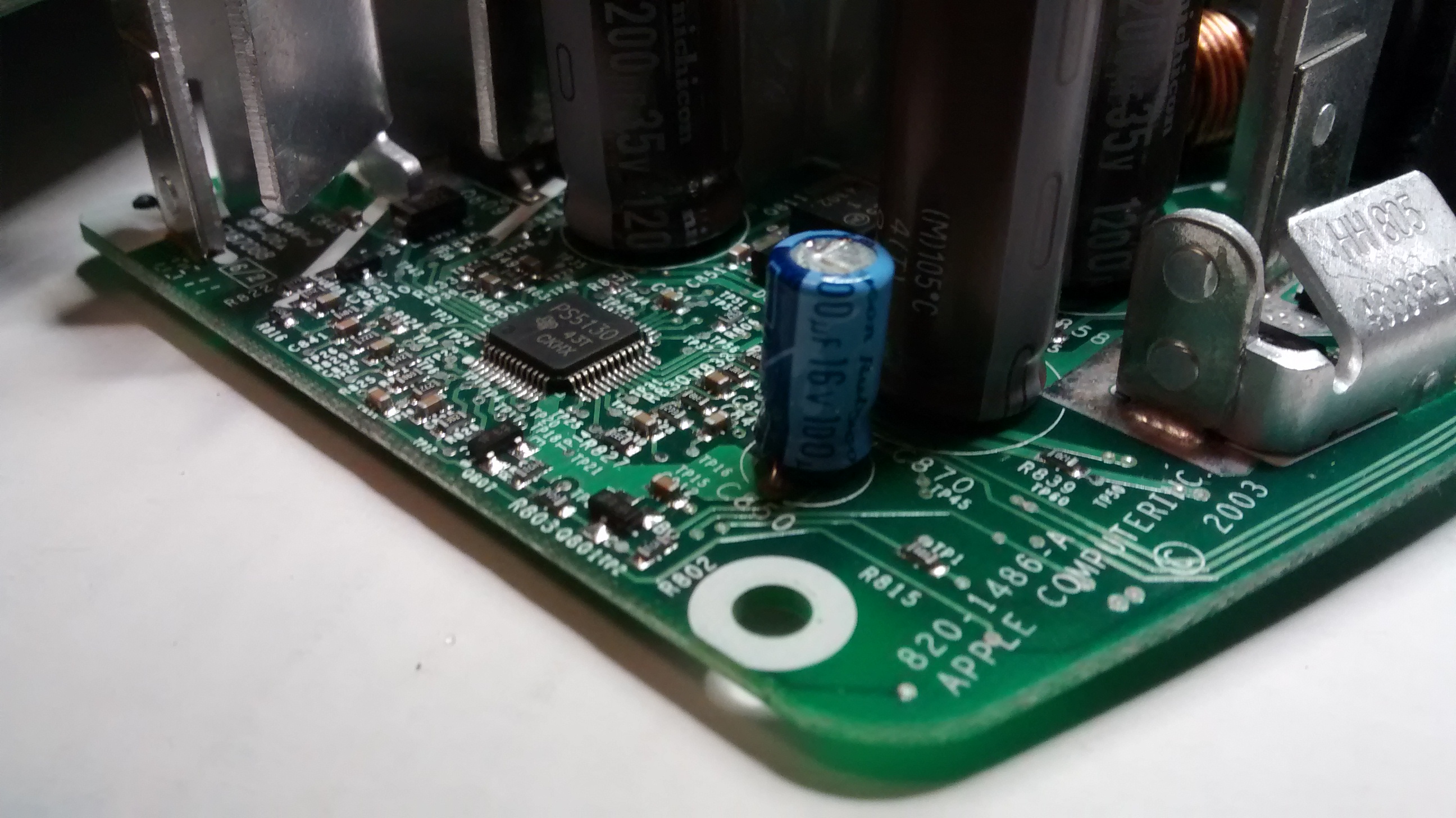

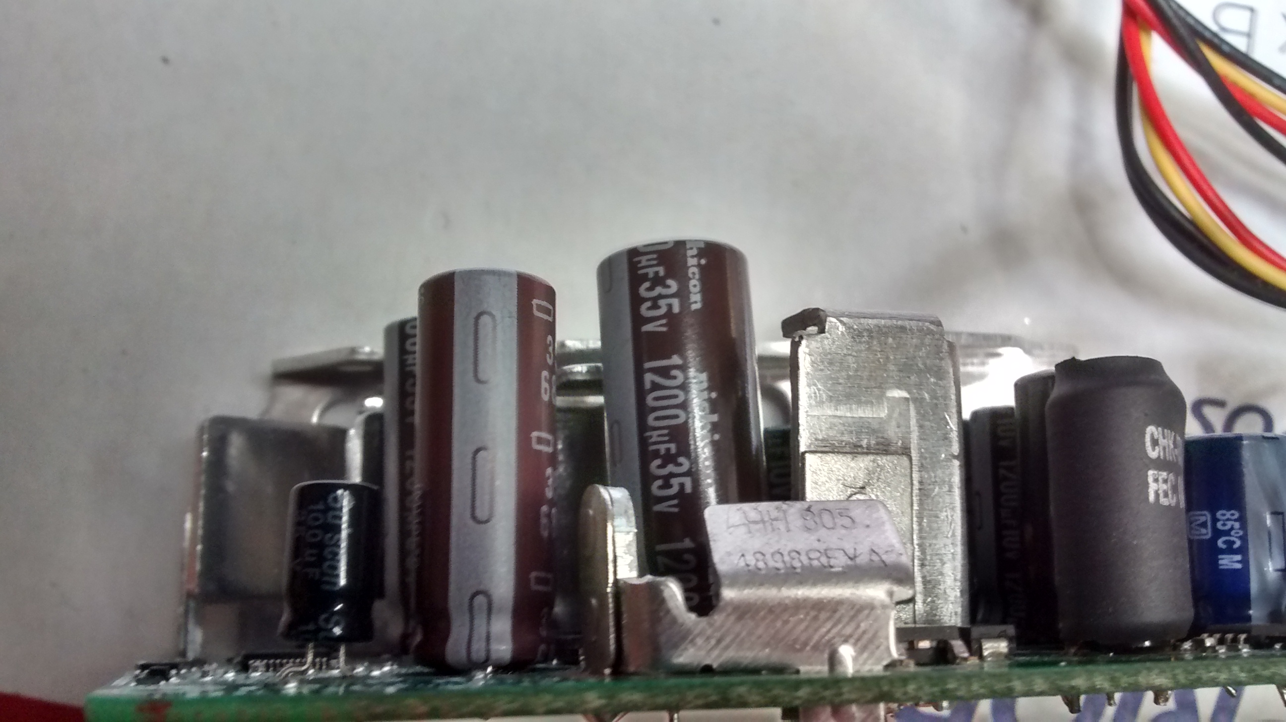

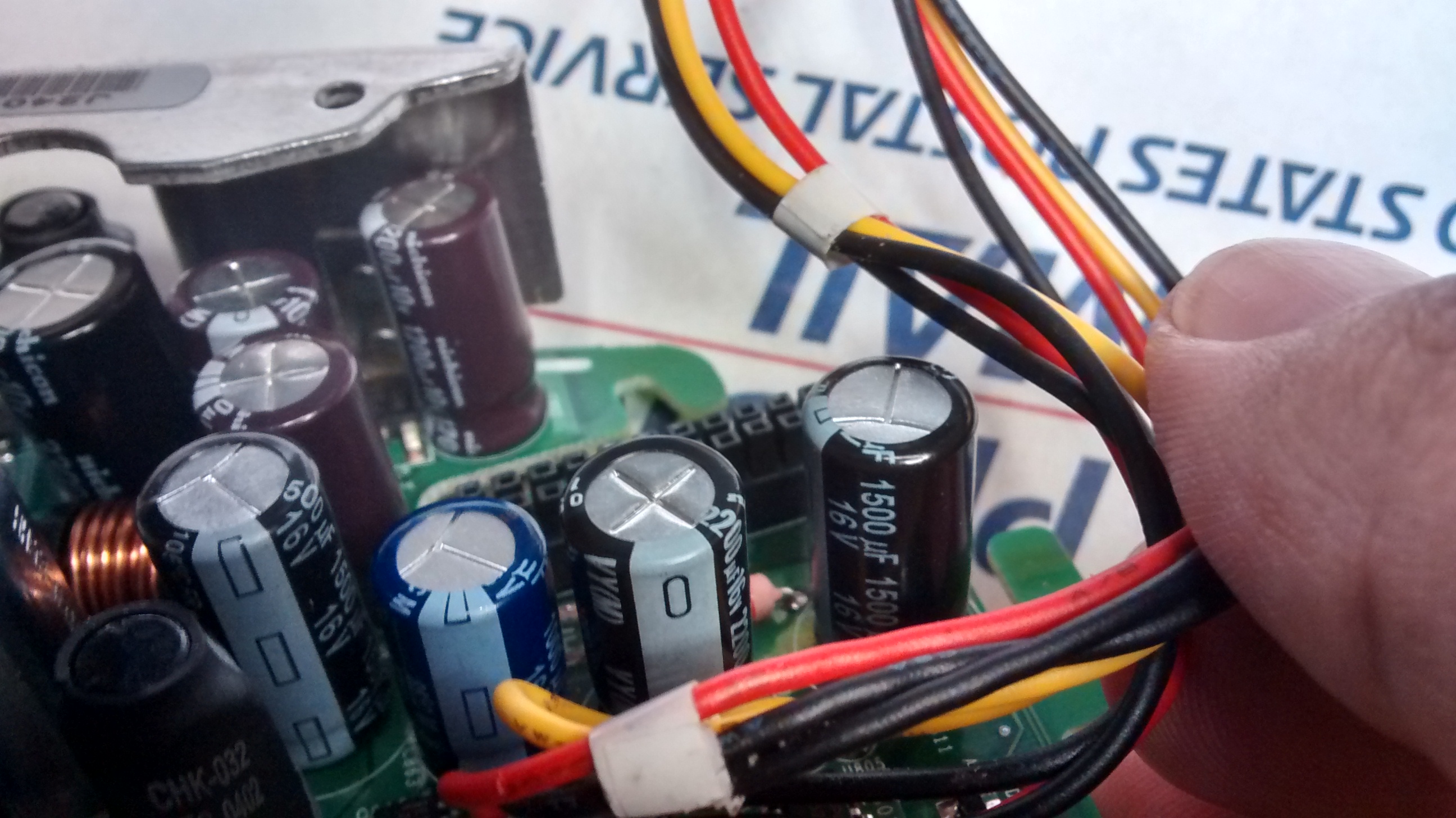

      here are some pics of the recap i did..

        What series are the lelons? Many will probably disagree with me but personally I have never had or seen problems with the low esr series from lelon (RXK, RXW and RZW) I have personally used those series in some repairs.

          no they are some cheap radioshack lelons it was the lighter blue covering on the outside so i dont know if they are good, i replaced it with a rubycon as i mentioned even though i've heard it's old, thing is the board is in an area where it dosen't get too much ventilation with the exception of the thick aluminum,steel? cover that goes over everything then the outer plastic shell, i think the metal is a heatsink? so it's going to get warm but not too warm, what surprised me the most though was the cap from chemicon was a UCC(united chemicon cap) i thought they only made special capacitors like the much larger ones not tiny ones.

                      let me clarify some of the things i mentioned in the post
                      the United chemicon cap is KY series (pun intended)
                      the panasonic m series does exist is as its listed on mouser
                      http://www.mouser.com/Search/Product...667-ECA-1CM102
                      plus info from panasonic
                      all of the previous capacitors were sus'cons
                      here are what were on the board
                      1500uf 16v x 2
                      1200uf 35v x 2
                      680uf 35v x 1
                      3300uf 10v x 1
                      1200uf 10v x 3
                      1000uf 16v x 1
                      2200uf 16v x 1
                      and one small 16 v 100uf
                      all of the sus'cons have no series just sc105 degrees c 0442(v) is v the series?
                      all were replaced with
                      Nichicon PW 35volts 1200uF
                      UCC KY 35volts 680uF
                      Nichicon PW 10volts 1200uF
                      panasonic m series 1000uF 16V
                      Rubycon cew 100uf 16v
                      panasonic fr 16VDC 1500uF
                      (more info )
                      the rubycon was purchased from radioshack and its a rubycon ce w 16v 100uf - yes i think it's an audio cap i dont have big plans for this pc as it's not going to be too stressed though
                      of course the capacitors i have now are much skinnier than the previous one's but they are same voltage and capacitance does this help, any advice you can give will be very appreciated

                        What you do with it is irrelevant. It's what function the capacitor performs in the circuit that depends on how much it will be stressed.
                        Your Panasonic FR, Nichicon PW and UCC KY are good. The Panasonic M is not.
                        The Rubycon CEW will probably be OK since those small value capacitors usually have easy jobs in PSUs anyway. BUT! As already mentioned, CEW is old, general purpose, and not rated for high temperature so it's still not really that suitable.
                        Being quite an old PSU with discontinued capacitor series already, the replacements are likely to be smaller anyway due to advancements in capacitor manufacturing ability.
                        However, you should get rid of those Panasonic M series and replace with a Low ESR series as they are general purpose and will not last very long in a switching PSU due to the high ripple. They may also make the PSU run incorrectly due to their higher ESR.
                        Look at the datasheets for Su'scon SC Series capacitors. Look up the sizes\values\voltage of the capacitors you pulled. Find the ESR and RCR (ripple current rating) for the ones you pulled and make sure your replacements have the same or lower ESR, and same or higher RCR.
                        If the replacements are spec'd significantly lower they will not last very long.
