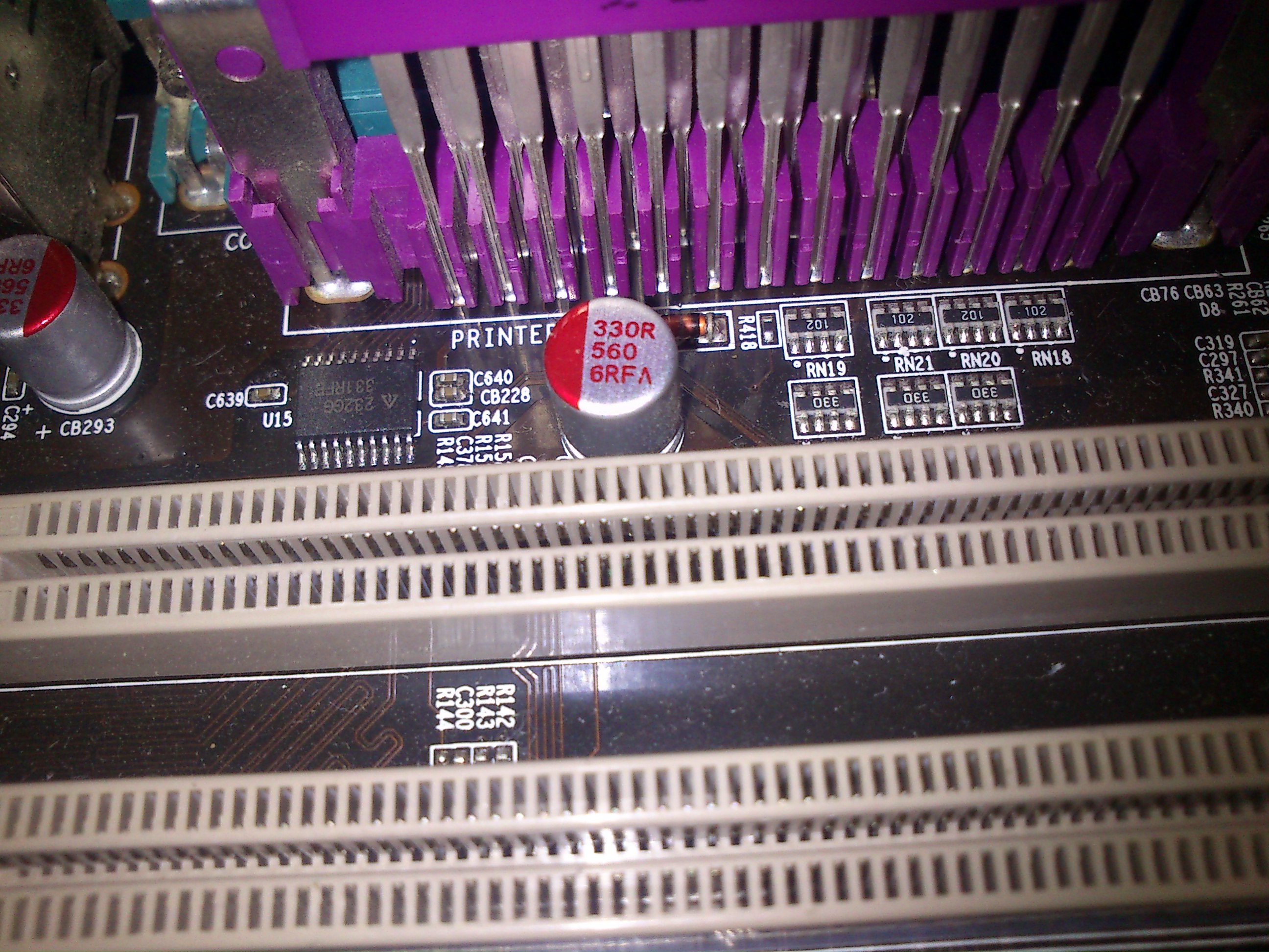

    i would appreciate it if anyone could tell me what is the voltage and capacitance of this cap, this is written on it "330R 560 6RF^",
    a picture is attached.
    thank you very much.

    Looks like a teapo/ost/unknown my guess would be 560uf 6.3v
      Re: help me identify a capacitor
      It's a 560uF capacitor. The voltage is most likely 6.3v or 10v because I see the same capacitor used right by the usb header and usb works with 5v.
      It's a polymer capacitor, a good chance it's a nichicon fp-cap (functional polymer) based on the red color (but usually you'd see FP written on it so like selldoor says maybe it's another brand) but any polymer capacitor with that diameter and low esr will work.

        thanks selldoor, i'll replace it now with 560uf and see what happens.
        these cheap motherboards are pretty popular here in Jordan and they give me a headache.
          oh thanks mariushm, the 330R got me really confused
