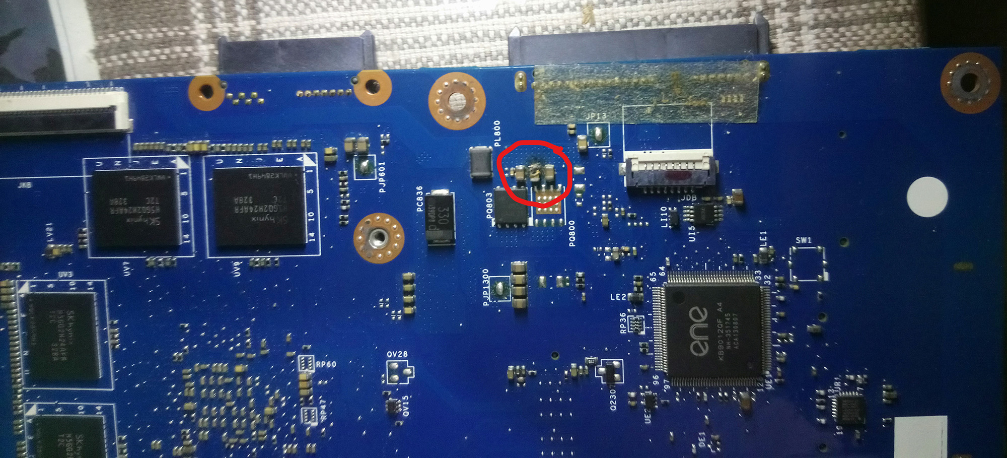

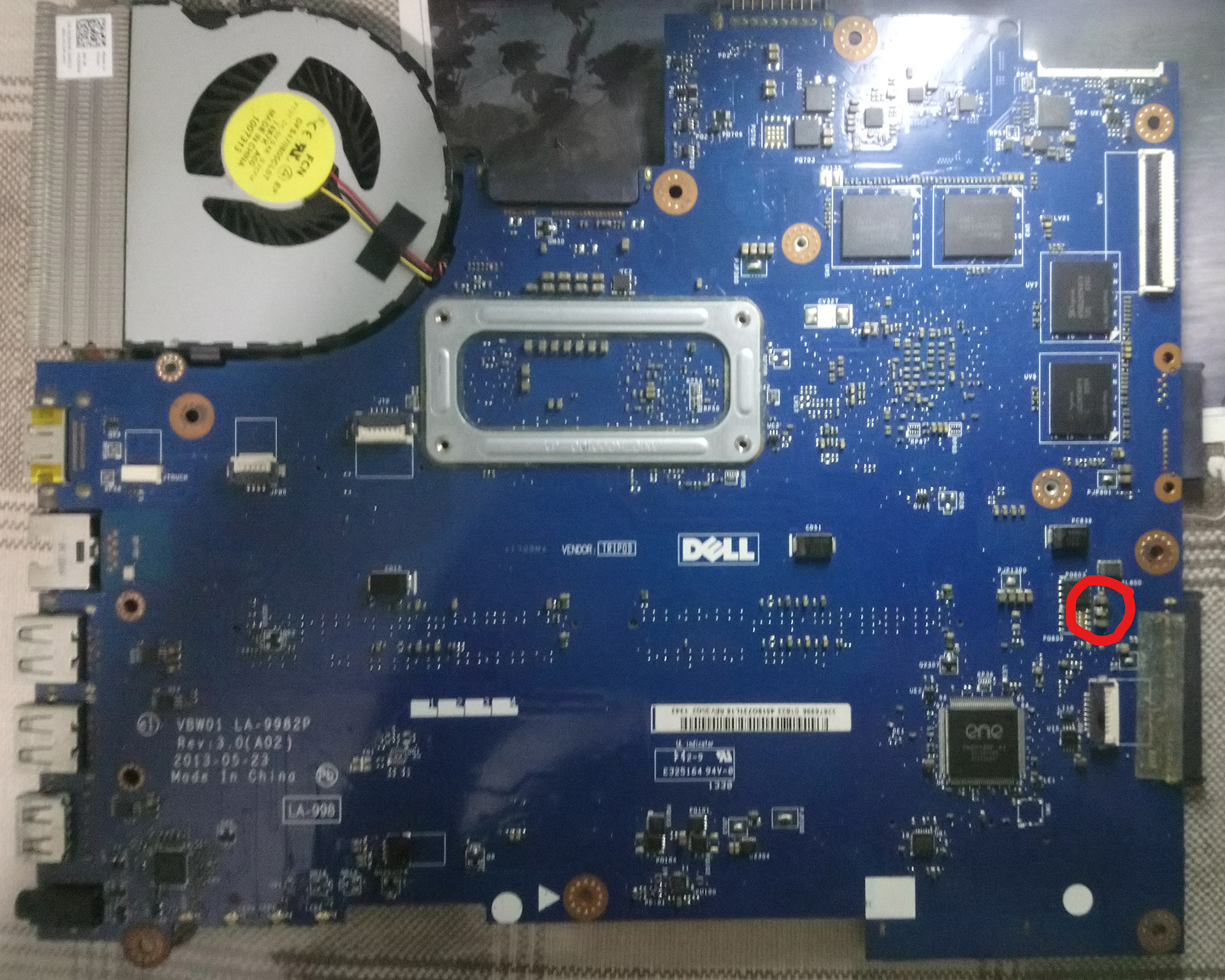

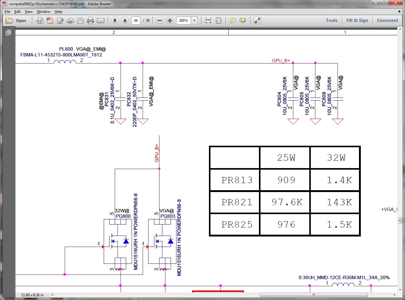

    I have an Dell Inspiron 15 3537 laptop mainboard (LA-9982P Rev. 3.0 (A02)) with a blown SMD capacitor as shown in the attached images. However, there is no printed specifications near the capacitor or a codename for the capacitor to identify the specification of the capacitor to replace it. I wonder how to identify the capacitor since the mainboard schematics are also useless as the capacitors are not named on the board. Any help would be highly appreciated.
    Thank You. Stay Safe.
    Chamara

    you have a set of 3 - remove a good one and meter the capacitance.
    then meter or scope the board and see what voltage is across them - obviously with the shorted one removed.

      Looks like they could be 10µf/25v

        Thank you very much stj for your advice. appreciate a lot. I'll do that.

          Thanks for the information R_J, as you pointed out, It should be 10µf/25v. I'll try it out. appreciate your help.
