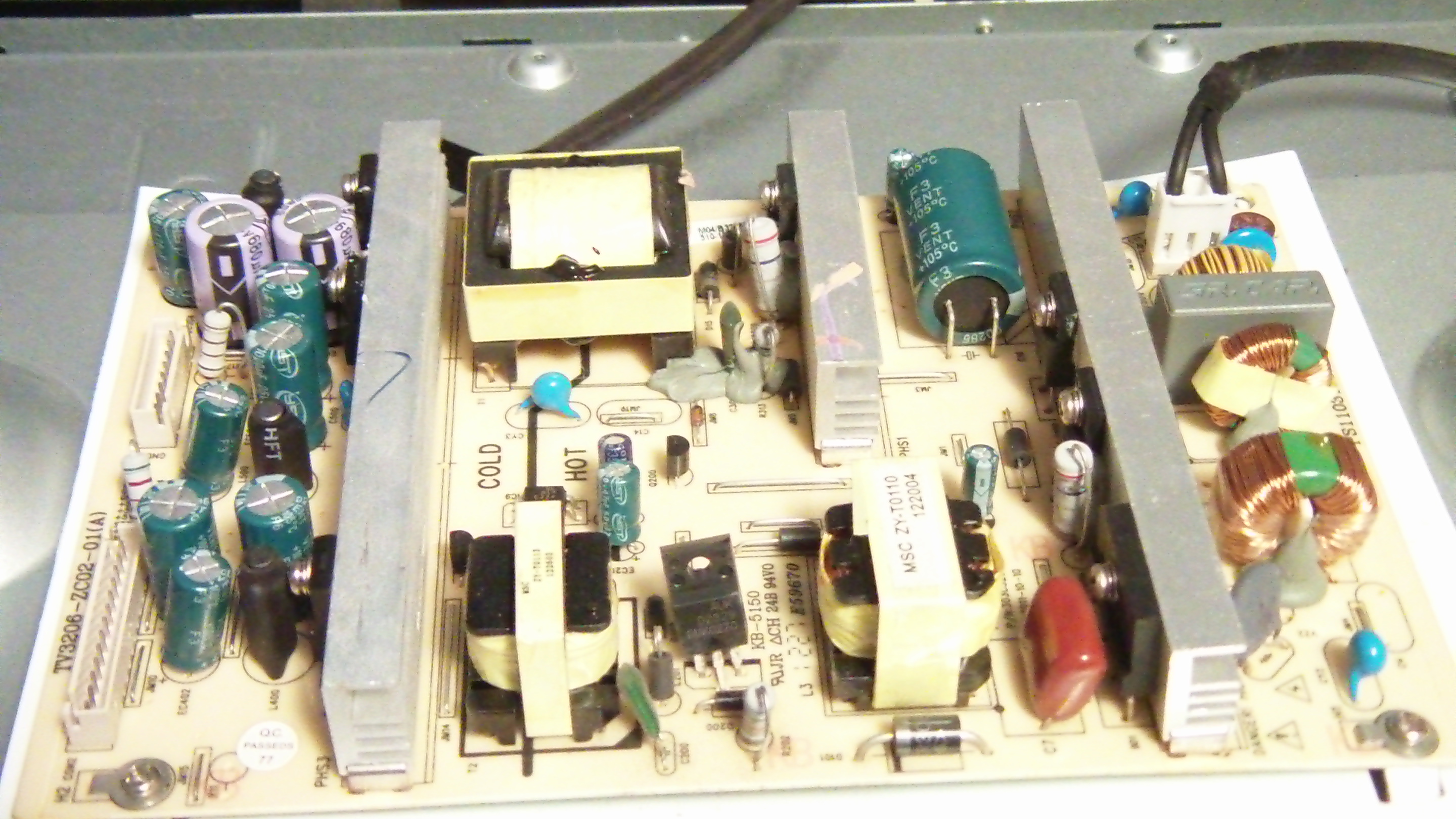

    I have a cheap 32 inch tv that has trouble turning on. It takes 3 or 4 trys to turn it on in the morning.

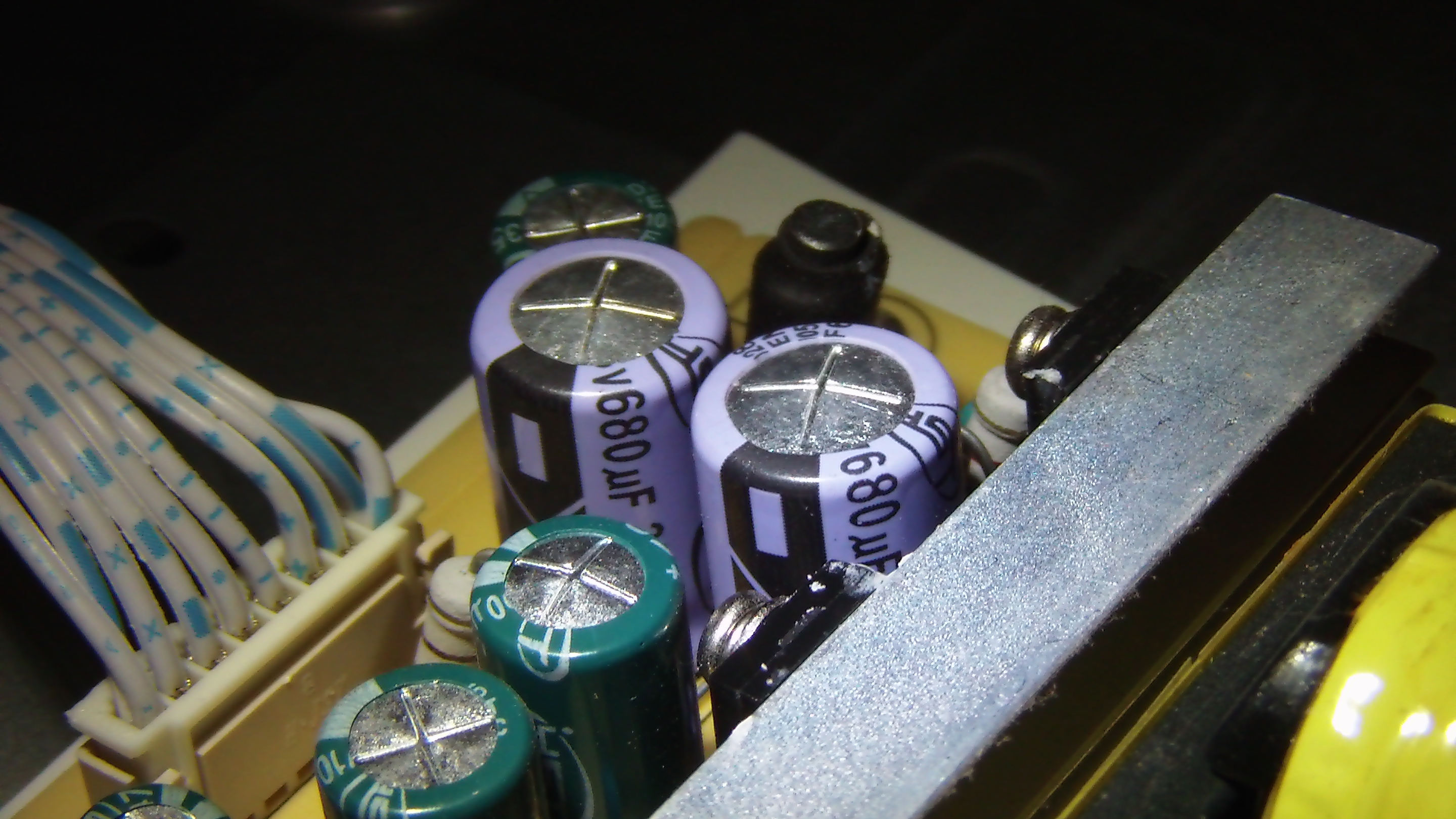

    I removed the back cover and discover 3 bulging capacitors. There are 2 purple capacitors labled as 680uf 35v with a number CD286C on them, and one green capacitor labeled 1000uf 25 v and a number CD286 on it. Both have a logo that says YST and F6 printed on them. I measured them and the 680uf 35v was 12.5mm Diameter and 22mm tall, and the 1000uf 25v was 10mm Diamter and 20mm tall.
    I looked for replacements and found these on digikey.com.
    http://www.digikey.com/product-detai...2417-ND/613778
    http://www.digikey.com/product-detai...1305-ND/589046
    Will these work?
    Here is a pic.

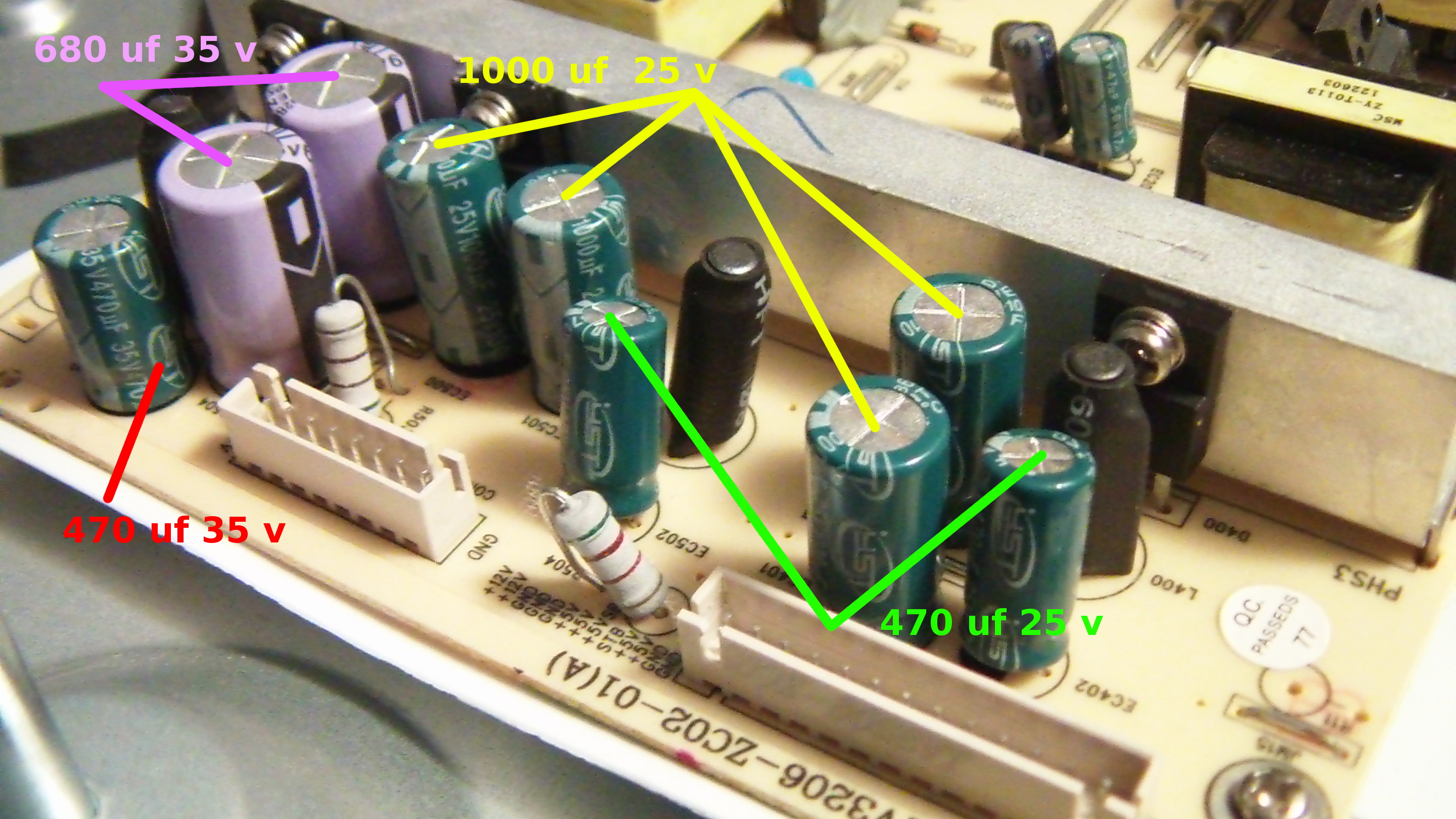

    EEUFR1V681
    EEUFR1E102 <<< NOT "L" version on either of these.
    what other caps does it have? specially small ones.
    better to not have to open it again!

        Also I wrote down all of the capacitors on what i assume is the power supply here they are ( the measurements are as close as i could get them )
        2 - 680uf 35v ( above )
        4- 1000uf 25v ( above )
        2 - 470uf 35v 10 mm dia x 17 mm height
        2 - 470uf 25v 7 mm dia x 15 mm height
        1 - 47uf 50v 6 mm dia x 10 mm height
        1 - 22uf 35v 5 mm dia x 11 mm height
        1 - 4.7uf 50v 5 mm dia x 10 mm height
        1 - ( label was on other side and couldnt see) 16mm dia x 30 mm height
        I also wrote down the ones on the other board ( I assume the audio )
        Here are some pics

          Here is the link to the spec of the PANASONIC Caps, just get the size and value you need then type in the PANASONIC part numbers into the search box of Digikey.
          https://www.badcaps.net/forum/showpo...2&postcount=65
