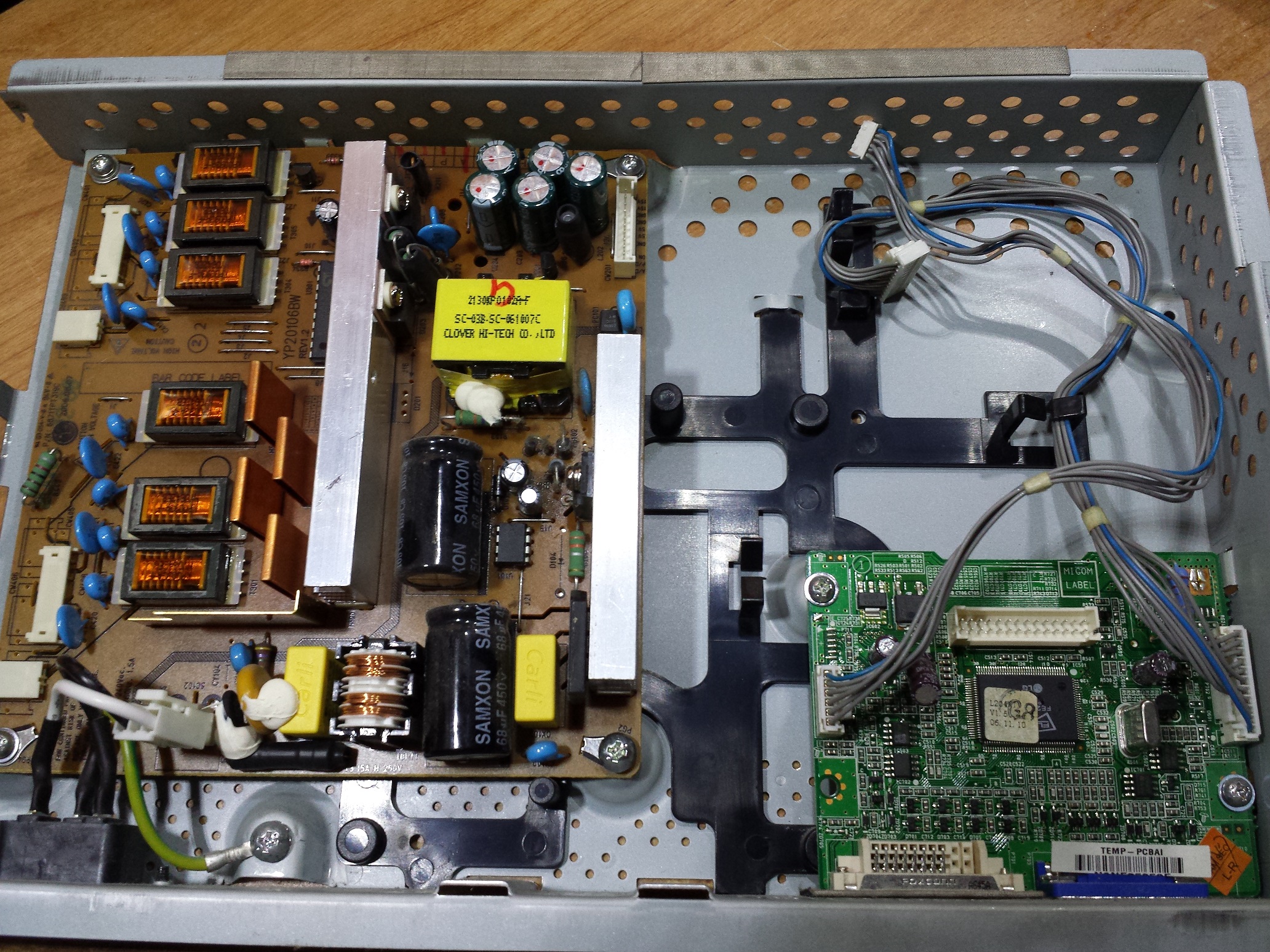

    I have a LG l204WTX which doesnt turn on, and has been sitting around for 3 years or so now. Back in the day it would sometimes turn on and function normally just by unplugging/plugging in the power cable. it would continue to work as long as it didnt turn off or go into sleep mode.
    Anyways, its completely dead now (and has been for 3 years), with only a rapid flashing blue/yellow light. I probed around and the 5V rail going to the controller board read at 5vs. The 15v rail however was at 18V. Could be a problem, could just be because the LCD (backlight and data) and VGA/DVI was disconnected and that was the unloaded voltage.

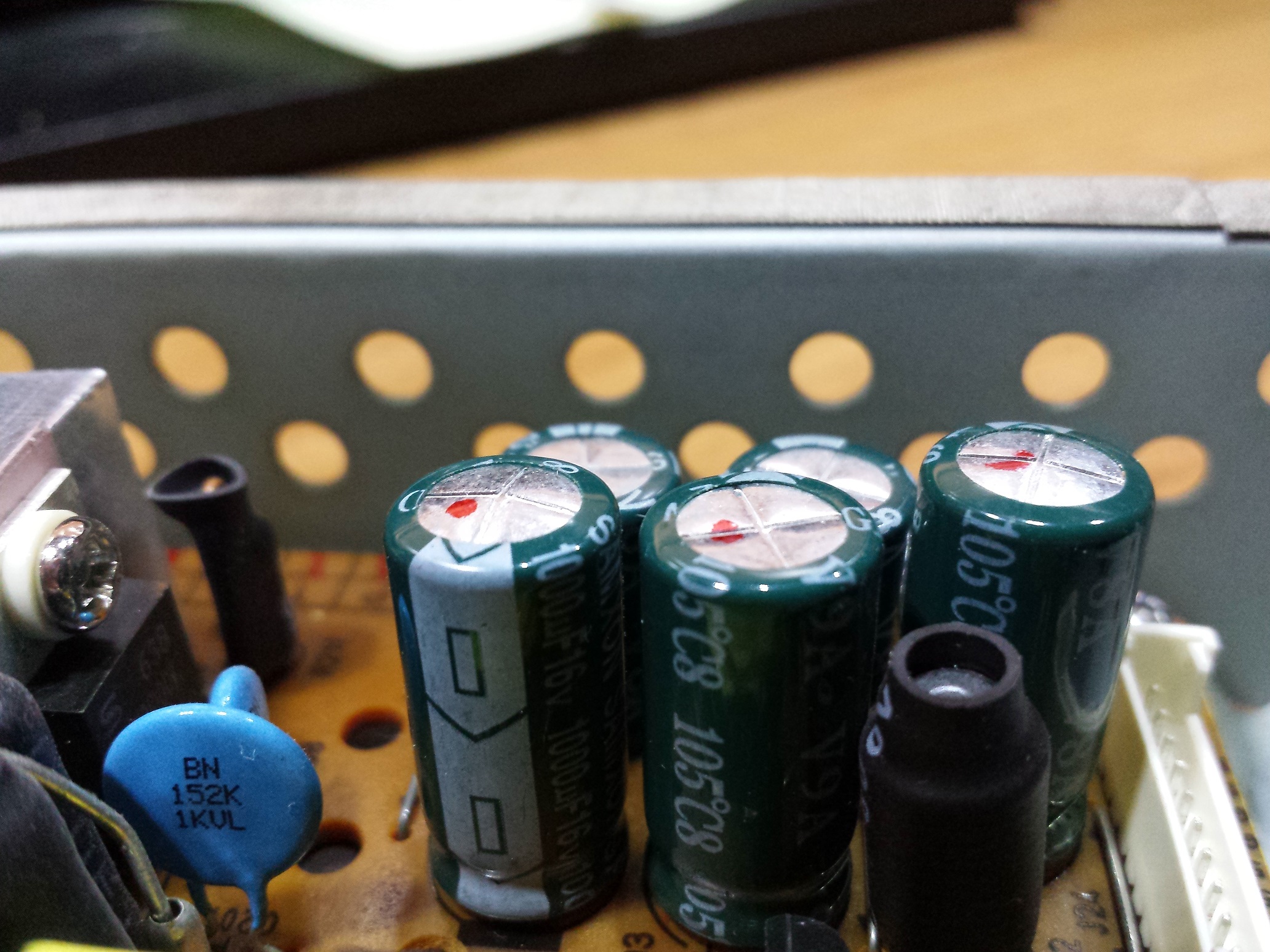

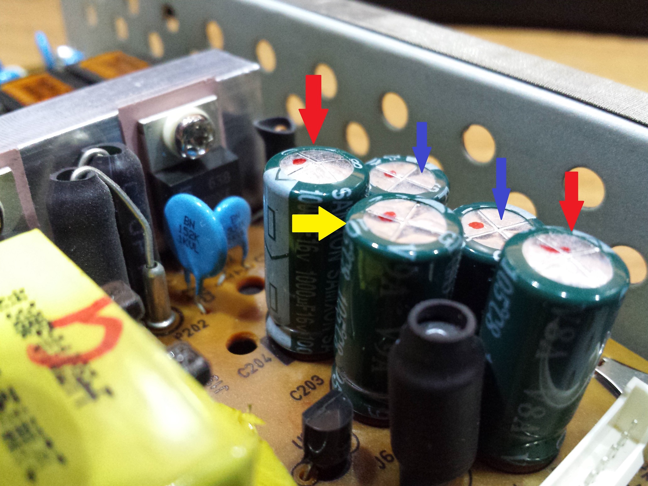

    What I did notice were some bulging caps. The caps are SAMXON GF(M)'s.
    The two that are bulging (and are on the 5v rail) are 16v 1000uf (V8A markings, red arrow),
    the two short ones (on the 15v rail) 680uF 25v (V8A markings, blue arrow),
    and the tall one between the two bulging is 25v 1000uf (V9A markings, yellow arrow) (also connected to the 15v rail)

          In reverse order, I was going to suggest considering Nichicon's PW series (or UCC/NCC LXZ series; or Panasonic's FC series). As you pointed out in the second post I quoted, the characteristics are more similar. All three vendors' series should be reasonably available and not too expensive.
          Impedance is the vector sum or the capacitive reactance (X(C)), the inductive reactance (X(L), aka ESL), and the Equivalent Series Resistance (= ESR). X(C) and X(L) are like adding a positive and a negative number, partly cancelling each other, but the X(C) of relatively large value electrolytic caps is so tiny that it is not relevant.
          Back in the 70s and into the 80s, with 20KHz-30KHz switch frequencies, ESR was the far more significant part of impedance, so cap manufacturers gave that value in their datasheets. from the 80s onward, switch frequencies greater than 50KHz became common, and ESL became more relevant. So cap manufacturers started specifying impedance rather than ESR.
          ESL is related to the mechanical construction and installation of the caps - the lead length, the length of the foils inside (for a given value/voltage a taller part has shorter foils and slightly lower impedance than the same value/voltage part).
          ESR has to do with the resistances of the leads, the foils, and especially the electrolyte. The electrolyte is not the dielectric. Different low impedance series can easily use the same leads and foils, but what differs from series to series is the conductivity of the electrolyte.
          A lot of people here use "ESR" in discussion, because it's easier to type and/or eplain than "impedance". Then there's OCD technoid lifeforms like me, , who type "impedance", .

            Thank you for explaining that. I ordered the PW series. I'll report back if it fixed the monitor.
            • secular
              • Oct 2014
              • 10
              • canada
              Re: Second opinion on replacement caps
              Replacing those two bulging caps fixed it. Thanks for the help!
