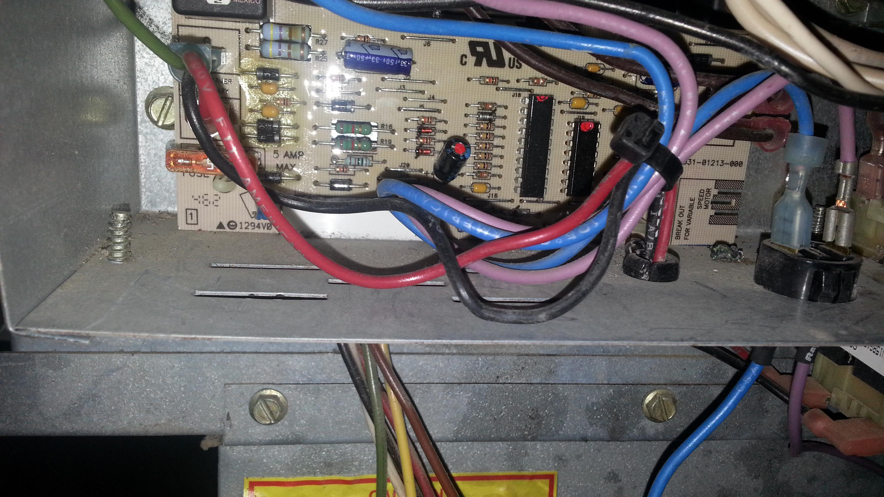

    Howdy, I'm needing to replace these EBC's but can't seem to locate them or better yet an upgrade. The only thing I see on these little burgers is "n 5 c" then under a bit more it reads "MAX 250". I let my meter dance with the Cap and this is what came out.

    Can we see the pictures? and what are you measuring it with?

          Re: Epoxy Buger Caps
          Here is a pic.
              The small yellowish/brown caps (I can see 6 of them in the picture)? Did you test them off the board or in circuit? They are Ceramic bypass caps (typical value is 0.1uF (you show the reading of 99.8nF which is within the spec of 100nF (0.1uF) and need to be tested off the board. I would suspect the electrolytic caps to be dried out by now, the ceramic cap when they failed, they failed as shorted circuit or have leakage resistance. Testing cap in circuit cannot be reliable due to other components are also connected to the cap.
              What kind of equipment is this?
              X7R, Z5U Ceramic cap.
              https://cdn.badcaps-static.com/pdfs/...c68cd3fc73.pdf
              http://www.digikey.com/product-detai...91-1-ND/818348
              http://www.digikey.com/product-detai...54-1-ND/818311

                yellow are axial multilayer ceramic.
                probably .1uf 50v
                i buy those in large numbers to replace old broken disc and mylar caps.
                        Very good y'all, its a control board for HVAC,. It don't seem to take the heat of the heater coils too well I think. Its mounted close to coils. The components need to handle humidity too. So I wanted to upgrade board.
                          If you want to help to protect it from humidity, you will need to use conformal coating which it does look like it has some on the board already. You may need better heat shield or mount the PCB further away from the heat source. May be the board has circuit function problems.
