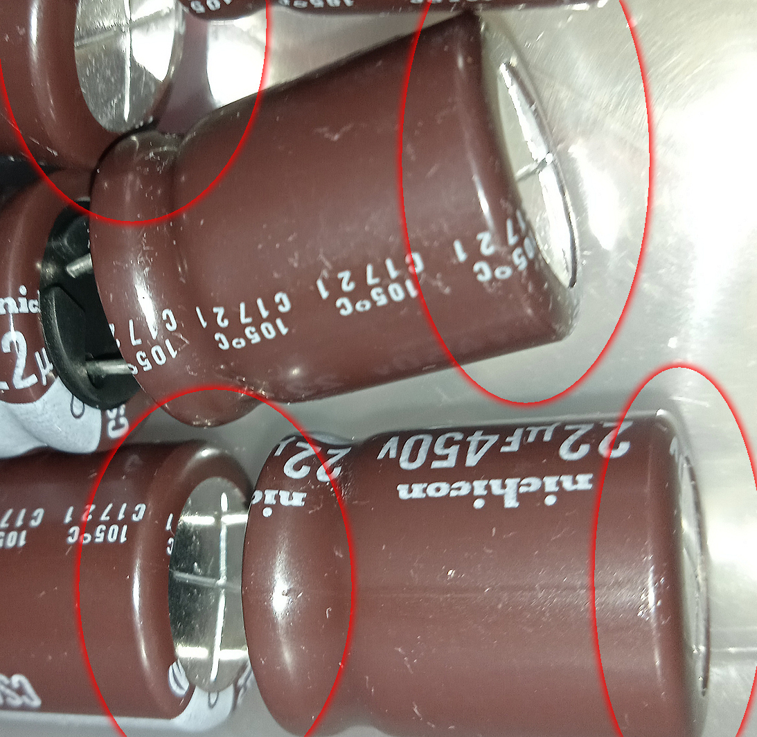

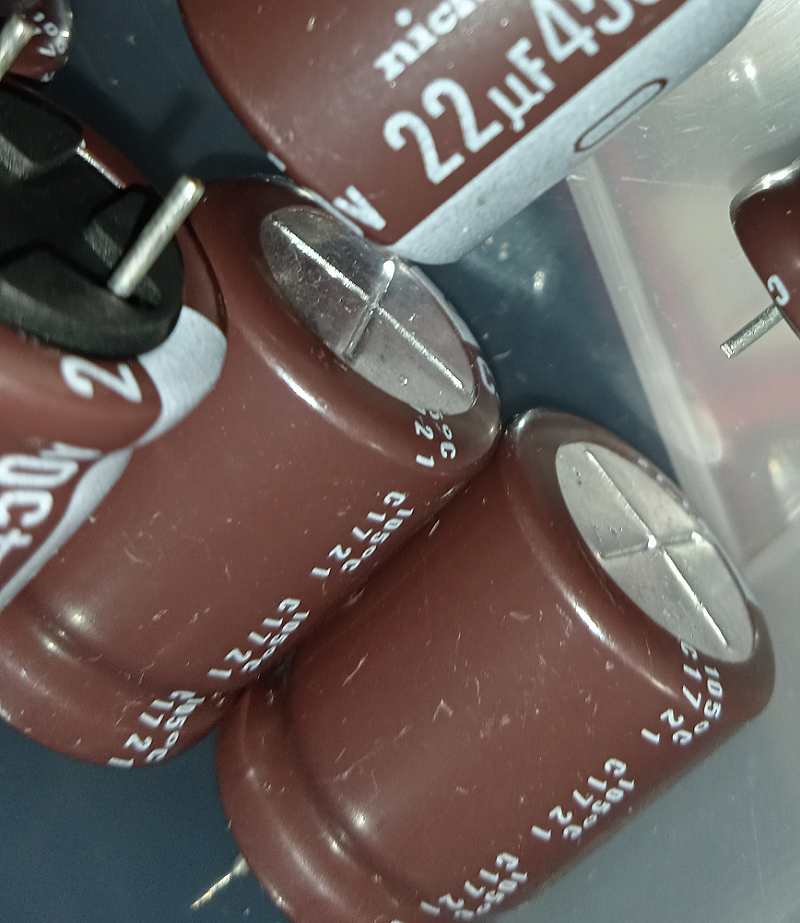

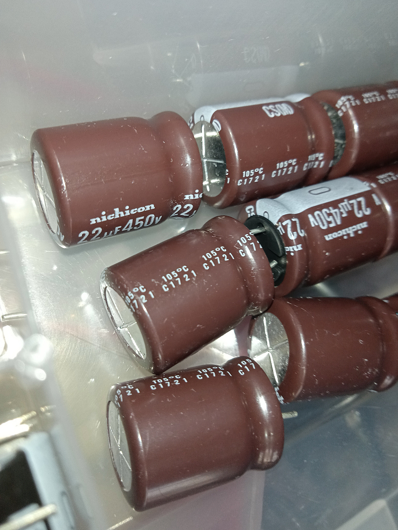

Slightly Bulging Capacitors
  • Hitto
    • Apr 2019
    • 95
    • Italy
    Slightly Bulging Capacitors
    Would you consider a slightly bulging capacitor defective if it measures perfectly and it is brand-new? To be honest, they are all equally like this: vent is not totally flat but they have very low E.S.R. and VLOSS is negligible.
    So, everything seems perfect apart from the vent looking a bit "strange". They are genuine capacitors, BTW.
    The bad thing is that they are 400V capacitors so testing them just to check how much they last would mean using them on the primary of a power supply, which means the risk of damaging the whole circuit.
    What do you think?
  • petehall347
    • Jan 2015
    • 4425
    • United Kingdom
    send them to me then i can dispose of them properly
    • Hitto
      • Apr 2019
      • 95
      • Italy
      I have seen capacitors bulging while being in storage but we are talking about one or two out of ten. This is the first time that I have seen a whole lot of identical capacitors failing en masse but still measuring perfectly (E.S.R. is around 1 Ohm which is quite an achievement for a 400V/22uF capacitor and loss of voltage is also perfectly in line compared to other capacitors of same class such as Panasonic EB).
      I doubt that the vent is deformed/bulged per design so should I ignore the fact that they all measure perfectly and just assume that they are defective and going to gas out? More feedback from direct experience is welcomed.
      • Per Hansson
        • Jul 2005
        • 5895
        • Sweden
        You could reform them with a high value resistor and diode directly from mains if you don't have a high voltage power supply.
        If they take a charge of 325VDC though say a couple 100k resistors I would say they are fine: important thing is that current drops to zero and that they then retain that charge.
        Usual caveats apply: mains is quite deadly and unforgiving about making mistakes
          • 30952
          they are done - throw them away.
          the bulge is caused by gas pressure - that will eventually push the liquid out around the pins if the top doesnt open first.
          • Mattz_GT
            • Jan 2025
            • 19
            • United Kingdom
            Slightly bulging is like "slightly pregnant"
              master hoarder
              • May 2008
              • 12170
              • Bulgaria
              Very strange if they are new. I wonder what made them bulge just from sitting in storage. According to the date codes, they are from 2017, which is relatively recent. A few years in storage shouldn't be a problem with just about any electrolytic cap (even some less-than-stellar cap brands.) FWIW, I have caps from 2009/2010 that still read OK, reform OK, pass leakage current tests, and have been fine when used for recapping equipment. So I wonder what gives here. Is Nichicon CS an inherently unstable series? Or were the caps somehow overheated??
              I also have had caps bulge and still retain their specs... and done so for quite many years (actually, a few of these I still hold on to, just to see what will happen to them... but so far so good.) In my case through, a few were pulls from Xbox 360 motherboards, where someone overheated the caps while doing a GPU reflow. So the bulge on these was due to temporary expansion of contents inside the can. Once the caps cooled and I pressed on their bulged top, there was no more pressure and the caps had gone back to normal. Stj mentioned a good point, that this can sometimes cause the caps to leak through the bottom. But in the case of my overheated caps, this didn't happen.
              Now I do also have a few very slightly bulged caps (ironically Nichicon again, but also a Panasonic) from very very old gear (1980's amplifier), and these too, are showing near perfect specs and low leakage current. However, when I pressed on their tops to check for pressure, they were still fully pressurized, so I can't make the bulge go away. At the same time, these caps have been like this for over 10 years now and still not lost their specs... and there's a few more bulging remaining in that amp, which up until recently has been seeing regular use.
              While I find this occurrence interesting, I agree that generally it's probably not a good idea to use caps like that... or at least not in anything mission-critical.
              As Per mentioned, you can try reforming them (thought a resistor) and also monitor their current as they reform. After 10-15 minutes of reforming, the current should settle to a value below the leakage current given in the datasheet. If it does, then the caps still might be OK to use (but again, advisable to do so only in less-than-critical applications, just in case.) What applications would that be? - Ones where you have clearly failed caps (that measure bad) and you just want to see/test if recapping the device can bring it back to life (i.e. a test recap, if you will )
              • Hitto
                • Apr 2019
                • 95
                • Italy
                Originally posted by momaka
                Is Nichicon CS an inherently unstable series? Or were the caps somehow overheated??
                No, Nichicon CS is a very reliable serie with long lifetime and high ripple capability. It is the equivalent of Panasonic EE/ED.
                • CapLeaker
                  Leaking Member
                  • Dec 2014
                  • 8042
                  What capacitors physically look like on the outside doesn’t mean much. They can look perfectly fine but yet are garbage. I get it, the slight bulging or pregnant look is almost a dead giveaway, but doesn’t have to be the case 100% either. Take it as you want it, it is my personal observation repairing electronics.
                  • dragon3x
                    After updating motherboard capacitors, what to do next (Asrock K7VT2, SOLTEK SL-75FRN2L)
                    by dragon3x
                    Hi, I have some 32 bits computer motherboards that need repair, as they fail to
                    power on.
                    Here are some examples :
                    (N.B. "capacitors" indicated here are electrolytic capacitors located in the onboard
                    switching supply area).
                    (N.B. #2 : I could not find a 3300 microF aluminum-polymer with a higher voltage
                    than 6.3 V.)
                    1 - Motherboard #1 : this is an Asrock K7VT2 (socket A) that still works well. To put it on test
                    I replaced capacitors with aluminum-polymer.
                    3300 microF/6.3 V. x 4 replaced by 3300 microF/6.3 V. (KYOCERA...
                    03-21-2025, 02:46 PM
                  • slybunda
                    AA and AAA battery charger capacitors?
                    by slybunda
                    hey all, iv got my favourite battery charger here which iv had for many years probably 15 years now or maybe even more. it still works good but thought id open it up to clean the dust out of it, lots of dust inside but now its clean and noticed 4 capacitors inside it and wondered if i should replace them.
                    it has inside:
                    2 x 47uf 16v caps 105c branded as Su'scon (lol sounds sus to me)
                    2 x 470uf 16v LZ105c branded as G.Luxon
                    not heard of these brands are they any good?
                    iv attached photos of the charger and the board inside for an idea on the type of...
                    12-24-2023, 04:41 AM
                    Panasonic switching power supply daughter board has two 27uf @ 50 volt capacitors which I do not keep in stock
                    by sam_sam_sam
                    I did not have any 27uf @ 50 volt capacitors but one nice thing is that it has enough room for two capacitors in parallel a 22uf and a 4.7uf @ 50 volts 22 plus 4.7 equals 26.7uf which so very close to 27uf I will show some pictures of it sometime tomorrow
                    This is one of the shit est boards I seen in a very long time and it was the daughter board the traces just lifting off the board I had to use the capacitor leads to repair the the traces and the main board is not any better because I had to repair several traces for the daughter board to the main board
                    After all of...
                    07-13-2024, 08:14 PM
                  • Ady2017
                    Are there any datasheets available for Elna RJG capacitors?
                    by Ady2017
                    I have a 2007-era Panasonic VHS combo that is full of of Elna RJG capacitors. I am trying to test the capacitors to diagnose the machine and then select replacement capacitors but I can not find any datasheets for them. I did find a Elna catalogue from 2007-2008 but there is no mention of this capacitor series. Where these specially made for Panasonic and so not made available to the public? Any ideas what to find out what the ESR values should be without the datasheets? They are all between 10V and 50V and 47uF and 1800uF. None are leaking or bulged but I know that they need to be tested to be...
                    05-25-2025, 02:19 PM
                  • beetle1303
                    Carver CM-1090 - Power relay clicking on & off, then fuse blown after 20-30 seconds of power cycling.
                    by beetle1303
                    I gotten a Carver CM-1090 amplifier from a friend who has kept it in storage for decades. Opened it up, thick layer of dust cumulated everywhere. Vacuumed it semi-cleaned, and blown off as much as possible the remaining dust. This is a 220V version.
                    On initial powered up with nothing connected - it works with all the lights and button indicator lit up as pressed, etc. I then powered off, connected a CD player into the CD RCA input and powered it on. It seemed to work for a short while and when I turned the volume up and down to see the the VUs works, the power started to clicked off...
                    01-13-2025, 08:49 PM
