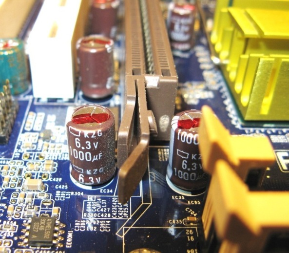

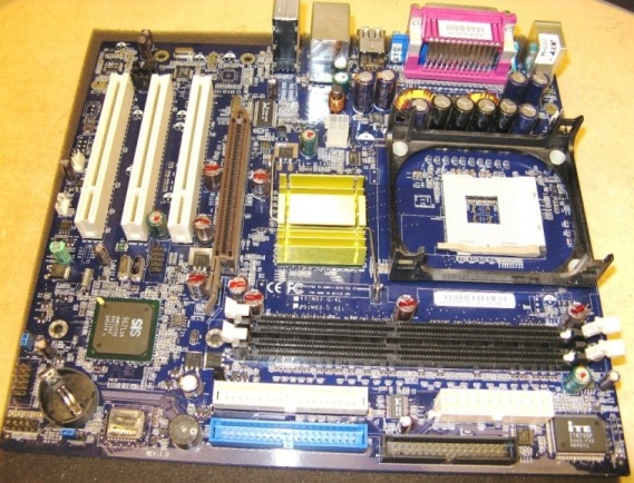

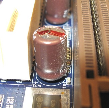

Swollen UCC KZG
  • Neo2_000
    • Apr 2005
    • 180
    Swollen UCC KZG
    I am beginning to mistrust these UCCs.
    Foxconn motherboard with Ruby's along the CPU row!

    Re: Swollen UCC KZG
    Perhaps UCC is having a bad run of KZGs ala Nichicon's infamous HM/HN?
    The ever-amazing (and ever-affordable) KY, Chemi-con's best kept secret.
    I'll probably be the only person going to SteamOS once it gets out of beta (ha ha.)
    • Tom41
      • Oct 2005
      • 336
      • England
      Re: Swollen UCC KZG
      It's possible; even the best brands fail from time to time. Nothing is perfect, even Rubycon has been known to vent occasionally...
      However, ANY cap will vent if exposed to extreme temperatures, or connected incorrectly. Reverse the polarity, or put too high a voltage into it, and it'll blow. Likewise, if the temperature at that point is too high, it'll boil the electrolyte and pop goes your cap.
      Could it have been connected up wrong? I remember a design flaw on a certain motherboard where one capacitor was put in backwards! Also check the temperature in that particular area of the case. If it's approaching the temperature printed on the cap, that's the reason it blew.
      You know there's something wrong when you open your PC and it has vented Rubycons...
      • willawake
        Super Modulator
        • Nov 2003
        • 8457
        • Greece
        Re: Swollen UCC KZG
        it should blow very quickly if so. Like during testing perhaps.
        are you talking about an msi board referenced here? that was an error in the pcb markings found during recapping. not a capacitor being installed at the factory backwards.
        everything is becoming crap these days
