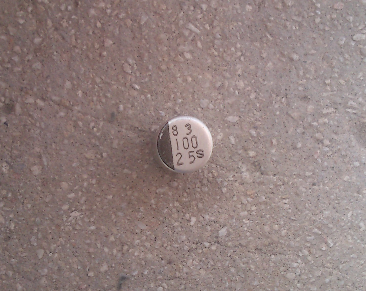

    Hello, i have a dv6700 for a customer that runs for 1-2 seconds only, i have re-flowed the GPU(twice) but the problem stays.. so i want to try to change the tow capacitors next to the cpu before replacing the gpu. the problem is that i am not sure about the capacitor values "i never saw them before" so i hope that you guys can help me(tell me the uf & v) of them. picture in the attachment
    maybe 100uf/25v??
    thank you very much

    https://cdn.badcaps-static.com/pdfs/...efb5c1729b.pdf
    100uf 25v

      Thank you Duncanbest ,
      i have alady replaced it with 100uf 25v but didn't had the courage to try it , now that am sure about it i'll be trying it next morning .

        If it only runs for 2 seconds and shuts down then the GPU/chipset is likely shot. Measure across the small ceramic capacitors on the top of the chipset and GPU (if it has one). If any one of them measures under 4 ohms then the chipset is shorted and needs to be replaced.
