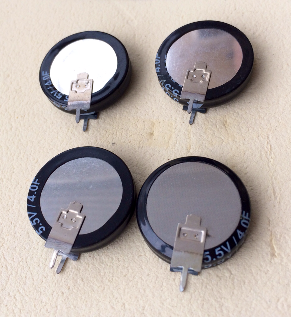

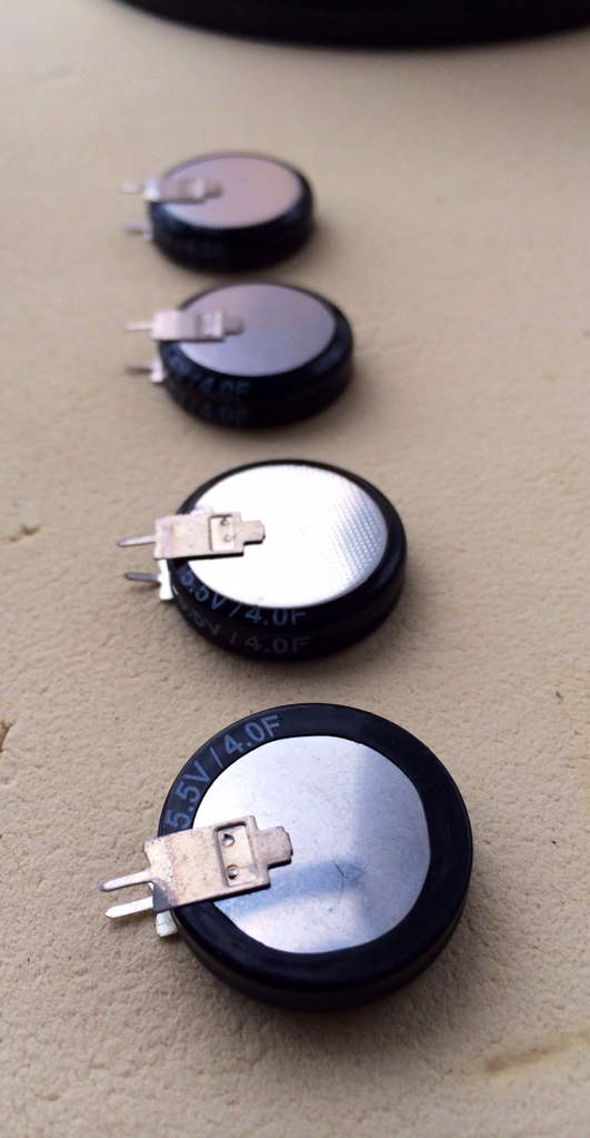

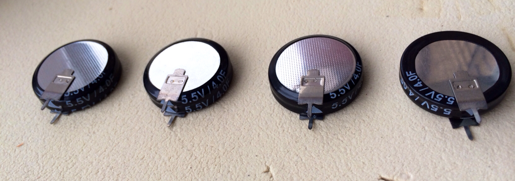

    feedback capacitors...supercapacitors...
    Good afternoon. That review these supercapacitors you benefit? have you done any experiment with something? are good? I know more of them. if you can help. regards.

            My question is, are good capacitors? What I want is to speak a little about them. A greeting

              Re: feedback capacitors...supercapacitors...
              There are several types of supercapacitors.
              The ones you show in the picture are not the kind that could be used like a regular capacitor is used, because they have a high internal resistance. They can't release the energy in them very fast, so these are best used for stuff that doesn't use a lot of power.
              For example, they are often used as 3v battery replacement for time keeping chips or instead of a BIOS battery. When the device is on, the super capacitor is charged and can provide power to the bios chip for lots of hours (or days) until the device is plugged in again.
