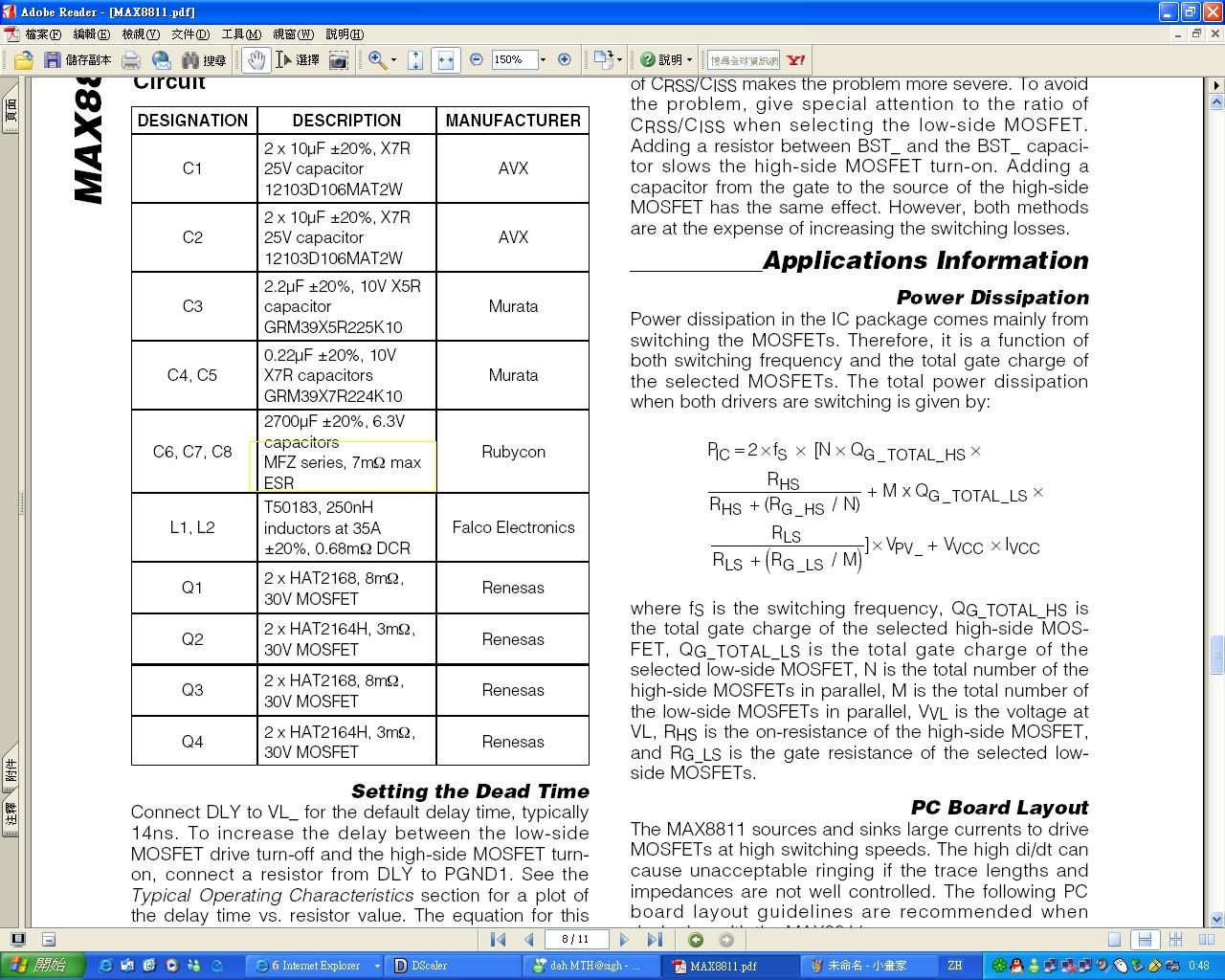

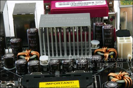

    Recently, i researched these 2 kinds of polymers on some new L775 mothbaords. However, we can't find any datasheets from Rubycon 2007 catalogue and the latest catalogue of Chemi-con.....
    I just found a little bit information about MFZ and TMV, anyone can get more information about these 2 types of polymers?
    A little bit information of MFZ from this datasheet -->
    http://datasheets.maxim-ic.com/en/ds/MAX8811.pdf

    I'll check my 2007 Rubycon paper catalog and try to look into it when next these two 'cons come for a visit. UCC seems particularly slow about getting info about news series onto their web catalog, and I'm not sure Nichicon or Rubycon are much better. Is the Rubycon part one of those stacked foil-and-polymer types for use under the uP? I know their paper catalog has data on one such new series. Also, both Nichicon and Panasonic have fairly new products that seem to fit that application and form factor.

            Well, I got a 2007 UCC paper catalog. No TMV series in it, polymer or liquid electrolyte. UCC plans to continue to use PS(X) and PX(X) for their polymer series names (through-hole and SMT, respectively). There is no new series responsive to Nichicon's PA series in the catalog. In some other literature we were given, there is an MFZ series mentioned. In context, it appears to be a UCC part, but it is neither polymer or liquid electrolyte. It appears to be positioned as lower ESR than liquid electrolyte but higher ESR than polymer. It is not mentioned either in the catalog or online.
