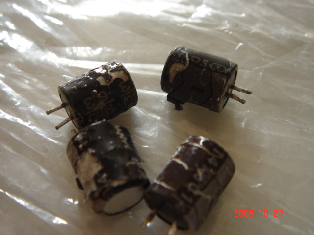

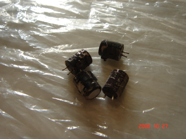

    LCD Monitor with bad caps OSCON?

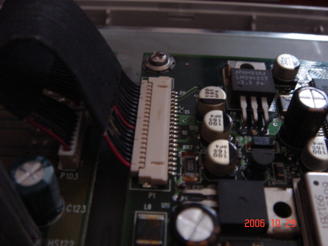

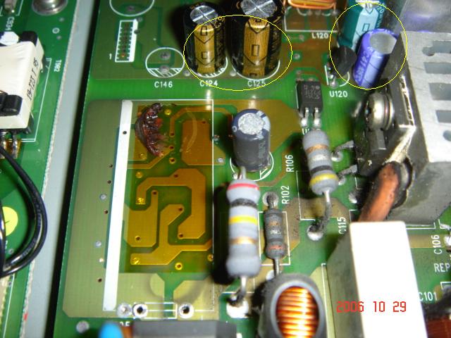

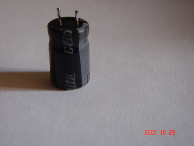

    These OCSON pull out from the TINY 15" LCD Model: BJ350 It is was 8 years old.
    I am surprise the original color is that color or not?

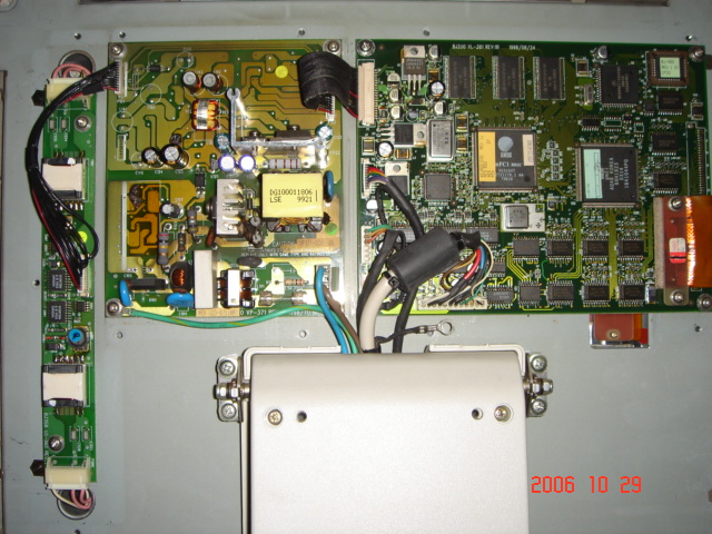

    Re: LCD Monitor with bad caps OSCON?
    interesting one you have there Joe.
    the text on the caps looks authentic. but i have not seen them that colour (only purple for those kind of series) what happened inside that lcd? looks like very much heat.

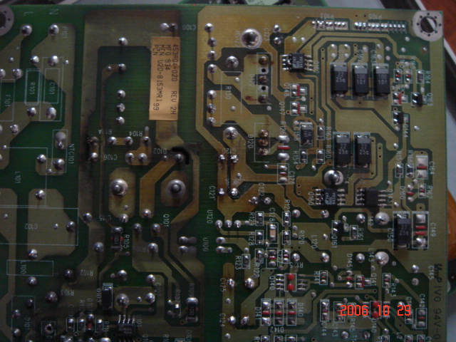

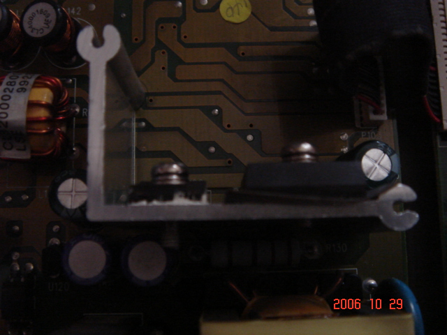

    any pics of the lcd board?
      the lcd survive the fire?
      weird.
        hm, 8 years of high temp usage? where is the problem? Recap and have fun another 8 years.
          oscons i have seen are blue,purple,or red.
          cant tell much from the pics but those look like fire victims.

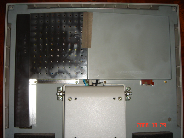

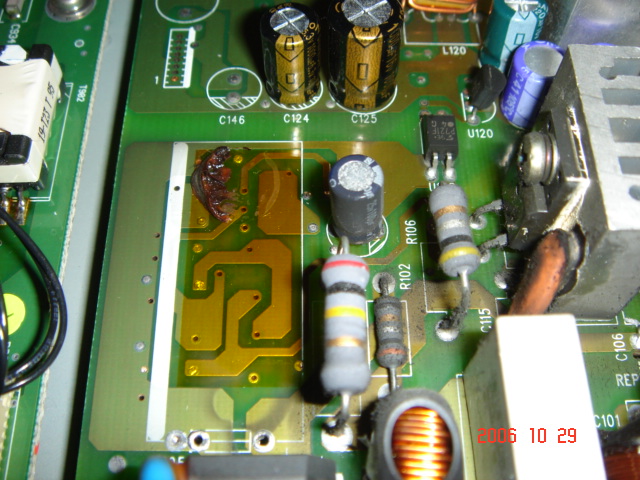

            Yup, i have saw the purple OSCON only. The LCD monitor will shut down automaticlly within 1 second now. There is some bad smell on from LCD, i guess the internal power supply is burn. LCD circult board will upload here later.
            weird.

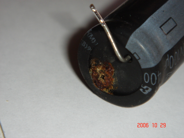

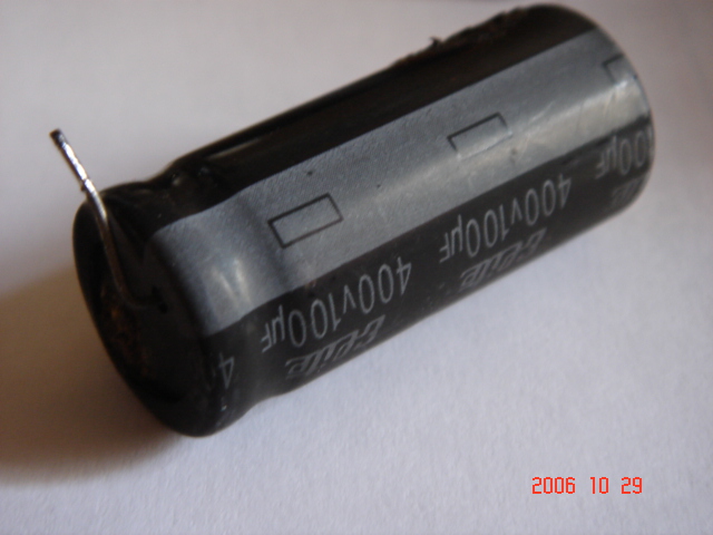

            It is not survive the fire, there are also some other E-Caps crap, like 1 pcs of 100uF 25v and 100uF 400v(big size)!
            May be you are right, i guess there is very high temp inside for a long time. By this reason, OSCON outlook was affect by the high temp for a very long time, so it seems look like burn by fire.

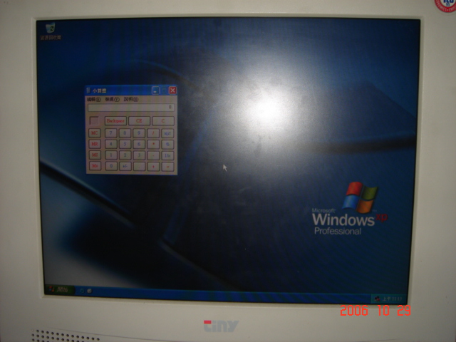

              Updated. The problem is fixed now.
                100uF 400v crap...

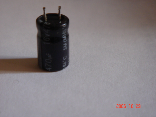

                  Forgot to mention 4 pcs OS-CON was recapped with 3 pcs Samxon E-caps and 1 old purple OS-CON.
                    Argh, those Elite caps are widely used in many CRT`s. Especially many Medion 17 and 19" are kontaminated with them in the main SMPS. But ok, they aren`t desinged to last more than 3 years. Most of them are failing earlier, due to bad soldering, a bunch of worser badcaps than Elite and bad manufacturing (e.g. loosening concetors).
