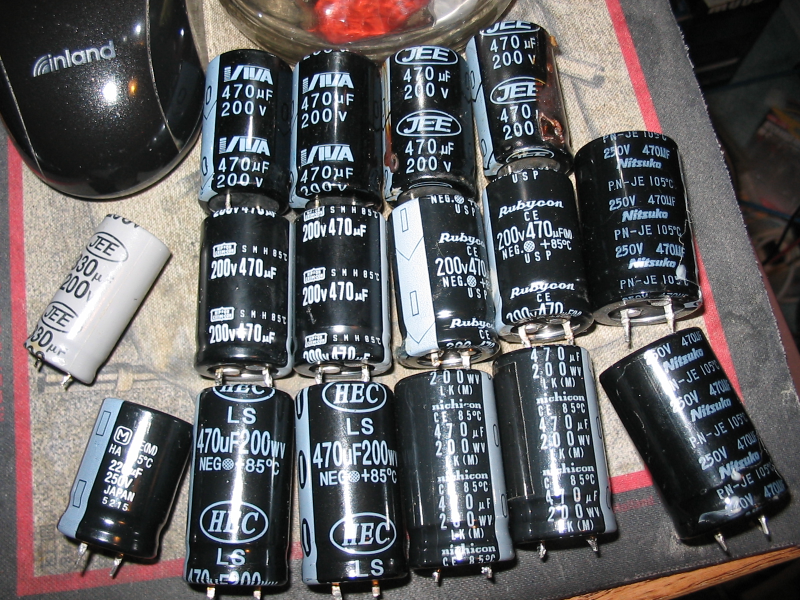

    I suspect most people don't see thse caps fail often, but I ended up collecting these as I parted dead PSUs over the years. Now I don't remember which came from what, but I definitely parted 7 ATX PSUs as there are 7 pairs of capacitors...
    Oddly enough they are all 470/200's indicating all of the PSUs are around 200-250W despite distinctly remembering one that was "rated" 400W. Liars.
    I did a quick ESR check on all of them, none where way out in the weeds. The JEE 470's were the worst, the others were out of the resolution of my ESR meter. They also appear to be out of a unit that suffered heat as witnessed by a bunch of fried glue on them. I think they belong in the trash, I'll never use these capacitors... or any of the other better ones most likely, either.
    The HECs were the only ones with domed tops, but it's a plastic bubble top not metal... and you can press down on the top without too much difficulty.
    I'm surprised I haven't seen any duplicates yet, indicating there are one heck of a lot of capacitor companies out there...
    Nitsuko Nichicon HEC Panasonic JEE NipponChemicon Rubycon Viva

    By "out of range," I assume you meant that the ESR was too low for your ESR meter to measure. In that case, the Jee caps are probably bad. The rest could be kept, but I wouldn't use the HEC, Viva, or the 330uF Jee for anything critical.

      Yeah HEC are pretty terrible. Nice collection though

          One thing ... the Nichicon, Rubycon, and Nippon Chemicon parts are all from good series, BUT they are 85*C parts, not 105C parts. They're good parts but should be used with decent cooling.

            Aren't most input caps rated at 85C? And is that JEE cap burned or does it just have conductive glue on it?

              The JEEs have fried glue on them indeed. Out into the dump they go, or maybe they should go through a dissection...
              Then again nothing very interesting in a capacitor...

                Nope. The Nichicon series in the pic is the LK series; the corresponding 105C series was the GK series. The NCC/UCC series in the pic is the SMH series; the corresponding 105C series was the KMH series. Those series came out in the late 80s, as 85*C and 105*C parallel series; I'm sure you would find similar parallel series in Nichicon's and UCC's (and others') current catalogs.

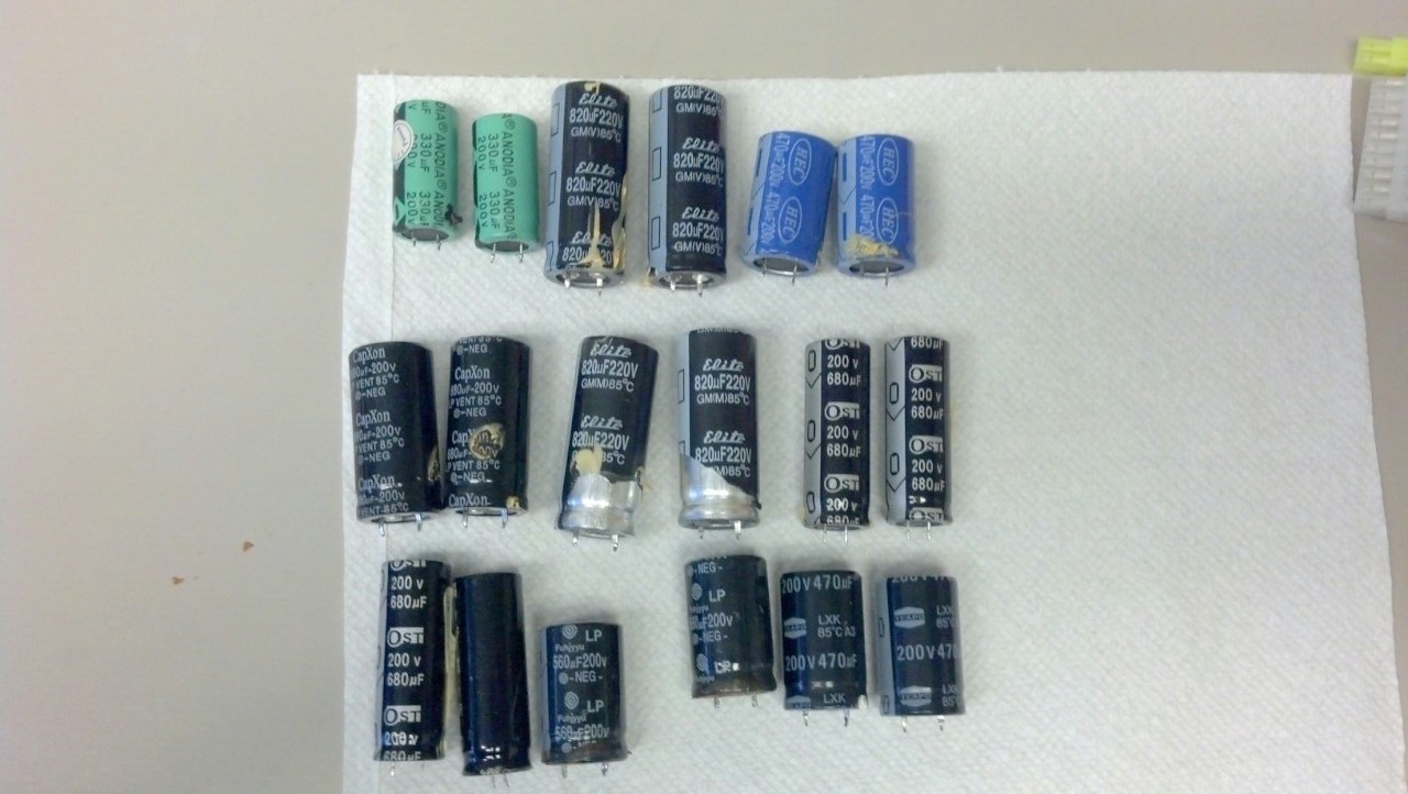

                        Thought I'd share mine is well, I like collecting input caps too this is probably half. I should be getting an ESR meter and capacitance tester soon I'm curious about their results. Out of all of them I think the Fuhjyyu is by far the most overspec'd. Not only are they small for 560's, they're as light as a feather!

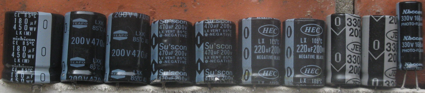

                          I have only been pillaging caps for the past year or so, so I don't have many filter caps to play around with.
                          Nichicon LK 180uF 450V 85°C N0124 - this one came from a 2001-era 51cm Sony CRT TV, found on the roadside with a smashed tube. Every other cap inside was either Nichicon VR or Rubycon YK/YXA (all 85°C general purpose), no cheap brand caps to be found.
                          Teapo LXK 470uF 200V 85°C 05/04 - My former Acer OEM, FSP Group FSP200-60ATV power supply (link here).
                          Su'scon LX 470uF 200V 85°C - Trash-found, blown L&C crappy PSU (link here).
                          HEC LX 220uF 200V 105°C. "L" (red italic L in a circle) ALS-300 ATX PSU. No pics since I had already dismantled and scrapped the PSU. However, I may put up pics of a second identical, working PSU in the near future. The tops looked domed on both caps, but it was found to be just the plastic cover after removing the top from one.
                          JEE CE·W 330uF 200V 85°C IM 9828 - King World crappy PSU (link here).
                          Nbccon 330uF 160V photo flash cap - Trash-found, dead, 2000-era Olympus digital camera complete with two leaked gold-coloured Coles (supermarket) brand AA alkaline batteries and acid everywhere. For those down here, it was the old Coles logo formerly used on Farmland products and the like, so those batteries must have been in there for years on end. The LCD panel on the camera was smaller than a Game Boy screen!
                          Last edited by Heihachi_73; 11-30-2012, 06:43 PM. Reason: Helps if the link is put in

                            You should cut open the fuhjyyu's and look inside!
                            Get rid of the OST's, they like to pop.

                              I don't believe that you advice him to throw away the OST. HV caps rarely go bad, even when they are crappy brand like JunFu or even Capxon. OST HV caps, I would assume them as being quite reliable.
                                Re: My HV input filter cap collection (good and bad?)
                                Sorry, I just had to say that, because I have seen about half a dozen of them bulged. All 680uF 200v....
