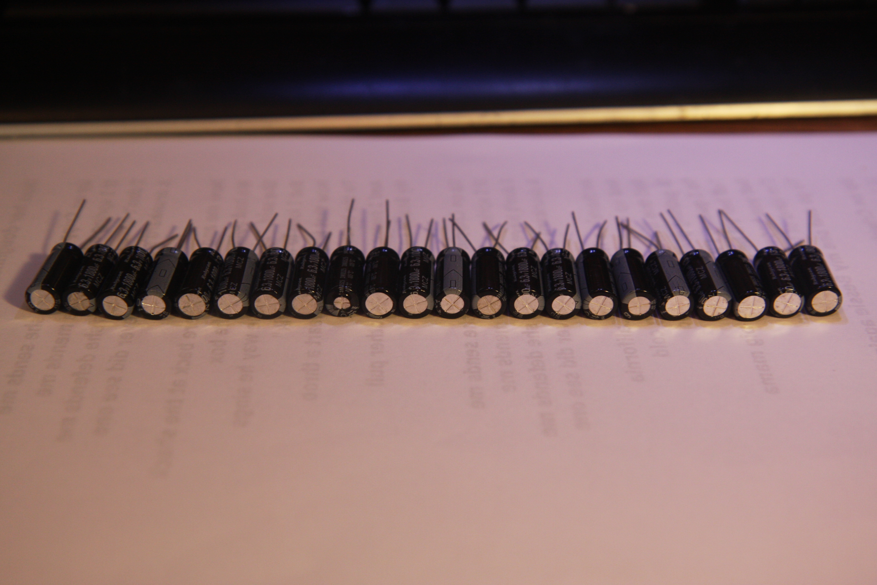

    FAKE Rubycon 1800uf 6.3v MCZ
    Got these off ebay from startboy1010
    Pure FAKES

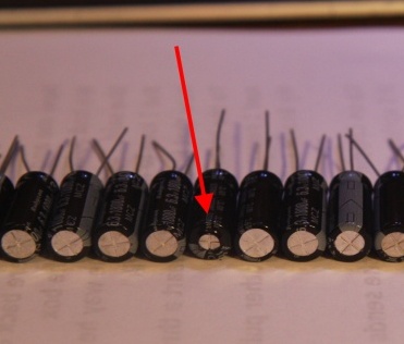

      Re: FAKE Rybycon 1800uf 6.3v MCZ
      Those are so badly faked it's actually funny
      Look how far in the sleeving is pulled on one of them
      This kind of reminds me of the time when the discription and title suggested they were NCC Polies, but they were actually Sacon FZ Time to stick 'em in a fire or or overvolt them

            Re: FAKE Rubycon 1800uf 6.3v MCZ
            yikes!
            those are about the worst fakes i have seen in a while.fake in so many ways i dont know where to start.
              Yup, completely fake. Should have ordered here to begin with and avoided all teh fake ebay garbage.

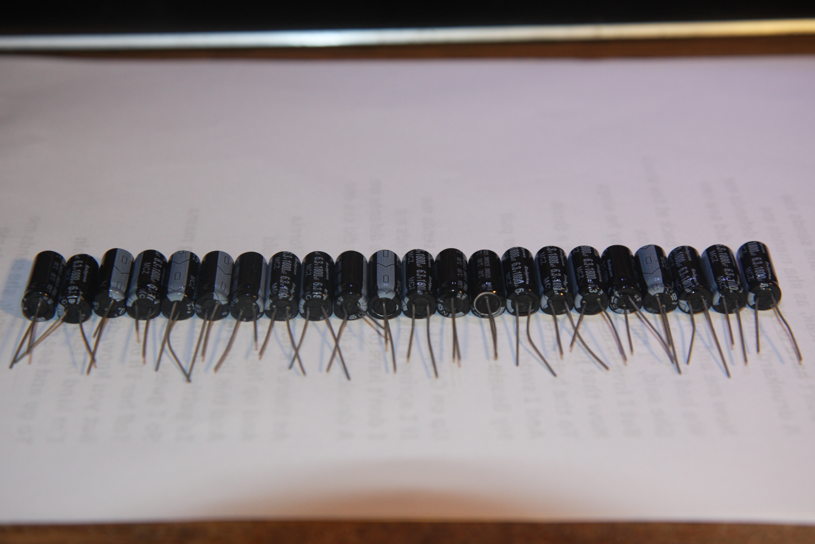

                    lol
                    Look at how the bungs are from a grab bag.
                    Some are circled, some are wavy, some are flat, some are shiny, some are dull.
                    Would be cool if we could get a pictorial dissection to see what is inside them!

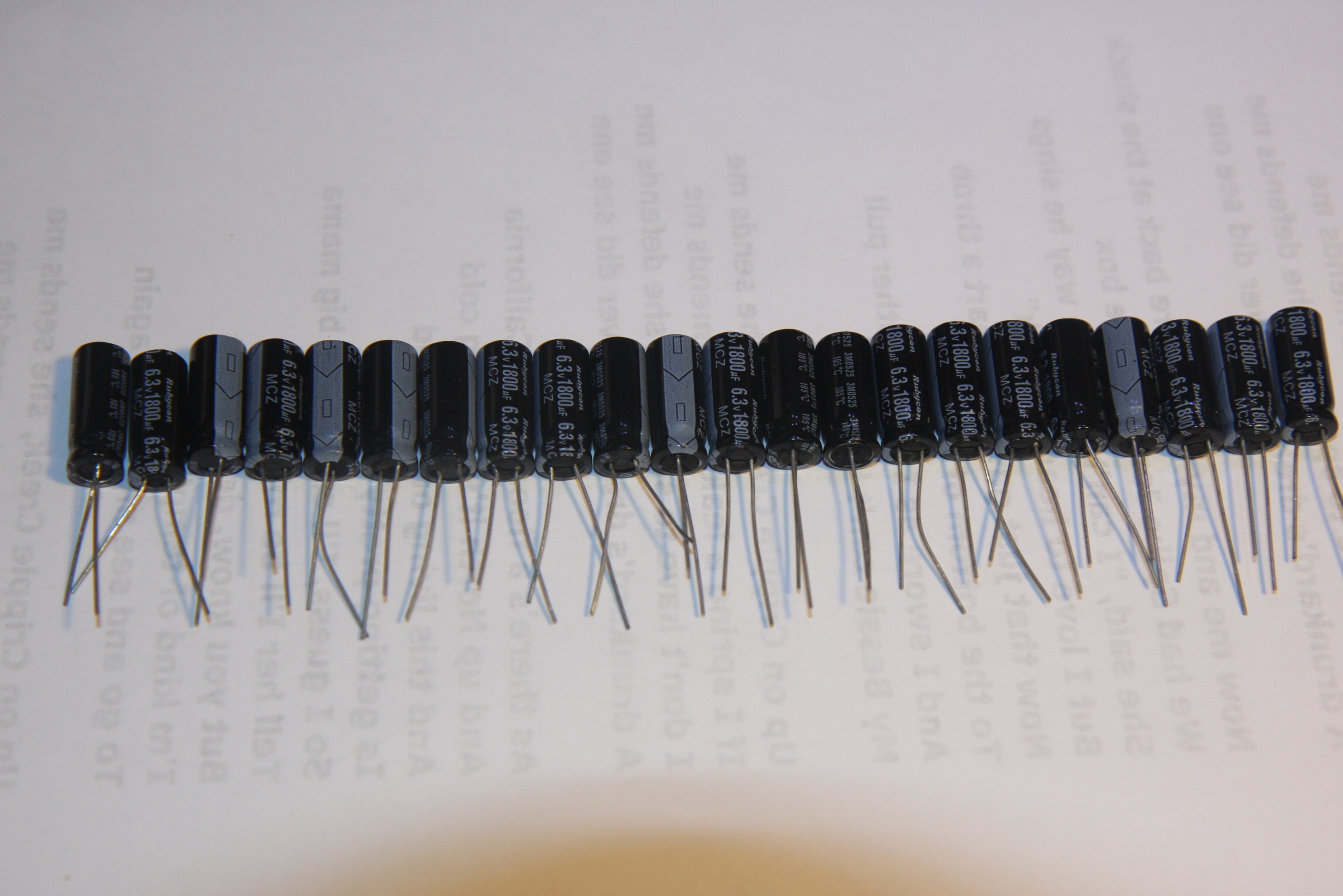

                      if the geometry of those pics is correct there is no way those are 8x20mm.
                      or should they be 8x25?
                      either way everything i see is FAKE!

                        I suppose I should chime in here..
                        I have some experience re-capping.. but no means a veteran. I'm learning. All my caps had come from Mouser so far EXCEPT these. Some may wonder why fleabay... not know no better... 'till now... but knew enough to see something wasn't right. I'm sure there are some honest cap sellers on the bay though. Yea, I intend to return them... with negative feedback. The guy can't count either.. sent me 21 caps and ad was for 25.
                        I have learned much from BadCaps folks and want to thank ALL who help out lesser knowing ones as myself. If not for the people here, I may have never known about FAKERS and installed them in someone's board.
                        FWI.. they all tested just above 1400uf... and most measure 8x20
                          Thanks again everyone. I wish I knew half of what the pros do, I may then understand what a board I just capped with all Mouser caps won't turn on. :>)
                          P&WW
                          You should keep four, and take them apart
                          If the seller asks why there aren't 25, just tell them, I only received 21 caps :P
                              It's almost like they tried faking Nichicon HM and then decided to put Rubycon MCZ on the label pathetic
