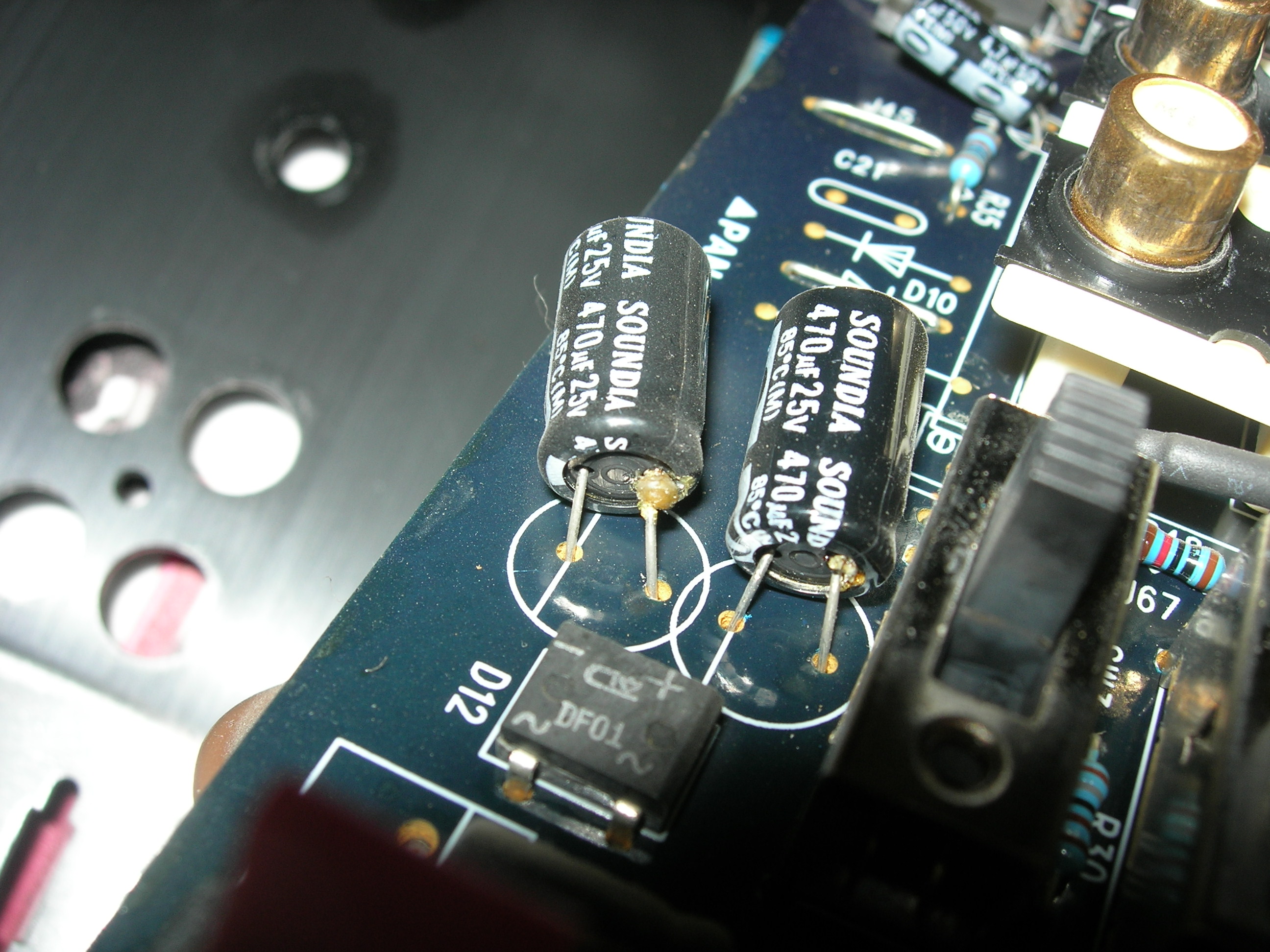

    From an audiosource subwoofer built in 1999. Subwoofer is hums with no RCA line connected to it or when the receiver is off.
    Is that stuff glue or busted caps?

    Bad caps

      Looks related to Anodia caps..

        Looks like they're right after the bridge rectifier, maybe used to create a split power supply.
        It's possible there's quite some ripple from the transformer coming into the caps - replace them with a good brand capacitors (panasonic, nippon chemi con, nichicon) and consider replacing them with 35v rated ones, those will handle larger ripple better..

          that your hum right there.replace all of them.

            I replaced those 2 with 470uF 35V RadioShack ones (only ones i could get on short notice)
            Hum is definitely improved, but still present. The other caps didn't look to have any issues

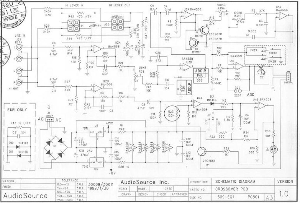

                I've attached the schematic. I *think* I replaced C7 and C18

                  You mean c17 and c18 .. it's the two by the bridge rectifier D1.
                  Radioshack buys general purpose capacitors from various companies and rebrands them.
                  They're generally not suited for use in locations that are subjected to excess heat or ripple, or if they need to be low esr.
                  It may work now, but they may go bad sooner or later.
                  If you're going to buy a proper set, I recommend also changing the capacitors after the linear regulators , C15 and C16 ... both 100uF 16v. Replace them with 100uF 25v, preferrably Panasonic FC, FM, FR, Nichicon HM, Nippon Chemi Con KZE
                  The reason is mostly because those two ICs U5 and U6 are linear regulators, which means they take 14-16v and output stable +12v and -12v but the difference is dissipated as heat into the area around.
                  If those 100uF 16v are near the linear regulators, they would be constantly under heat from those ICs. Going to 25v is not required, as the capacitors will only see 12v on them, but usually capacitors rated for 25v are just a bit larger and more resistant to heat. From the pictures, it looks like you can fit slightly larger capacitors.
                  Check the badcaps online store, should find both these capacitor values+voltage ratings or use digikey.com / newark.com etc

                        What about C12 and C13 too? They look related to the power supply..

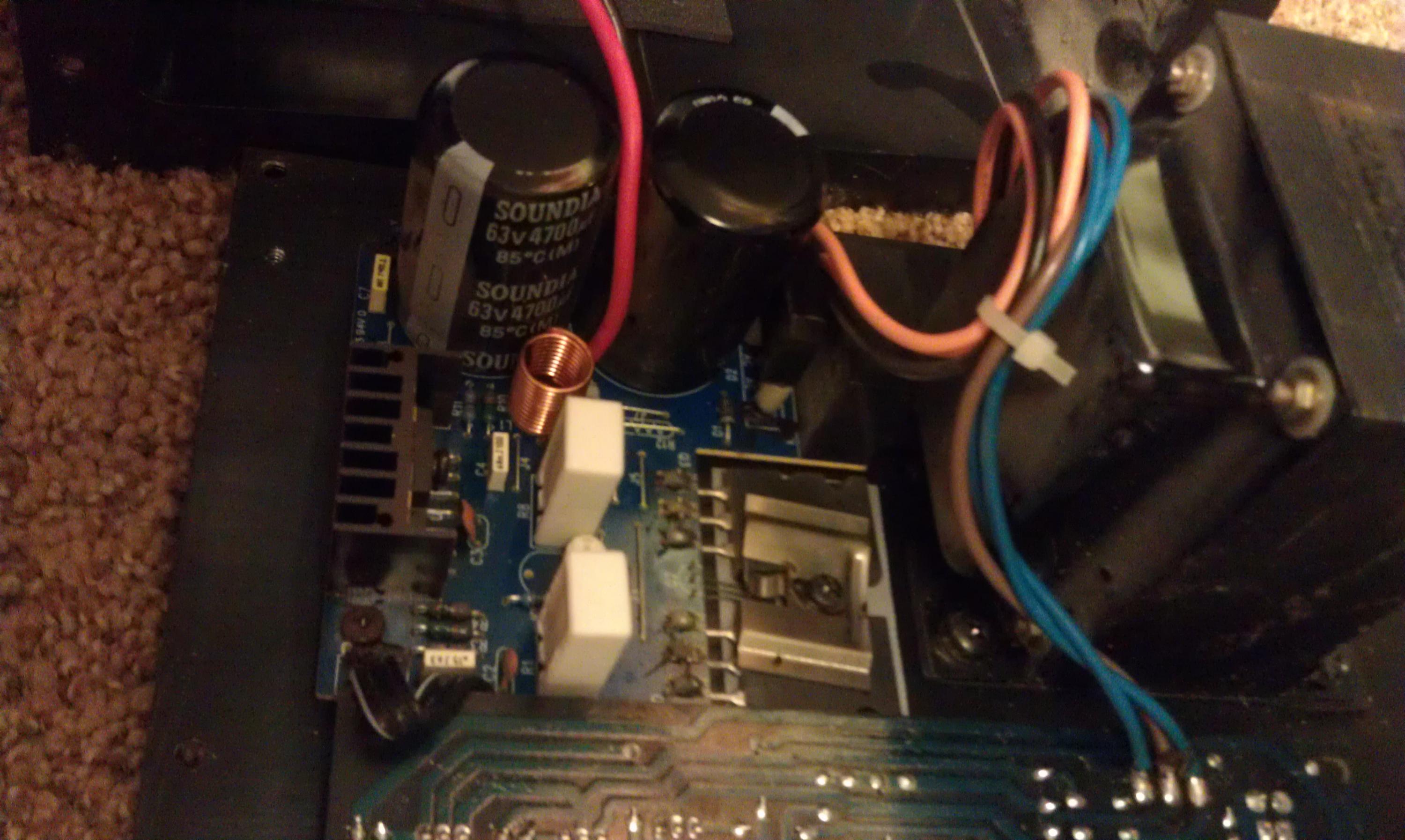

                                  These were the caps immediately next to the speaker leads (the red and black wires). Just ordered replacements for them + all those suggested above

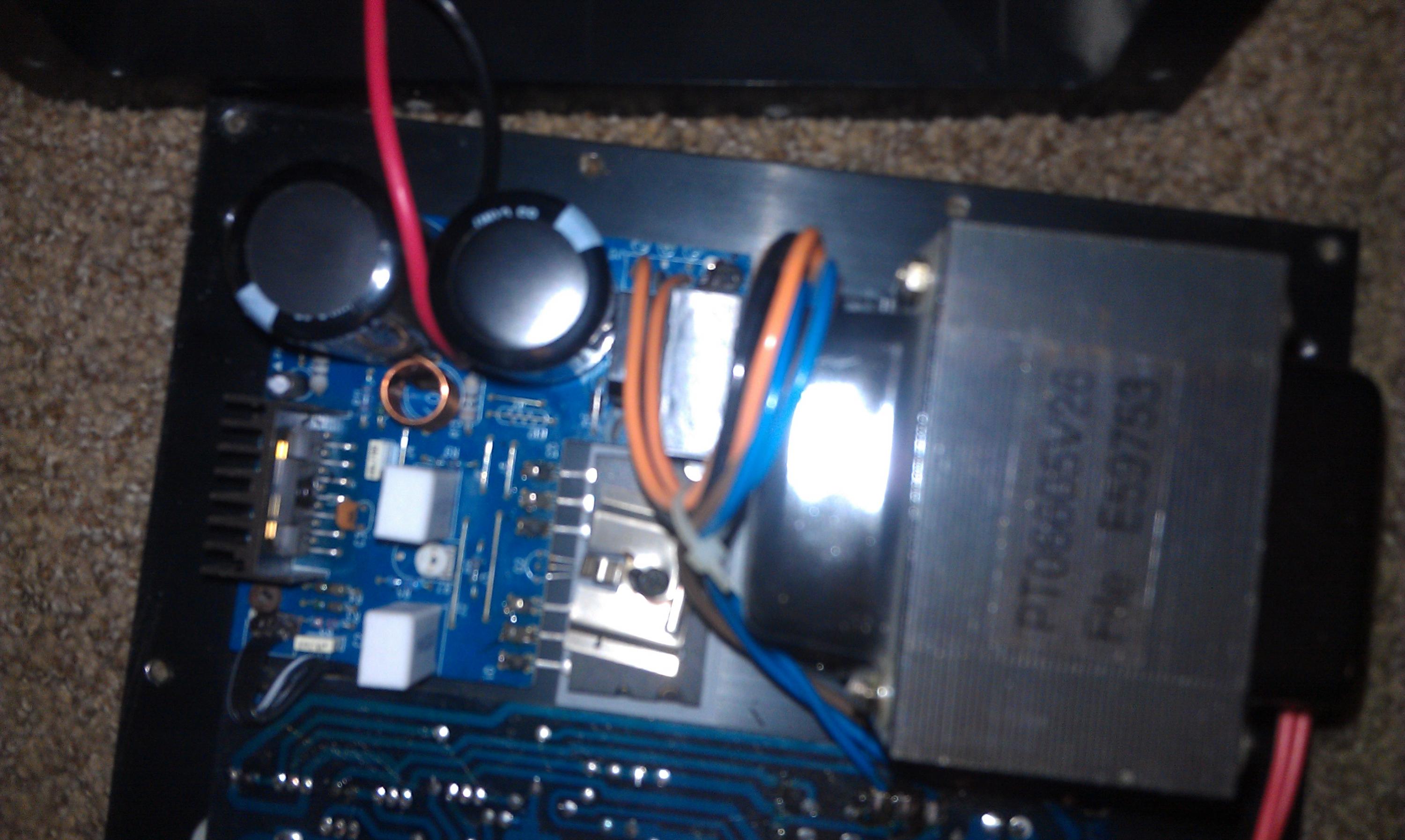

                                    Well I replaced all the caps suggested and the two big ones pictured, and there is no improvement

                                      Re: Bad Soundia Caps?
                                      Is it possible that you have a ground loop somewhere?
                                      Is it buzzing with NO input wires connected?
                                      Have you checked the rectifier diodes to see if they could be leaky?

                                        It's humming if the sub is the only thing plugged into the wall - no input wires connected at all
