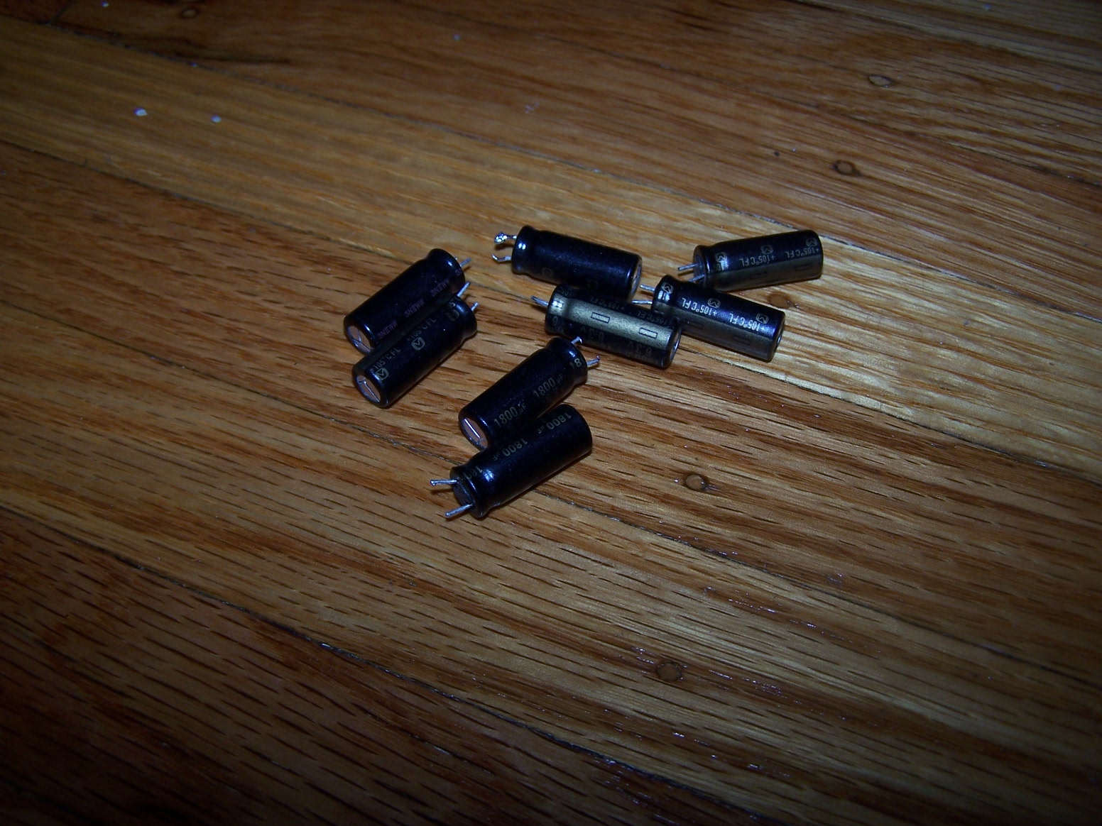

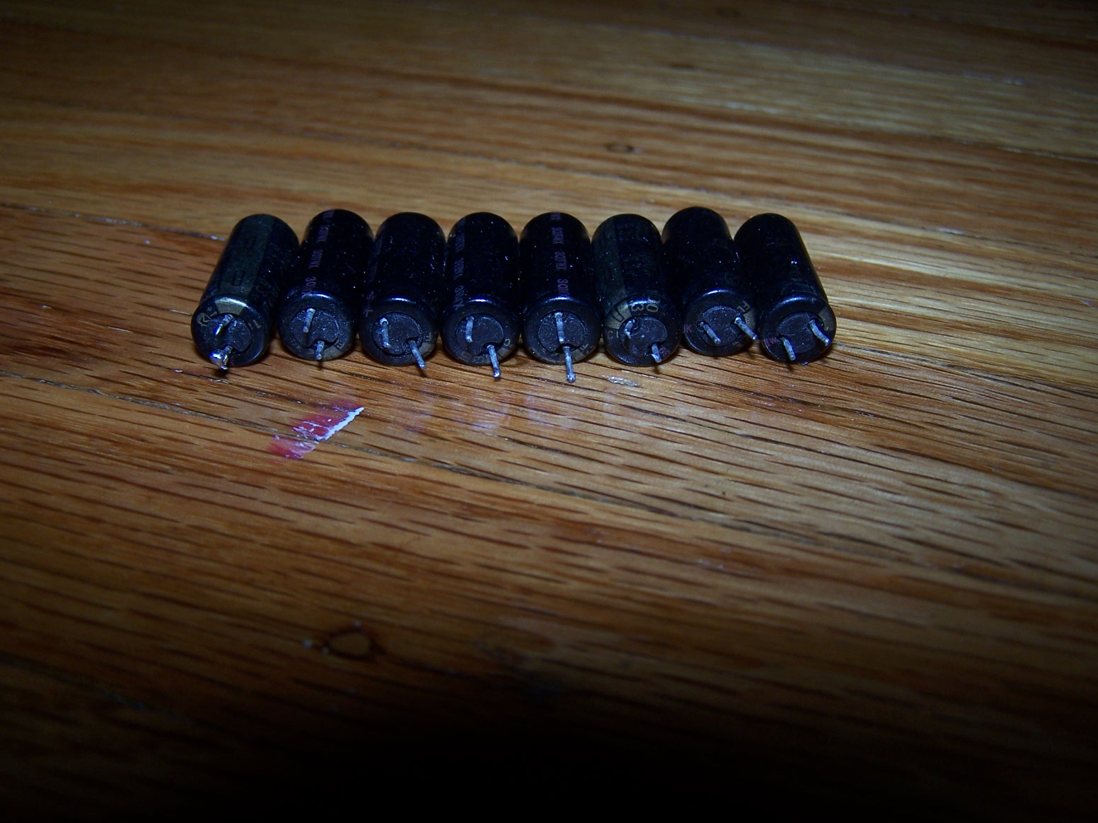

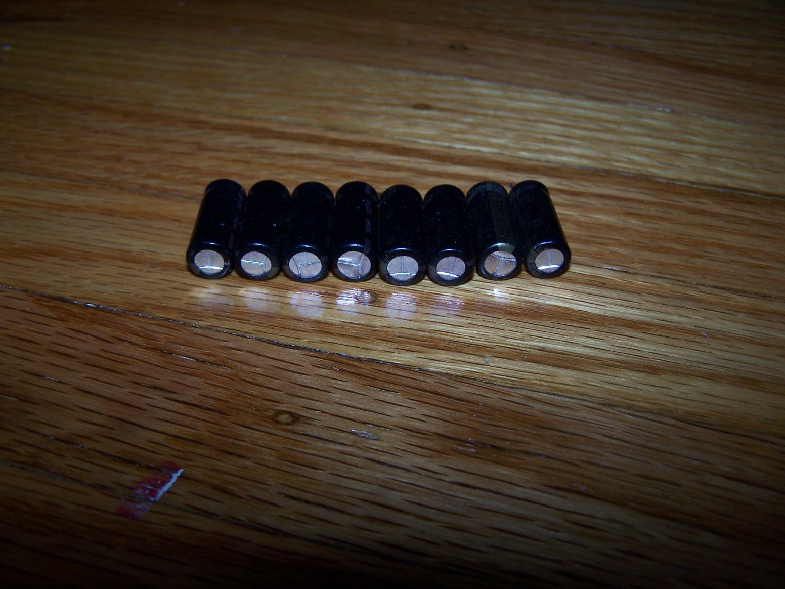

                      Re: What's Dealextreme up to again? Panny FL for sale??
                      Well, it turns out I have no fewer than 8 of them in my stash.
                      Some poorly lighted pictures:
                      The Vents:
                      The Bungs:
                      The Sleeves:
                      The datecodes on them are: ( numbers in parentheses indicate multiple occurrences)
                      (2) 39IIIWX
                      (2) 30IVWX
                      (3) 30IVUK
                      (1) 3NIIWW
                      Unless Topcat sent me fakes (Which is VERY, VERY unlikely) , that's what legit 6.3V 1800uf Panny FL caps look like.

                        Panny always use flat bungs on their 8mm and smaller caps. 10mm and larger get the other kind.
                                  Good thing that you mentioned this. Don't know why, but up to this point I have always been left with the impression that all Panasonic caps have the elaborate bung regardless of the size. I was wrong, though. I just checked some in my Panasonic cap stash, and the 8 mm diameter and smaller ones do indeed have flat bungs (had a few 8 mm FJS ones as well as a bunch of old 85C general purpose ones 8 mm and smaller).
