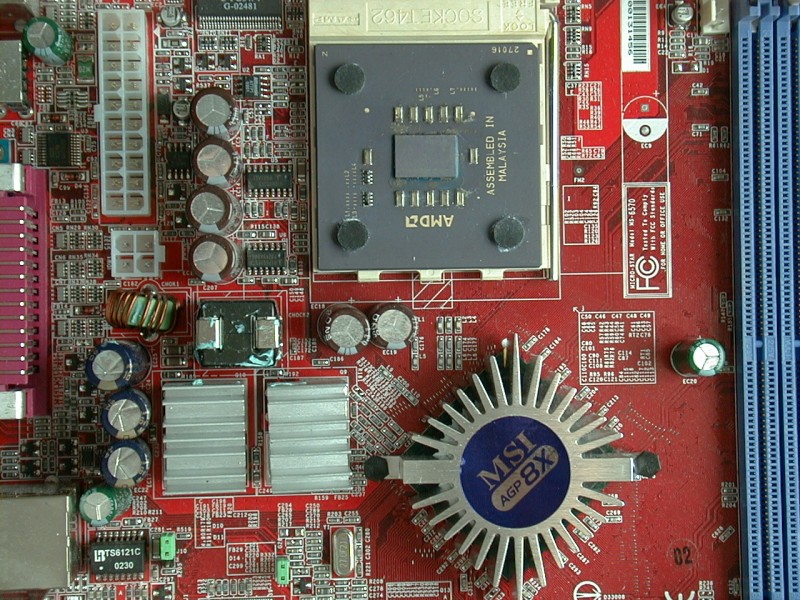

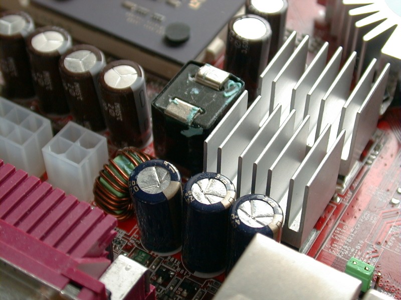

    I got an MSI K7N2G board for free a while ago. The board seems to be totally stable, though it's generating a loud electrical noise. I can't tell exactly where the noise is coming from, but I think it's somewhere near the coil next to the mosfets, or from the coil itself. The noise is really loud, I can easily hear it from another room.
    What do you think is causing the noise in this case, bad caps ? No caps on the board are visibly bad, no leakage or any other sign, but as I understand they can be bad anyway.

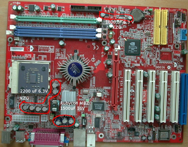

    I have tried to identify the caps on the board, but I was unable to identify the brand of most of them. I have attached a few pics of the board, so you may be able to identify them, and tell me if they are bad.

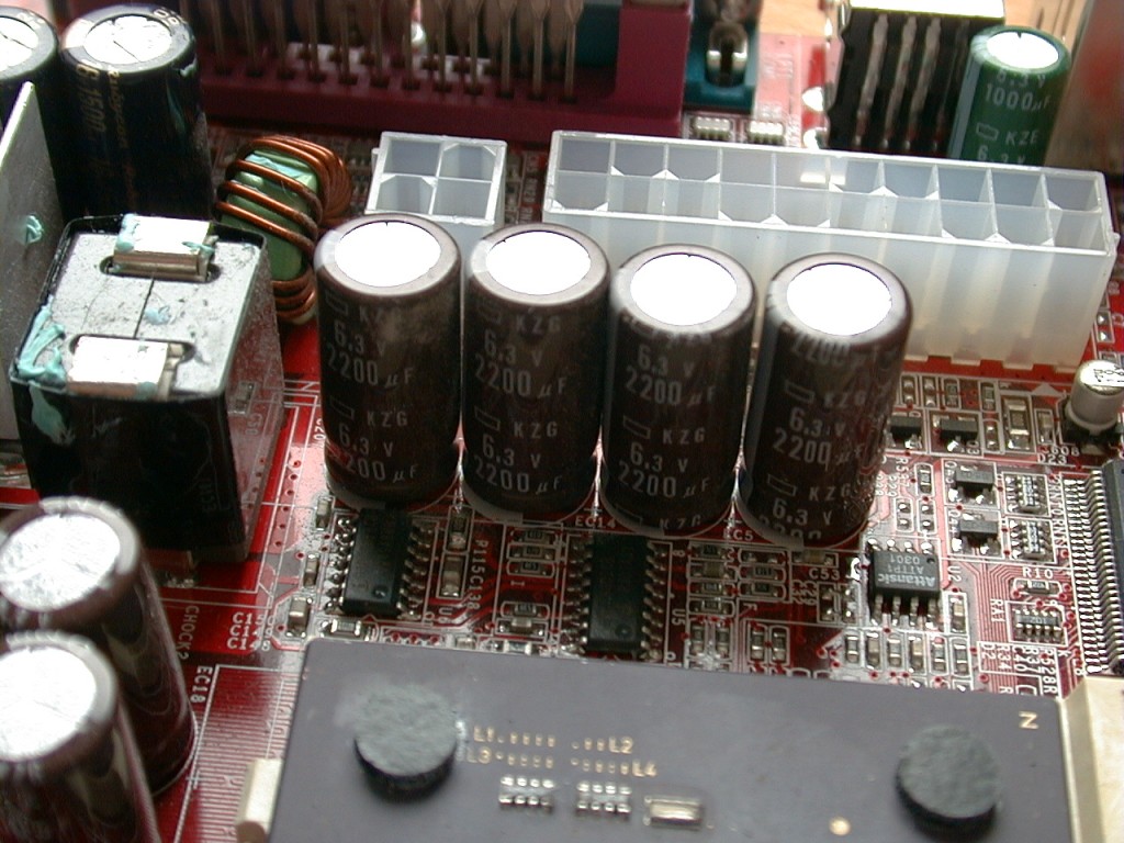

    What I could read from the caps:
    3 x 1500uF 16V Rubycon MBZ
    6 x 2200uF 6,3V KZG
    2 x 1800uF 6,3V KZE
    16 x 1000uF 6,3V KZG

      Your caps are excellent, United Chemicon and Rubycon...
      You can identify the offending coil by touching it with your finger when the system is running (wearing a ground strap of course like you always should when working with ESD sensitive equipment)

            Your KZE and KZG caps are United Chemicon caps, excellent brand (and models)

              My kid's pc has the same MB but a version 1.X (can't read the rev. there's too much crap in front). It has a very large passive NB cooler and heatsinks on the mosfets. It wouldn't run stable much past 180fsb so I put an 80mm fan over the NB and mosfets and I got a stable 192fsb x 11 multiplier on his 2500XP-M. It's only a 2 phase VRM and I think the caps (although good brand) are light on capacity. Heatsink the mosfets and go with a slightly higher rated cap. It should run a lot more stable
