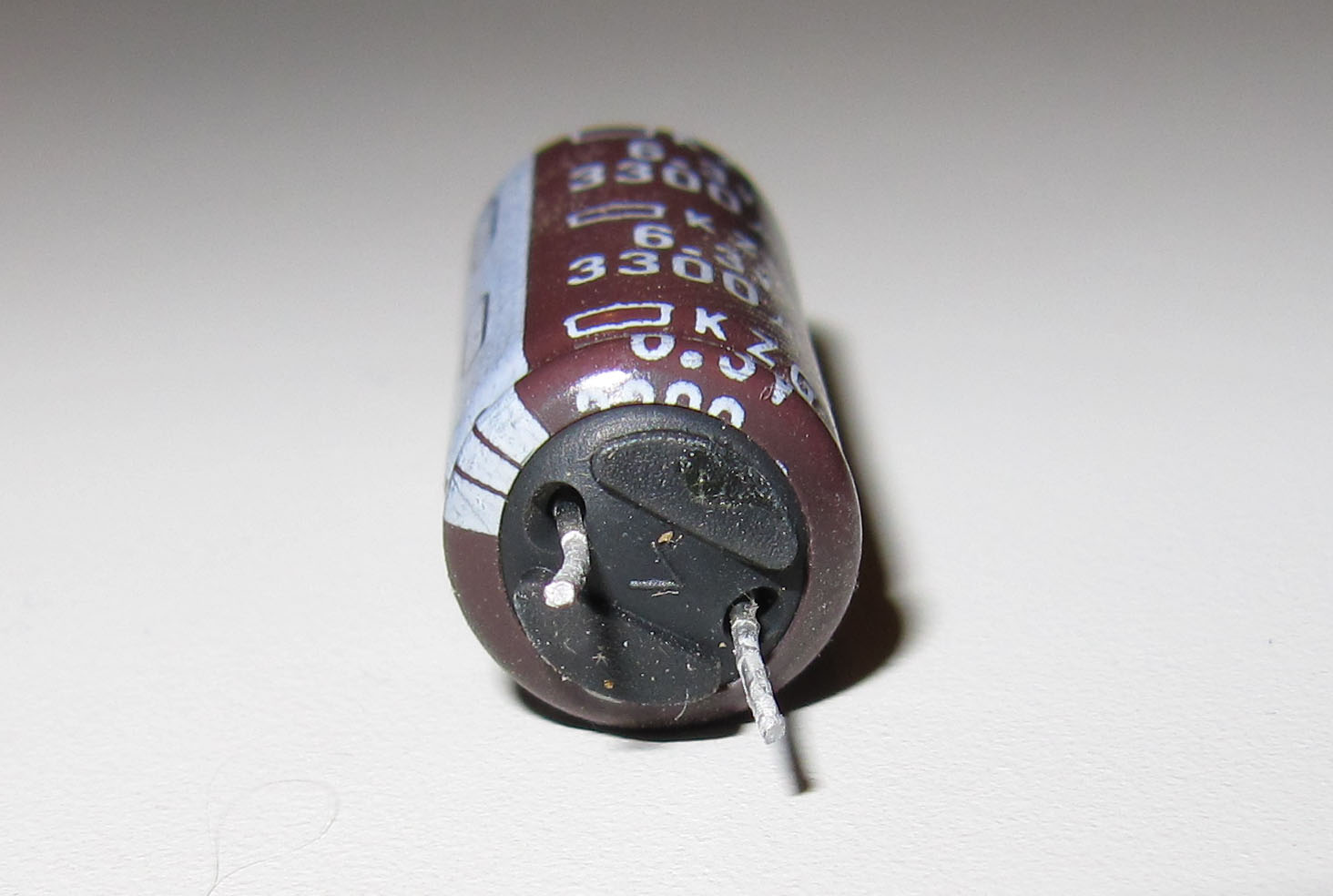

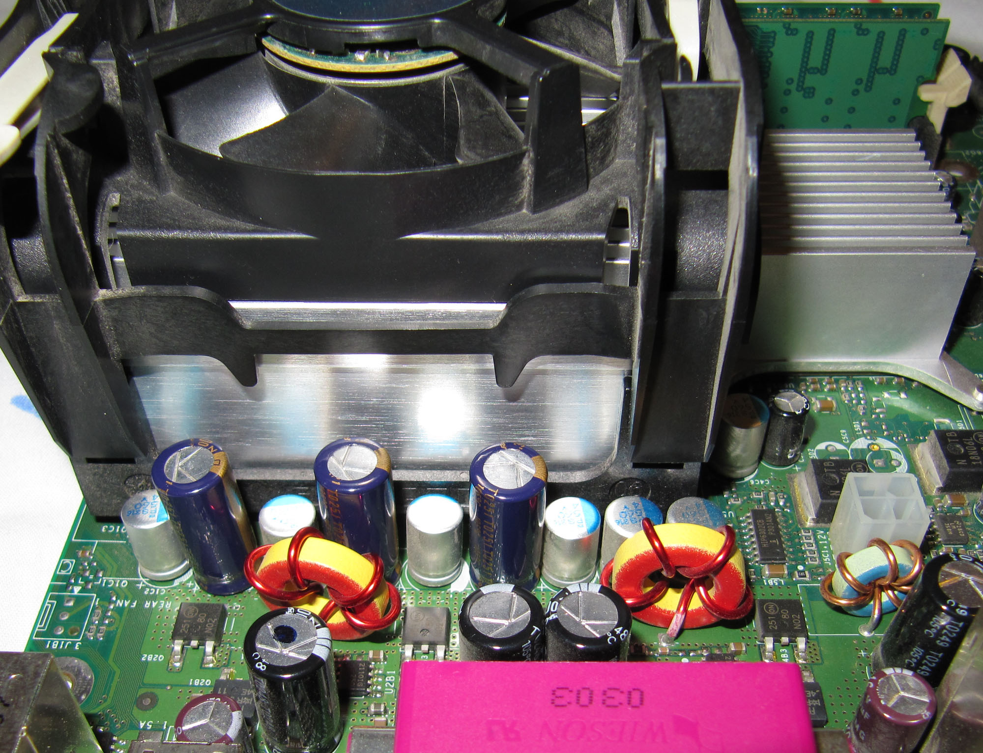

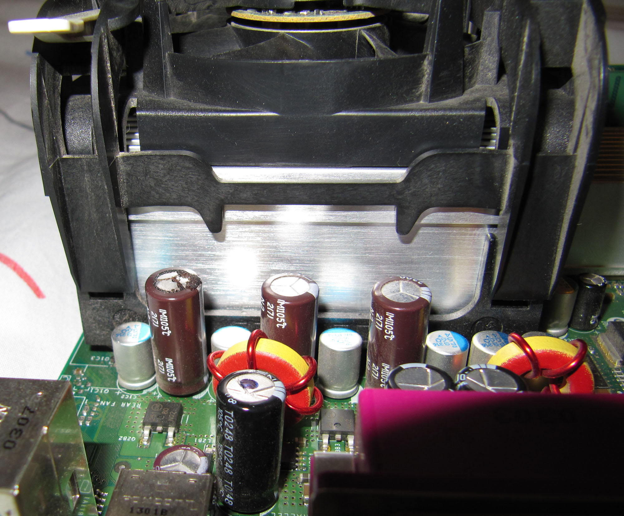

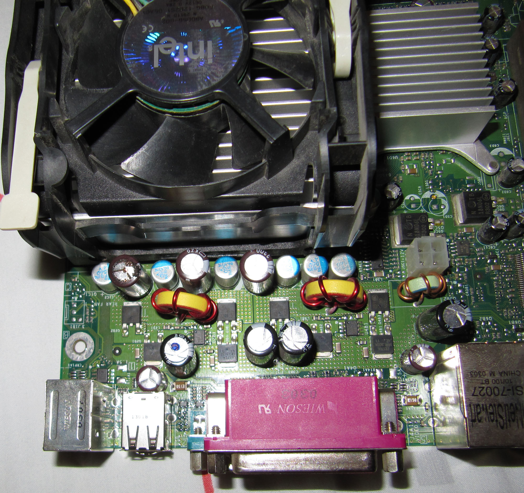

    KZG cap bulged sitting in the attic
    The motherboard is an Intel D845PESV and it was not in use since August 2011, (all the caps were ok at that time).
    Today I opened the PC case to take the speaker and noticed that 1 of the 3 KZGs was in very bad condition.
    I know that during hot summer days the temperature in the attic can reach 43Celsius, but I never could imagine that the electrolyte of KZG would break down by itself.
    Anyway, I recapped with used Rubycon MBZ that I took out from another -dead- Intel D845PESV mobo.

    Re: KZG cap bulged sitting in the attic
    yup, sometimes the forumlas can be so messed up (especially with KGZ series) they can bloat under 85c
    heat by itself CAN bloat a cap with no electricity required too. Get a heatgun, put it on high and aim it at any boards caps, and they will vent thier forumla right there
