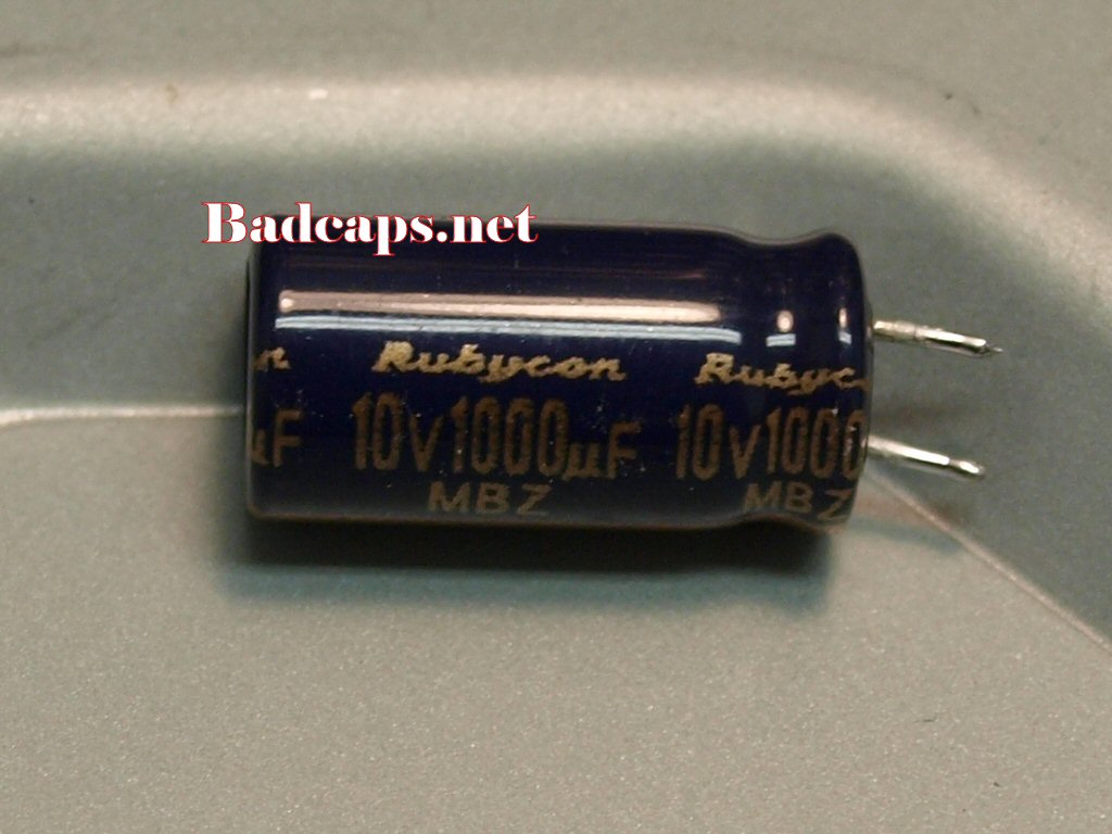

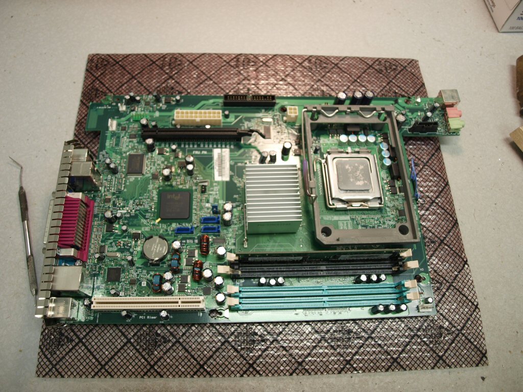

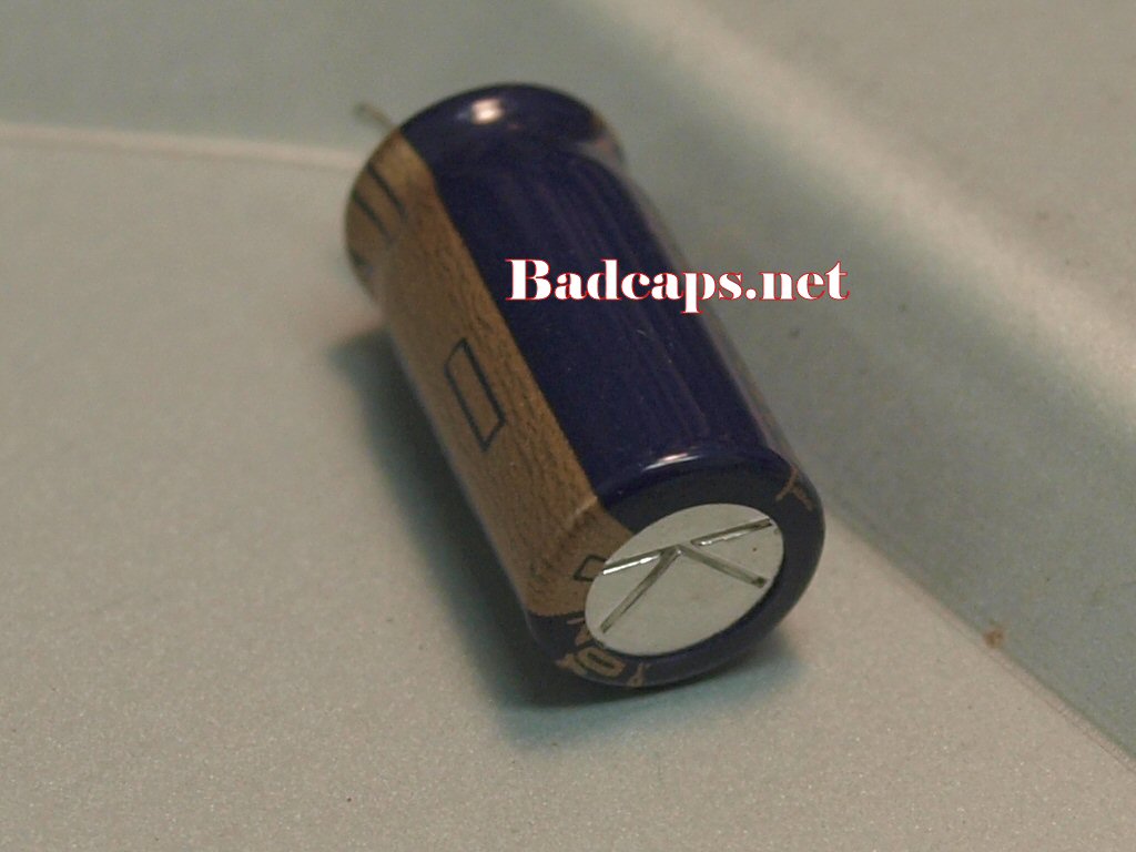

    I got a batch 30 of IBM/Lenovo Thinkcenter boards in for repair from a great metropolitan newspaper.....Yes, that is true, I just won't reveal the city, as it'll give away the client (and it is a large well known city).
    I've repaired a lot of boards with cooked MBZ and MCZ caps over the years (mostly overheated Dells), but this was the first I've encountered this issue. Their IT guy was pulling his hair out, he told me only a few of them had bloated caps, but all of them either wouldn't POST or wouldn't finish booting the OS before rebooting or BSoD'ing...even the ones with caps that 'appeared' perfect. He already replaced PSU's and eliminated that factor...so they show up here....
    I first took one that actually had a couple bloaters on it, right next to a couple FETs in the middle of the board, and replaced only the bloaters, and then bench tested it. The board would POST, but would freeze under MEMTEST in about 2 minutes....so I tried the same thing with another one, same result. There was one last board left that had a couple bloaters, I replaced the bloated caps only, and that one wouldn't even POST. ...so now what...
    I started pulling random caps of the same value of the bloaters and checking them. I was bewildered at the results!! These are so far out of spec, I thought my Sencore had gone screwy, so I checked it with a new cap just to make sure that wasn't the case, and it wasn't the tester that was out!!

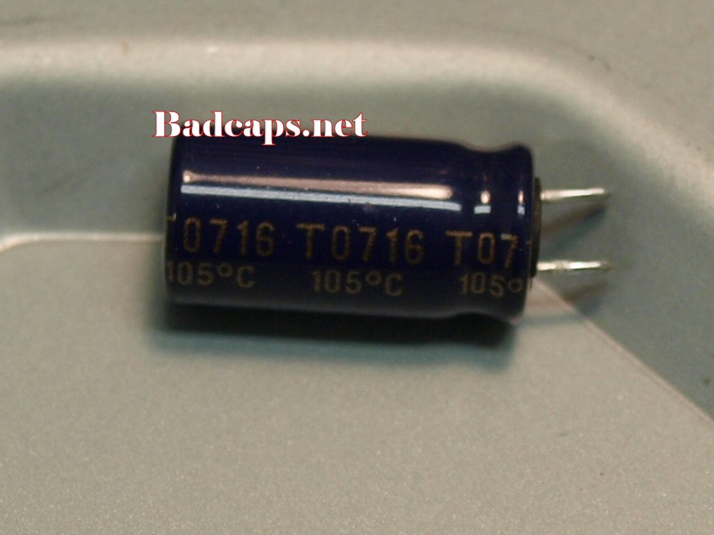

    All these caps datecodes range from 2006~2008. They are genuine, not fakes, and original to the boards. They have never been recapped.
    They were all 1000uF 10v Rubycon MBZ Series:

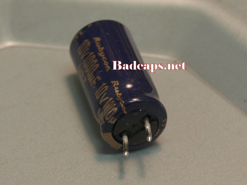

    You will note that the bung is flat, no leakage or damage:
    Same with the vent, it's pristine:

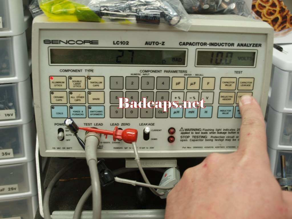

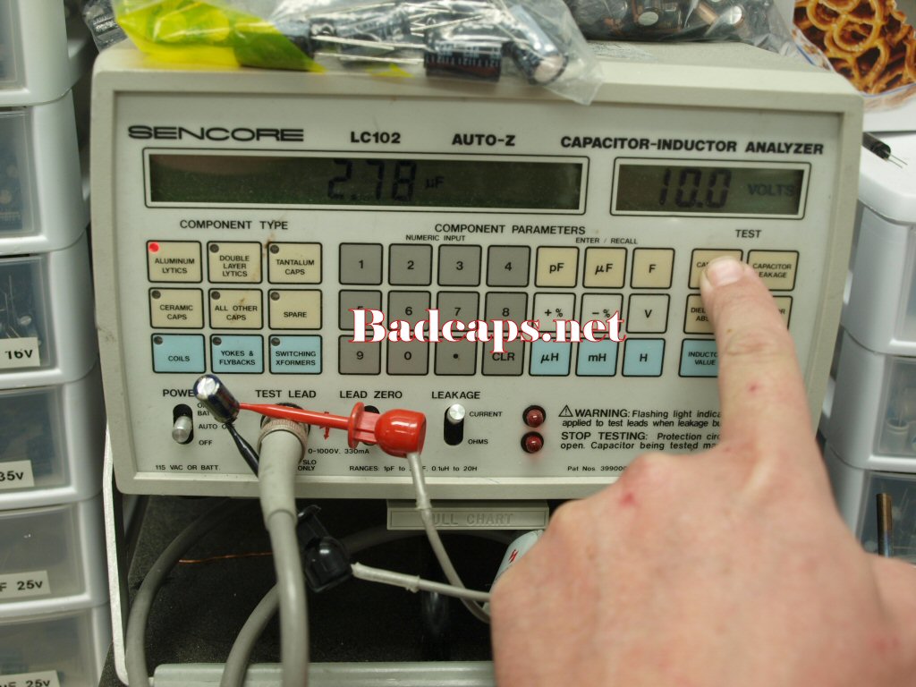

    Ok, here's where it gets interesting!! The value is SUPPOSED to be 1000uF! it's reading 2.78uF
    LOL @ 27 OHMS ESR:
    I pulled several hundred of these over the course of a couple days, this is just one cap that I profiled in this article. The rest were just as screwy. I found there was no pattern. Some were so far out, the LC102 wouldn't even get a reading, or show an open load. They would come from random/different sections of the board, clearly they didn't overheat, yet they were worse than a teapo as far as being out of tolerance but not leaking/bloated!!
    The aftermath:
    I recapped all the boards completely removing ALL their MBZ's and replacing them with Nichicon HM's of the same value. The boards now run flawlessly, and are back in operation. I did check the other caps on the board, there were some Rubycon YK 220uF 16v and a couple Rubycon 470uF YK's as well. Those were all well in spec, it was just the MBZ's. Scary trend for the recappers that don't have the equipment to accurately check a capacitor. Every failed Rubycon I've ever dealt with in the past had vented/bloated/leaked.....

        These are for a client, I dont experiment with client machines (ie, polymodding). I also dont believe polymodding is the holy grail of failing lytics. I've had plenty of failed polymod attempts....but that discussion is for another thread.
        I'm thinking they were a bad run by rubycon. When recapping a particular model of board, especially when I have a lot of the same model, you can detect 'patterns' in the failures.....IE, certain clusters/groups of caps fail, while others don't. These failures were in sporadic places on the board, not in any particular 'trouble spot'. Some of the boards yielded not a single good one, every single one was like this. The cases are also fairly well vented. Not the greatest, but overheating doesn't seem to be the root....I've seen what overheating does to Rubycon caps.... IMO, these were just a junk batch. I'm posting this more as a heads up.....if you run into something similar strange behavior from a system, you may not want to trust some of these age group MBZ's that 'appear' ok. It's the first I've see this in Rubycon.....lets see if it was just a fluke, or if this is going to become the norm...

                  Those do not look genuine to me... Vent ridge is too deep and printing quality is subpar. I have seen an incredibly good Panasonic FC fake, so I'm not surprised. Open one of the caps up and compare it under a microscope with an equivalent confirmed genuine part...
                  • Topcat
                    The Boss Stooge
                    • Oct 2003
                    • 16958
                    Re: Scary Trend of Rubycon MBZ failures - No bloating!!
                    they're real. The pic is just very close up....but I assure you they're genuine. The odds of IBM using fakes is pretty much nill....they get them factory direct, there is no middleman to the OEM's. I kinda wish this could be blamed on them being fakes, but they are not fakes.
                    here's a pic of one of the boards:

                              When a cap doesn't bloat it means the seal is bad. The seal must be good around the can and the two leads. If the seal is bad then the cap will have a short life.
                              Test the seal on those bad caps. Apply too much voltage to burn the cap up. If the seal is good it will bloat and explode like they do for c_hegge the capacitor seal clubber. Test many burning them out slower and slower. They should all bloat if the seal is good.
                              If c_hegge used voltage instead of fire he would be performing valuable capacitor seal research and having fun at the same time.

                                Would be interesting to see a dissection of a few of them to see how they failed. Dried-up as severach suggests, or something else?

                                    As for testing for dry-out, remove the shrink wrap and use a pair of small diagonal cutters to pry up the lip of the can that retains the bung. The peel the can down a little and the guts should pull out easily. Done it scores of times, though with larger caps (18mm, 16mm and 12.5mm cans).

                                      I saved a handfull of them. Autopsy to follow.
